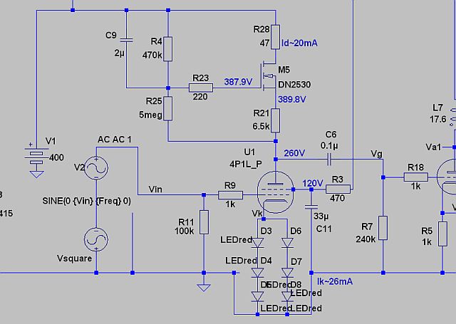

what is the gain of Pentode driver 4P1L? Operation point is 256V/-3.6V?
I will, Ale, I will. This week.
Thanks for the gain info in pentode mode.
Far more than I'll ever need to drive the output stage.
Good, keep us posted!
Gain is determined by the RL in parallel with the 4P1L when loaded with the gyrator (or CCS). It may be a bit high, you can reduce it by reducing the RL, but distortion will increase...
Ale

Hi Anatolij and others.
Trying to find a cheaper, but good, pentode driver as a replacement for my existing C3g, Im here.
Based on Anatloij first post in this thread I simulated this 4P1L pentode driver. Works good to me.
I have no experience with 4P1L or another DH pentode. My plan is connect pin 1 and 7 to 4.2 Vdc then LED string from pin 8 to ground.
Correct?
Thanks to Ale for very good 4P1L pentode spice model.

Hi Raiko;
looks doable, except I personally would reconfigure your CCS into gyrator, for better regime stability of anode voltage.
