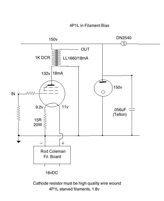

Thanks Andy, I have on hand the Lundahl 1660/18mA for #26 tube preamp and wired as you: Alt Q SE Line Output 4.5 : 1 with that configuration have a gain x10 & and output impedance of 2K?

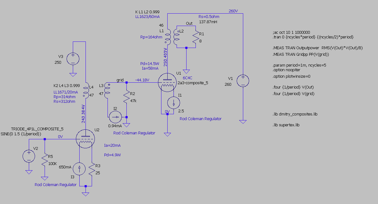

Thanks but I'm looking at why it couldn't drive a 6C4C/2A3 fairly well in triode mode.
Say I have 4Vrms input from my SS balanced DAC (using an input transformer on the amp):
4vrsmx1.44x2= 11.5 to the 4p1l grid.
My goal is about 1.5 watts max, 1 watt normal listening
with a ccs anode supply should get a gain of at least 8 so:
11.5x8 = 92V's. Divide by 2 gives 45V which is a typical bias for a 2A3. I guess I would rather have a low overall system gain and have the low Ra driving power in triode mode rather than higher gain I won't use in pentode mode.
Am I missing something looking at things this way ? I guess what trade-off am I missing ?
Well, why not. With -45V on the 2A3, you do only need 45V zero-to-peak (=peak voltage)
Ale measured a mu of about 8 for the 4П1Л, so yes, you can clip the 2A3 for, say 6.5V peak, a little over 4V rms.
I don't think you are missing anything, providing the 4V rms from the DAC does not involve any bad-sounding compromises.

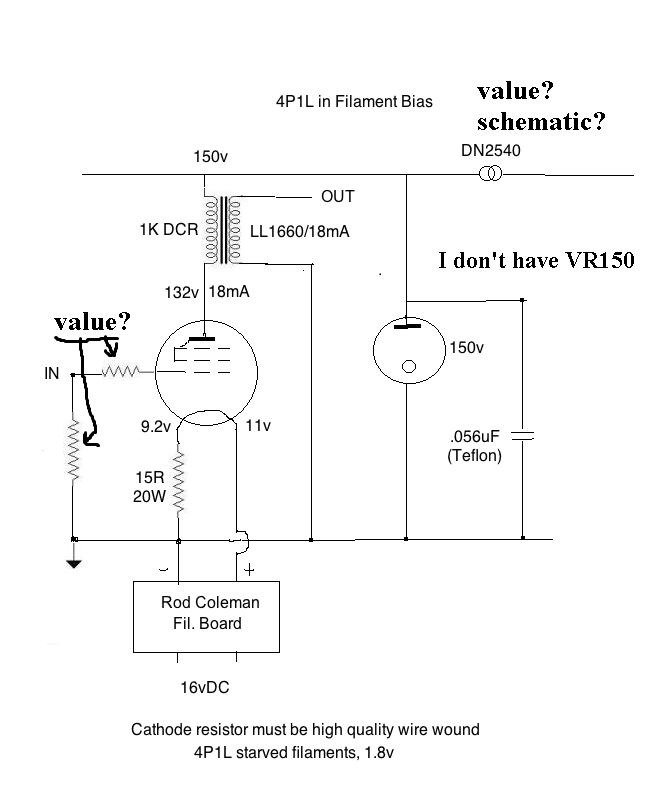

I have DN2540, I only need to know the value in mA to 4P1L and the schematic?
VR150 are these tubes?
vr150 tube | eBay
Recommended brand?

I'm not andy, but yeah, those are the VR150s. I have a bunch of them and they all work regardless of brand, but I have mostly used GE/RCA/american ones. You the CCS needs to provide the 18mA to the 4P1L + whatever current you need to light up the VR150. I don't have the doc in front of me, but close guess is about the same for the shunt as for the circuit. Shunts aren't efficient, but they sound good.

Do you see what I'm doing? with a single stage all DHT amp there's opportunity for better 2H & 3H harmonic cancellation if you make the first tube "work" harder and the output tube work less, if it doesn't work of course I can re-wire for pentode mode.
How are you going to cancel 3H?
And 2H cancellation by 2 stages is not so straight: curves are multiplied, not summed!

Just going back to the VR150 tube - it's an 0D3 octal base and I put 22.5v through it. So add the 18mA and you get 40mA. I have a 100R resistor followed by a 10uF polypropylene cap before the DN2540, so I adjust the sense resistor on the DN2540 so as to measure 4 volts across the 100 ohm resistor.

Anode followers are inverting, there is cancellation in a 2 stage SET, maybe we are talking about different topologies ?
I didn't say it would be easy, going all DHT means thinking out of the box and this 4P1L with its high gain and drive allows that. It reminds me have a poor man's EML 20B
If you are interested just run a quick simulation 6n6p vs 6c4Pi driving a 6C4C, no matter what the 6N6P always gives less 2H distortion on the output because its curve shapes are similar to the 6C4C. I know its a just a sim but there has to be some truth to it. I don't find the high gain high mu space age tubes to match well with the older DHTs in the shape of thier curves. I can upload my asc files if anyone is interested.
As far as 3H, cancel isn't the technical term but cancelling 2H leads to less 3H on the output, I would need a chalkboard to show you.

You are assuming the mismatch between the two tube's characteristics is greater than the topology's inversion. Basic math as you said, I think your assumption could be wrong, at least it is according to the simulations, but we both know that the sim tube models aren't perfect. One thing for certain at the same output level if we compare a simple two stage amp:
4p1l-6C4C vs 6c45pi-6C4C the 4P1l has 10dB less distortion according to the math. The 6n6p still beats them both because it has more inverted 2H to cancel the 6C4C's 2H.

This is what I am coming up with for a 2W all DHT 4P1L headamp, I think it is worth the cost to try and build (FYI there is more 2H going in the output tube than coming out.)
I am not showing the input transformer. Any feedback appreciated. My design decision is coming down to either this SET or a 4P1L + SS Buffer hybrid.

Building on your idea, here is my first sketch of a 4P1L into 6C4C (or 4P1L PSE). 4P1L driver is using LL1671 IT in filament bias. The fixed grid bias is using your regulator as suggested above. 6C4C/4P1L PSE with output transformer LL1623/60mA. Looks like a good approach. Couldn't simulate it as the ideal current source used in the IT secondary prevents the AC signal to develop in the grid. Any idea of how to overcome this in LTspice?
