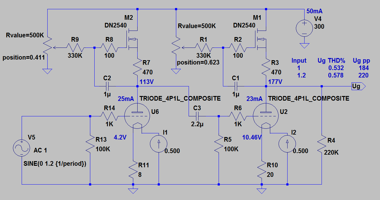

Anyone tried 4p1l to drive gm70? I heard it couldn't but i cant see why not?
It could swing 160-180v surely.. with a ccs or interstage then just needs ~<20v in so 3 stage or 4p1l line stage and very little excess gain for low level recordings with 2vrms sources.

What about a 4P1L - GU50 (triode)? I can post a sim it looks nice. For my purposes I don't like 3 stage amps, because it takes away the natural 2H & 3H distortion cancellation.
One thing I haven't quite grasped is why we need so much gain when designing an all DHT amp.
I mean you have a 3A5 in front of the 4p1l, but the most the 4P1l is going to swing is ~180V's. So why not just feed it 2ishVrms, its gain is nearly 10 so I am not seeing how the 3A5 is doing anything ?

Three stages or two depends on the input voltage and the sensitivity of the speakers. One of the many good things about the 4P1L is that it does have good gain for a DHT, unlike the 71A. So that allows an output tube with less gain, like 2a3 or 300b. It has low anode resistance and can be used in filament bias - very flexible for a driver tube. Most of all it sounds great.

Yes I agree about the flexibility, it is such an interesting tube and I have a quartet I am dying to use. Using the 3a5 for a DAC output makes sense, and it adds more flexibility for a wide range of DAC's/preamps. But for my case with a solid 2Vrms DAC (SS) do you think a 4P1L would have enough gain to push a 6C4C 150V-180 Vp-p, maybe even even a GU-50 triode ? Worse case I would use an input transformer to use the DAC's balanced output and deliver 4Vrms to the 4P1l ?
Gu-50 has nothing common with 4P1L, even though both were designed by Telefunken for military usage. Gu-50 in triode is not close by linearity to 4P1L. You can parallel 4 of 4P1L to get the same max dissipation power like one Gu-50, with incredible linearity.
2 stages of 4P1L, driven directly by CD player. 5 tubes total. You can use either an interstage transformer, or the method that I used when started this topic: dynamic load and cathode follower. Or a source follower using modern nice depletion mode high voltage MOSFETs.

The 4П1Л will drive the 6C4C into clipping easily.
It's very well behaved in pentode mode - there are no sharp rises in screen current, even with the anode down at 50V.
The only big demand is a B+ of 500V. But the current is low, so you can use a voltage doubler to get this high voltage. a tube (damper) rectifer is recommended, to give a slow rise to this level of HT.
Operating condition:
Va(b) = 500V, well filtered LCLC or shunt regulated
Va = 200V
Vg2 = 150V (eg DN2540 CCS into gas tube)
Ra = 10K 14W Welwyn W24
Ia = 30mA
Pa = 6W (7,5 max rating)
Gain is approx gm.RL: about 6 x 10 = 60
So to get 90V zero-to-peak, need 1.5V peak from DAC
IME a single pentode driver sounds much fresher and more articulate than 2-stage triode.
And if you like the sound in pentode, you can convert the stage to shunt cascode later, and get better supply rejection, more gain, and better sound.
