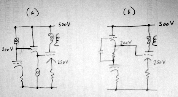

You have common cathode driving the output tube via a cathode follower. How is this different from moving the cathode following to sit on top of the input tube to make a mu-follower topology ?
How is it different? Well, look at the coupling cap.
When it is loaded on the non-linear resistance it creates dynamic distortions. So if you use SRPP (not a mu-follower, it has higher output resistance and introduces additional non-linear distortions driving the grid positively) with the cap between it's output and the control grid of 4P1L you would get dynamic distortions caused by rectification of the signal on the cap-grid shifting bias point.
It is the main reason why people believe that 300B amps sound bad: because of this dynamic distortions. Using the cap between anode of the driver and grid of the follower I eliminated this problem.
Now if you ask me to remove the coupling cap, I will ask you how to organize stable DC coupling. However, it is possible to have a 2-floor even 3-floor power supply, voltage stabilized, but it would be completely different project. I am working on something similar currently.
I see - it's the capacitor in the drive to the grid of output tube that is the beast to be avoided since positive grid current on clipping into A2 produces some charging of the capacitor.
So if I understand, with appropriate power supply there is an option of all-dc coupled (a) which means no capacitors. There is also mu-follower which puts the Cathode Follower in totem-pole and also can avoid capacitor before power tube grid but can't avoid capacitor in the totem pole (b)
The main problem is, tubes amplify. It is easy to directly couple stages with resistive load: the worst thing that may happen is saturation. But when the tube has transformer load it pulls as much current as it can. And this current changes with change of the voltage between cathode and grid. Slight idle voltage change changes idle current such a way it can easy kill the tube. That's why cathode resistor is used, to keep the tube alive. But it decreases voltage amplification factor and increases output resistance. That's why it is usually shunted by capacitor.
Yes, we can solve the problem of bias by shunt regulator in cathode. But we can't solve the problem of it's stability: slight change of current through the driver will cause big current change on the output stage.
