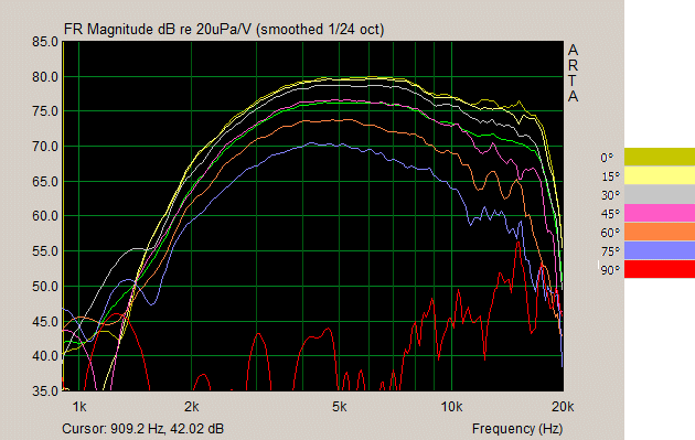

Since those are the numbers (thank you), it means that 67 mm wide "baffle" of Neo3PDR will extend the dipole behavior all the way up to at least 6k cleanly.
Now I'm even more interested in the nature of that 9k anomaly.
I strongly suspect the 9k anomaly has mostly to do with Neo3 being bare naked. Can you frame it up somehow, keeping the same overall size, but getting rid of that edge-step and see if it helps? What is that soft, oily, pliable putty that always stays soft and is easily shaped called in English?
I wonder how far it will go, given the size, if the anomaly wasn't there and it makes me wonder how far the dipole ribbon will go, given it's size and pear shape. I thought it won't go far up, but it just might go up enough...I'll do some measurements these days.

Wow, thank you for the info! 8k5 !!!! Crazy!
That's about 3.3 times it's cut-off frequency!
So, do you have a dip at 8k?
If not because it's EQ'd flat, what does it say off-axis?

Well the Neo3 eq'ed flat on axis certainly didn't retain that response off axis for me. I don't see how that could happen as the dipole peal and first null mover higher in frequency as the off axis angle increases. The dipole peak occurs at c/(2d) and the first null at c/d; c= sound speed, d= separation. We usually think of that as applying on axis but it actually applies everywhere in the far field. That is what we have the figure 8 pattern. d = D cos(theta). As theta approaches 45 degrees the peak moves up to 1.414 time the on axis peak, 1/2 octave higher so the response in the lower dipole region is -3dB at 45 degrees, at 60 degrees the peak move sup a full octave hence the response is down 6dB.

The non-PDR Neo3 dipole peak is about 3.45kHz so the first "null" is centered near 6.9kHz, not 8. John K also refers to the null as dipole bloom which, IMO, is a more descriptive term for the displacement of radiated energy from on to off axis.So, do you have a dip at 8k?
My basic measurements (indoor, ungated, 1/24 smoothed) and EQ are in this thread; figures 5 and 6 of post 1, figure 2 of post 3. The rise in the off axis curves around 7kHz is probably bloom but the SnR on the data isn't good enough I'm convinced I can declare it statistically significant. An outdoor sonogram at 5 or 10 degree steps would be conclusive but the weather here's unlikely to cooperate until, oh, May or so.
Unfortunately ARTA locks up my laptop. Thanks, though.ARTA can generate sonogram plots

That is indeed an amazing response - but I'd be concerned that it isn't the whole story. The arrangement of the two drivers makes it look like it may have different responses at different angles (horizontal looks great, but what about vertical, and in between?). Looks easy enough to try though - I guess it is a testament to our laziness .
Aleksander - if you could make a driver dedicated to dipoles, that could hit near LR4 at 1kHz, and had a smooth polar response, and good sensitivity/power handling, you would have a winner, and it would be worth the cost, because no driver can do that yet. It would change the way high-end dipoles are designed. Is there a large-enough market? I don't know.
I second that about Rudolf's work! The same goes to twest820!
I could, but you should know that a good cone driver does things better up to 1k5-2k than a ribbon ever could dream of. That is why electrostats and big planars sound wimpy with drums, percussion and piano.
In midrange, parachute effect, or large air loading, needs to be controlled with greater force per surface area than any ribbon, stat or planar can give.
Trust me, you're much better off with cones in midrange.
If you want to get truly remarkable results in midrange, use 3" FR driver in clusters of 2x4, 3x3 or 6 pieces in hexa and one in the middle for total of 7. Do not use line sources, they don't add together well, as top driver doesn't know what bottom driver does and vice versa, meaning that they don't share the load and sound equally wimpy just like one feeble 3" driver, only you can cross it a bit lower. Sharing the air loading is the key, a such 3" FR drivers clusters are the way to go. They get so much authority and slam that it;s not even funny. The main advantage to a comparable surface area of just one cone driver, is that 3" FR will have first cone breakup problems even as high as 11k, so you'll end up having a piston of a large area all the way up.
Choose only ones without Farraday rings and such tricks. Look for saturated pole plate and central pole piece. BTW, very few good driver use a Farraday ring as it wastes the signal current on showing you a nice impedance and they need 150 Watts to get dynamics and start sounding lively. Only a few bright examples exist, made by people that understand the drawback of it.
- On the directivity of dipole tweeters
