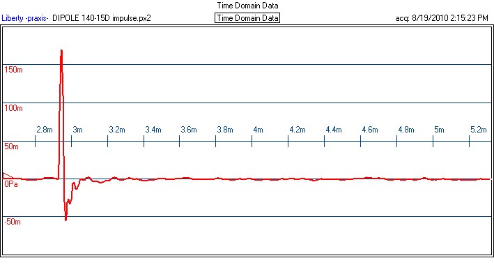

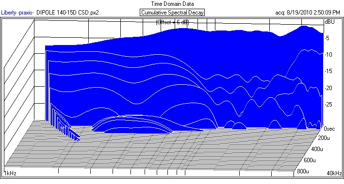

Beyma 150 is an interesting beast! here's a plot of dipole 140-15D without acoustic lens. this will make a better comparison to the Beyma tpl150, as they're about the same vertical size. If you're not crossing low, and maybe you don't as you use 4-way, I don't think you'll loose much of the efficiency, if you don't mind the same beaming.
Nice plot, it is efficient, it suffers only in the 5k-9k range respect to the Beyma.
Do you have an inpulse response maybe?

Hi, Telstar, sure you're invited! Impulse response attached.
