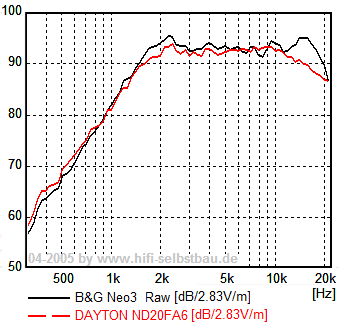

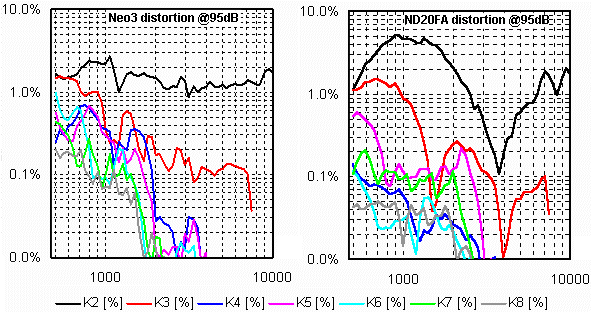

I can't tell you, I can only compare - see diagrams. All measurements are for the closed version of the Neo3 PDR and in infinite baffle. Identical measuring conditions for both drivers, but not done by me.
To put things straight: I'm not advocating to replace all Neo3s by tiny Daytons. I was only trying to find the limit, where dome tweeters can work as true dipoles.

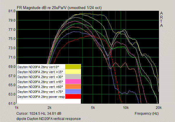

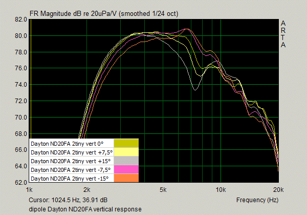

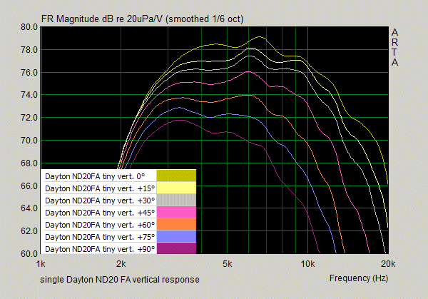

Immediate desaster
Today I measured the vertical response of my tiny dipole tweeter. In fact I turned the baffle 90° and rotated it horizontally:
attachment.php
Results were much worse than I had expected. First "upward":
attachment.php
Then in smaller steps around 0°:
attachment.php
Things get out of control almost immediately. Even +/- 7.5 deg is not bearable. So back to the drawing board. It will take me some time to get the sticky gum away from the tweeters. 😡
Afterwards I will again try the tweeters back-to-back and see, whether cutting away some of the baffle area has done anything helpful to that configuration.
Rudolf

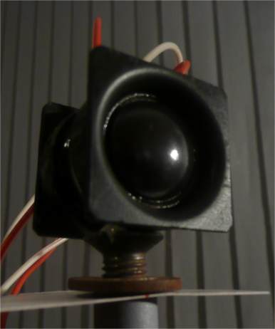

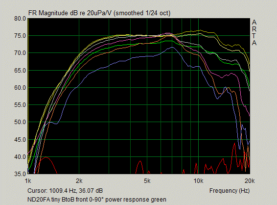

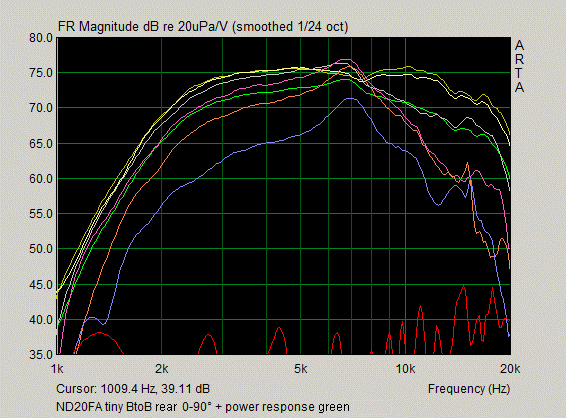

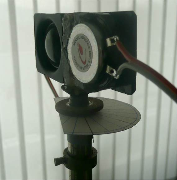

This will be the last time ...
I glued the poor tiny Daytons together back to back and got a package of 3.3 x 3.3 x 3.0 cm:
attachment.php
The resulting dipole response is possibly the best one can get with these tweeters without compromising any direction (as in my last attempt 😡):
attachment.php
But there is a back side to everything - literally. The quality control of those cheap ND20FA isn't very picky - resulting in a less convincing response from the opposite driver:
attachment.php
For comparison I show the response of the original unequalised ND20FA dipole in a small housing as presented in post #6:
Can you spot the progress? 🙄 😛
I now will take the Dayton tweeter dipoles and put them in place of the larger Monacor dipoles. If they sound better, they will stay. If not ... I don´t believe they would sell on the bay in this shape. 😀
Rudolf

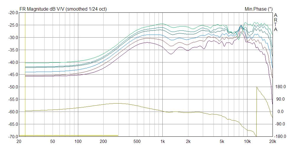

I'm getting (what I think are) decent results with my Neo3 PDRW. The trick seems to be the amount of effort I put into fixing the on-axis null - too much and too little both seem to hurt the overall response. I'm still experimenting - here's my last attempt, 1800 LR4 XO to a 6.5" midrange, no foam or felt on the tweeter:
attachment.php
The listening axis is around the 2nd or 3rd curve from the top. I plan to try a notch for that 9kHz peak, even though it'll make the on-axis response worse. It's funny how a totally different picture emerges when you look at the off-axis plots.
I agree with keyser that the non-PDR model would probably be a better choice. Well, different set of trade-offs, I guess.

Spatz,
if your design is technically feasable - which I can't judge - it would surely help to make a very compact dipole tweeter. But I don't know, if there is a market for more than two dozen pairs worldwide. 🙄
Saurav,
- adding nothing around the tweeter that could increase the dipole length
- ignoring the 0° axis when equalizing
- listenig off axis at 15-30°
those could be the best strategies when dealing with dipole tweeters. And yes, getting those small critical areas in the response right can become a never ending story ... 😉
Rudolf
