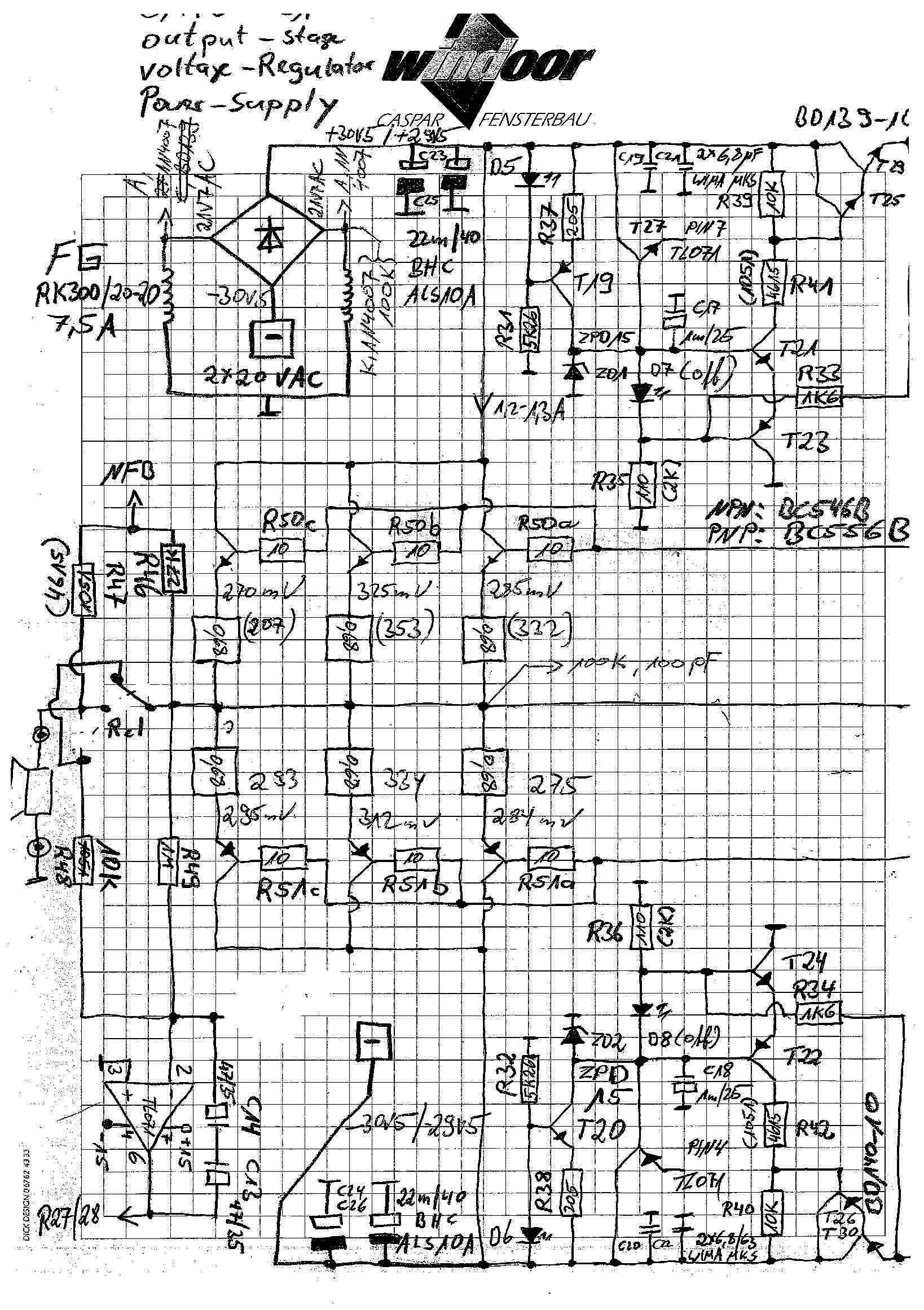

under the URLyes, the values are little different (between 676 and 683 mR). But to little for the observated variation at idle current.

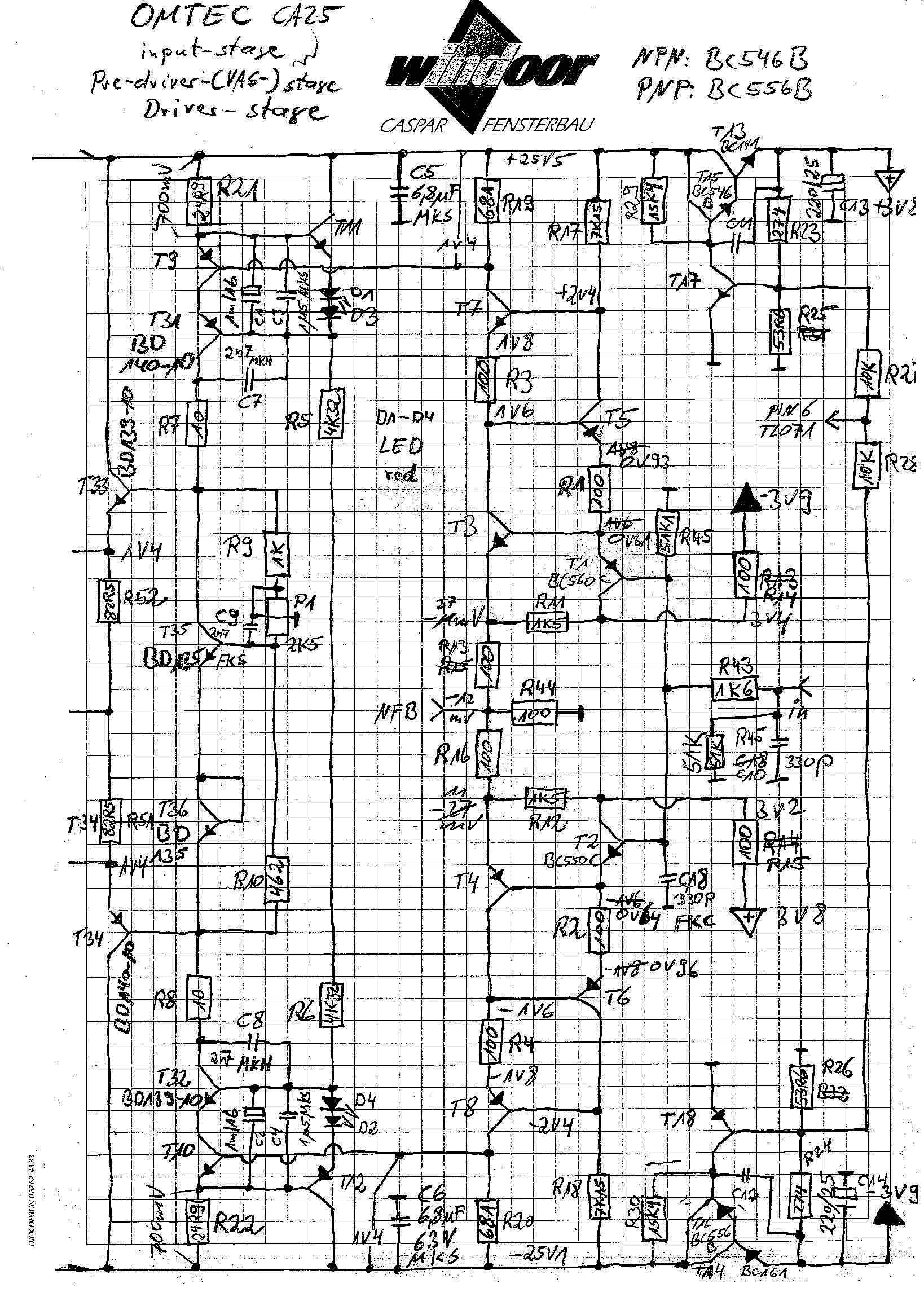

the showed circuit are to find in the datasheet of AD844The Input stage is a heavily cascoded symmetrically realized buffered current feedback input stage, which couples into a high linearity push pull current mirror ("VAS").
If you take a look into classic CFB-OPAs like AD844 or AD846 you'll see very similar circuitry.
The basic topology is the one of a transimpedance stage (input + mirror) and a power buffer.
http://www.analog.com/media/en/technical-documentation/data-sheets/AD844.pdf
on this circuit even the non inverted input has low impedance - in opposite of the AD846 and the used circuit in OMTEC's CA25 - go to
http://www.analog.com/media/en/technical-documentation/obsolete-data-sheets/270284AD846.pdf
Where is a successor of the AD846 ??

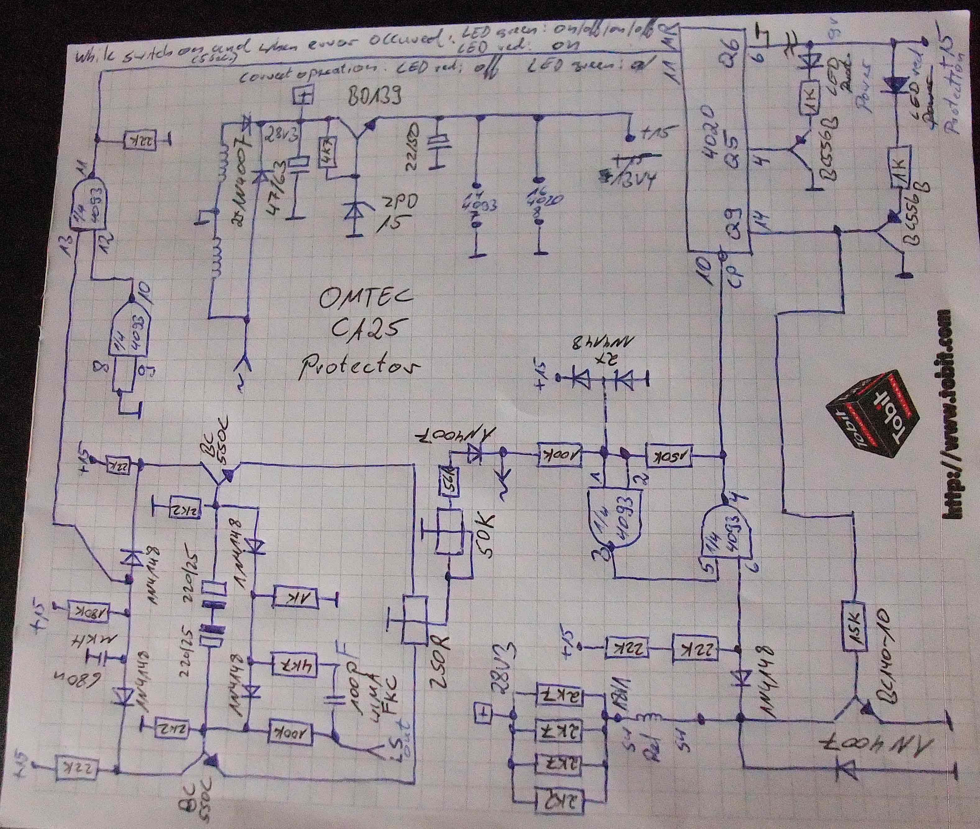

I understand the AD 846 schematics: But: For me, the Omtec has a high impedance input and current feedback.
And I see a cacoded amplifying stage, but no output buffer. Correct?
I would be happy, if someone posts the control circuit with some explanation.

There is an input buffer (T1 and T2, thus high impedance input) for the actually non inverted input (base T3, T4) and a darlington output buffer (T33/T34 include the associated power BjT devices - 6 pcs in TO-3 outline) behind the cascoded VAS stage (T9+31/T10+32).
Because the NFB signal was flow in the emitters of T3/T4 (= inverted amp) we call this NFB kind "feedback with current control" (in opposite to a typical LTP input amp with differential amp and two high impedance inputs).
Basically, but not in all details the same circuit than the internal circuit of AD846.
The reason for multiple cascoding at the input stage could be reducing "Memory distortion" - go to

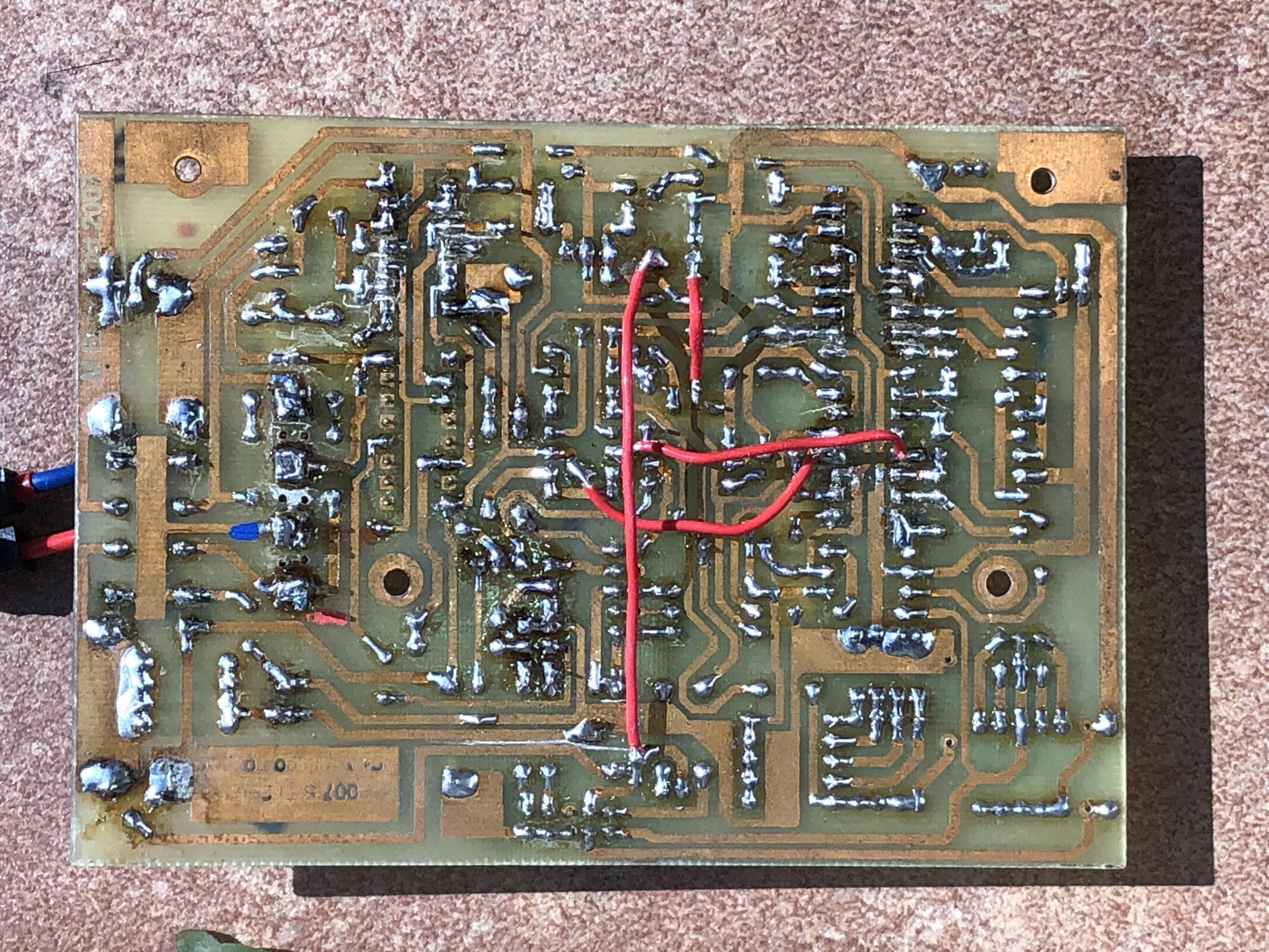

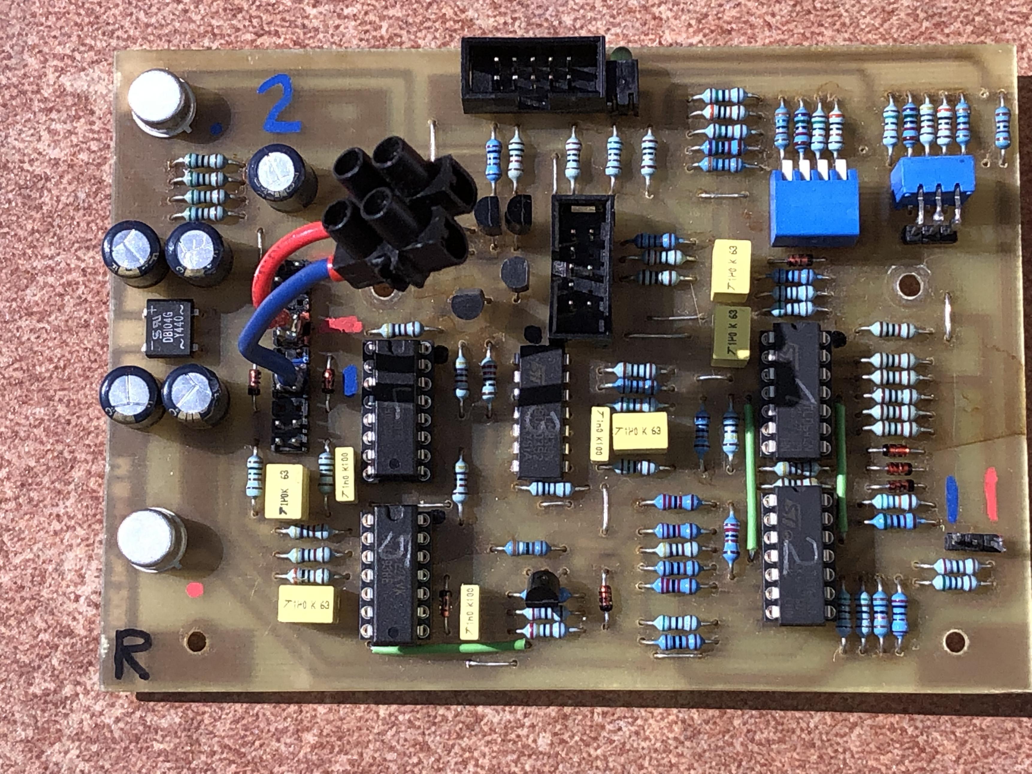

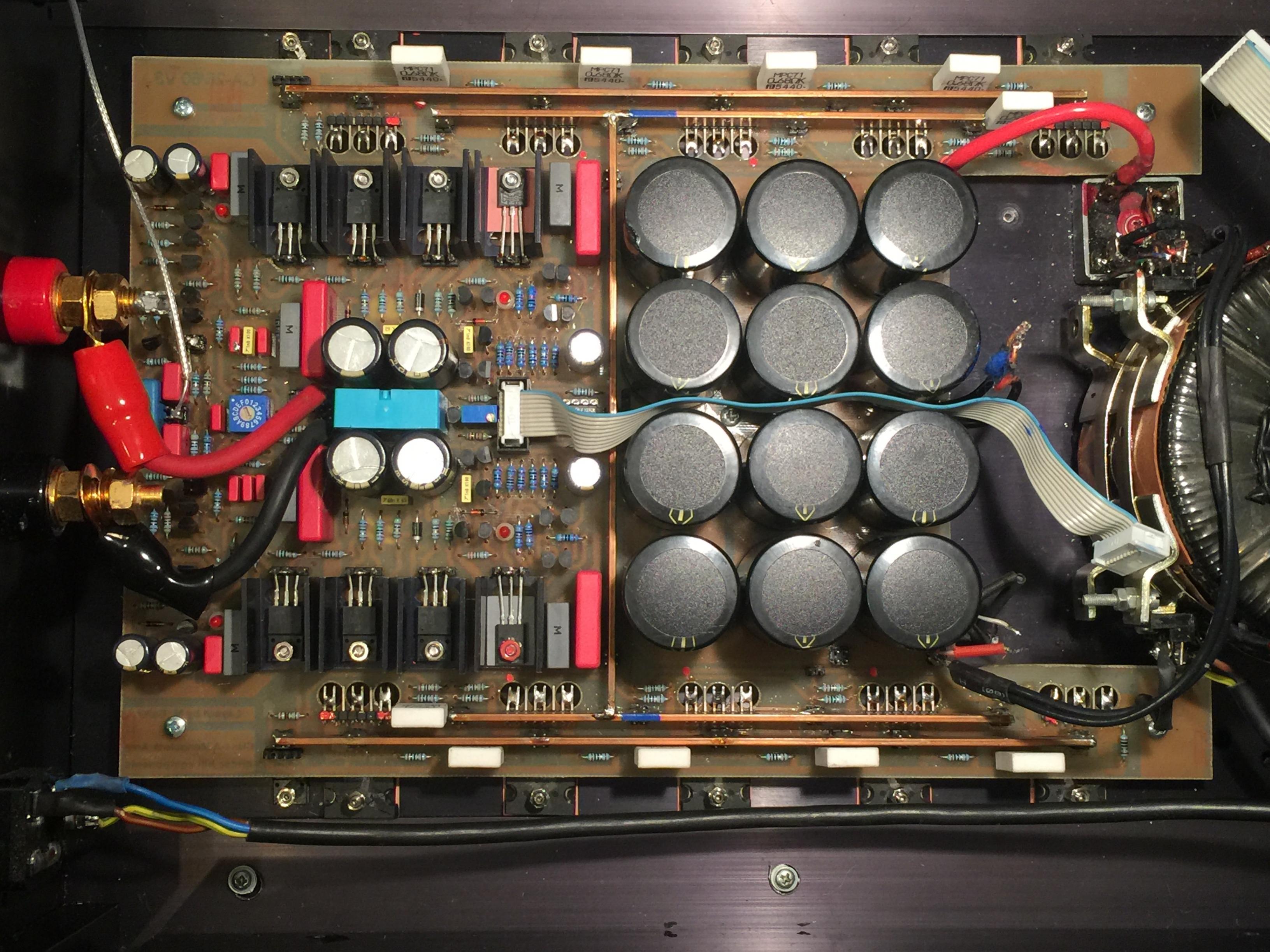

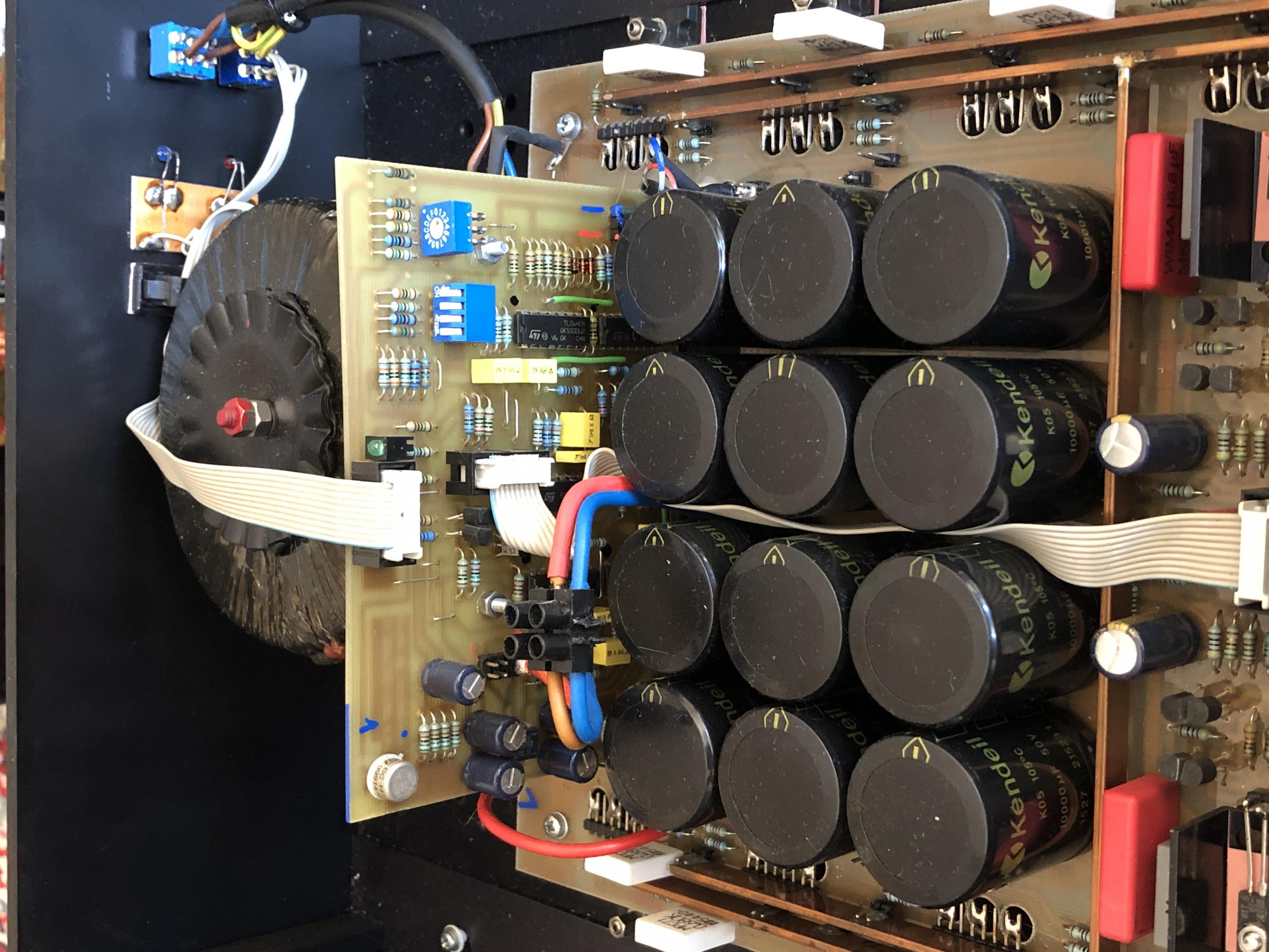

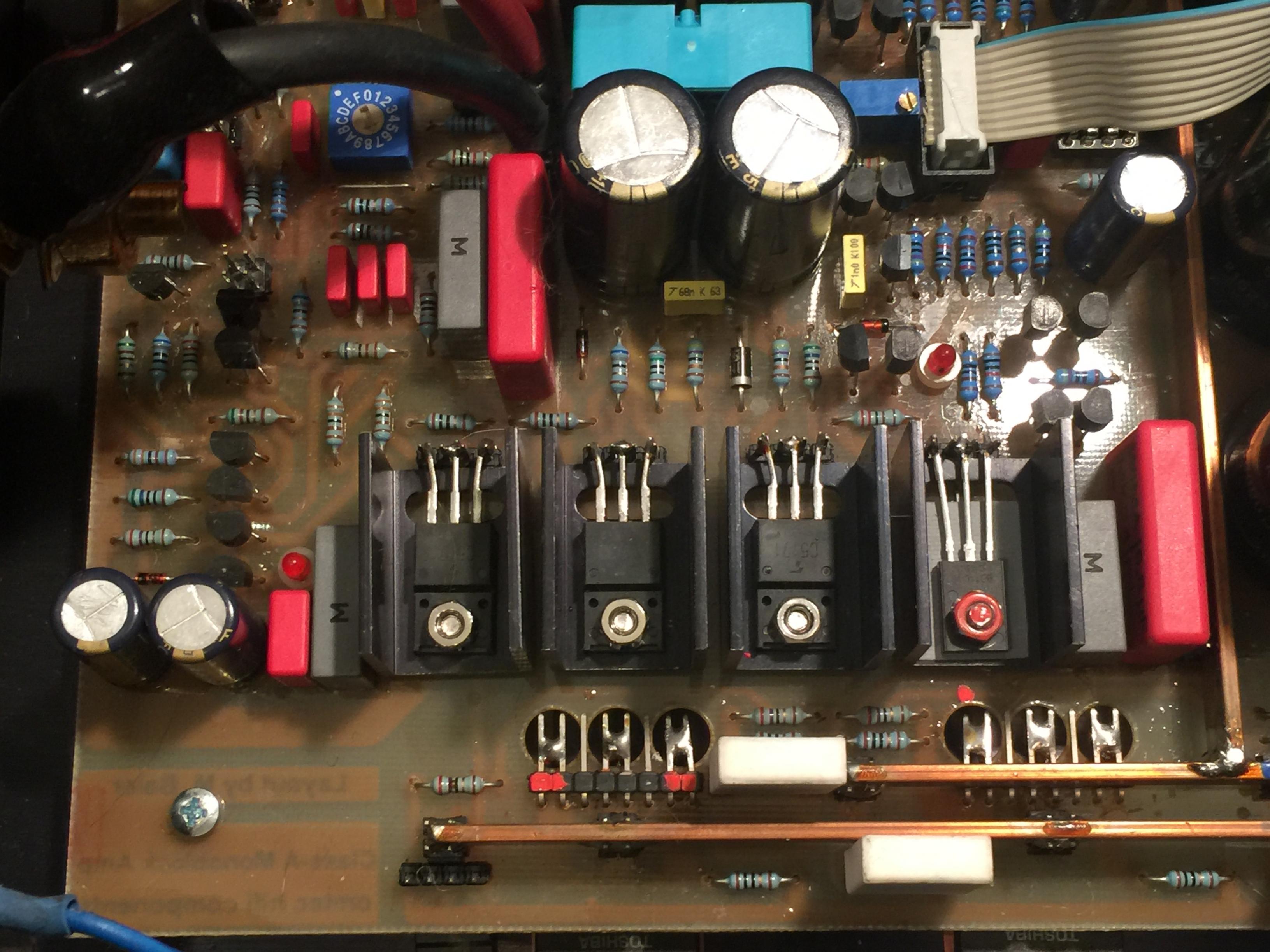

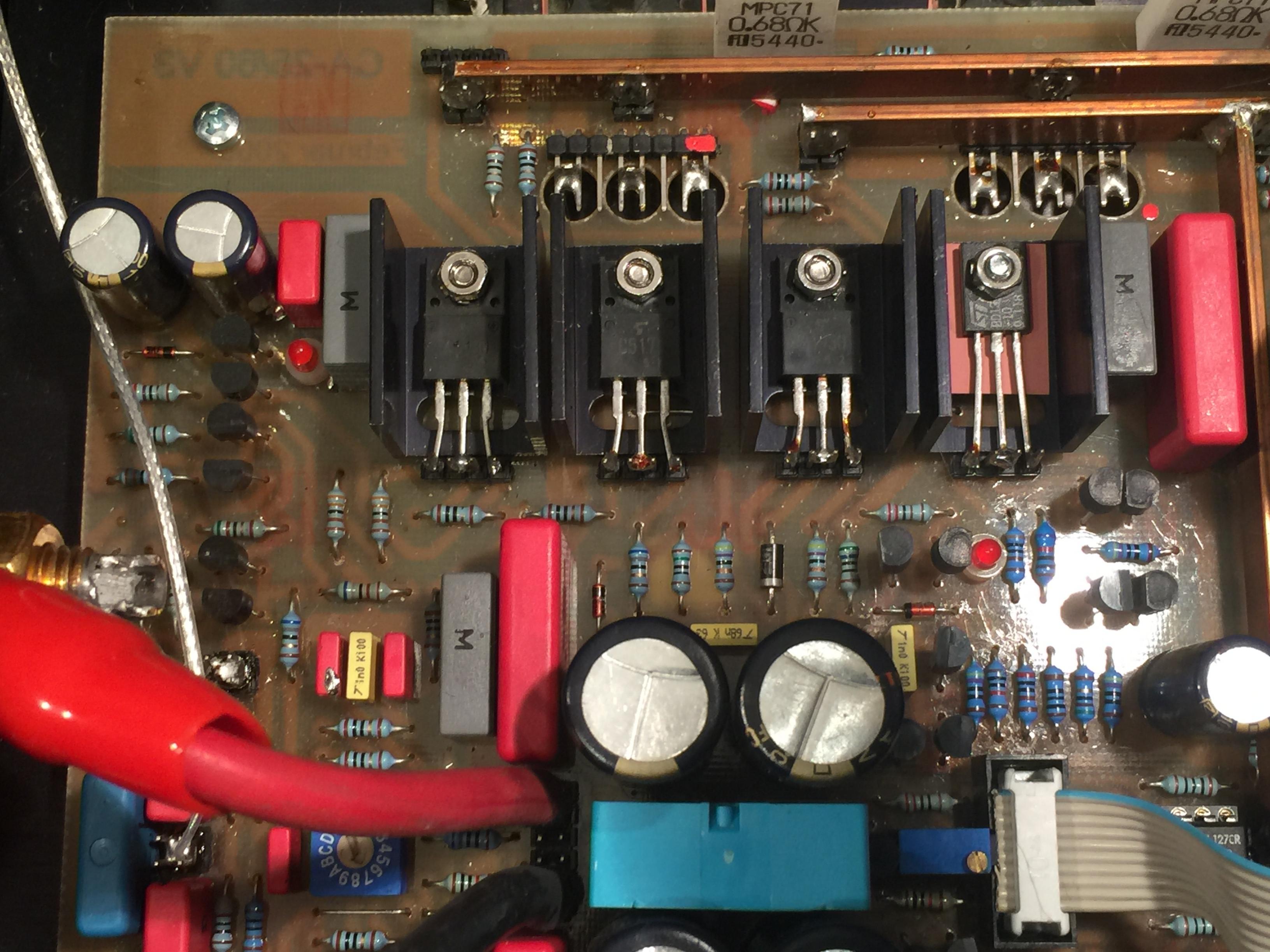

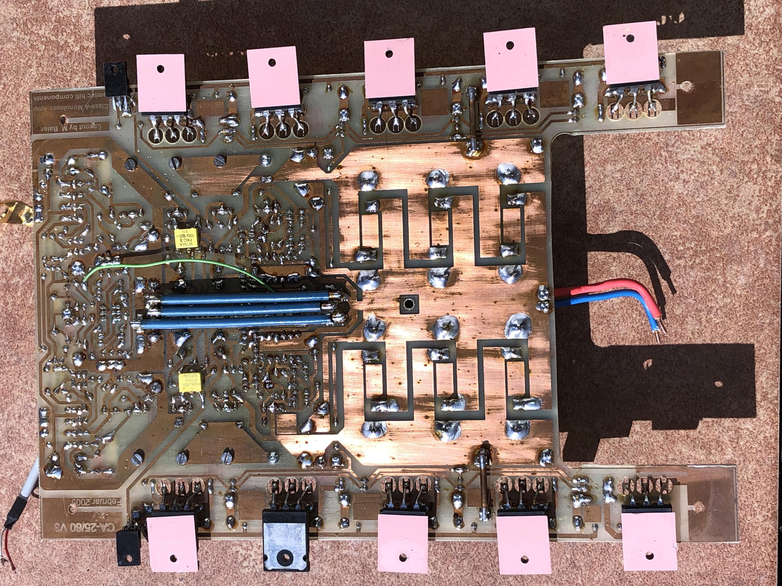

OMTEC CA60V3 schematic wanted
I will get the last version (PCB from Feb 2005) for troubleshooting next time. Maybe anybody have the schematics for upload - thank you very much in advance.
