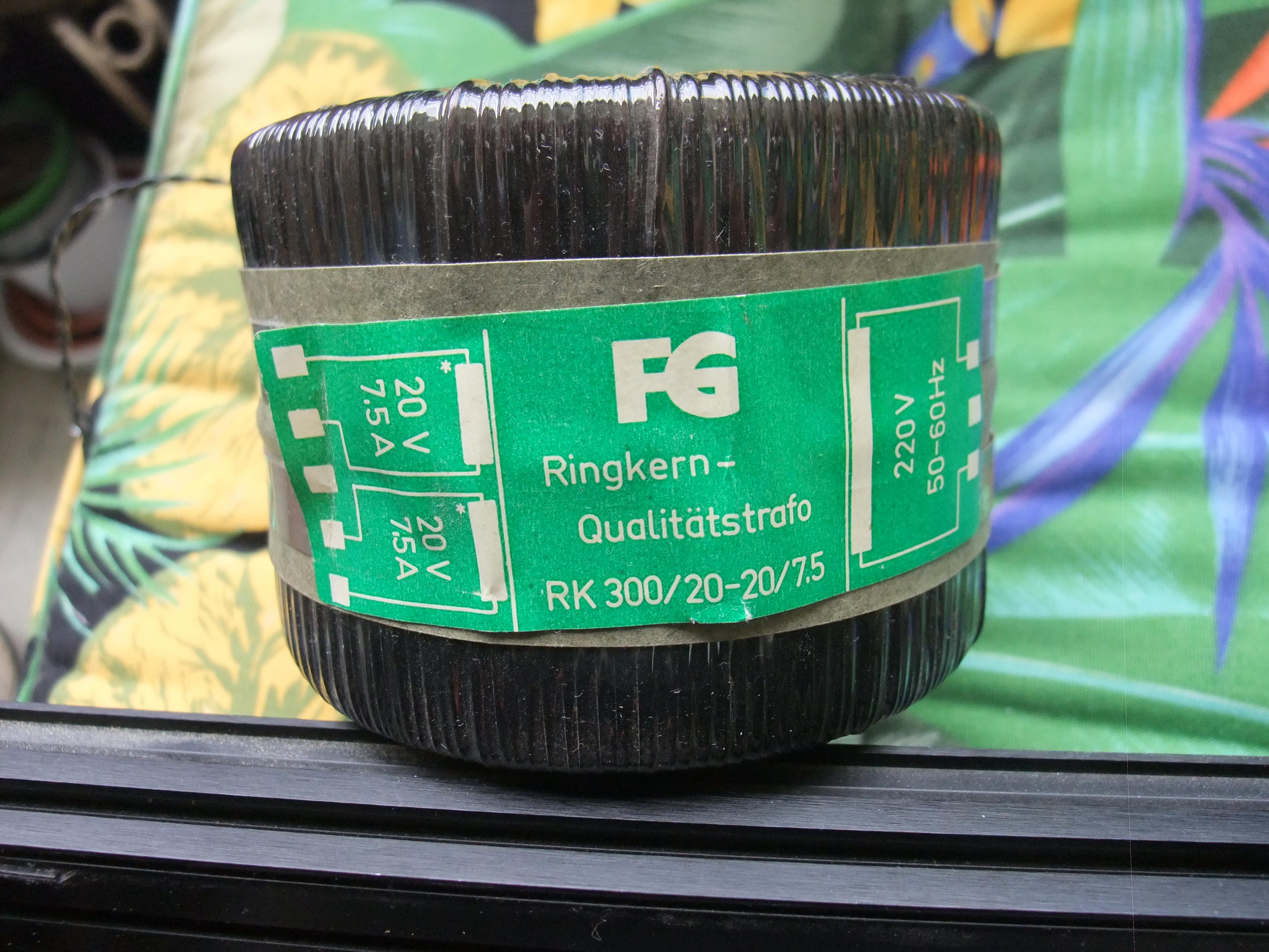

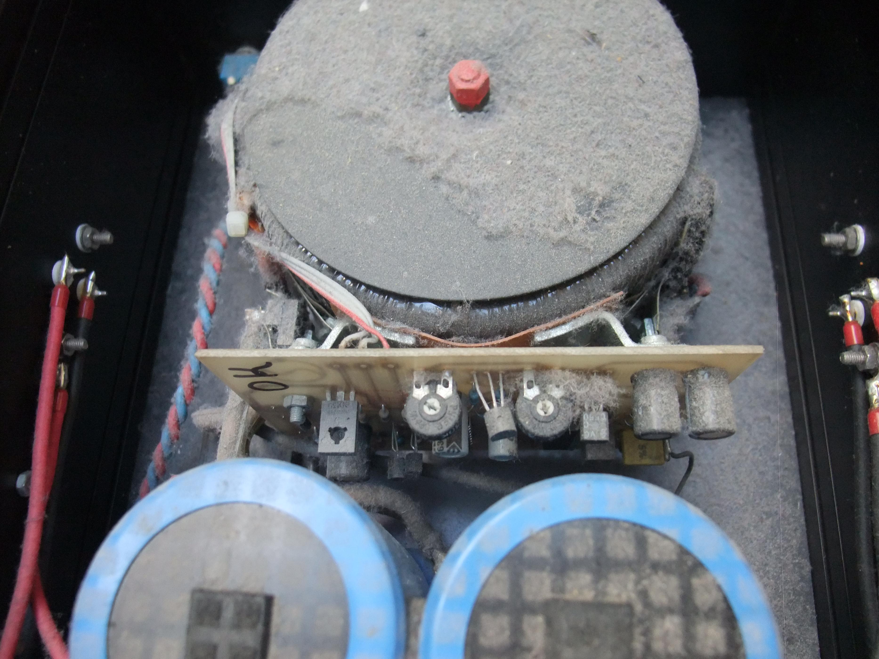

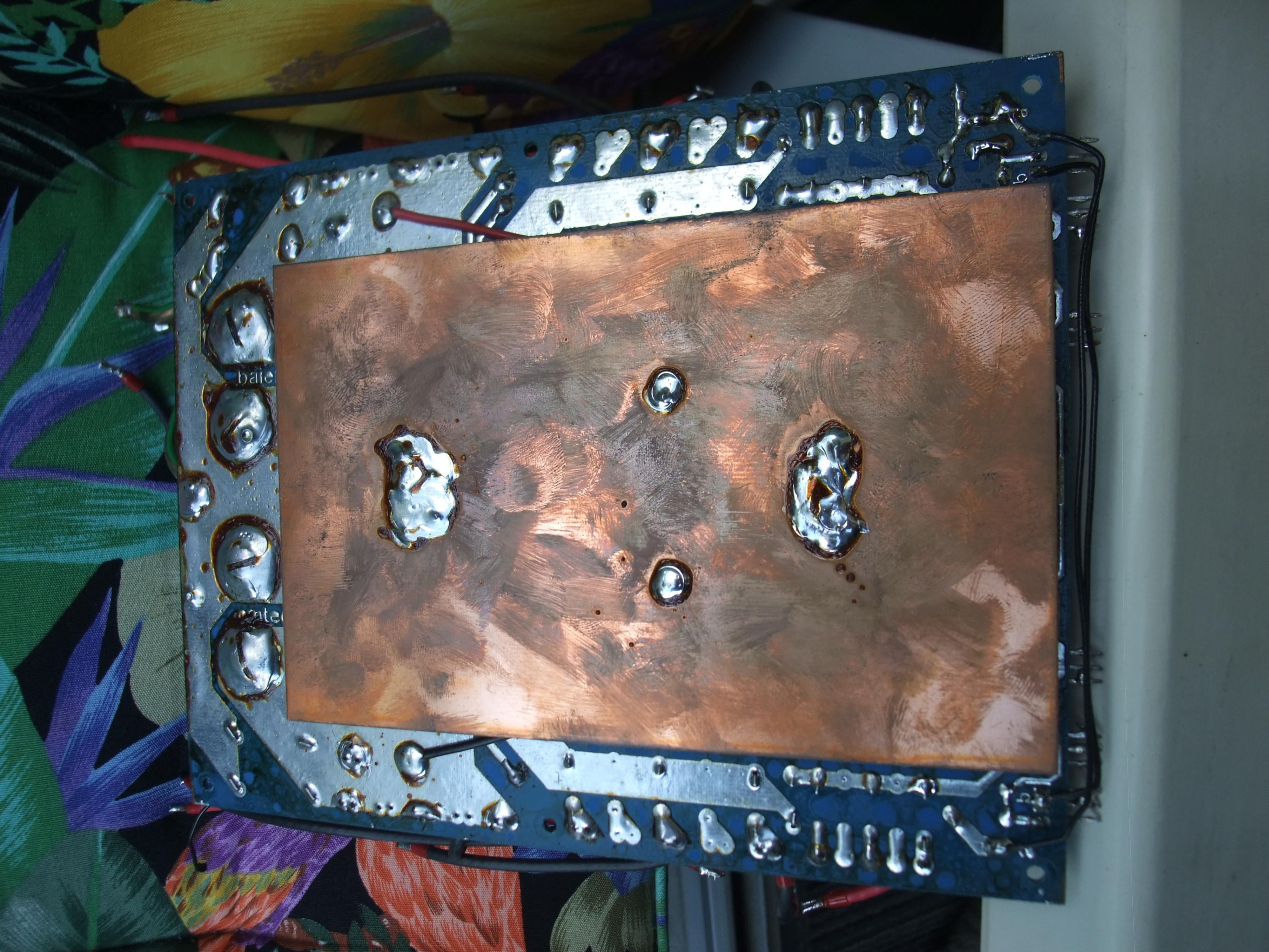

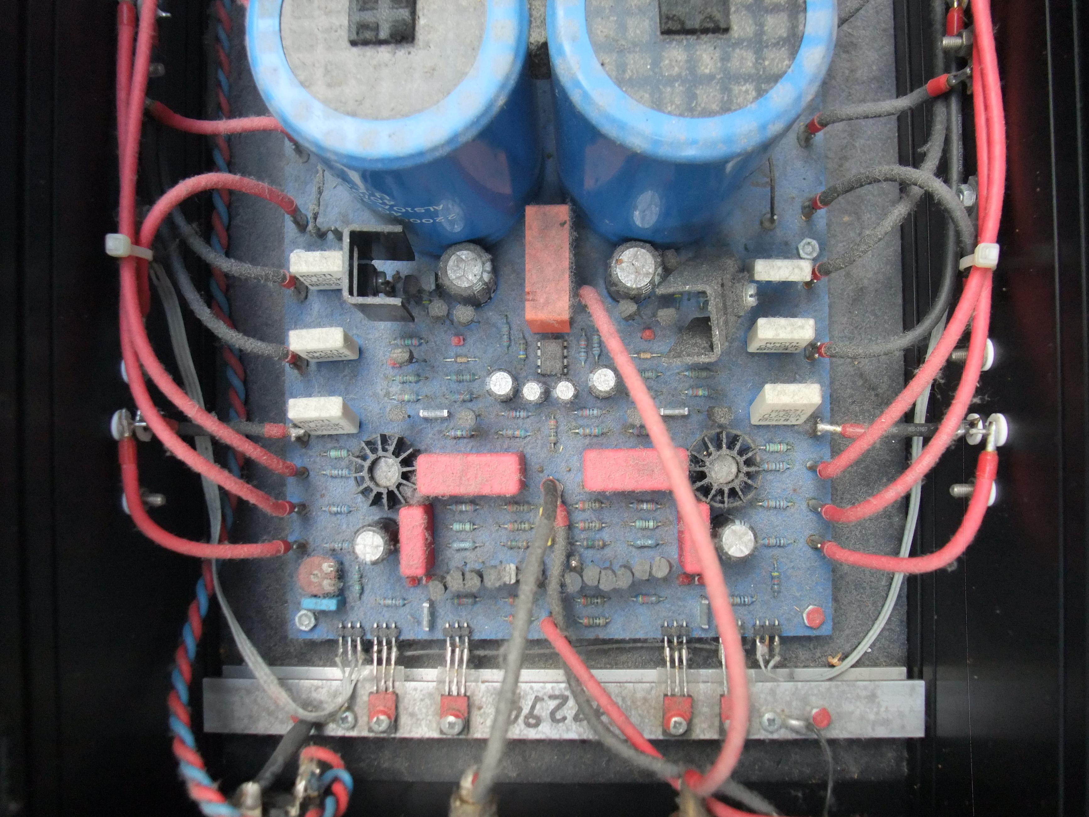

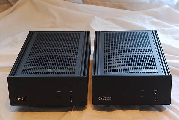

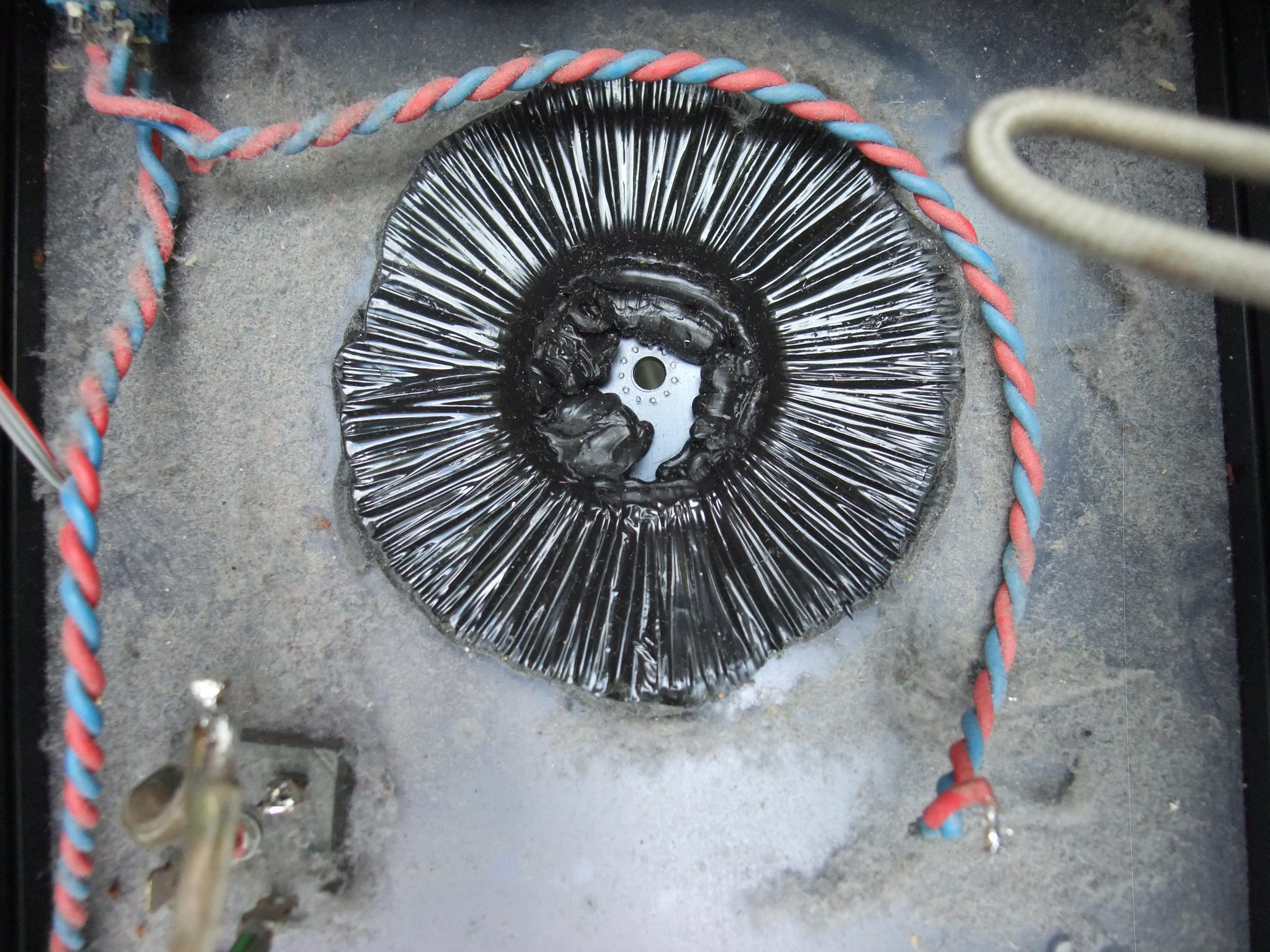

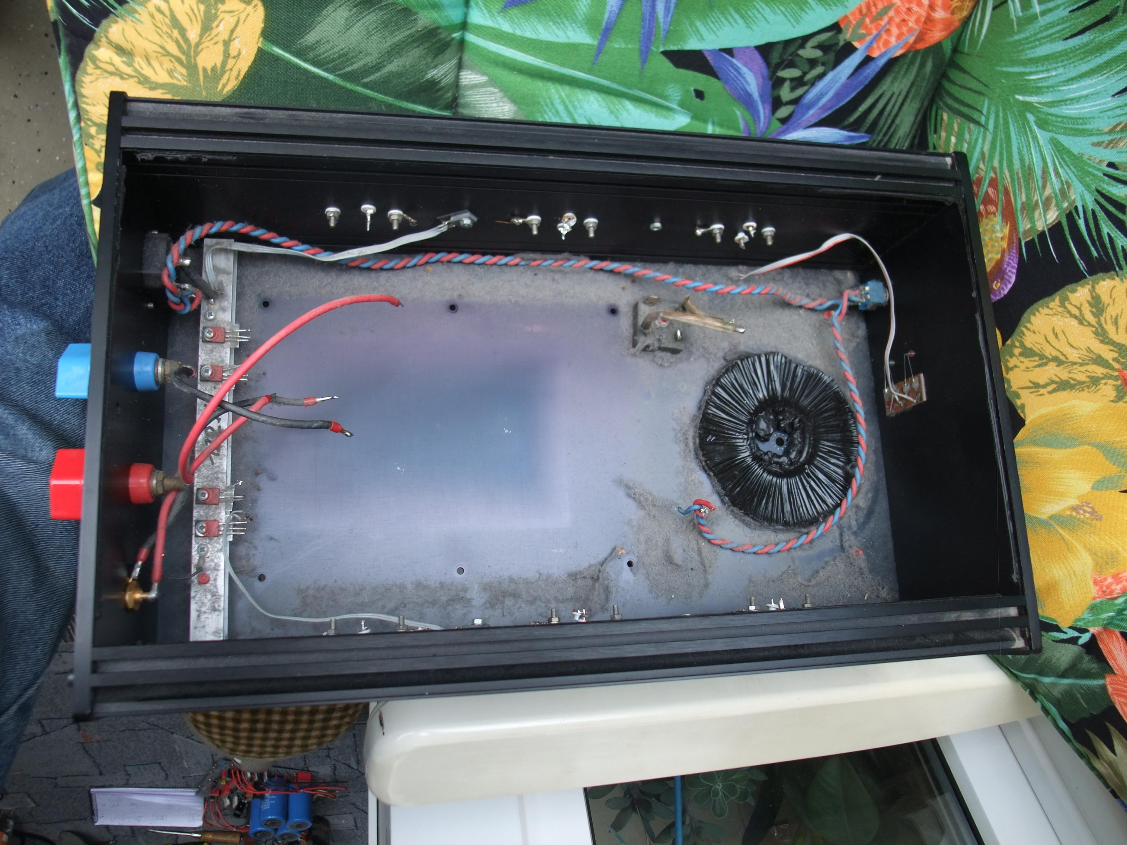

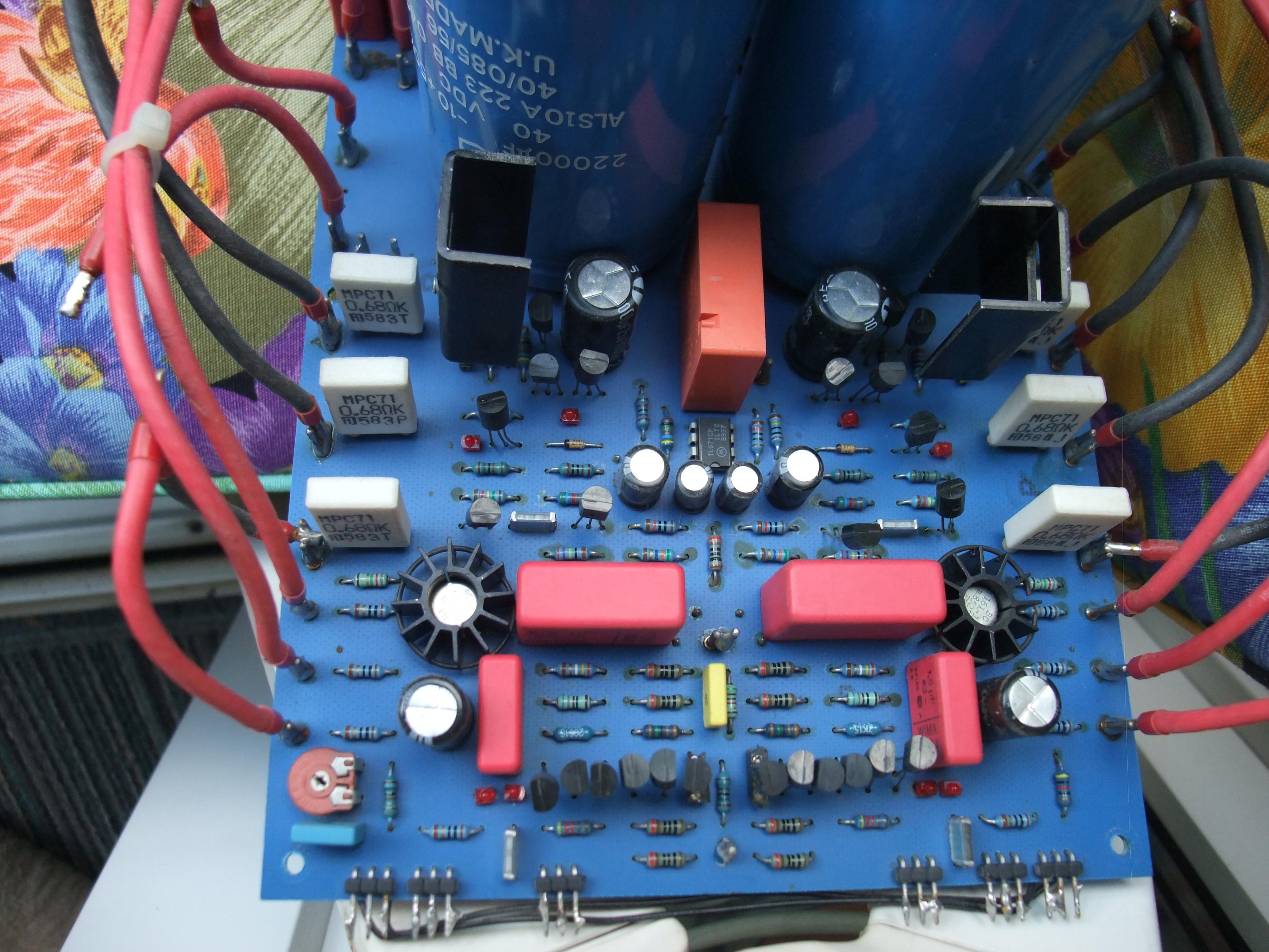

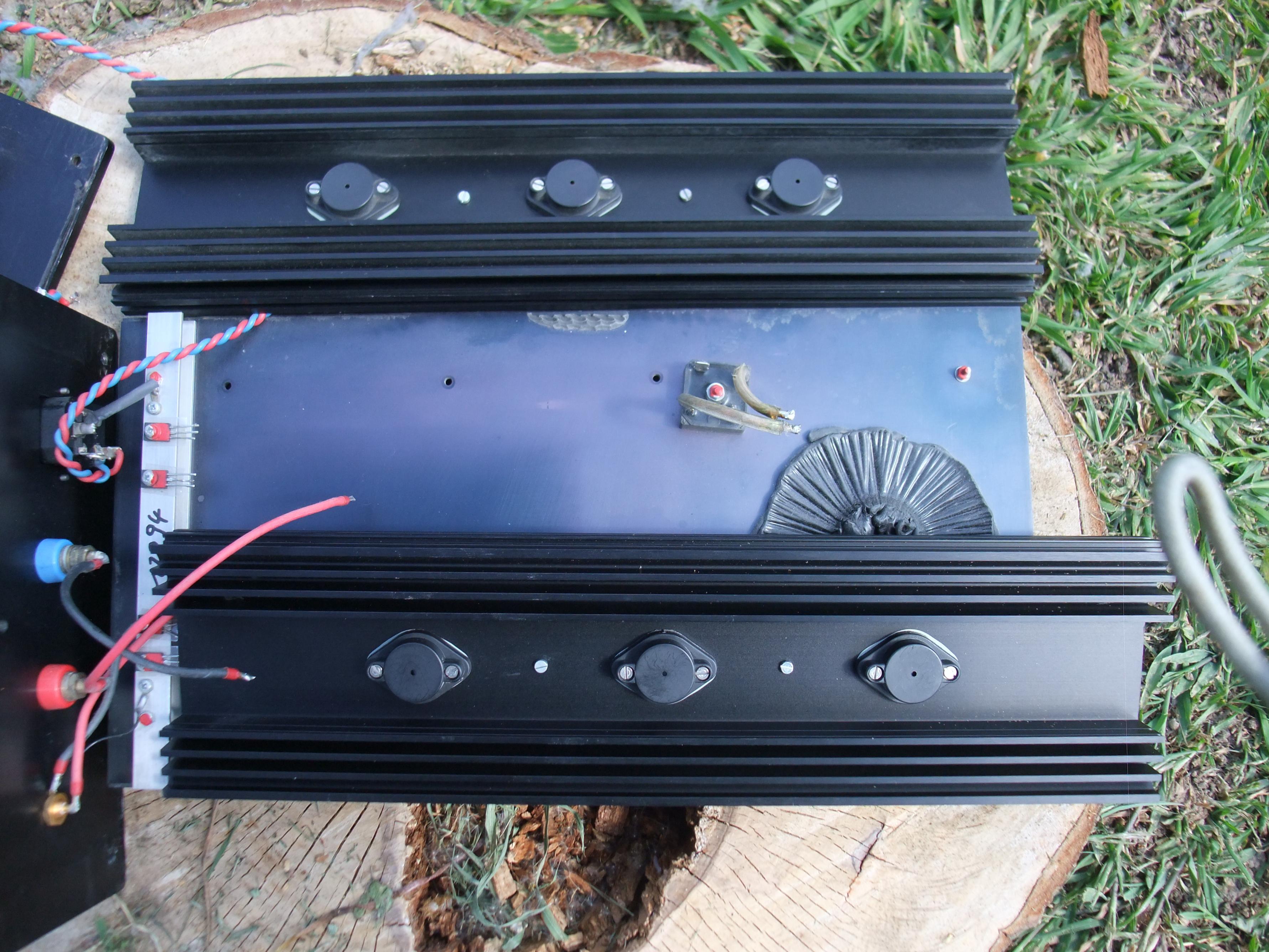

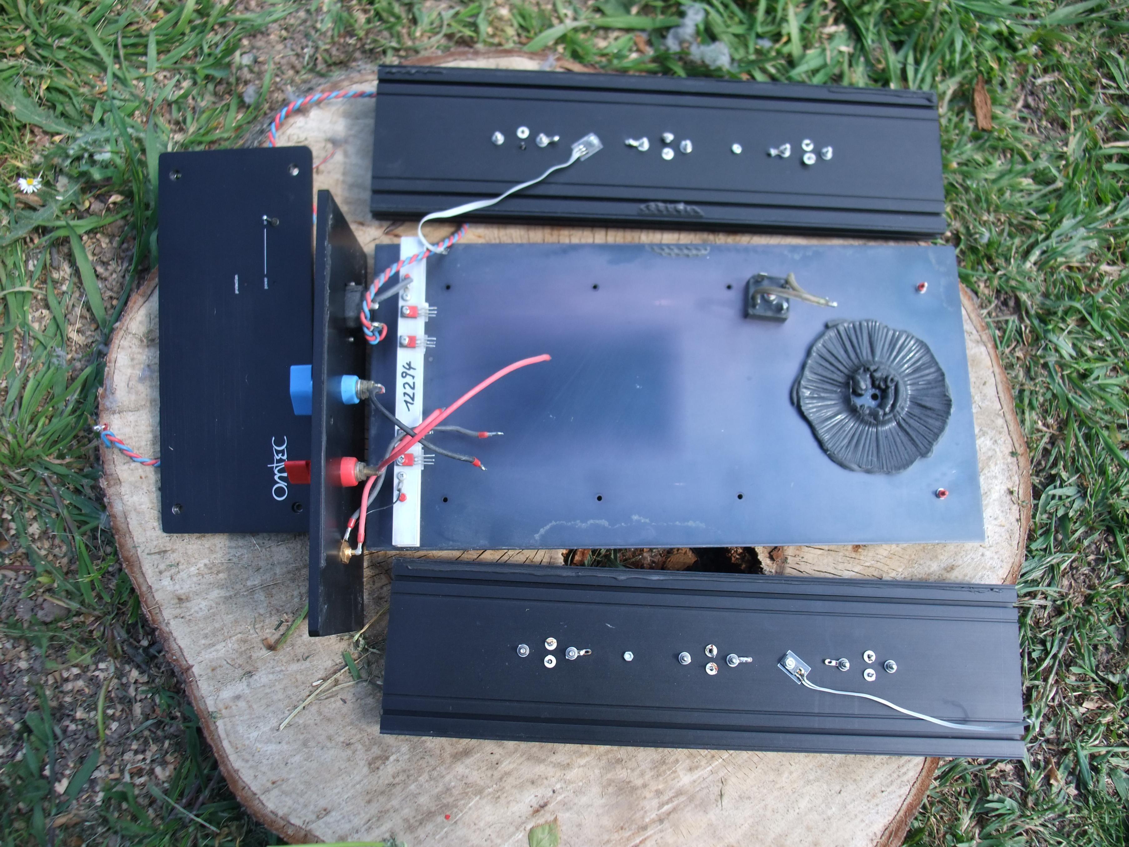

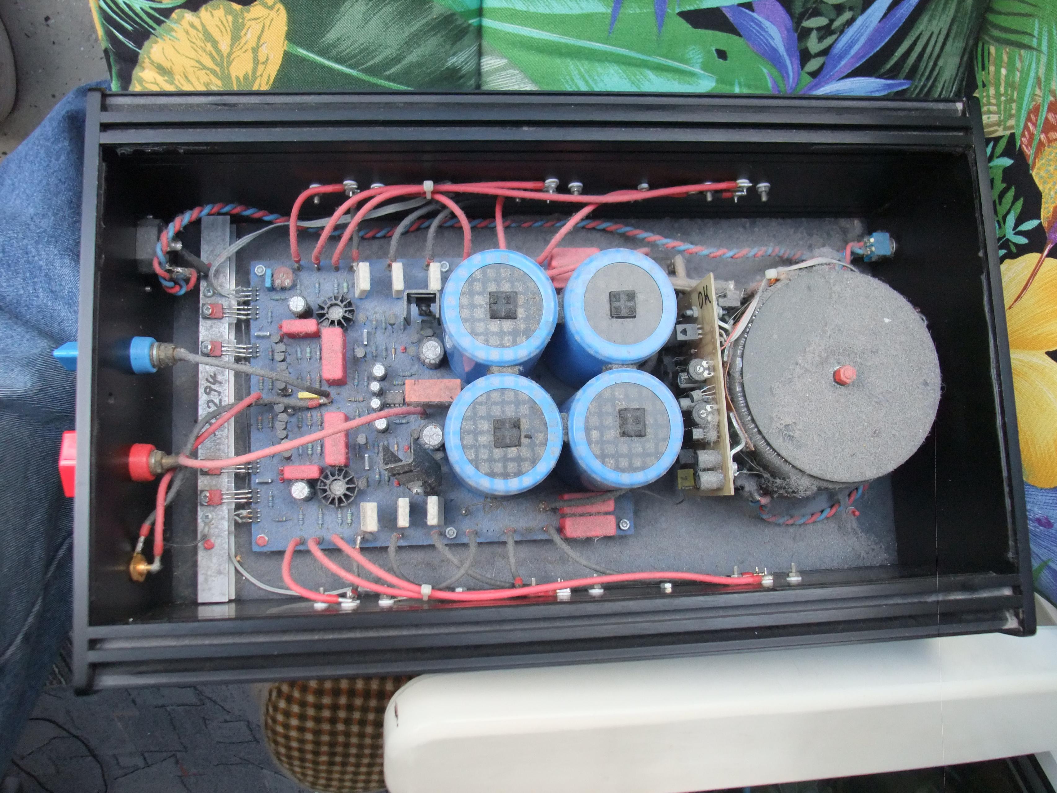

The power mono amps arrived. Some pictures:

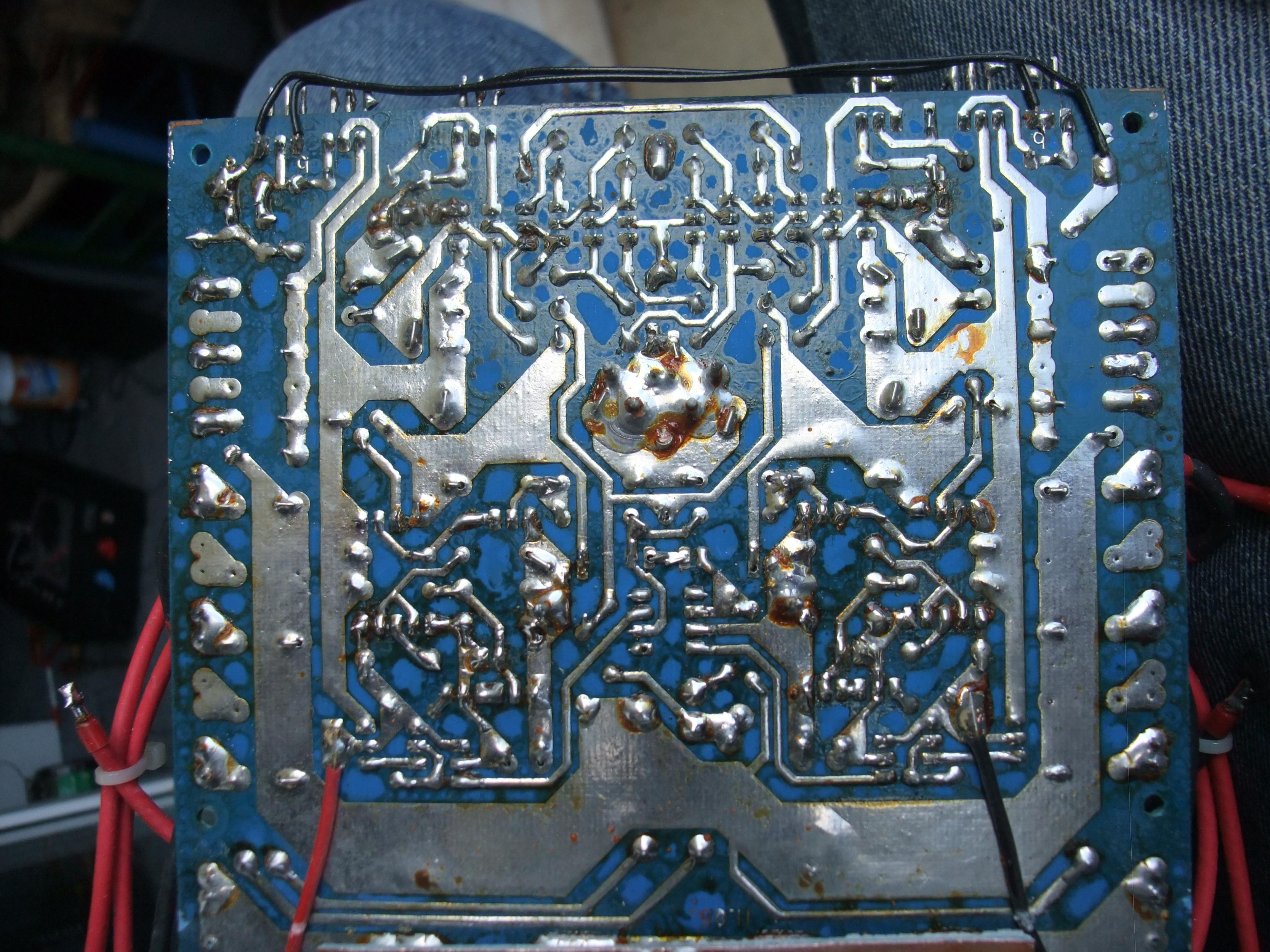

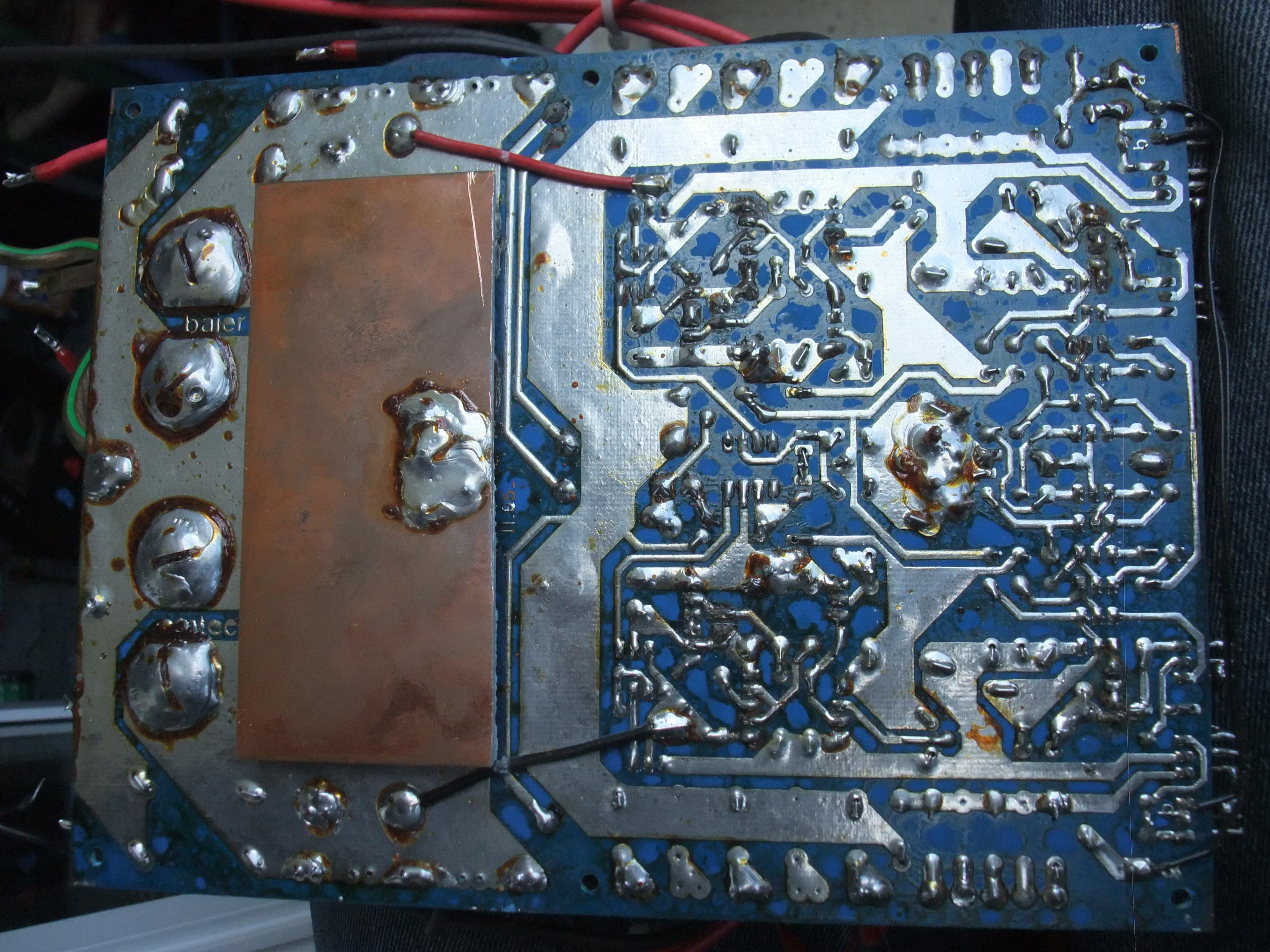

more pictures PCB solder side

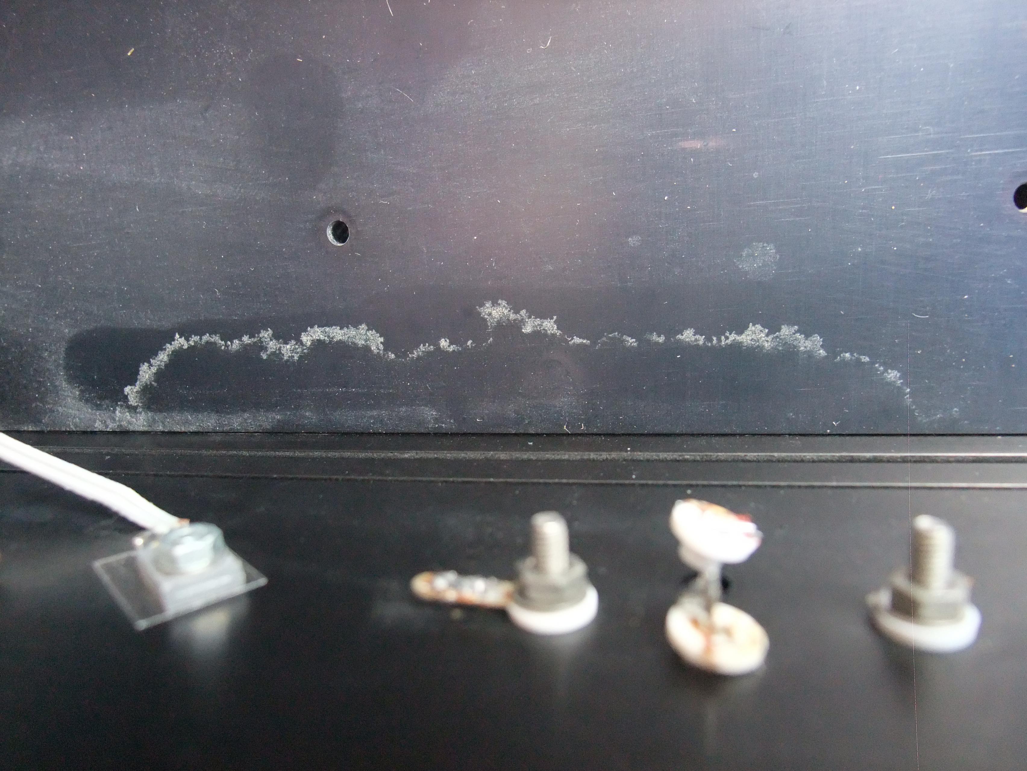

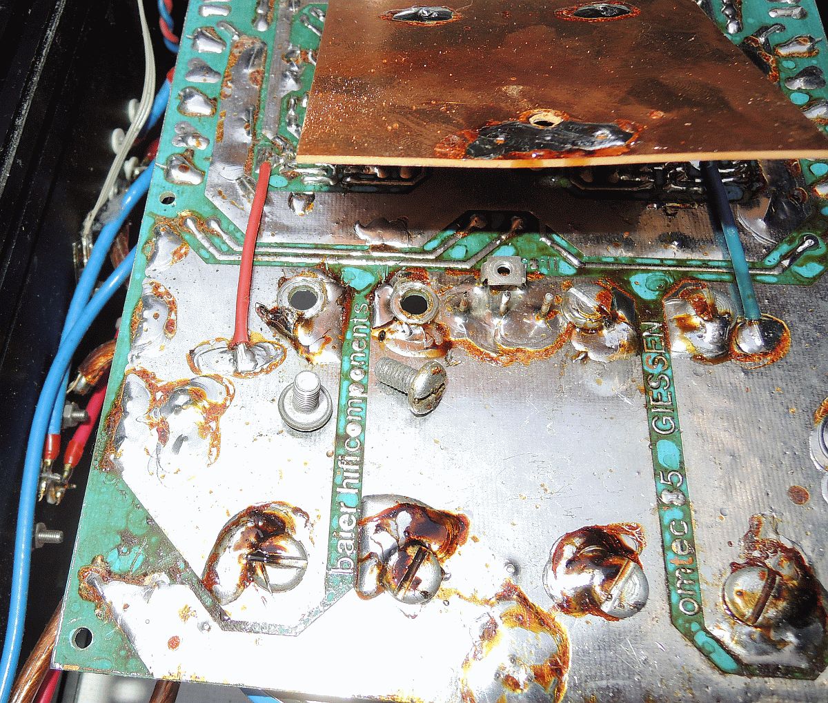

PS:
I own CA-25s, too.
New caps might be a good idea - just in case you'ld like to share some info...

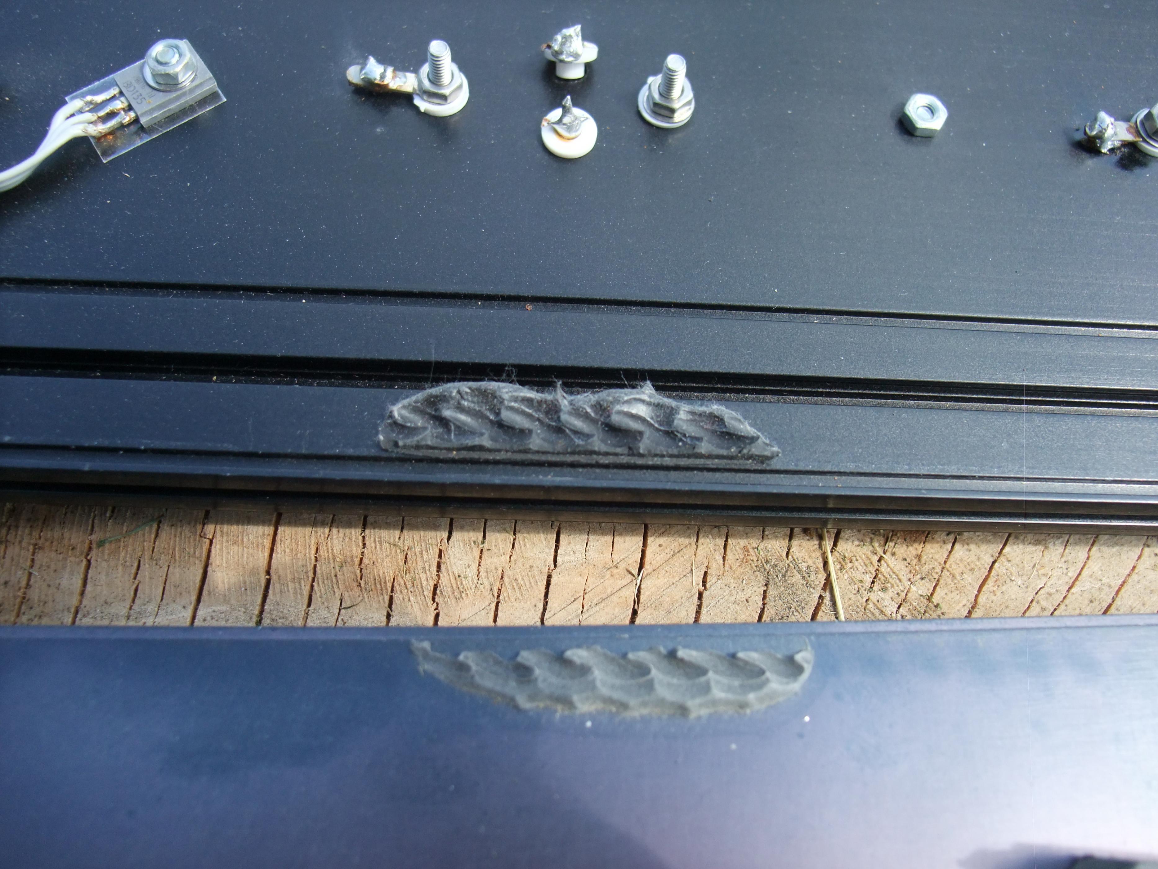

A while ago I had to re-solder the cap screws...
good informations - thank you very much.
If I look to your picture, I guess, there is a special soldering tin for soldering the aluminum terminals of capacitors in use.
Therefore the follow question rises up:
What is the best way to solder aluminum together with copper ?
in this case also this thread is of interest:
http://www.diyaudio.com/forums/solid-state/137753-outsider-mono-power-amplifiers.html

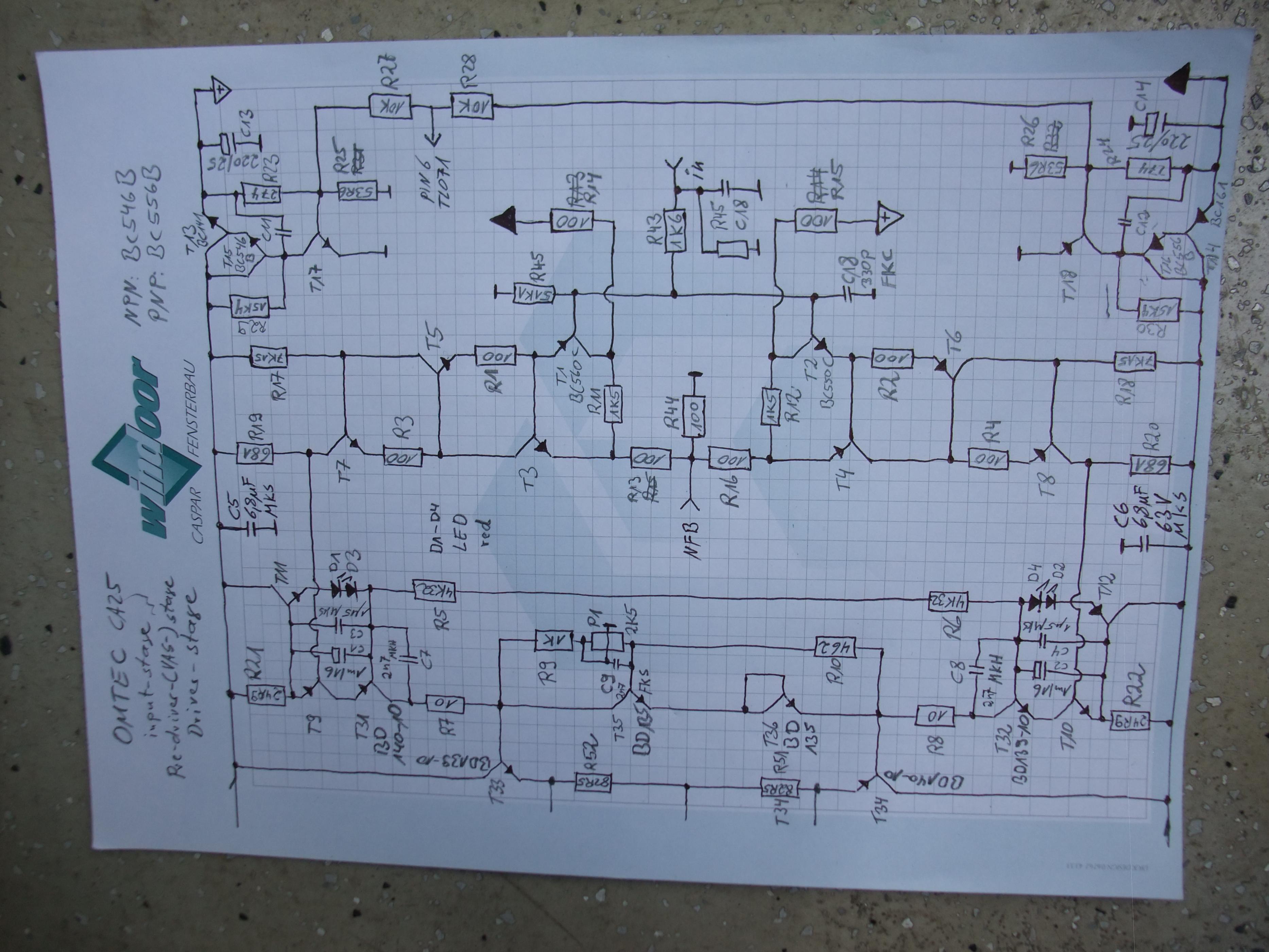

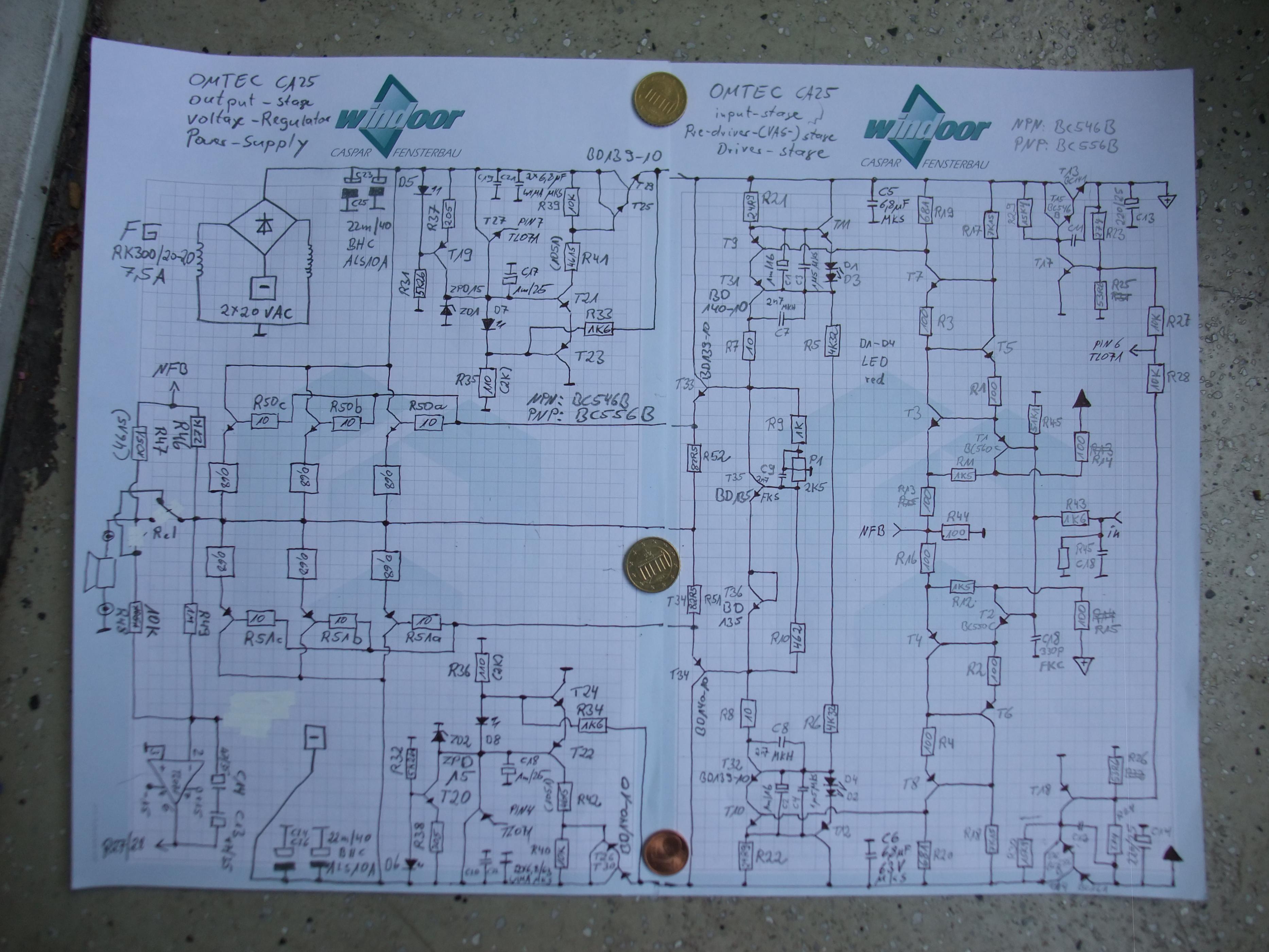

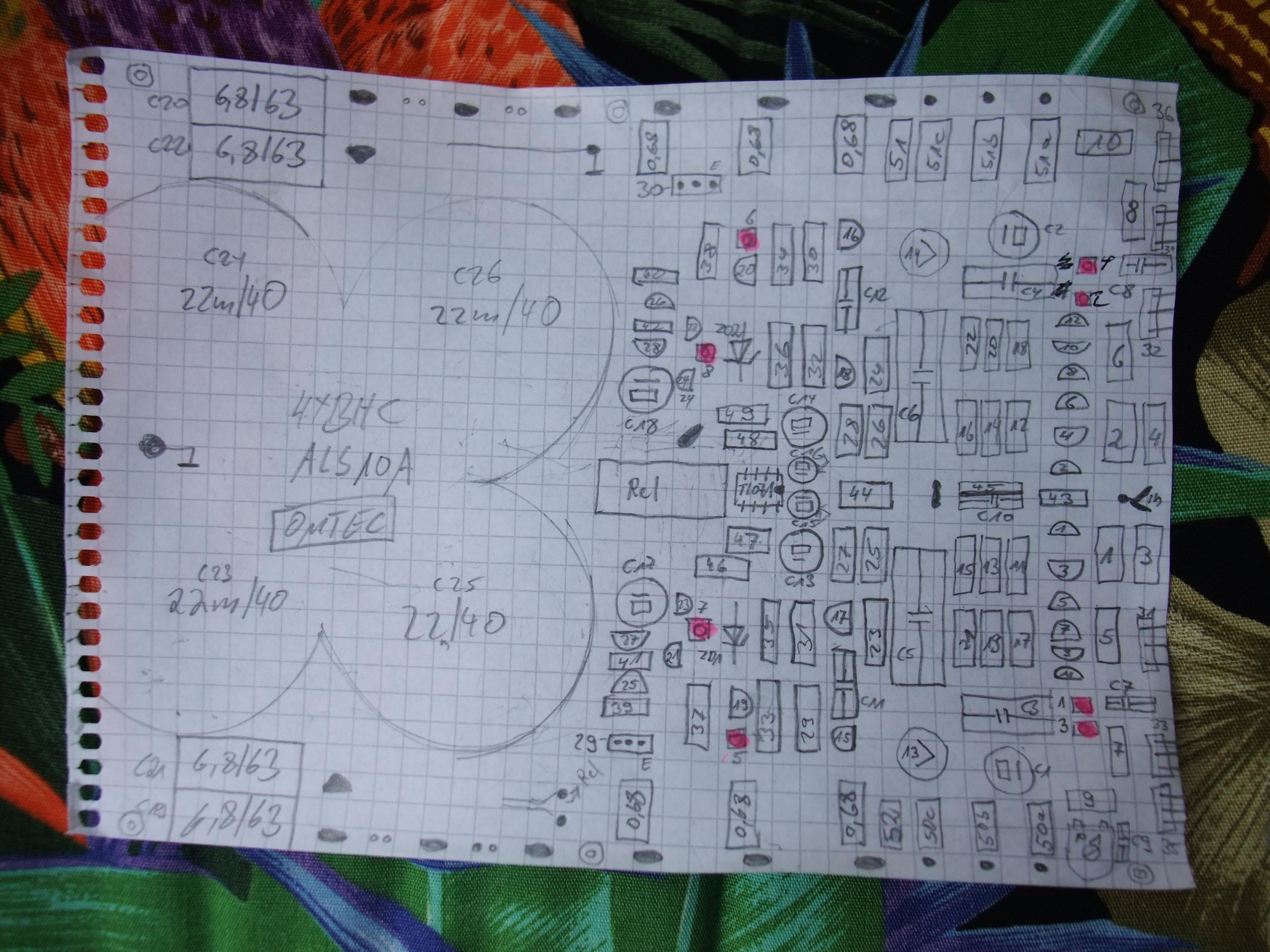

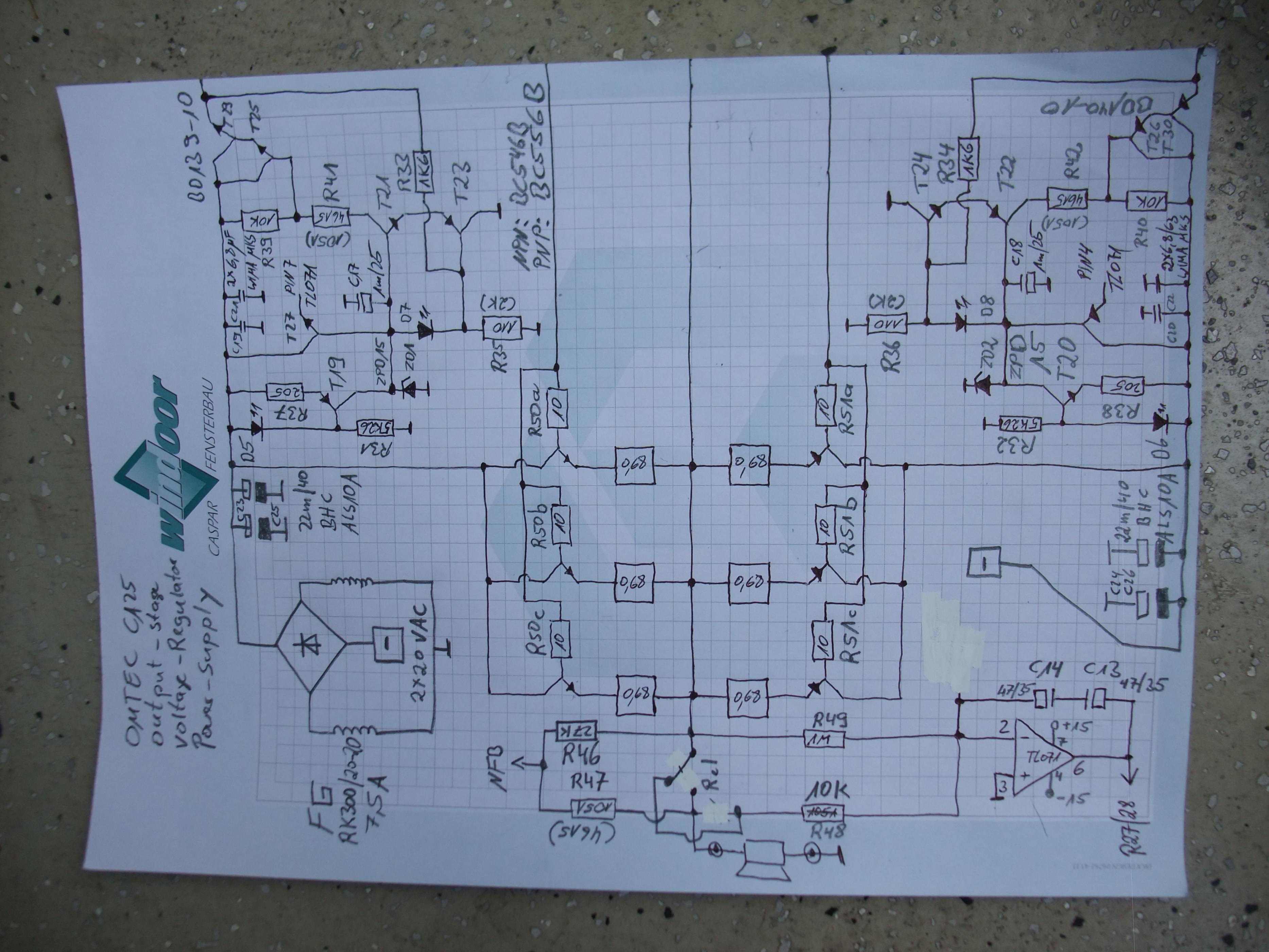

Omtec Mono Power Amplifier "CA 25" (CA25) - Schematic Diagram
Please note: In the schematic from the images are probably still many errors.
About error hints, I am happy of course.
Information on current flows and voltage values will follow soon.
Yes, I think so, too. But this isn't a good solution due to excessive heating of the internal connection of the caps. Caps with srew terminals instead solder terminals are not make for solder.It appears from the pic, that the soldering is to steel capacitor mounting screws - after tightening. Are they really aluminium screws? I doubt that any soldering to aluminium would be used, as it is usually quite difficult and likely would void the capacitor warranty.

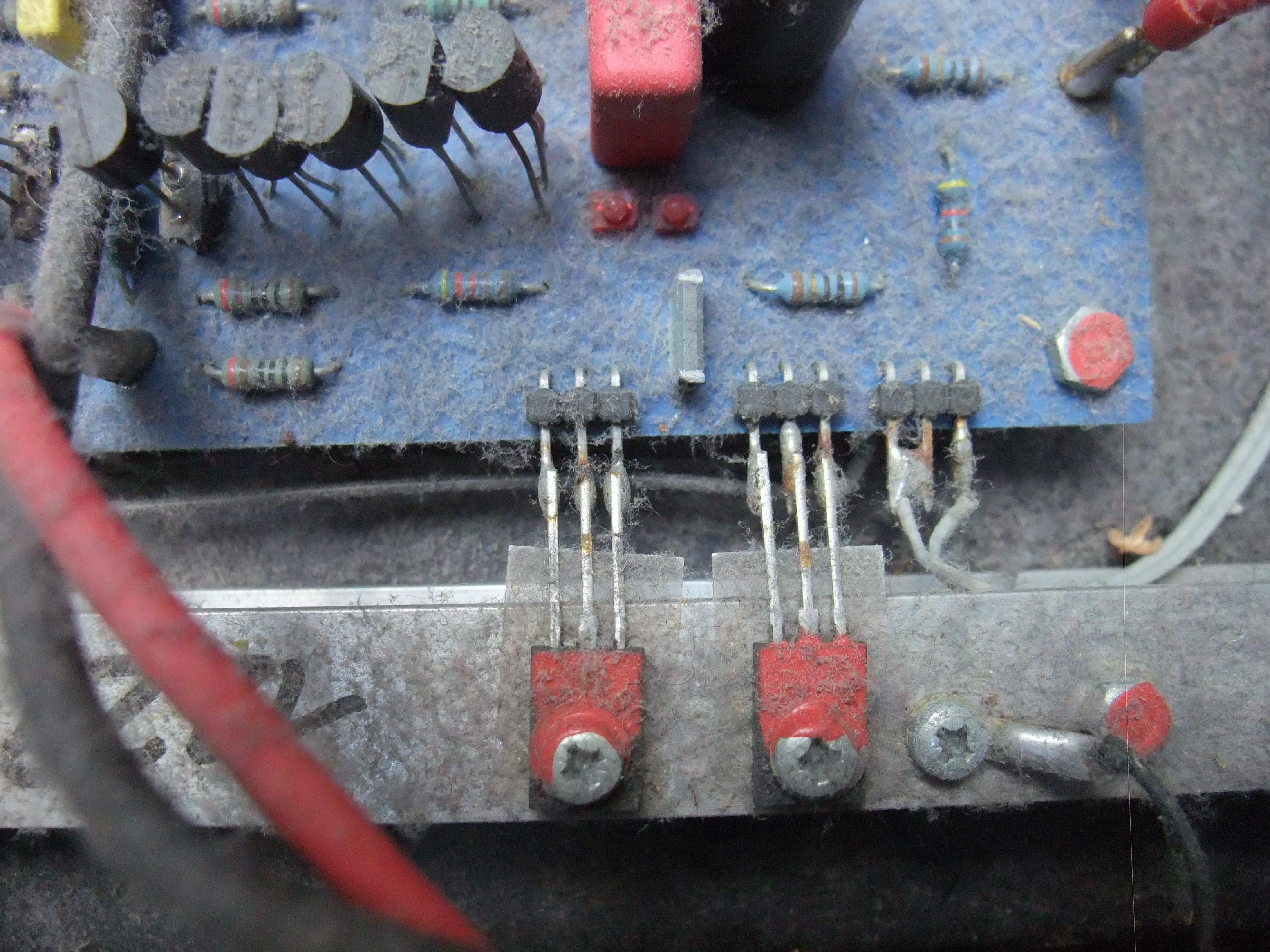

Both mono amp devices are now in working condition. Idle current at the darlington output stage on both devices is 1250mA and very stable, i. e. both immediately after switching on and after the warm-up phase nearly the same value.
But one observation confuses me:
from the in parallel mode working darlingtons are great differences:
the lowest value is 195mV and the highest value 334mV (voltage measured at the 0,68 ohm emitter resistors)
This is due the Ube voltage tolerances - so I think. Am I right?
Which influence does have this to the sonic quality?
Next time I will upload the updated schematics.
yes, the values are little different (between 676 and 683 mR). But to little for the observated variation at idle current.Normally one would expect equal current through those resistors.
Sound quality will most likely be degraded in case of different currents.
Have you checked the 0r68 resistors for having the same value?

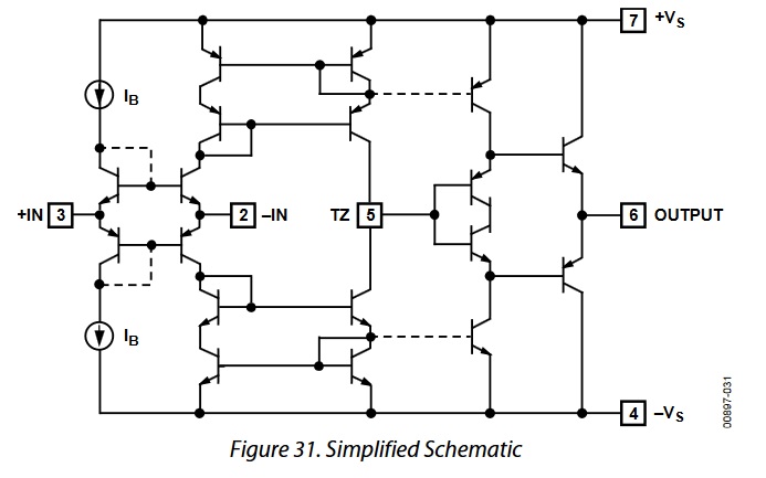

Hi Andreas,
I took a look a the schematics. It provides regulated voltage for VAS and input. And has a servo that ensures correct offset.
The VAS is cascoded, but the cascode voltage is modulated.
But I do not understand the input stage. Could you explain it please? I would like to understand.
I try to understand and explain. Please correct me. I'm NO EXPERT. I just want to learn.
My idea of how it could work:
"T5 and R1 form a constant current source.
T1 is a emitter follower working on the constant current source.
Therefore, base of T7 is on fixed voltage.
T3 together with T7 is a cascoded input amp. The feedback is current feedback on the emitter of T3.
The DC balance is done by shifting DC of the emitter."
The Input stage is a heavily cascoded symmetrically realized buffered current feedback input stage, which couples into a high linearity push pull current mirror ("VAS").
If you take a look into classic CFB-OPAs like AD844 or AD846 you'll see very similar circuitry.
The basic topology is the one of a transimpedance stage (input + mirror) and a power buffer.
