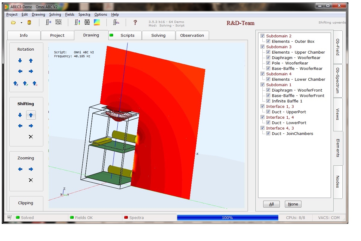

BEM, has arrived

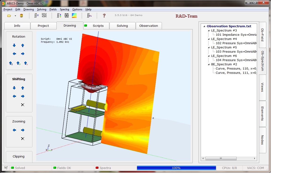

It was a bit of effort, but I can finally use ABEC's BEM engine to simulate the sound fields inside and outside a speaker. This tool will be used to refine the design. I'm still checking the port outputs, its the issue I have with pressures from ABECs LE engine as well.

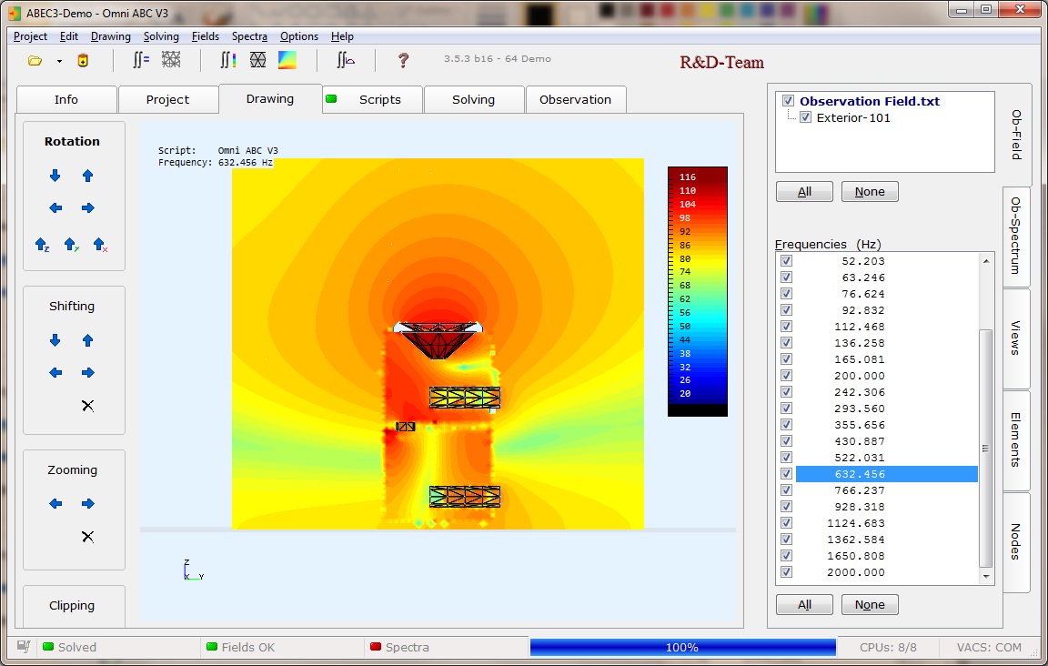

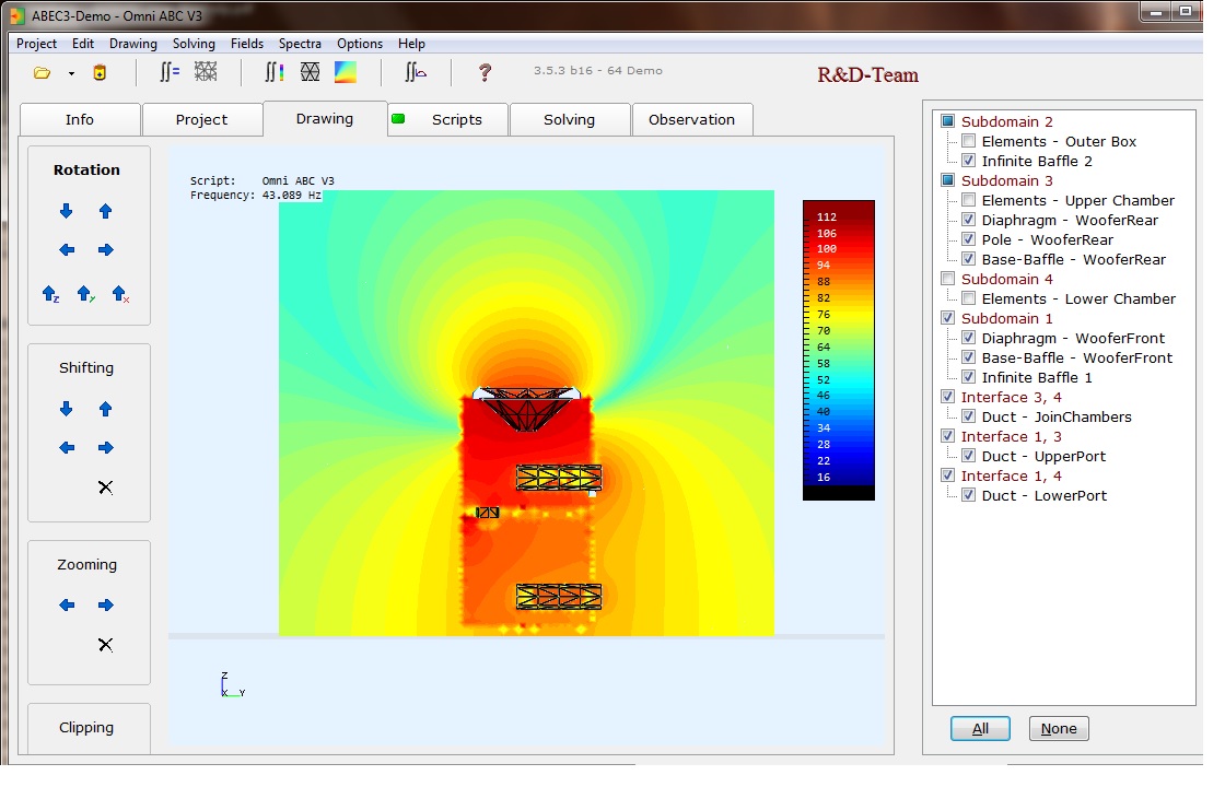

The pics below are for the ABC cabinet only. You can see how the sound gets more directional as the frequency increases. First pic is 40Hz, the second is 1KHz.

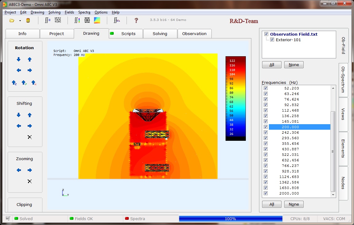

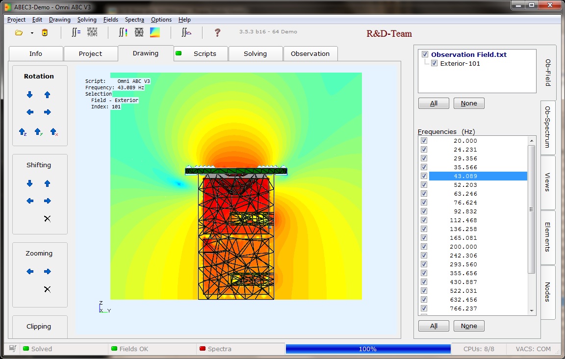

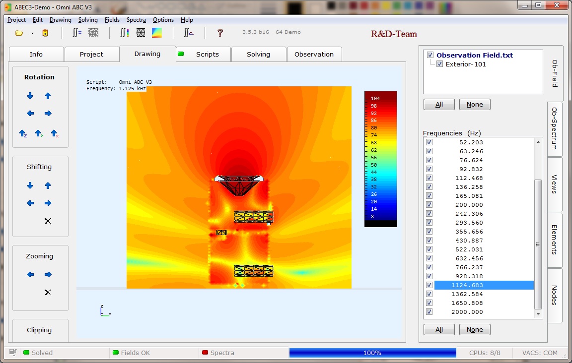

Improved BEM sim, internal pressures
I finally got the internal pressures working properly the following pics are the base cabinet internal and external pressures. The cabinet detail has been removed and just the driver and ports are visible so you can see the internal and external pressures as the frequency increases. The pics are [43, 200 632, 1125Hz].

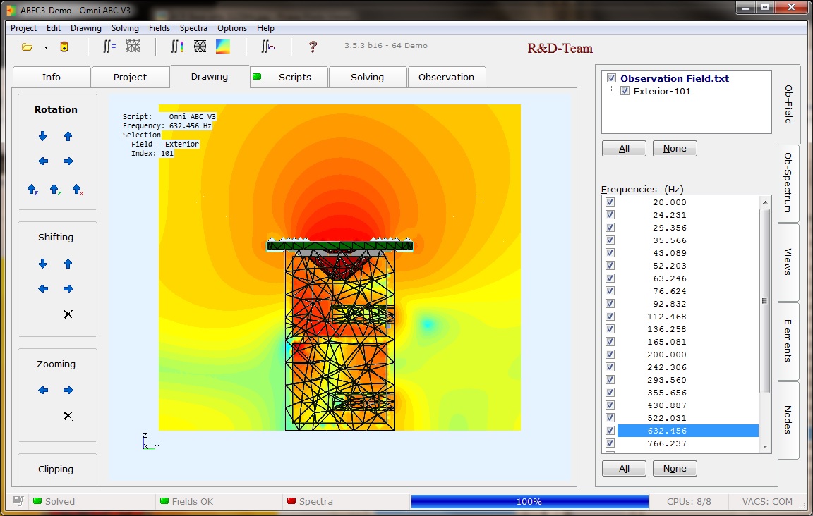

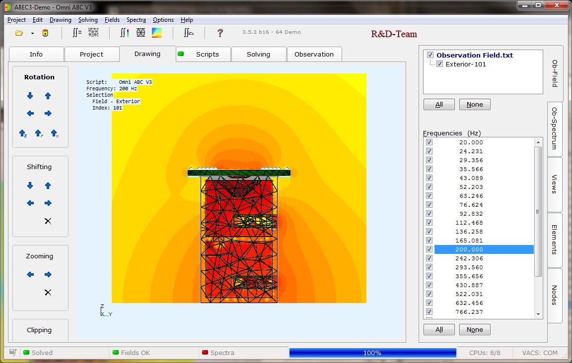

Adding the lower disc
This is with the lower disc (40cm dia x 2cm baffle) added. Its the same freq. shown above, only a 40cm disc is added. Compare the graphs above with these.

In short, it divides the shape into many small surfaces and volumes (elements) to determine how sound pressure moves across them (boundaries). It's solving 1000's of simultaneous equations (Helmholtz integrals). The last sim has 2300 "elements".

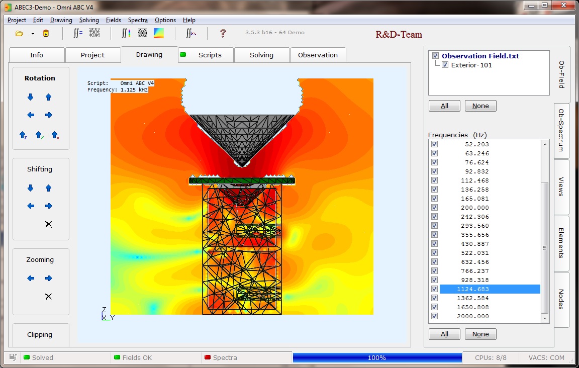

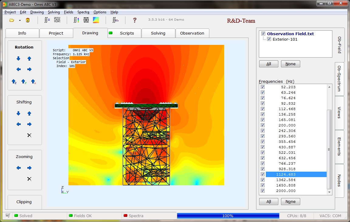

What happens when a reflector gets added?
This is a conical reflector, mine is actually curved. So next step is to look at importing CAD files. However there is benefit, I've only shown the 1125Hz where it becomes more apparent that its adding to the lateral pressure.

Yes, this is a simulation. I have also taken actual measurements using a mic, these sims explain why I was seeing + measuring multi-lobe pressure variations as I moved the mic up and down the outside of the disks. The variations tend to disappear when you get combined output at 1m out.
