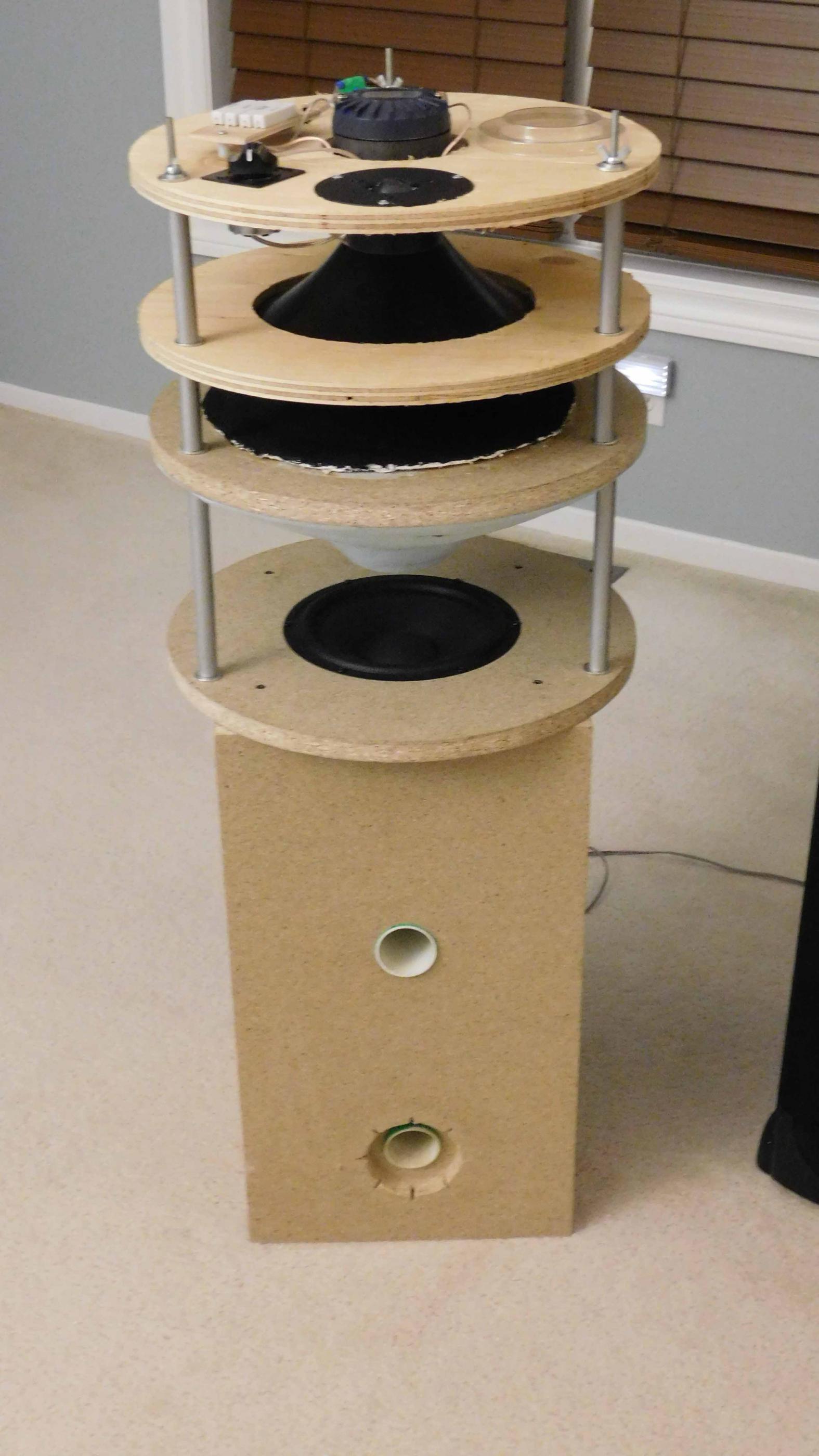

Interesting suggestion. The domes are directional with frequency, having reasonable wide cone at low freq (120deg@2Khz) and narrow cone at high freq (30deg@15Khz).If you put some sort of barrier so that up-firing tweeter doesn't radiate forward, what you then get is only the treble that's arriving at your listening position via the ceiling and maybe some walls - this gives the arriving wave energy a certain delay that should dramatically improve the 'spaciousness' of your sound - look up 'the Romeyn' sound that's based on the work of that speaker guru (plus other things audio) Floyd Toole.
A barrier would cause reflections or scattering near the dome. However the proper shape could focus the sound much like a parabolic sound dish for listening. Only it would be used in a reverse sense, trying to focus the energy at the reflection point. I need to think about this one

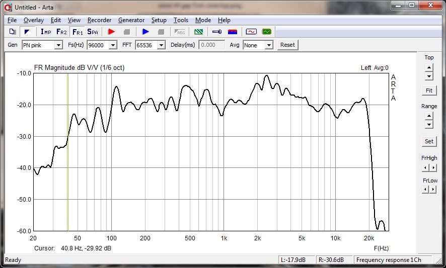

Aperiodic Bi-chamber Bass improvement
After listening to them for awhile, I decided to improve the bass response. The current 16L BR response is weaker than I like and seems to start fading at 100Hz although its F3=60Hz.
I'm restricting the volume to 32L so the design choices were ApBc, BP4, or BP6, there's not enough room to fold a quarter wave horn. The Aperiodic was just easiest, as I already have split the volume and have 2 x 16L chambers. All I needed was to join the chambers with an internal port and then port out the second chamber. So total of 3 x tuning ports (2x external 5x17cm, internal 12x2cm).
The results match HornResp simulation and I get response to 40Hz with an 8" woofer. In fact its +10db higher than the BR at 40Hz. Its an audible improvement. This ApBc also has a dip at 175Hz in the near field measurement. The graphs below at @1m with room acoustics.
Interesting speaker!
How does it sound? The stage is OK when you sit at best LP?
I have an idea for the tweeter horn, I will draw something to explain soon.
It sounds good and it surprises people when they see the shape and listen to them. You can walk around the room and get good spacial sound from both speakers nearly everywhere. There's even a few special alcove spots where the reflections can mislead you (like acoustic fun house mirrors). The better position for stereo phantom image (using L+R ) is anywhere in the "sweet line" (not a spot) between the speakers about 2m back and at least 1m from the back wall.

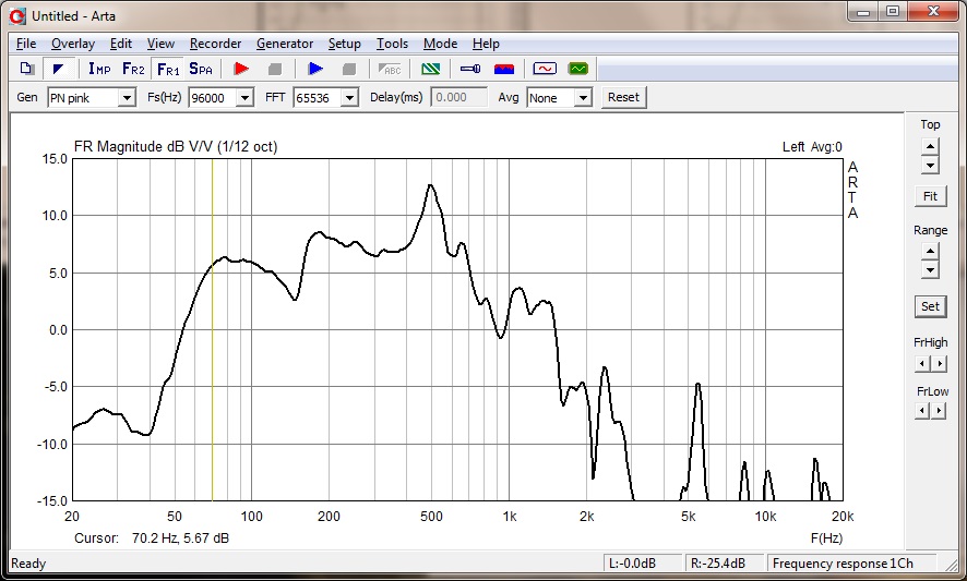

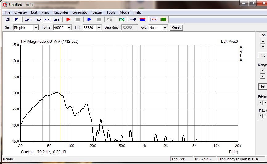

Aperiodic Bi-chamber (ABC) whats that bump?

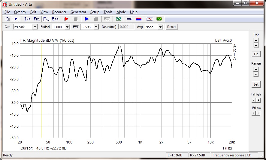

Early when I tested this, I liked the bass extension but I noticed an inflection point at 175Hz that is not like a Bass Reflex dip. So I remeasured both the nearfield driver, and both ports. Sure enough its still there, so are these artifacts at farfield or is the combined response better.
You can see the graphs [front view, driver near, top port, bottom port, speaker farfield] that the driver and 2 ports combine to remove the bump at 175Hz. There is no evidence of the 175Hz defect at farfield (@1m with room acoustics).

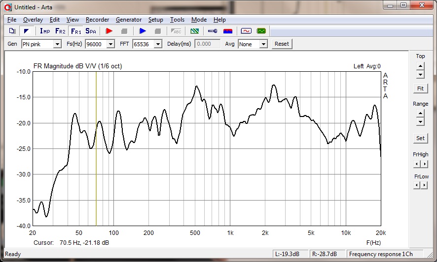

Does more stuffing (damping) help in ABC
When I was trying to remove a bump in the bass response I also tried various amounts of stuffing to see how much I could shift or smooth the response. The bump was never removed, didn't need to be, it was compensated by port(s). However I did get some results from damping in an ABC
Graphs below are @1m with room acoustics. Over several attempts with polyester fill I did manage to eek out a couple db. Nothing major, and I did not see a downside.

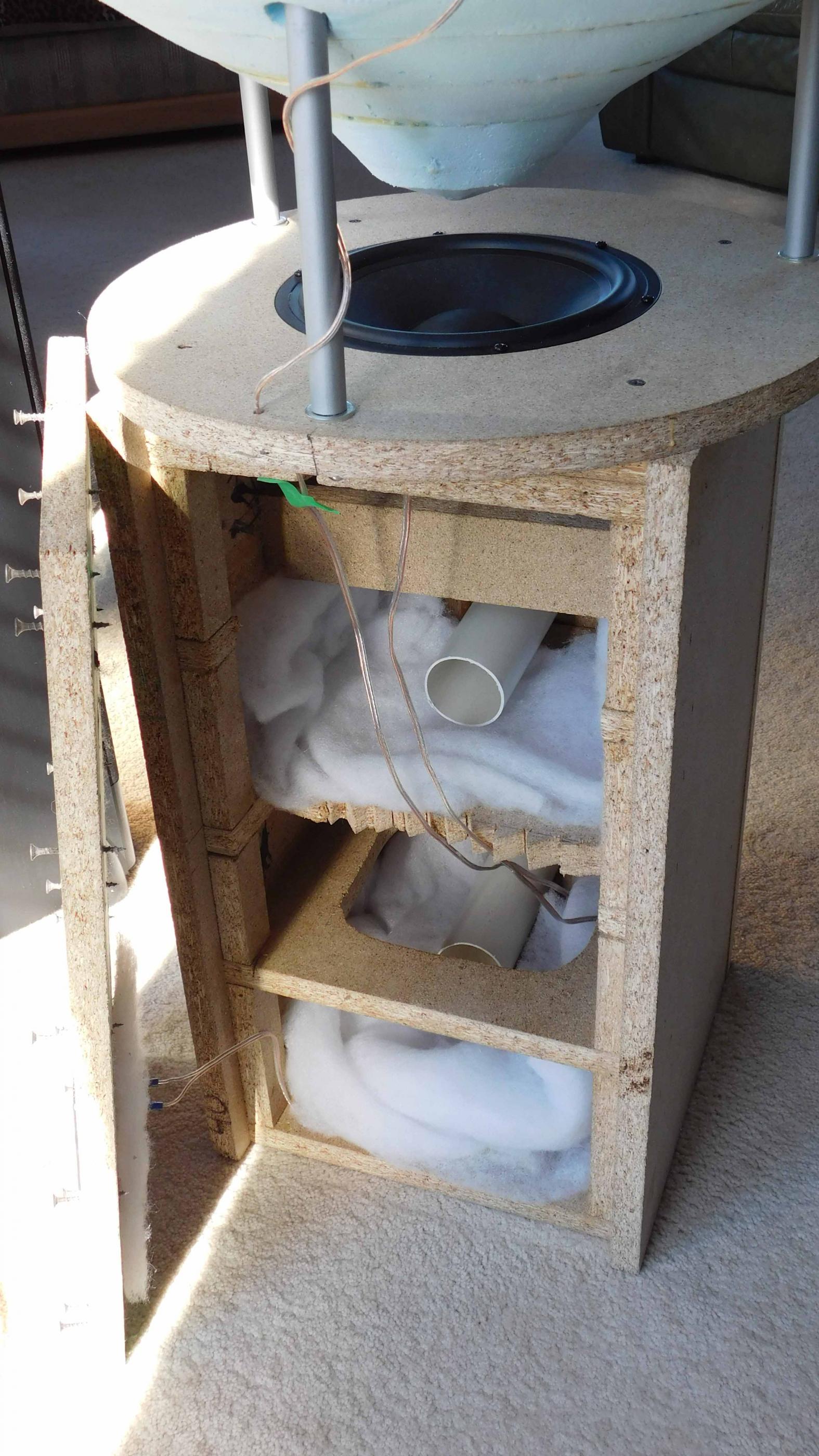

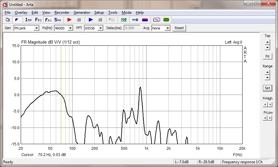

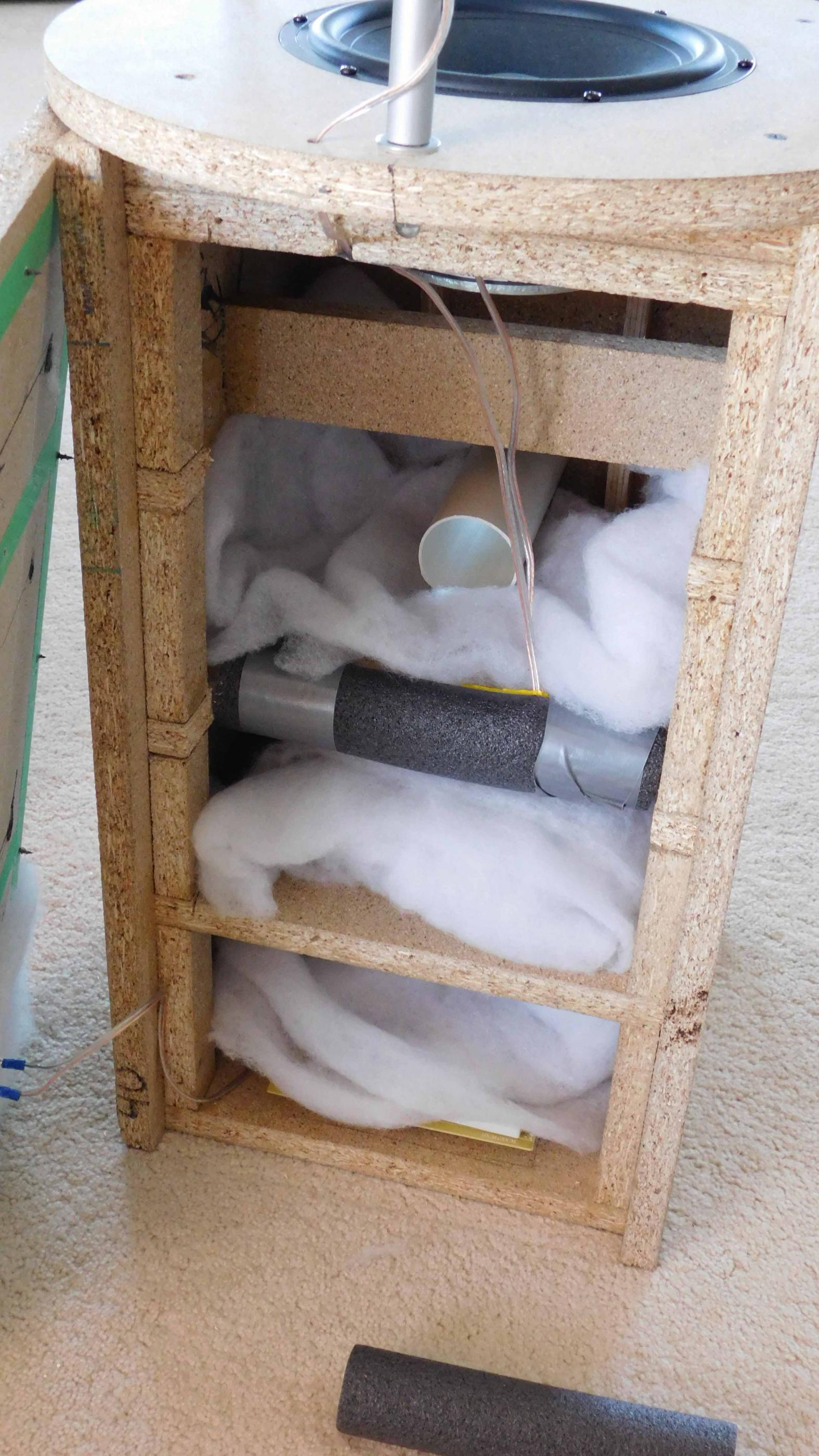

Don aren't the bi chambers usually separate but joined together with a vent of the same size as the ports?
Your picture looks like a reflex enclosure with two ports.
Have you taken an impedance measurement to see what it looks like and if it drops where you want it tuned to?
The top port looks to have a lot of high frequency stuff getting through unless that is leakage from the driver itself?
The port connecting the chambers is that square 24cmx5cm (by the black middle foam) as a cutout. You can tune using all 3 ports depending on what you want. In my case I already had 2x16 chambers so that drove the tuning. Cutting the back rectangle passage was the easiest. It's still a sandbox, and the effect still works, and it matches HornResp Sim. The 175Hz blip is exactly where it should be, I just didn't understand why.
The top chamber noise, I believe is interaction between the driver cone the reflector cone above it. It seems to have gotten worse when I reduced the height of the lower cone (used to be more pointy). This was lower when it was a simple 16L BR using just the top chamber and more "pointy" reflector.

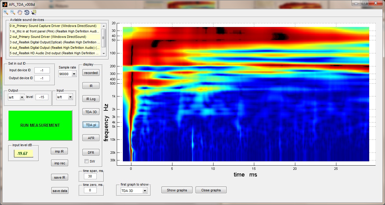

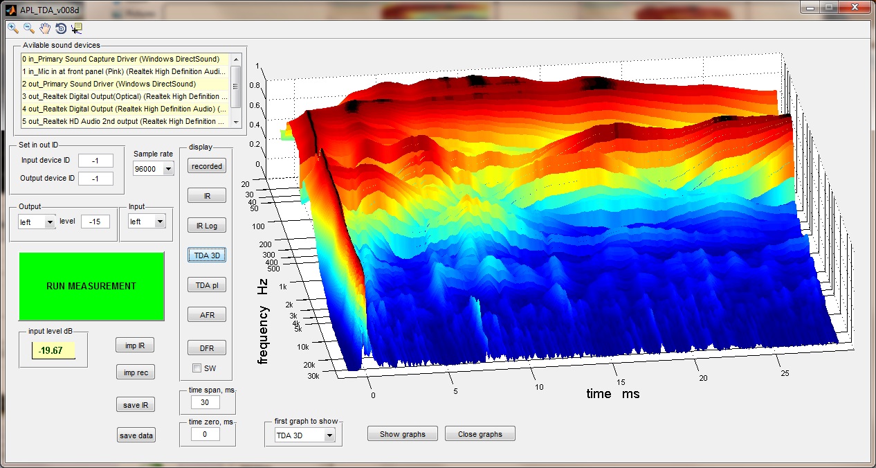

APL_TDA

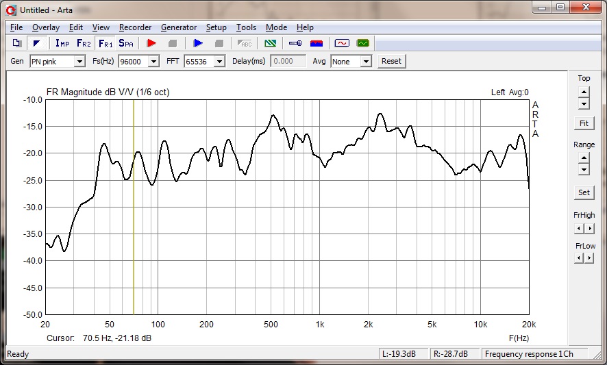

This was a suggestion from Wesayso, http://www.diyaudio.com/forums/mult...design-soundstage-imaging-14.html#post5032808 in another thread to run a program (APL_TDA) that plots the freq content vs time trying to determine the incident wave and its reflections. It's a very interesting idea.
Below are 2 plots (3D and 2D) for one omni that uses ABC and its at my standard measuring position @1m amp@-25db as a baseline so I can compare it to existing FR plots.
Note : ignore all content below 50Hz, my PC requires 6 fans that run constantly and are throwing LF against a back wall. In the FR plots you can see this as the "LF floor" that does not drop as fast as it should.
