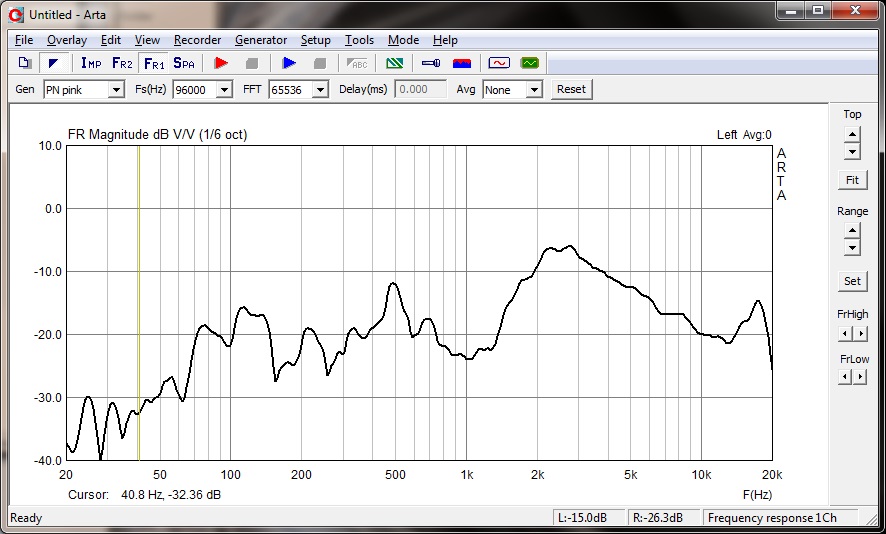

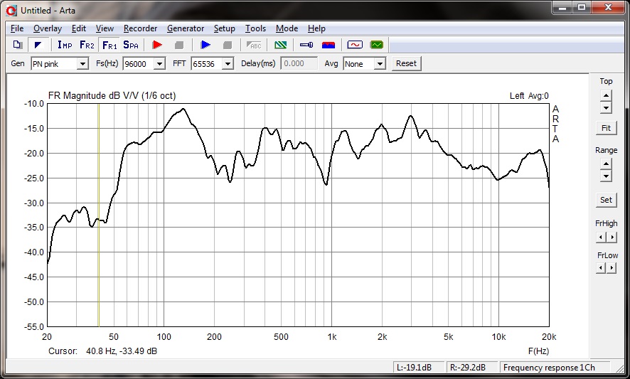

Waveguides and compression driver - baseline driver test
I have Dayton 10" circular wave guides and Fane CD130 drivers to fix the HF issues. This is a quick test to see if they work and if they're consistent before the woodworking starts. I have a few other things to take care of, so actual mounting and reflector test results in 3-4 days.
Now they are loosely sitting on the top on my cabinet as I test and listen to them. They have a different sound compared to dome tweeters so my ears are still evaluating them. The circular waveguides have none of the "honk" or "harshness" of the rectangular horns I've heard, so I'm happy with that.
They are extremely efficient, and are 15-20db above my 90db woofer. So the drivers work as advertised 106db/w with these waveguides. Off axis is similar to dome tweeters, they are still good at 30deg but they fall off at 60deg and become more directional at higher freq. The response is clean down to 1.8KHz (probably lower) but hve a dip at @10KHz, and something I'll check into later. Both my waveguides and drivers are virtually identical in performance. Graphs provided.

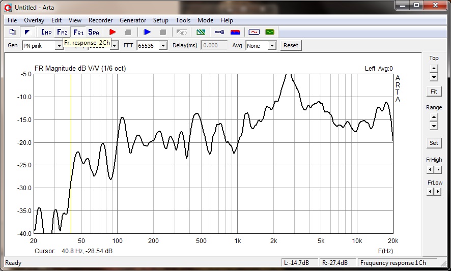

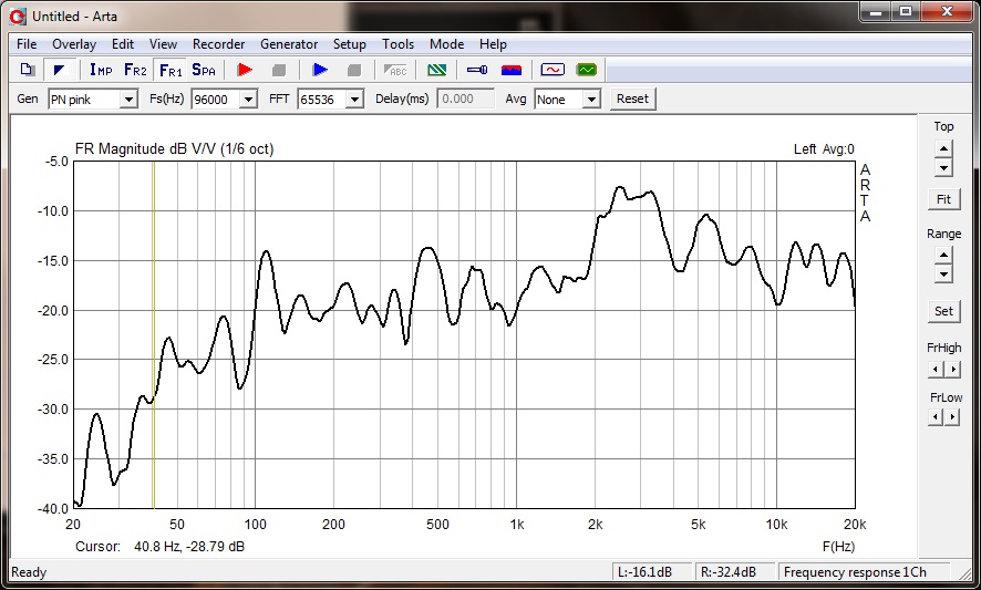

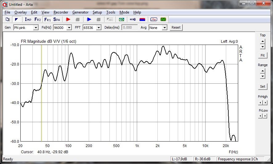

Coaxial waveguides as a HF reflector
This suggestion was "Originally Posted by anji12305 : I wonder if you could achieve this HF dispersion pattern with two identical waveguides "nested"?

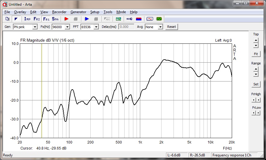

Well, it does work, thanks anji12305. I tried this with different edge to edge waveguide spacings [5cm, 10cm, 14cm, 18cm]. My preferred spacing is between 5-10cm as the curve most ressembles the original baseline waveguide curves. Going too close (<5cm) with a 2cm polystyrene cone cap will actually suppress output from the waveguide. So spacing effects the response curve's frequency dependent attenuation and smoothness. I'll try different shape reflectors to see if I can go better (smoother) than coaxial waveguides.
The compression driver and waveguide still have the expected -8db path loss from a reflector and levels are still about +5db higher than the woofer levels. This would be easy to fix with L-pad attenuation and a bit of equalization at 2.2Khz. The graphs include room acoustics and are measured at 1m out at mid top-middle disc height.

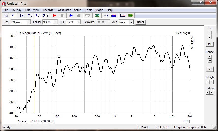

It sounds pretty good. Huge improvement over a dome tweeter and conical reflector.
Unfortunately I only have 2 waveguides and they're both on the left side now. So the right has a direct firing silk dome that does not match well with a waveguide.
At this point, for listening I use an equalizer to flatten out the 2.2Khz bump and I drop the entire HF section by 6db to balance it out. Listening to Van Morrison, Into the Mystic now 🙂

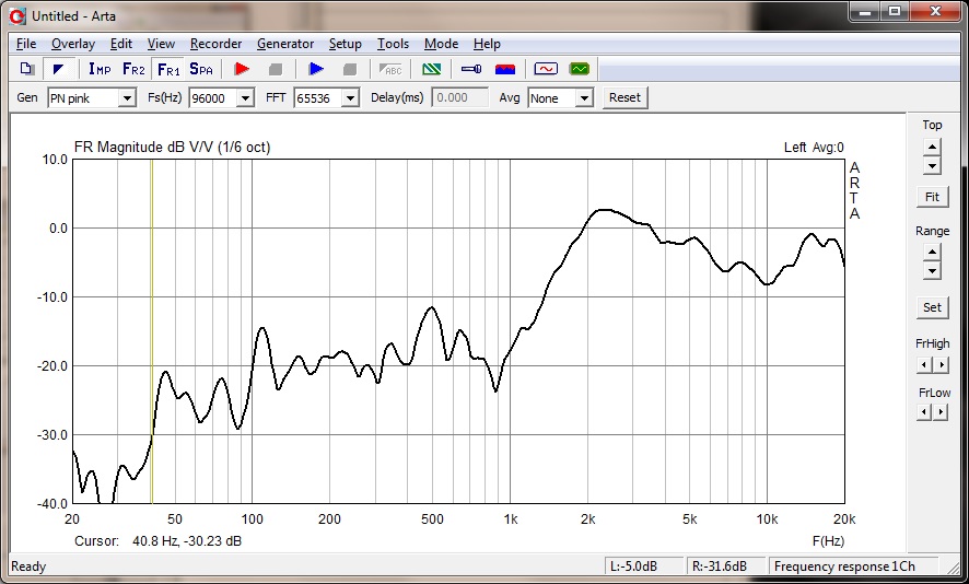

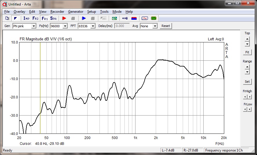

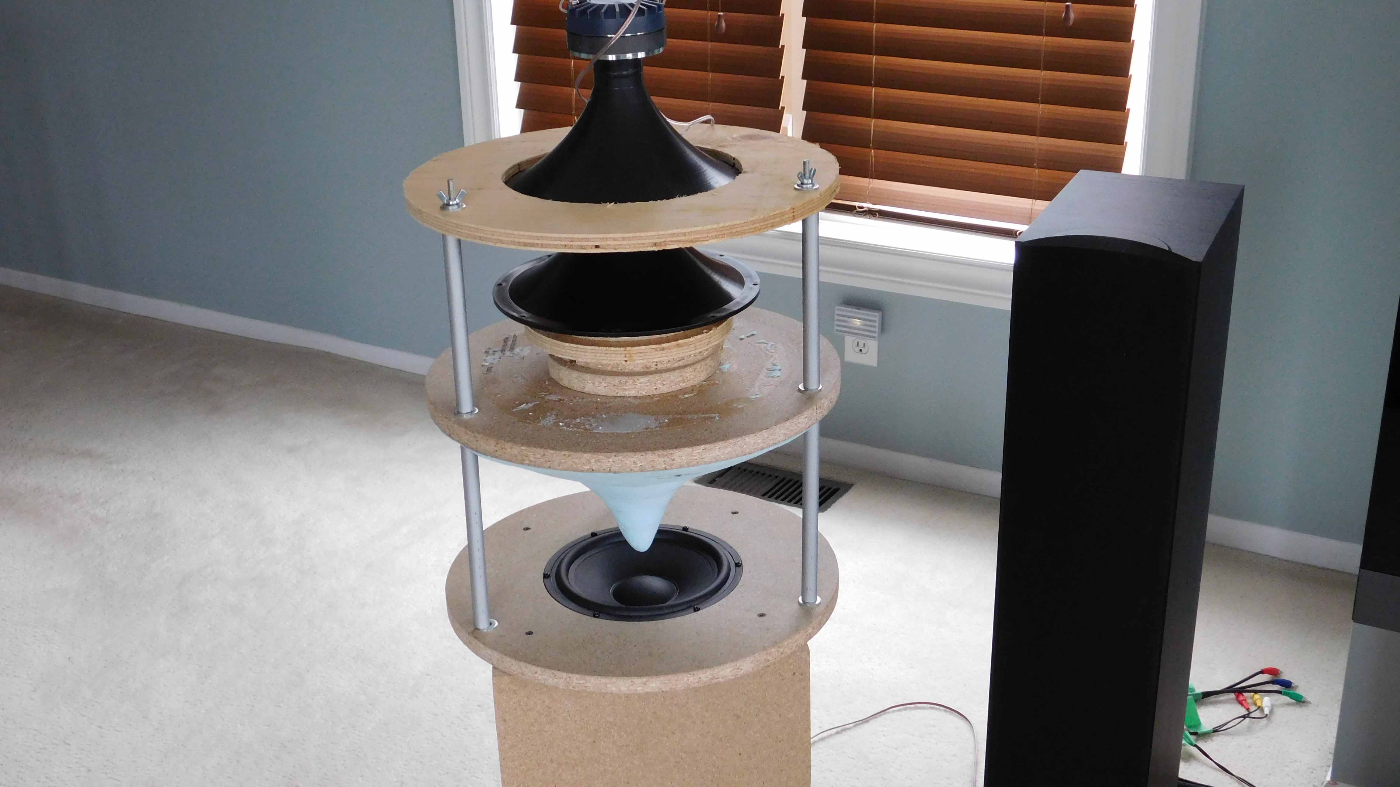

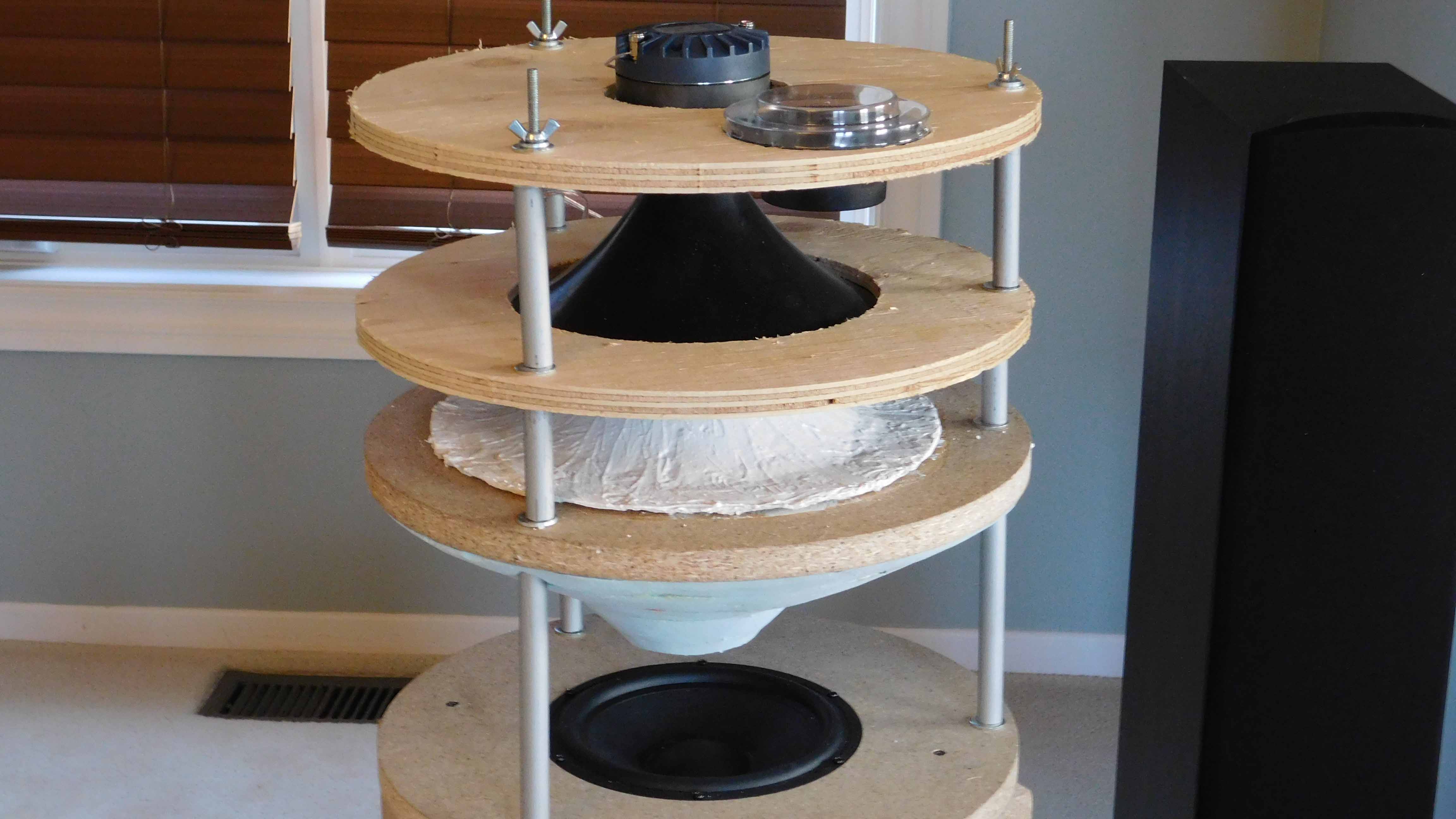

HF Waveguide extended and attenuated
It occurred to me that moving the waveguides closer together just creates another waveguide with a different flare factor. Its no longer a reflector. I've also unsuccessfully tried a HF reflector cone but it experiences the same high freq attn problem as the dome experiments.
I didn't have enough waveguides, so I made more. A plastic bag, paper towels and some plaster to copy the existing waveguide. The plastic bag left some wrinkles, I'll sand out later, but it works fine.
The CD power is reduced with a 5.5R series resistor. It also seems to take down the peak at 2.2Khz. The entire speaker stackup height can now be reduced. The polar response is even enough for evaluation. The measurements include room acoustics.
The additional new layer (disc#4) holds a Dayton DC28 that was on hand. Its in in preparation for making this a hemispheric radiator where the tweeter will reflect off the cathedral ceiling. Its pointed straight up.

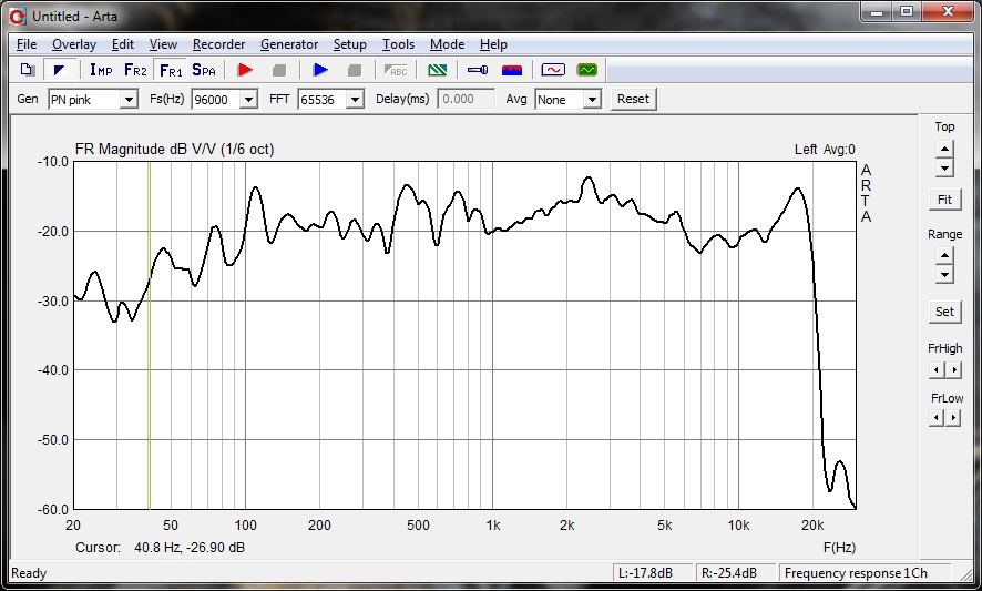

Hemispherical

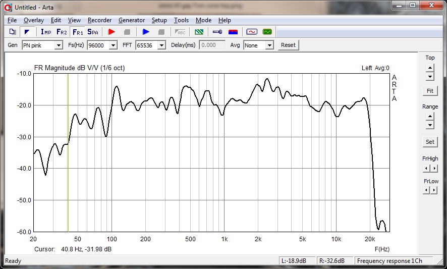

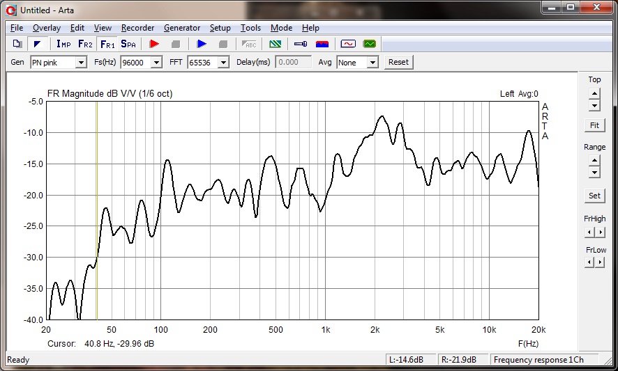

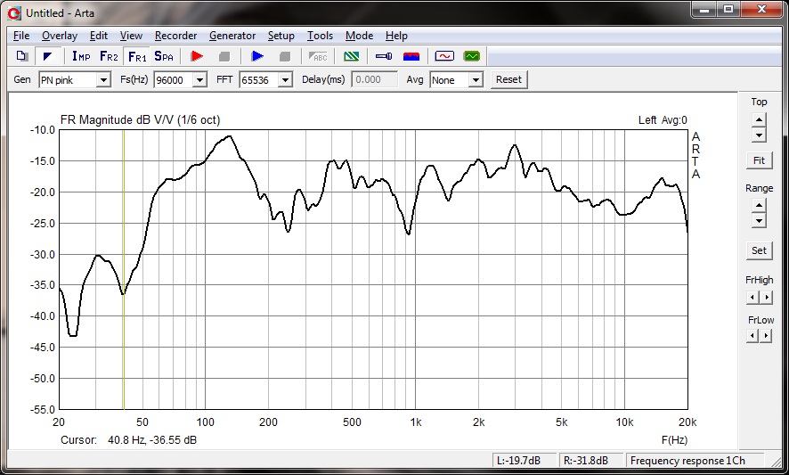

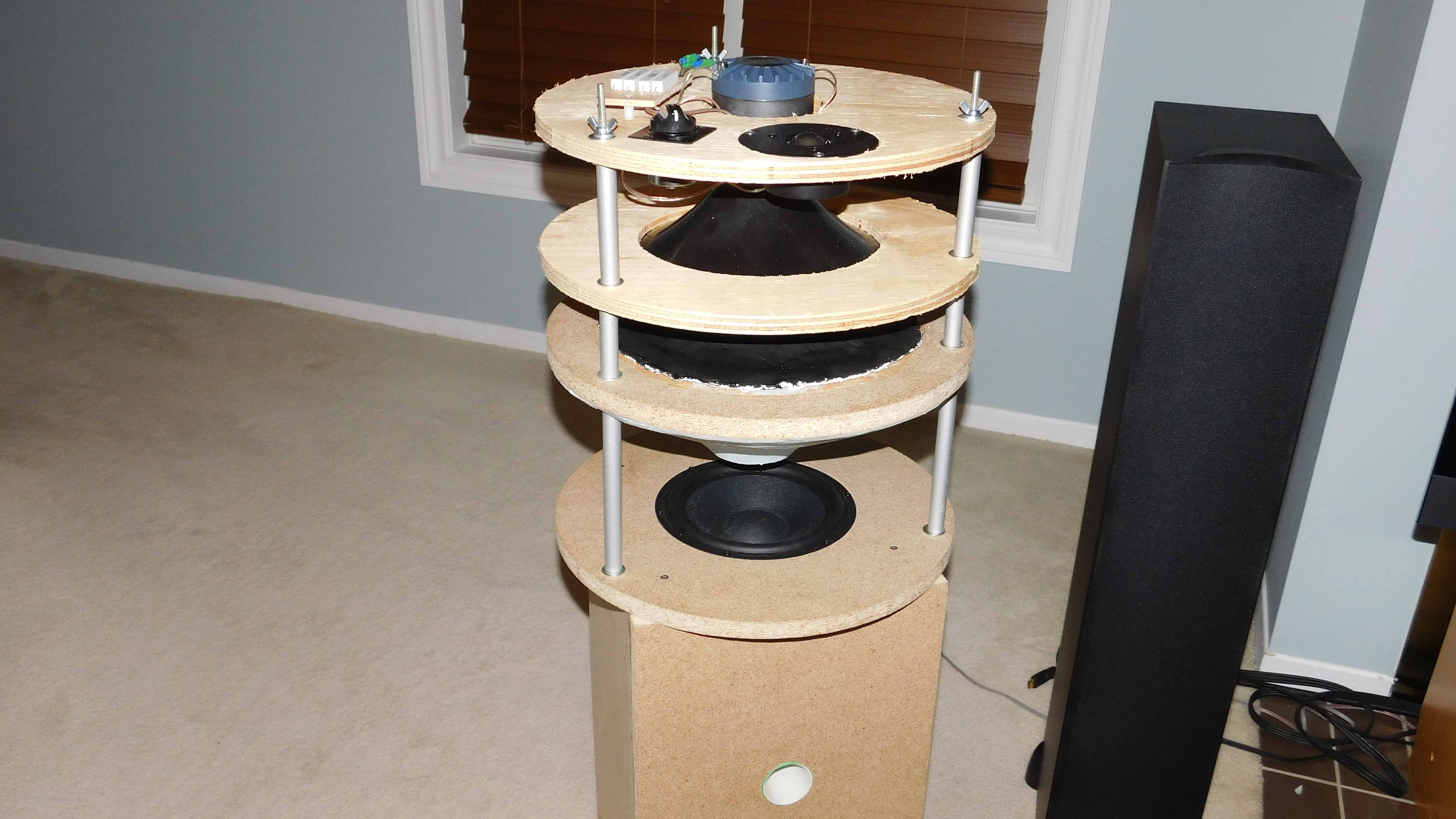

I added attn resistors to balance the waveguide, added the Dayton DC28F back to reflect off the ceiling, and added an L-pad to control the volume directed at the ceiling.
I've include my std measuring position with no/all volume directed at the ceiling. It only makes a 2-3 db difference but you can tell when its on. I've also included a listening position at 2m with both speakers driven. Again the dome tweeter aimed at the ceiling only adds a few db. I prefer it on, as it the sound seems more spacious.
omni L&R at listening 2m amp-25db full ceiling refl.jpg131.3 KB · Views: 132
