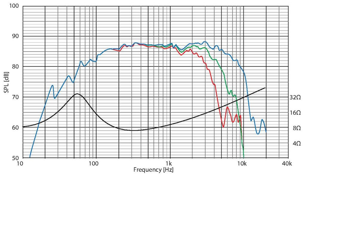

Parameters don't mean much without a waterfall plot from a sweep [ A stage I haven't reached yet] because without such information you don't know what the shape of the response is.
But experience with old woofers tells me that as the frequency gets higher the response slowly drops off and at a certain frequency that is often at a rate of 6 or 12 dB per octave. 6dB per octave is a first order response; 12dB per octave is a second order response, 18=3rd 24 = 4th etc
Look at the picture of the Frequency response of the little Vifa I use. That smooth roll-off at the top after 3000Hz is a classic second order response, the sound drops off at ~12dB per octave. If you add a coil at about 3k then that slope becomes a third order approximately, steeper in other words. May people think that a second order response give a better sound/ better integration. Now look at the drivers response below 300Hz, a classic approximation of a second rder slope, now if you put that little woofer in a closed box which in itself gets you a second order response the slope than doubles to a 4th order slope. One of the reasons I like the driver so much as a midrange, it is so easy to use.
May older drivers from classic speakers have this second order slope at the top end, and this is why they work so well open and with no coil to limit the top end and why a single capacitor in series is all you need because the closed back of the tweeter already gives you that second order slope, the combination of the closed back and a capacitor is then giving you a third order acoustic shape. If you change the electrics of the XO to second order the slope changes to 4th order acoustic and you may have a hole in the response. This might need the XO frequency to be lowered and this may then be too close to the tweeters Fs and you really need to cross 2 octaves above Fs
You might get a better explanation from Steve if he responds because I am a beginner at this.

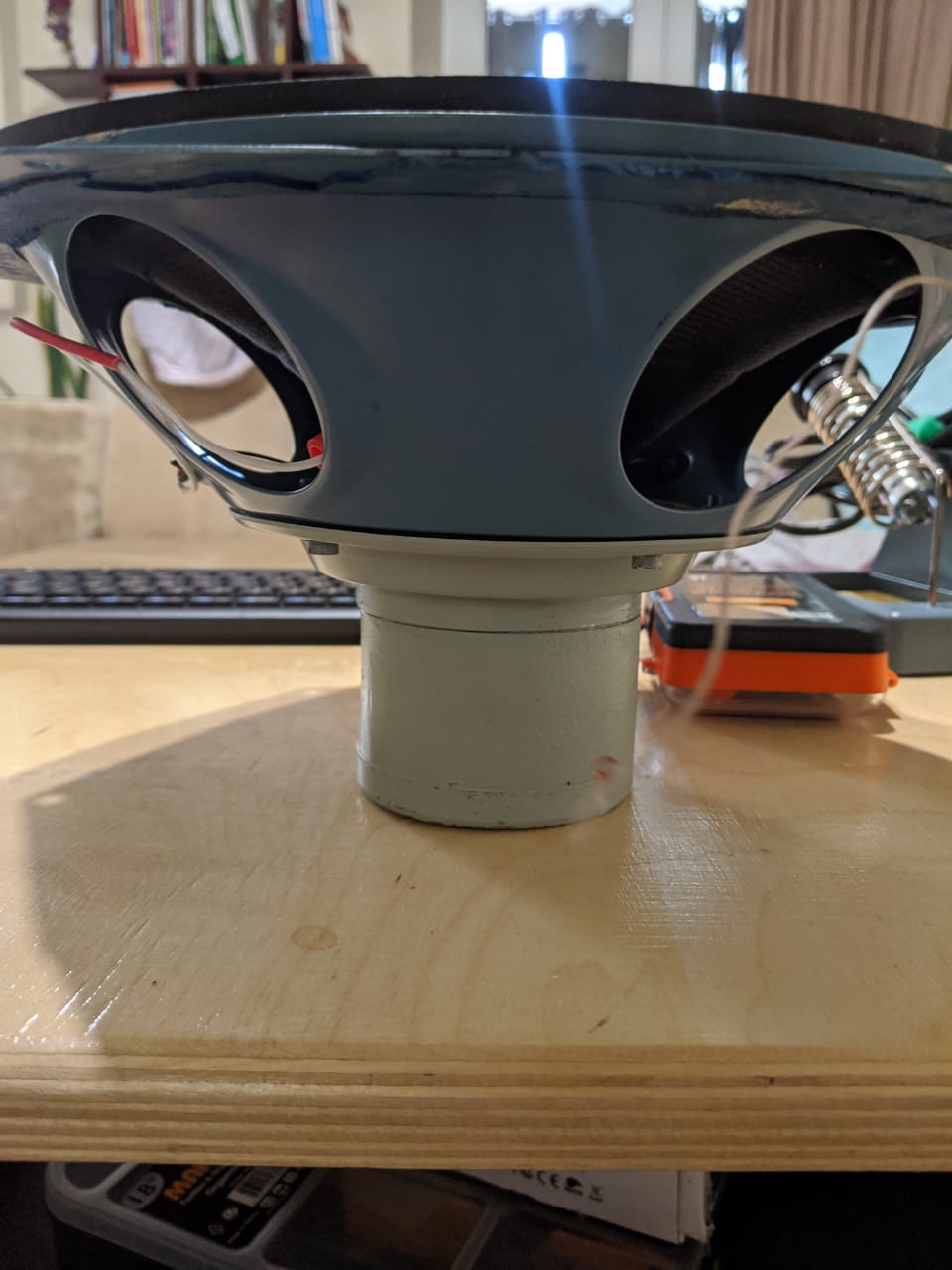

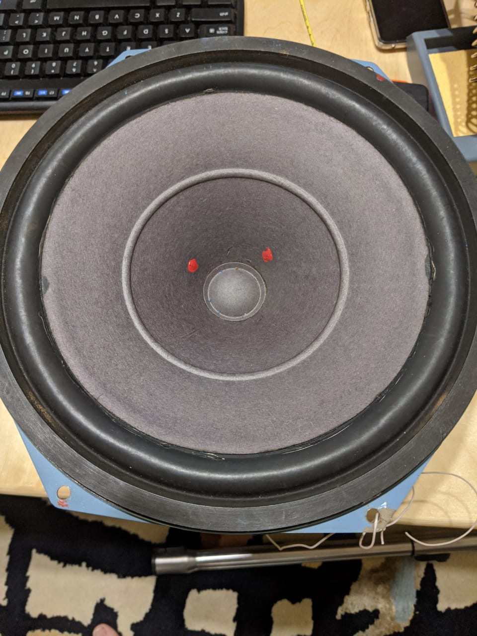

Anybody else here think this woofer was badly repaired a while ago?
I think that originally would have had a pleated paper accordion surround and from the size of the dust cap I suspect a VC about an inch in diameter
Late 1940's early 50's??
Don't know whether the surround is original or not, but this 'woofer' would be better described as a 'mid/bass' driver.
The driver's central area has been engineered especially to reproduce the midrange/low treble frequencies.
This driver is designed to be connected directly to the amplifier terminals and to cover most of the audible range. The tweeter supplies only the missing top octave or so, i.e. the very highest frequencies, via its 4uF capacitor.
Speaker systems like this did not have complicated crossover circuits. The idea was to throw as much sound around as possible and not waste energy in the crossover components.

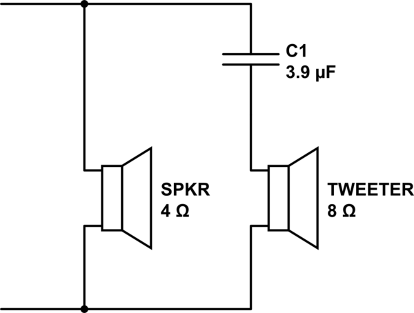

Just to confirm and to double check the 4uf cap which Ill obviously change is in series before the tweeter can someone link me to an example of how the capacitor is connected and to what? If the woofer is connected directly to amplifier then where does the tweeter connect to?
The tweeter is a 4 ohm tweeter according to DATs V3.
It seems the capacitor is connected to the number 2 which must be the negative with a wire from number 1 connecting to the wire from number 2. Is this series?
The drivers are wired as shown in the attachment (ignore the ohm values).
I would stick to this simple crossover in line with the original design intentions.
