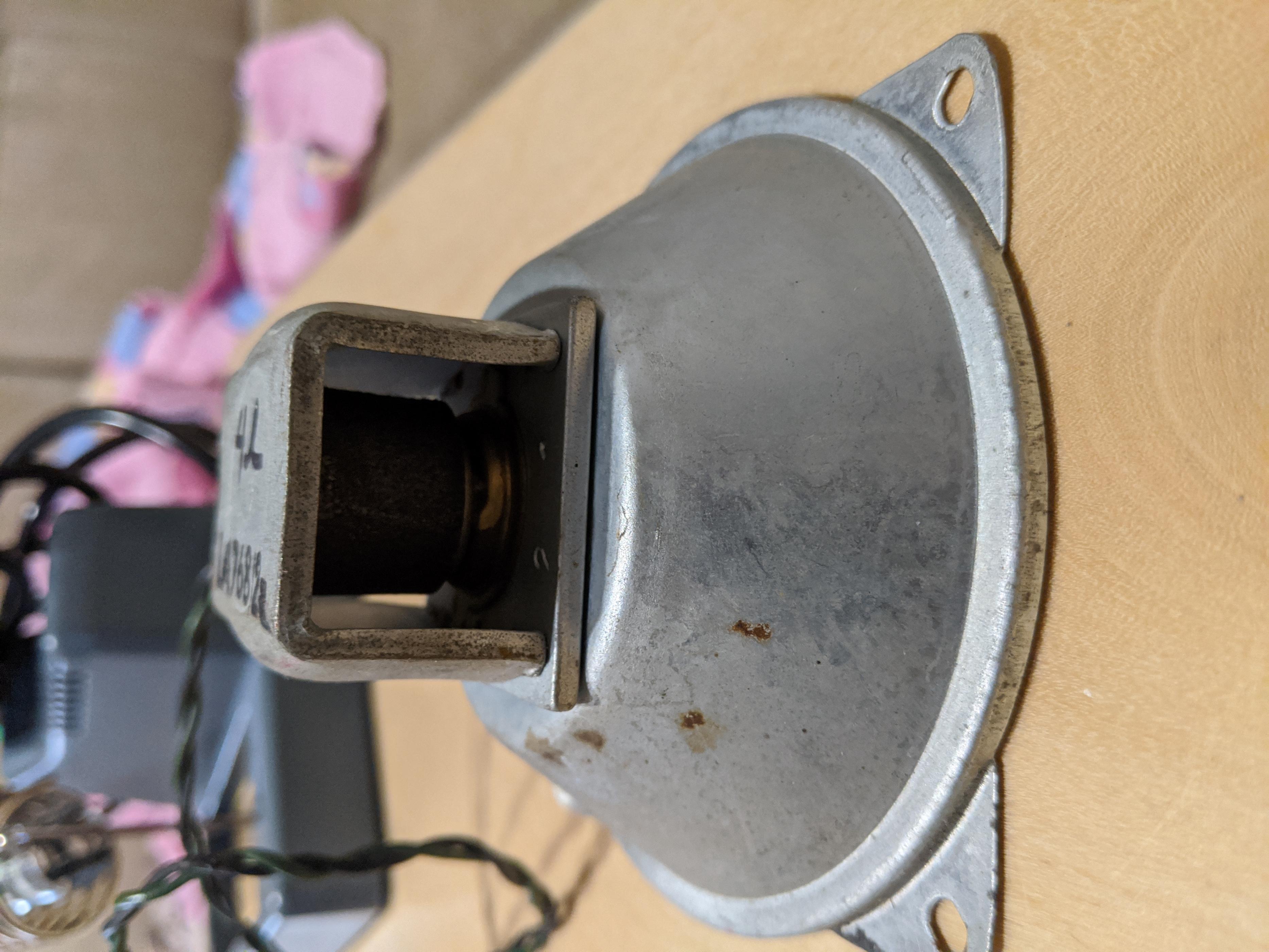

It seems like there is no in-between the original Fs and say 70% less. My tweeter is a paper cone vintage tweeter which is very stiff and I can't manage to get the VAS. I tried the above method but unfortunately once you put a weight on it reduces the Fs by about 80% and any amount of weight less than the one i had just put gives you the original Fs.
I can't find any other info no how to attain the VAS with teh DATs V2, the methods are not in any instruction other than the added mass method. Is there a way to guess it? Or can anyone tell me more about vintage paper cone stiff tweeter Fs is about 1300?
I never thought my first speaker design will be attempted on vintage speakers but it is the way it is. And Im a little stuck on deciding on the tweeter cabinet.
As it plays pretty low I am guessing it will need a cabinet? Small one im guessing....

Thank you, I had a feeling hence why I asked if someone can tell me more about vintage tweeters. Its not a wharfedale and it doesn't have an open back.
But if its playing the mid frequencies(well, I will measure and see if I need a dedicated mid driver) would it need a enclosure? This is where I am stuck on. Or can a two or three litre enclosure be okay?
I have the woofers enclosure size once I get figure out the tweeters enclosure size I can mock up a cabinet with chipwood and take measurements.
Anyway, a few more tips regarding a paper tweeter with a Fs of 1300 would be really appreciate it.
If it's a closed back type, no, it doesn't require a sub-enclosure. The closed back already provides that. You could add one anyway, purely to isolate the driver structure from some vibration caused by the LF driver, but I doubt it would make any audible difference in this case.
The 'normal' recommendation would be to cross the tweeter above its FS. Therefore you will not really be playing midrange frequencies through your tweeter.
Try to get a piece of scrap wood about the size of your intended baffle, mount the tweeter with no enclosure and measure it. Then add a tiny enclosure to the tweeter and re measure to see if the bottom end of the response develops a peak. (edit: it wont because it has a sealed back, I wrote this reply before the last 2 posts)

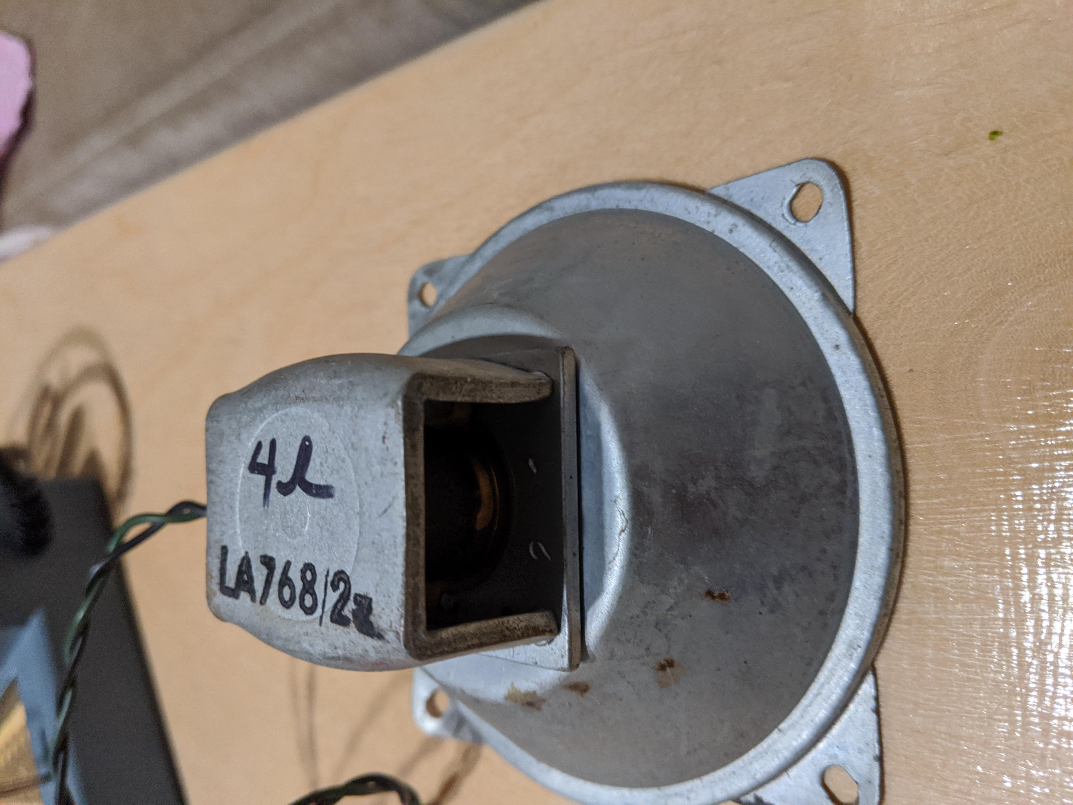

Just to double check if the tweeter is in a closed back? Some photos....

It is a closed back tweeter; there are much better tweeters available these days. I would suggest that you will need a midrange speaker if you are using a 10'' bass speaker in the design mix.
Given those rust holes in the back casing the owner might actually be right in asking for an enclosure, I am guessing, but they might not be airtight any more. I have seen it happen a couple of times
Proper designed XO perhaps not but at the minimum a vintage speaker would have had a capacitor in series with the tweeter. There might even be a "rule of thumb" for what capacitor size to go with what cone diametre but I've not seen one but the smaller the diametre of the cone the higher the Fs and therefore the smaller the capacitor value.

If corrosion has produced open holes in the back casing then they should be filled/covered with epoxy. The correct response of the tweeter will depend on its cone working into the small, sealed volume of the back casing. I would not simply place the leaky tweeter in a larger, substitute enclosure.
If the impedance of the tweeter is 4 ohm then a series 3.9uF polypropylene capacitor would be a reasonable first choice to act as a minimal crossover..
