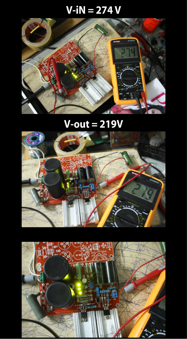

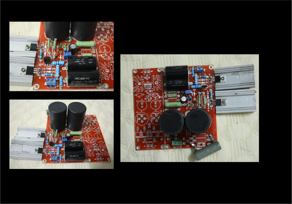

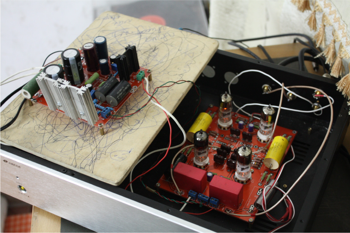

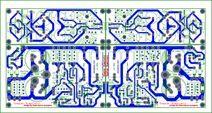

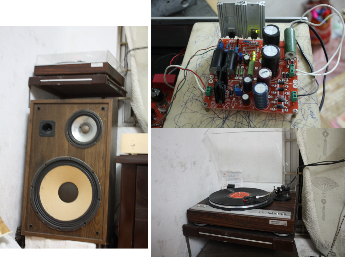

Test PCb is ok
Hi all!
to day I test PCB layout is ok.
Next today i will make PCB

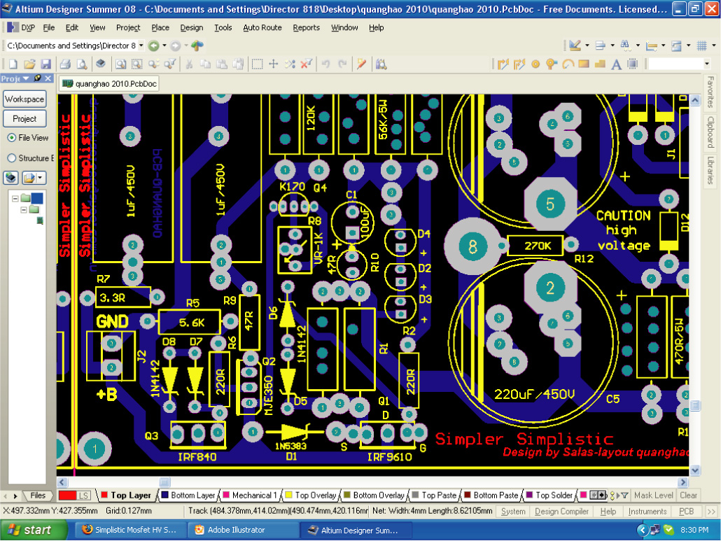

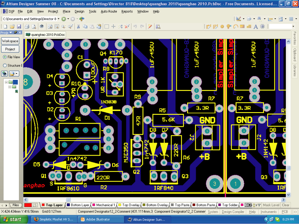

I use 1N5383. I see long traces, when I use it straight on the D to S pins underneath board. Can be some oscillation between nH of the traces and junction capacitances. Make a good test that your PCB build is reliable for 9610 in real life without the clamp and skip it if you can not solve it either by trying the original protection part or by making a test with it short legged and straight on D,S pins. Cathode to S. If you can not make it work with the clamp, delete it from board, if there is position, people will use it and lose Mosfets. You say the gate protection Zeners give you no problems, let it work on a real application, fully using all parts that work, and go through many on/off cycles. Not my business, but just my 2 cents of advice.
