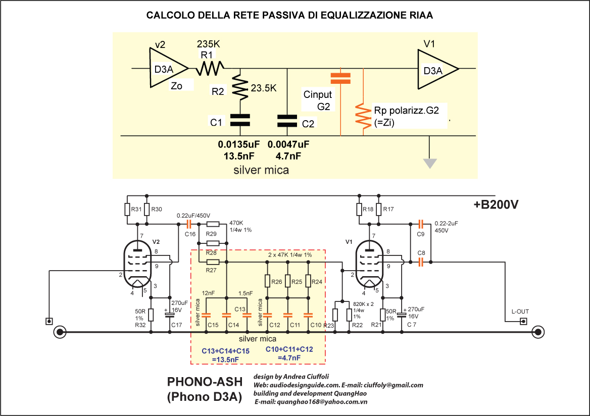

I have a small question the RIAA capacitors on your schematic and on the Andrea's site are not the same value. I know that there are different ways to make RIAA but which one is better?
Pred
Pred
My PCBs arrived last week.
Pred
Ok! the PCb is good??
The RIAA , Andrea have new RIIA, in the my Cricuit! I test New the RiAA is better!

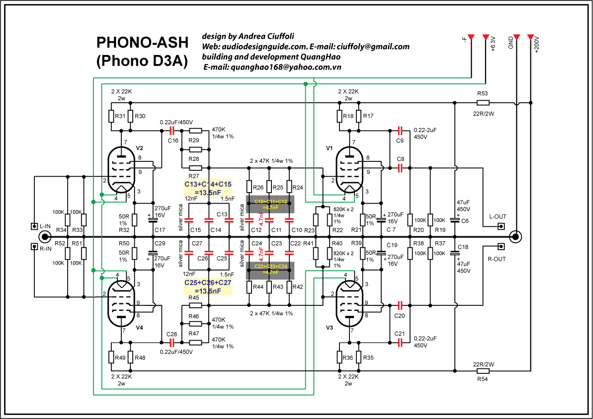

I have calculated 2 set of values for the RIAA.
The first was to work at lower impedance to get vey low noise but this mean higher capacitors value so only MKP can be used.
The new set of value allow have higher impedance and allow to use Jensen paper oil and silver mica capacitors.
At this time I don't have tested the new values.
Quanghao have build both the versions and he prefer the new as sound.
