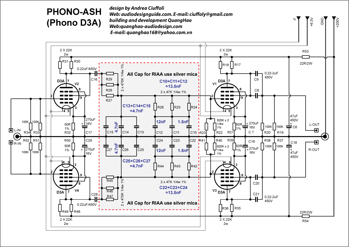

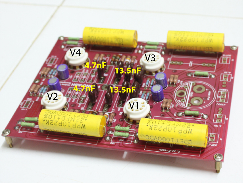

A bout the New RIAA
in diagram
R2(23.5k) is in series with c1(13.5nF)
But in pcb ayout.
23.5k is in series with 4.7nF
is this an error?
in diagram
But in pcb ayout.
is this an error?
Yes i see that! cricuit is wrong Cap, you can change it
You can check it help me!
thank
I don't understand!
look at post 177
which is correct?
Is riaa circuit (top) correct
or is pcb schematic (bottom) correct?
I don't understand!
look at post 177
which is correct?
The circuit i put the value is wrong!i check it now!

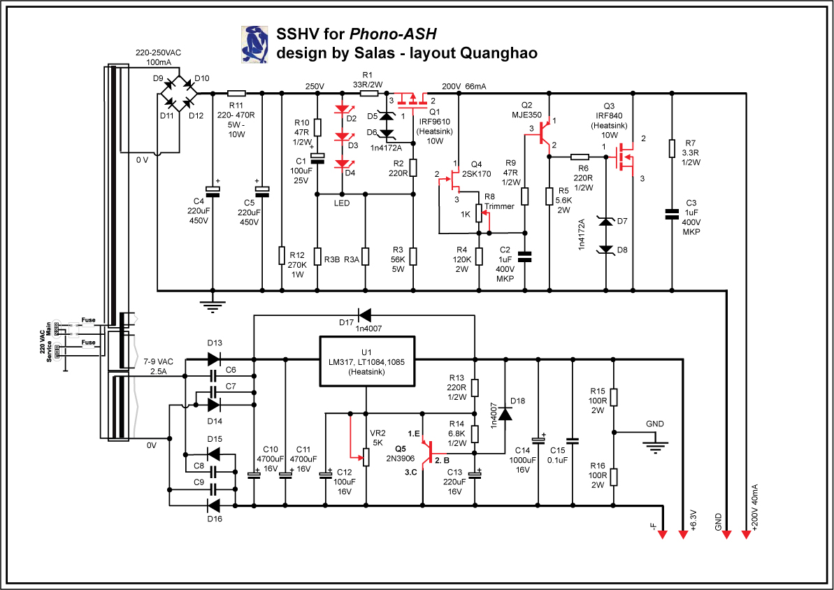

Can we agree that there are these errors one circuit? :
1) IRF9160 should be IRF9610
2) c13 + c14+c15 must be 4.7nF and NOT 13.5nF
3) c10 + c11+ c12 must be 13.5nF and NOT 4.7nF
4) number 2 and 3 must also be changed for other side of circuit?
IRF9610
Yes that right!
13.5nF= C10//C11//C12 (C22, C23,C24)
4.7nF= C13-C15A (C25-C27A)
