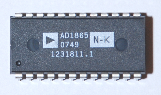

Does anyone have a pic from a genuine AD1865N-K? From Digikey for example, not those old ones..
DAC from Digikey:

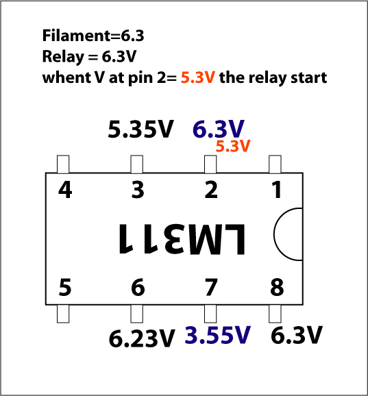

Voltage of Relay
The relay is ok???
Can you see in the image
Hi adamus!supply volatge comes up slowly, reaching 6.3v over 20 seconds or so
chattering begins when pin 2 lm311 hits 5.3v
The relay is ok???
Edit
In doing this i then needed to alter the the R11 again (which i hadnt done).
So with R11 at 700ohms, and R8 and R9 the regulation is stable and i am not getting chattering.
I should have been more methodical.
You dont use R8, R9, you conect direct is ok. No noise for filament.
I did try that. Its a fine balance between too hot resistors and too hot regulator.
With no resistors the regulator was extremely hot, so come volts needed to be dropped. with r8 and r9. 1ohm in parallel worked well. P=I^2 R, P= 1.28watts... s still reasonably hot, but only 0.65 watts per resistor so the 3w rating is fine for the 1 ohm in parallel.
