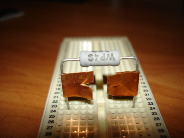

Avoid long term dry soldering joints
Because the 2.2R resistors are running very hot this could be an idea how to avoid dry solder joints problems in the future by dissipating the heat from legs.
The aim is to keep the soldering joint under 80 degrees.
The resistors can work as hot as over 200 degrees no prob.
