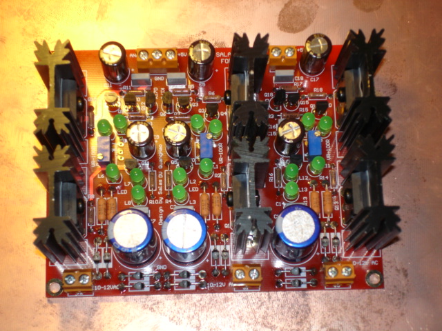

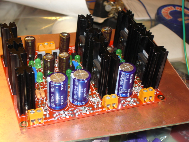

Salas Shunt Board Ready
Look good! you conect to AC??? what is about the led??
did you use 2x 33r or parallel 2x 66 - 68r.
I used 1 33r 2w resistor.
I will try AC tomorrow. I just finished and now I go to bed.
I used two dale 2W 56R parallel opposite orientation.
Farnell 1155017
Only use one R 27 Ohm/2W, or one 33 ohm/2W for CCS of Salas shunt. if use 33R// = 16 Ohm, the curent is lager, it not need that!
no! it is 250v! not enought voltage, about 400v
250v ac is approximately 400vdc, thats should be enough for this position, the plates are at 180v.
