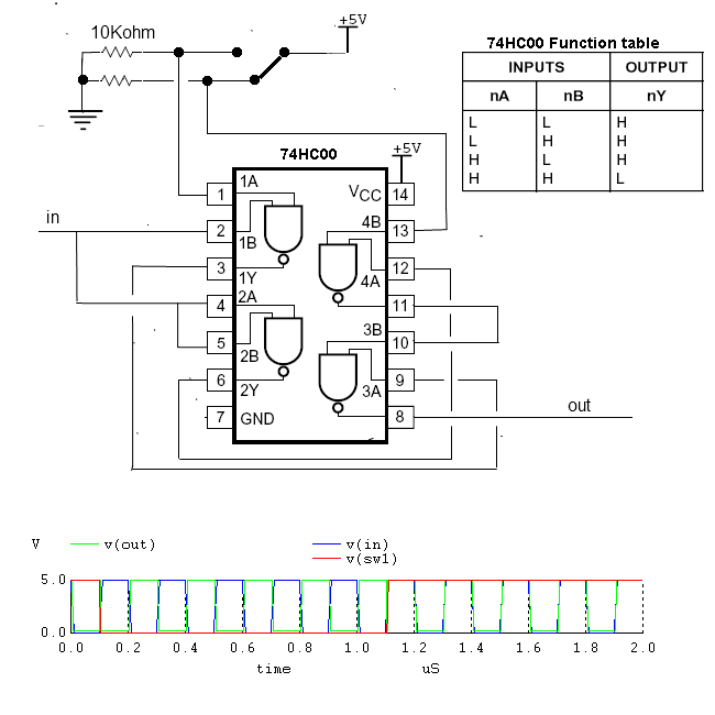

I had a thouhgt regarding the phase jumper.
Some Recordings are made out of phase and some in phase. It's realy hard to distinguish, but we all trust our ears to which recordings simply sound better.
When I get around to assemblin mine, I will put a switch on the fron panel of the case so I can switch to either in or out of phase "on the fly".
instead of the jumper block on the pcb, I'll find a header that I can use to wire to a switch.
Does anyone think having a switch instead of a jumper be problematic?
Perhaps the pcb layout can b designed to accomodate a users choice?

Jeff, Are you sure some records are in out-phase ? never ear before.
In any case is not possible have long wire in the signal path for these.
It is possible to do it changing the logic.
ok, thanks..... then how about an on board relay?
That would keep the digital signal path as short as it needs to be, and it would give us the option of changing phase without having to open up the case of a finished unit.

use a realy instead.
JD
Relay??
the signal does not go through relay, relay should not affect the signal
*and it would give us the option of changing phase without having to open up the case of a finished unit.**
That is a good idea and practical, but in this case I think not.

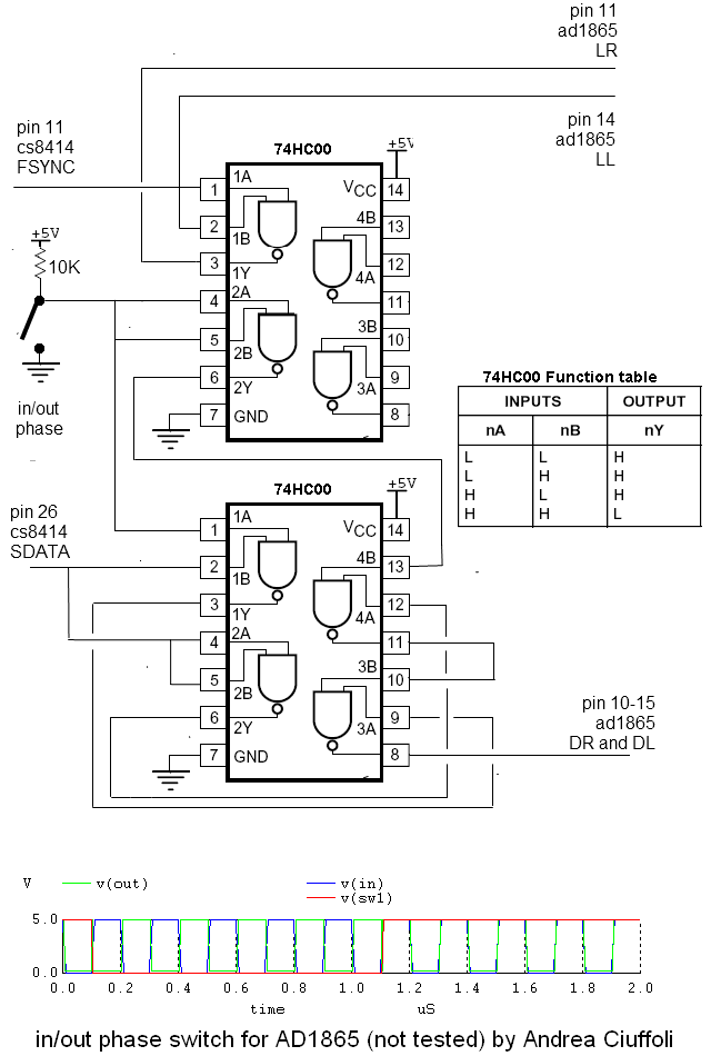

Jeff, it is possible implement a phase switch with a circuit near this
http://www.audiodesignguide.com/DAC_final/receiver3.gif
It use a 74HC00 NAND but it is necessary a capacitor on the digital signal path.
