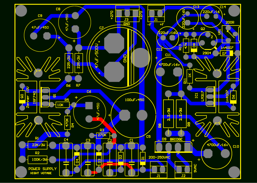

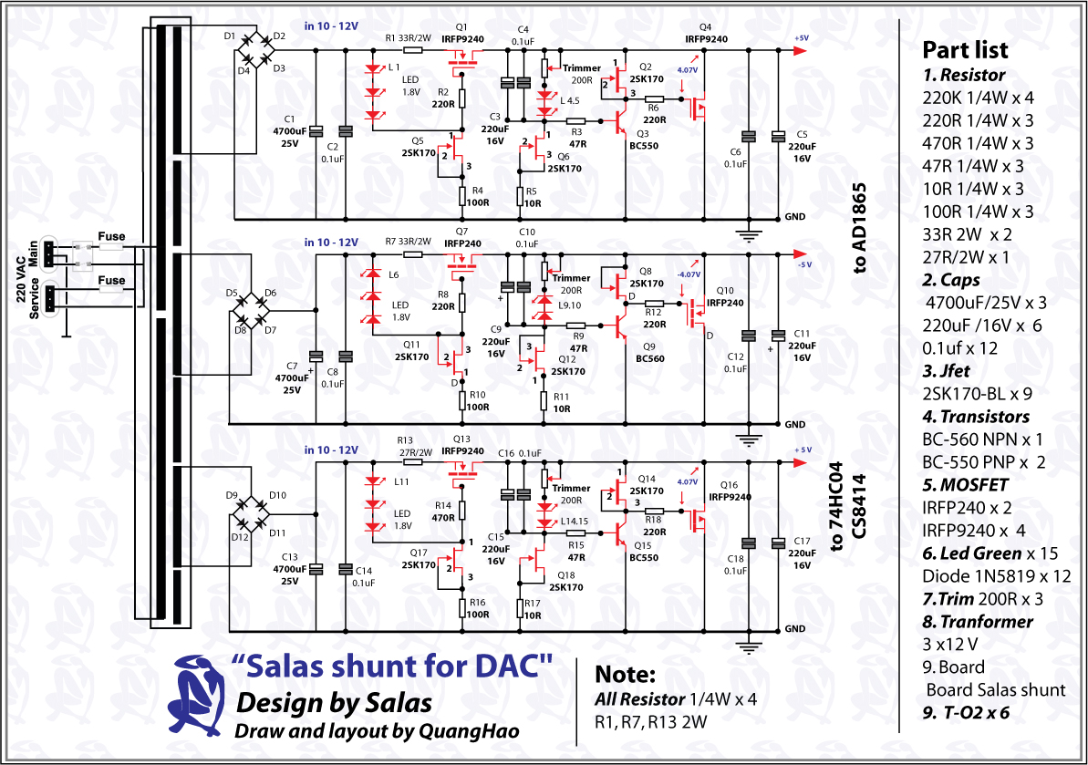

My choise about power supply transformers has been:
LS70-1 0-15X2(0.8A) 0-12X1(0.8A)
R80-55 0-9 X2 (3A),0-250(200mA)
from Ebay shop:
50W R Core Transformer,115V//230V, for Preamp,DAC/R26-x su eBay.it Transformers, Vintage Electronics, Electronics
I will test soon.
Probably with the same money it is possible to get one custom made toroidal by Bartolucci (Ricerca e Sviluppo - Bartolucci Transformers - Welcome to Ricerca e Sviluppo - Bartolucci Transformers)
I consider 200mA (0.2A) the minimun for the 250v and also 220-230v are good.
from Ebay shop:
I will test soon.

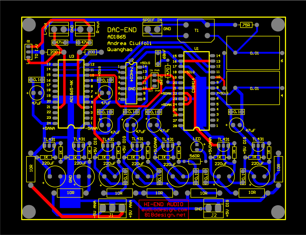

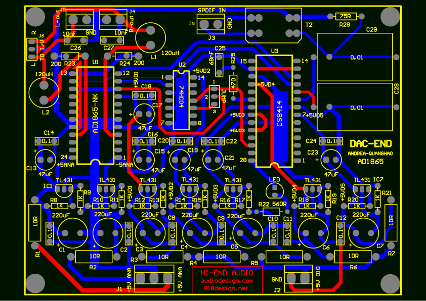

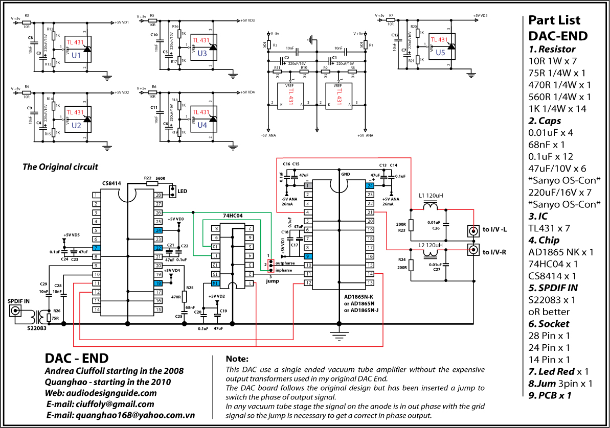

Didn´t you forgot the TL 431 for the DAC board?
I also count only 7 220µF there, not 12.
BTW, are there no 0,1µF besides the 220µF on the +/-5V Line?

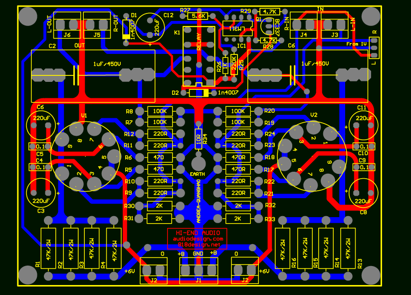

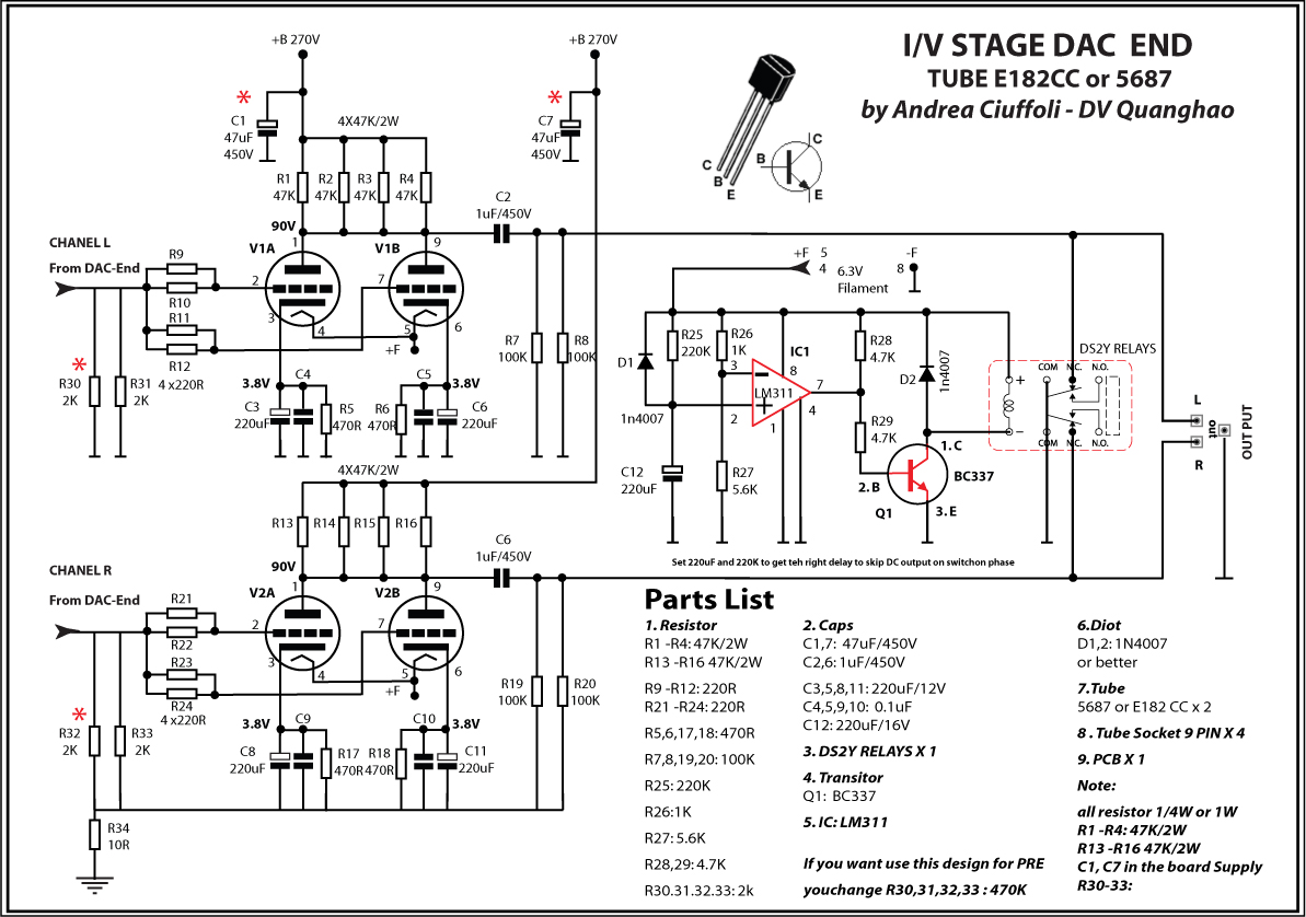

In the output stage board for any resistor on the signal path there are 2 resistors.
The best choice for the resistors is the Caddock but a good and less expensive choice is to use 2 resistors in parallel with opposite phase (inverted colors).
I suggest to use MK132 Caddock on DAC output (200ohm).
If you want to get the "best" resistor, you could also use the TX2575 from Texas Components.
I have outstanding results with this one in my DAC projekt!
DVB-projekt.
0.1 besides the Cap 220uF. Dont need it! May be i can put It on the board!
Tl431, Cap 220uF the Bom i up dat!@ thank
DVB-projekt.
I am not the PS specialist but all 220µF input caps have a 0,1µF parallel,
only the +/- 5V rail not. Perhaps there is a reason for that? In your schematic they still are!

I think the 0,1 parallel to the 220µF are not necessary, if Oscons or other super low Esr caps are used.
If someone really wants to add them, they can easily be soldered underneath the PCB, directly to the capacitors.
@Andrea
I'm asking myself if there are not too many caps after the regulators, which should already provide a clean and nice source.
And are those little TL431 regs really necessary? Is all this for decoupling the rails from each other, or is there another reason?
Probably you tried it and it was better...
@Andrea

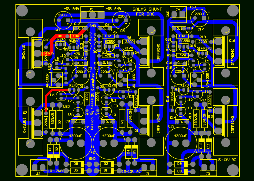

2. Salas shunt for DAC
