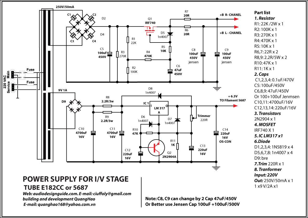

Published the last measurement on DAC output filters on the prototype board.
DAC End 2 - the AD1865N-K with single ended vacuum output stage
I consider as best solution a 10-12nF in parallel to the 200ohm I/V converter
but the pcb will allow you to use a different type of filter.
The transformer specification are about this:
3 x 12v 1A
1 x 9v 3A
1 x 250v 0.2A
I have sent my choice about these transformers got on eBay shop.
Is there any 250VAC & 9VAC transformer for 230VAC to be found? 250V & 6.3V was the closest I found. There is 250V/50mA in the schematic, is 0.2A really needed?
How about using 6.3AC for the heaters? Have you tested the hum? Or do you have that I/V?
And any 3x12V? 2x12V & 1x12V was again the closest..
