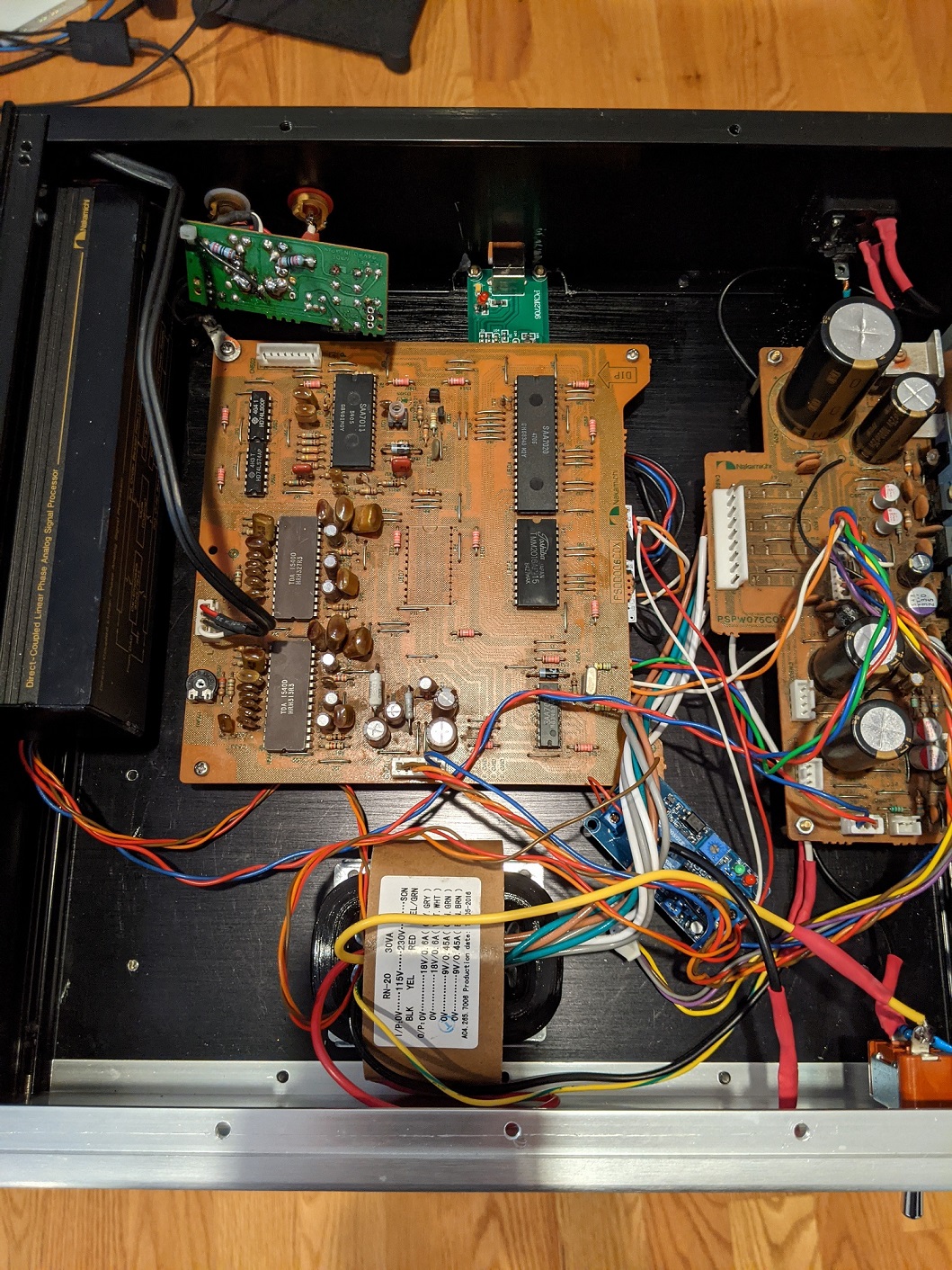

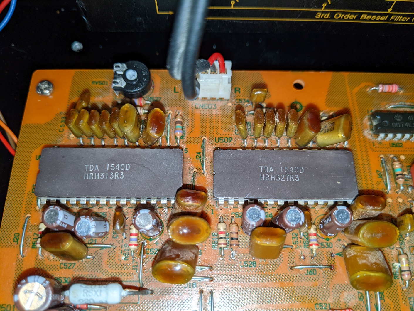

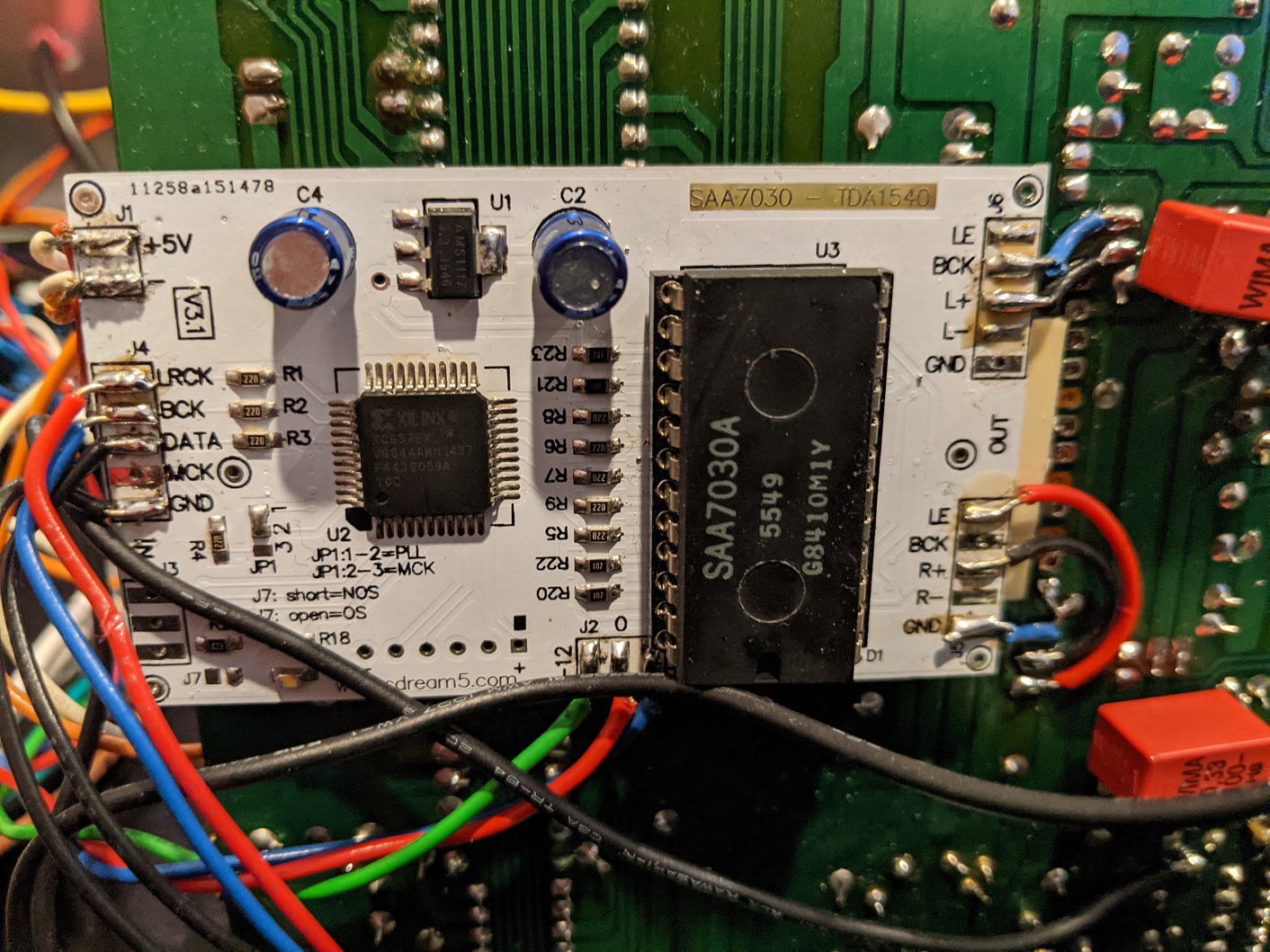

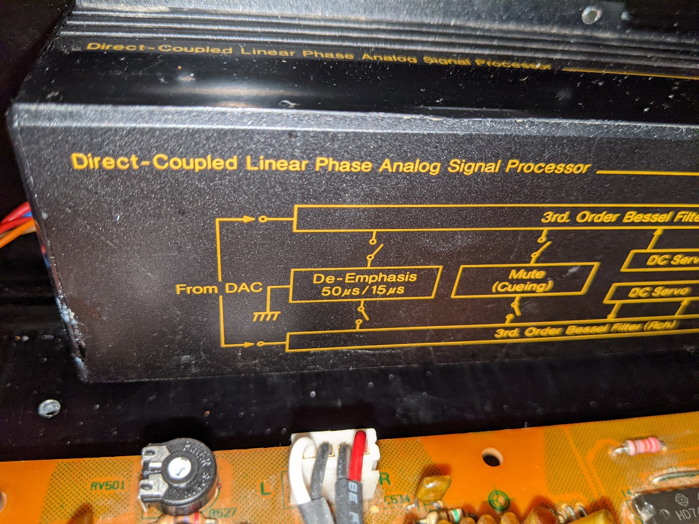

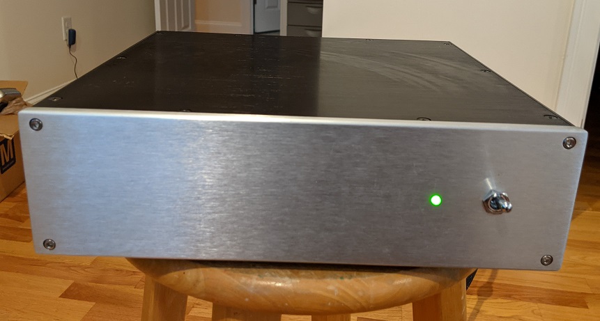

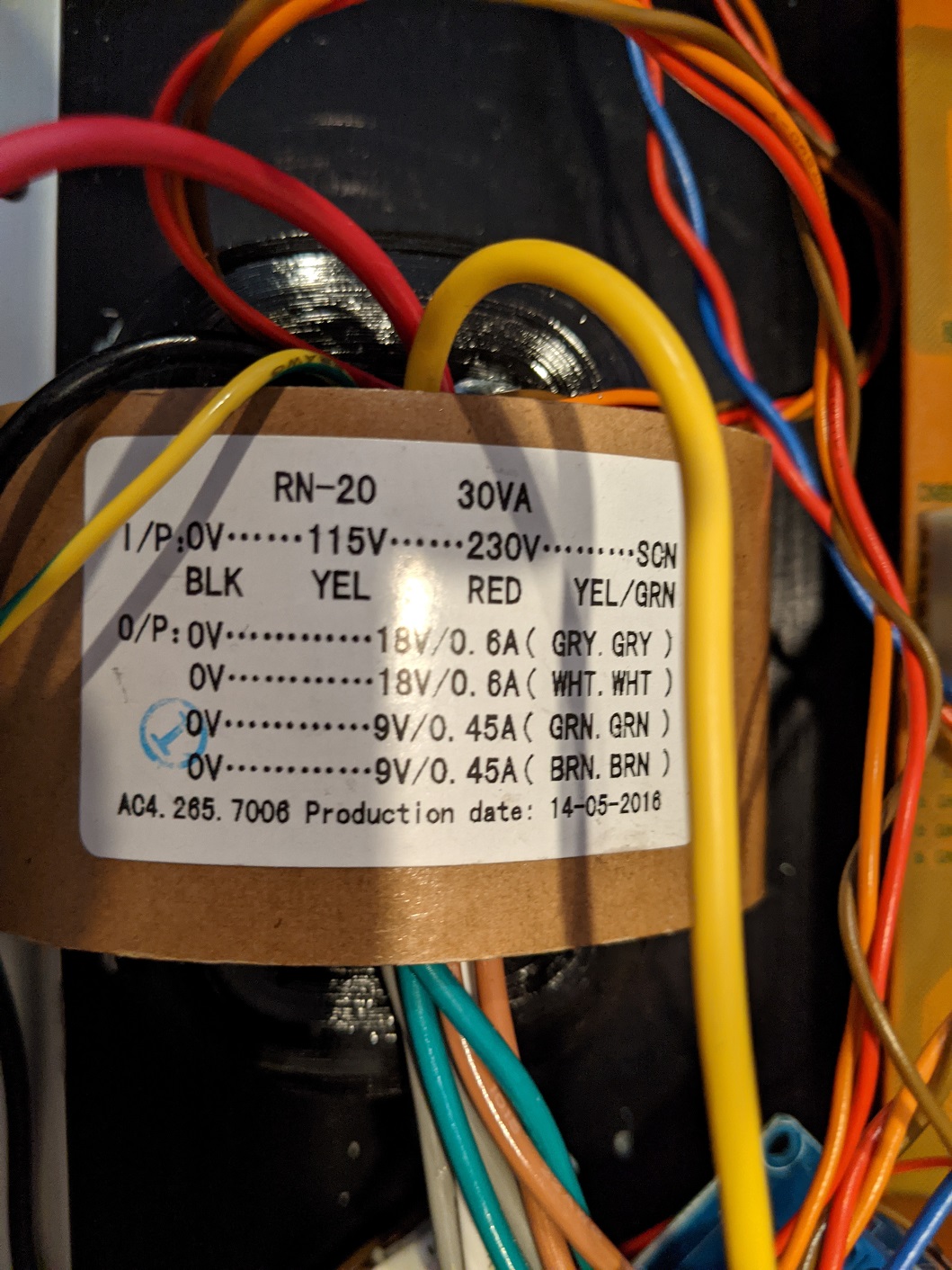

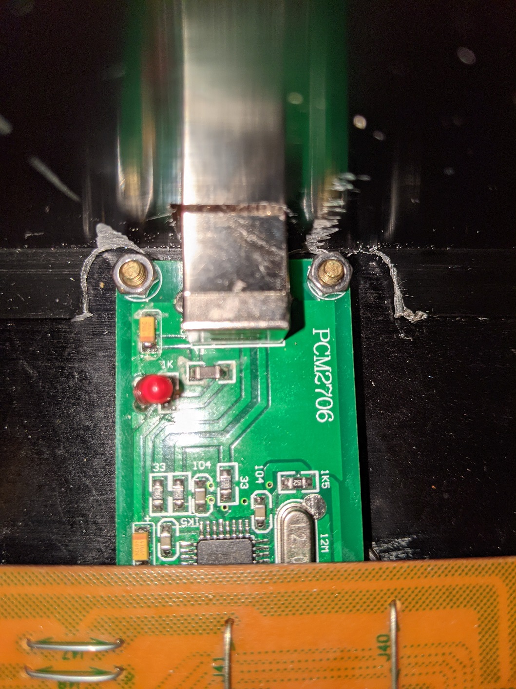

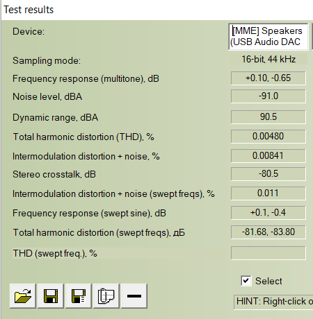

Responding to the OP, I opened up my DAC and took some pictures. I got the Power Supply, DAC Board and Analog section from an old Nakamichi OMS-7. I could have used the original transformer, but I found it runs the 7812, 7805 linear regulators at the voltage limit and too hot, so I am using a 18Vx2 + 9Vx2 transformer. The key is to remove the SAA7030 from the digital board and I mounted the cdream5 translator board on the back side right under where the SAA7030 used to be so I can run the high speed wires shorter. The translator board has just a few wires to connect to the SAA7030. I remember the one thing that took me a while to figure out was the damn Mute line (from the cd player digital section) which in my case has to be connected to 5V otherwise the output relay is left open and no output. I did the RMAA measurement a couple months ago using a Scarlett 2i4 and it was the first time I did any measurements not sure if I did it right.

Hello blackwindstorm. Really interested in your OMS-7 project. Thanks for sharing!
I have an old OMS-5 that's become very unreliable reading CDs and I'd like to try and convert it to a DAC too. Ideally I'd keep it in the original case and use this expanded version of the board that you used for the conversion which should allow direct SPDIF input:
I was planning to power it directly from the main board of the CD player (original power supply). You mentioned that the current might be a little high but would it still work?
Also could you provide any more info on the muting circuit and what I need to do to provide it the correct voltage to keep the output relay open?
I've built another TDA1540 DAC before from a similar kit from the same manufacturer but I'm no electronics expert, very much an amateur!
If you or anyone else could provide any extra guidance it would be much appreciated!

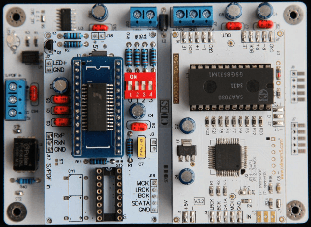

I bought this pcb from ebay for my TDA1540 DAC build...................
( https://www.ebay.co.uk/itm/32523126...Wev8eMMzokt0hP0LIOnEt581c=|tkp:Bk9SR4Srg_fXYA )
Very friendly seller.
You can get i2s from SPDIF or USB Sources and feed to this PCB and then this PCB feeds TDA1540's.
