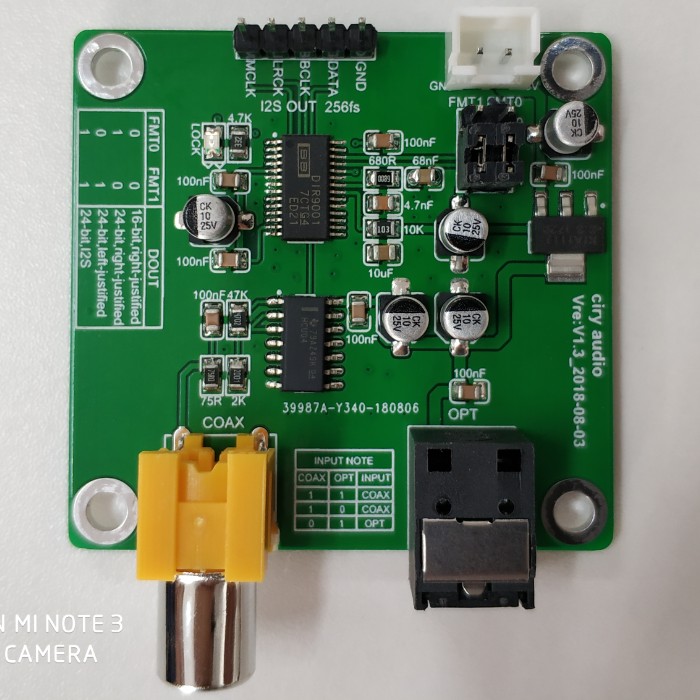

The place I would start is with a TDA1540 Datasheet. That tells you what there is to know about the dac chips and what they need in terms of input signals. Same for the digital filter chip, if anything exists on that.
Digital inputs like SPDIF and, say, USB, generally require conversion to a format compatible with a given dac chip. For some dac chips there are conversion chips that make the job pretty straightforward, although using them may require programming a microcontroller. For old chips like TDA1540, custom interface logic circuits may be needed. The links percival007 provided are about one important stage of interface processing.
You need an SPDIF receiver and an I2S to simultaneous (offset binary) converter, something like this:

I think you can find a DIY version here on the forum.
