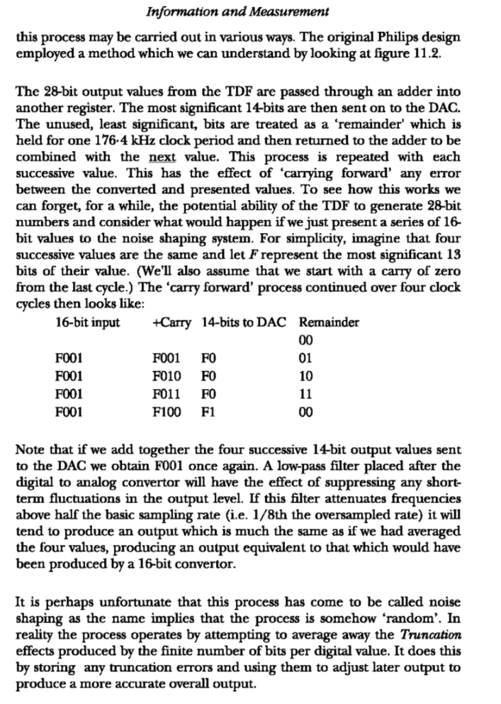

I am not sure what there is to explain. There is the general case of digital filters increasing word length which is a function of binary arithmetic. And there is the specific case of the SAA7030 which receives 16/44.1 and sends 14/176.4 to the TDA1540. Phillips simply state that by running at 176.4 their 14 bit dac yields the same performance as a 16bit dac running at 44.1. It is all in the datasheet.

If a 16-bit number is multiplied by another 16-bit number, the result is a 32-bit number. That is what happens in a digital filter.
Modern sigma-delta dacs may only have, say, a 5-bit dac in them. But if you operate that 5-bit dac very fast, the average (filtered) voltage output at audio frequencies might be good to 20-bits or maybe 21-bits.
Also maybe helpful to consider, DSD is a 1-bit dac. Its average output after being filtered can be good for much more than 1-bit of accuracy. Right?
It seems exactly this happens. 4x oversampling will push down the quantization noise, but the DAC gets 14 bit program material nevertheless. BTW the SAA7030 has 16-bit mode, too.Or is it just an upsampling to clean the audio pass band (interpolation?) while still ignoring 2 bits ? (dynamic loss?)
