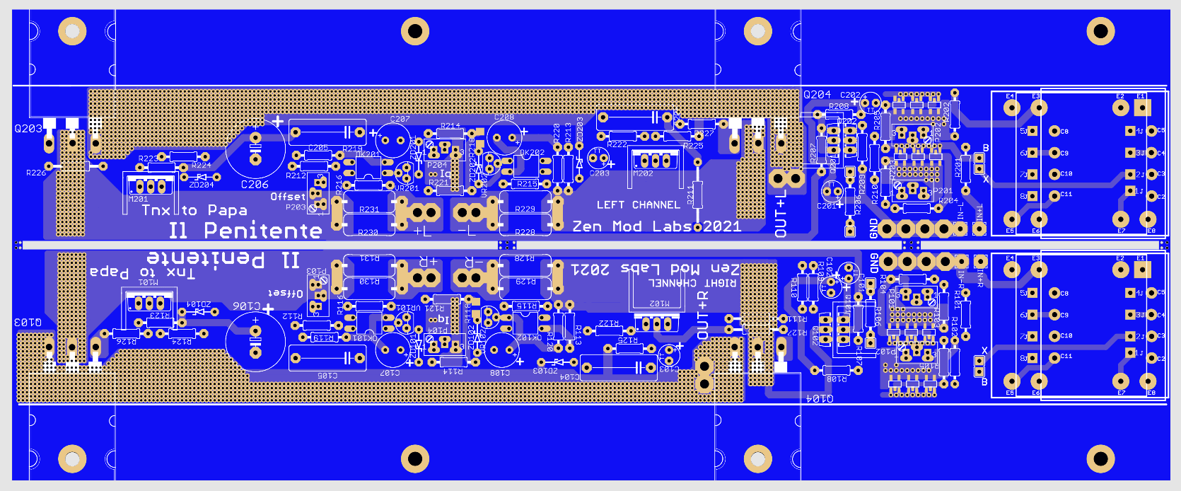

entire gain being in autoformer , smidge bellow 4V/V, which is 12db
meaning - rough calculus - for 25W of power, which is 14V14rms, amd needs to be driven with 3V53rms
counting that most modern sources are having 2Vrms out, preamp of 6db (2V/V) should suffice

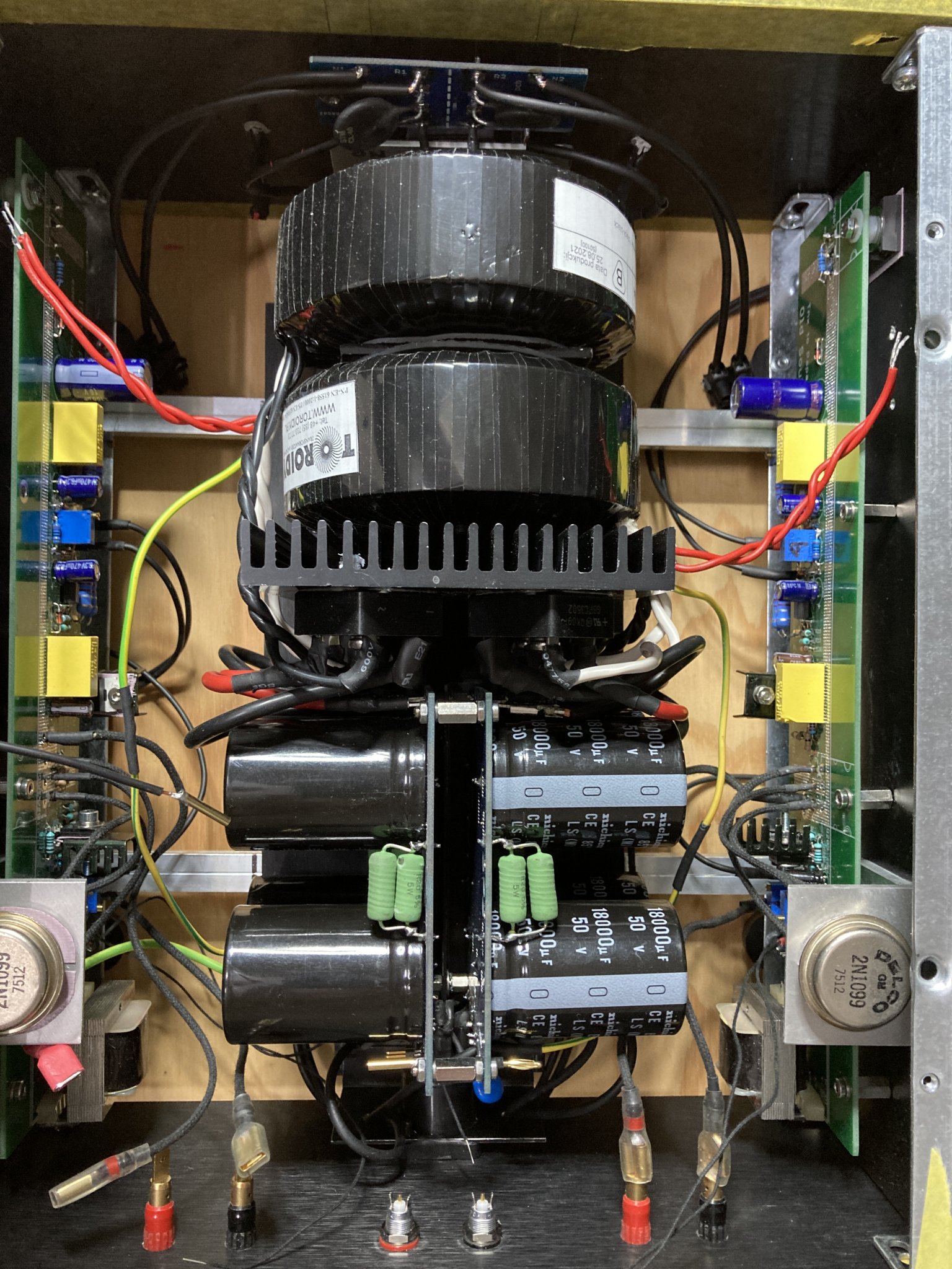

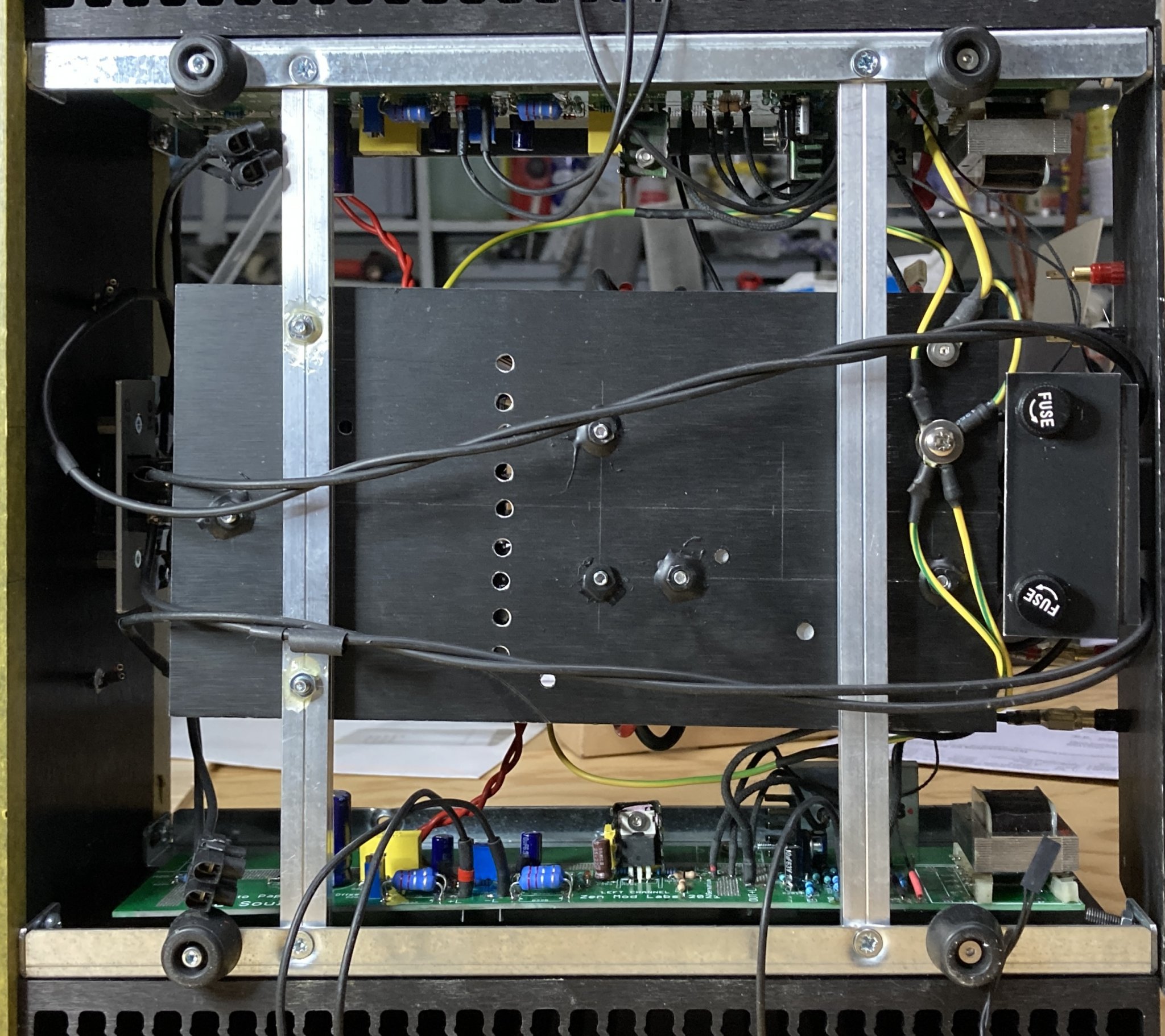

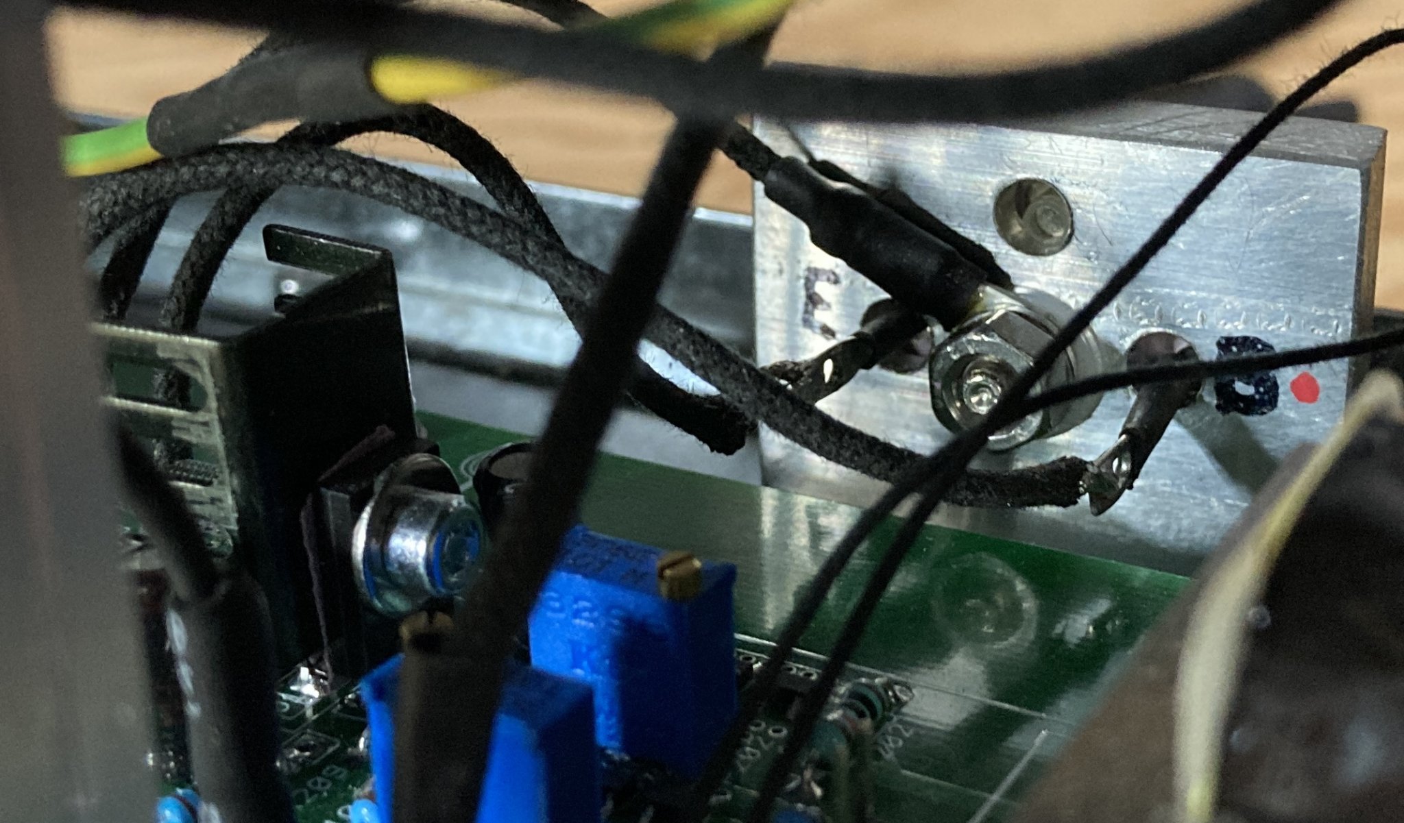

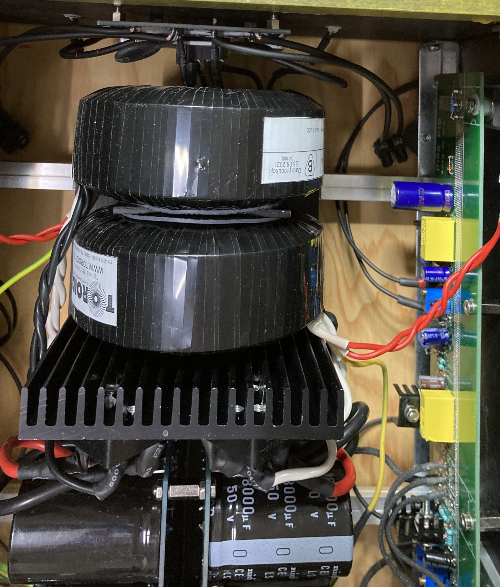

Twitchie, since you kissed me awake, here's what my old fingers came up with that good old Soul...
Just by looking at it it seems clear to me that I must improve the spacing—turn the Cap-Bank 90° (space is just snuggly ok), shorten bottom-plate and rewire the beast. (Ah, and I intend to insert a sort of handle to the psi, to be able to one-handedly lift it out of the chassis)
Since I must remove the boards to replace a faulty part, I will take the opportunity and turn the Beguns 180° (and add the forgotten heatshrink-tubes), so that the wires are parallel from board to beast... :Popworm:

Just a word of caution:
the second-greenhornyest greenhorn or so!
Ok, so after what, 6 weeks, I got back in screw(-around)-mode, and dismantled my Old Soul to get the weaknesses and mistakes out.
Guess what: The cap-bank was still under load, causing a frightening zap-sparkle! Aah, I sometimes hate to be such a ... greenhorn.
Q 1: do the caps suffer when they're not getting drained for so long? (not speaking of shorting them, mind you)
Q2: Since they're off-board and not connected to anything anymore, how should I drain them?
they are happy being full, waiting to zapp! whatever comes first
use 1K small resistor for few secs of draining, then use 10-20-50R resistor, whatever you have handy
if you go that way, in two steps , no need to use fat ones - small 0207 are good enough
hope you didn't sparkle on channel boards .......

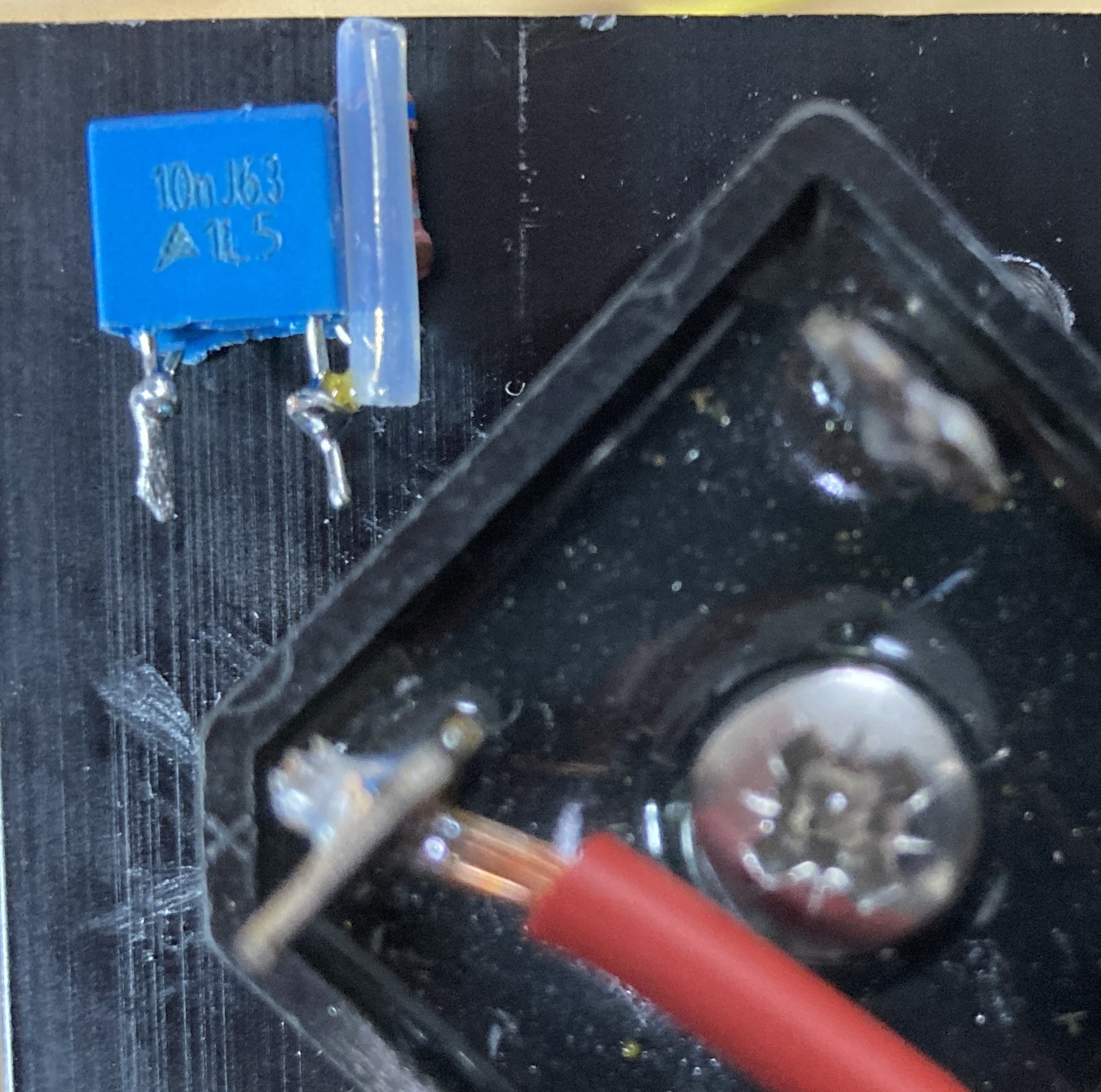

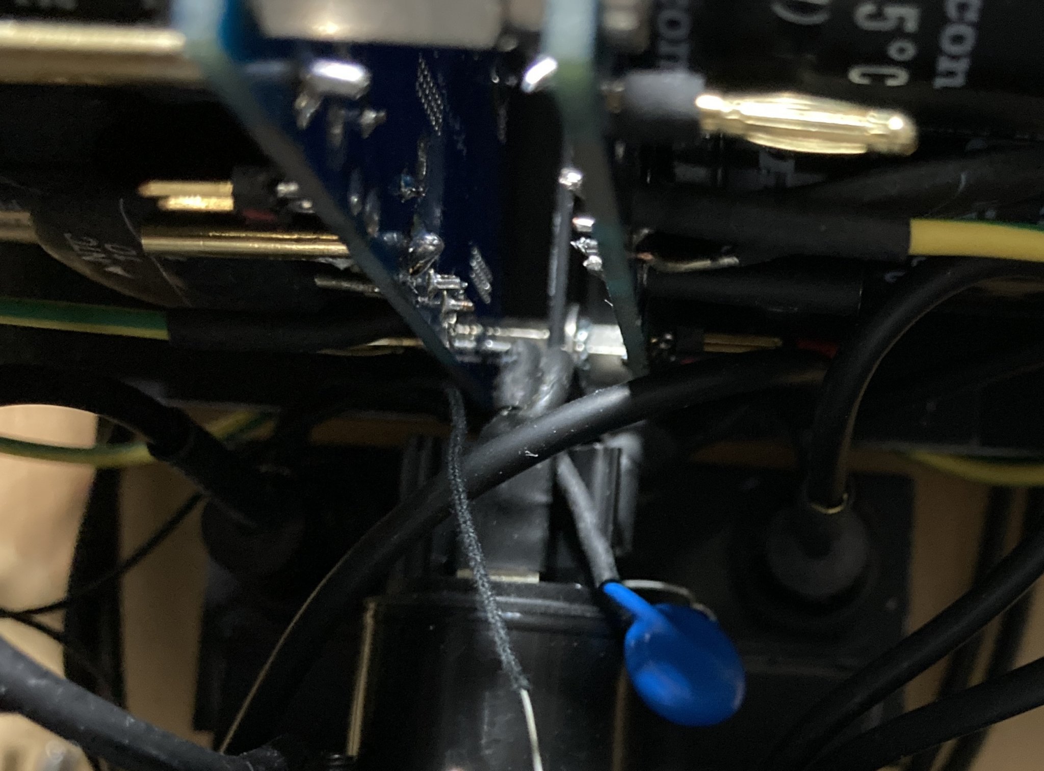

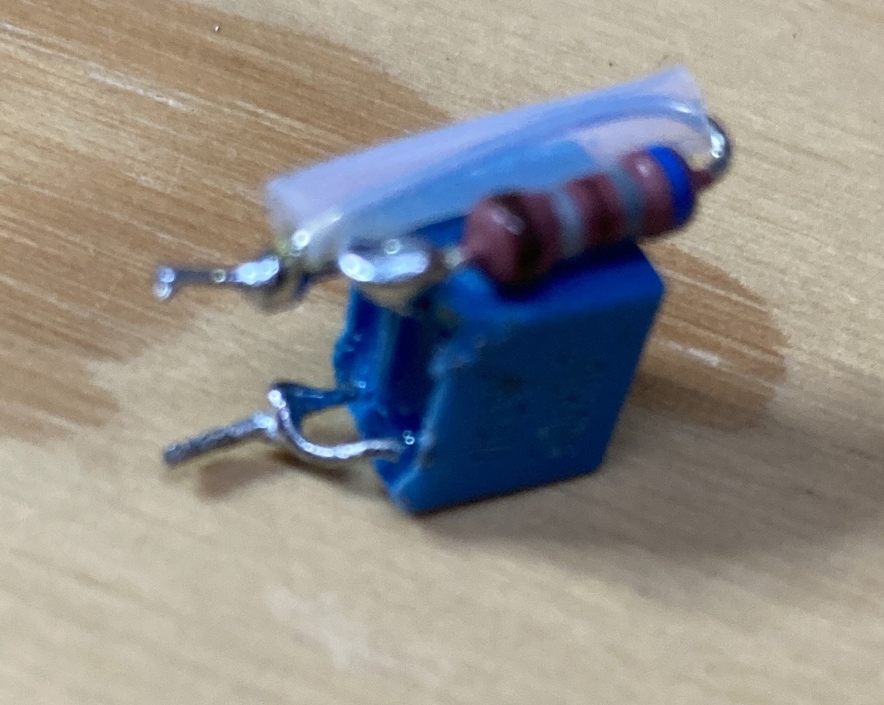

Hiya!
Toroid's snubber will go onto rectifier's input, correct?
:greenhorn: 😀
