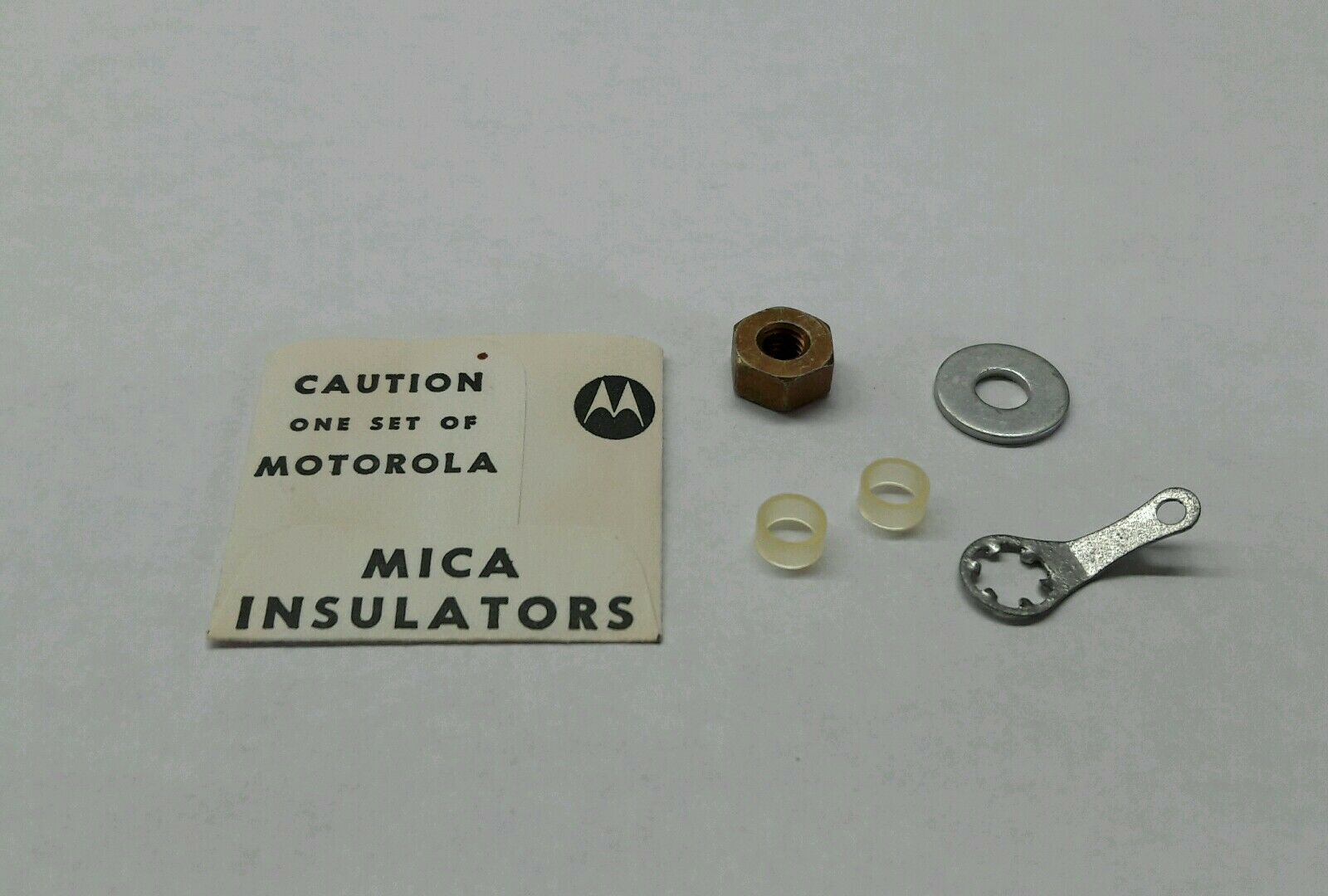

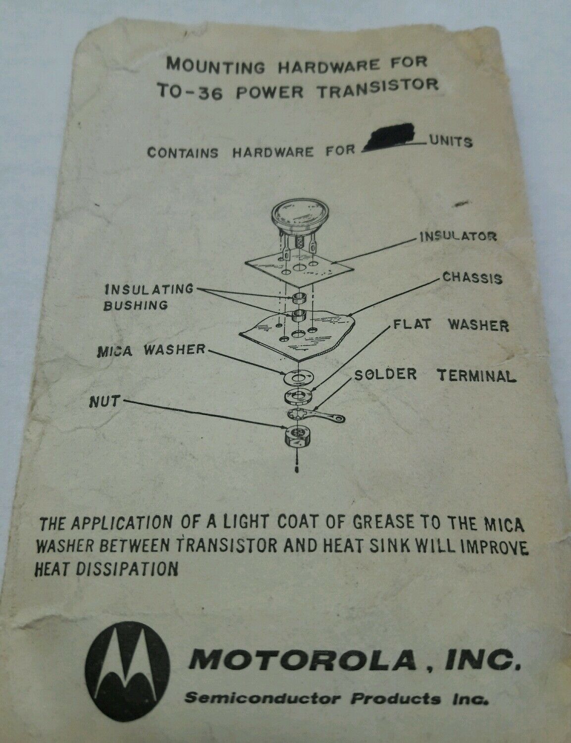

I found this mounting hardware detail for a 2N1099 - (TO36)
An ebay guy has them for $10 a set. Think I can get the pieces
for much less.
for much less.
