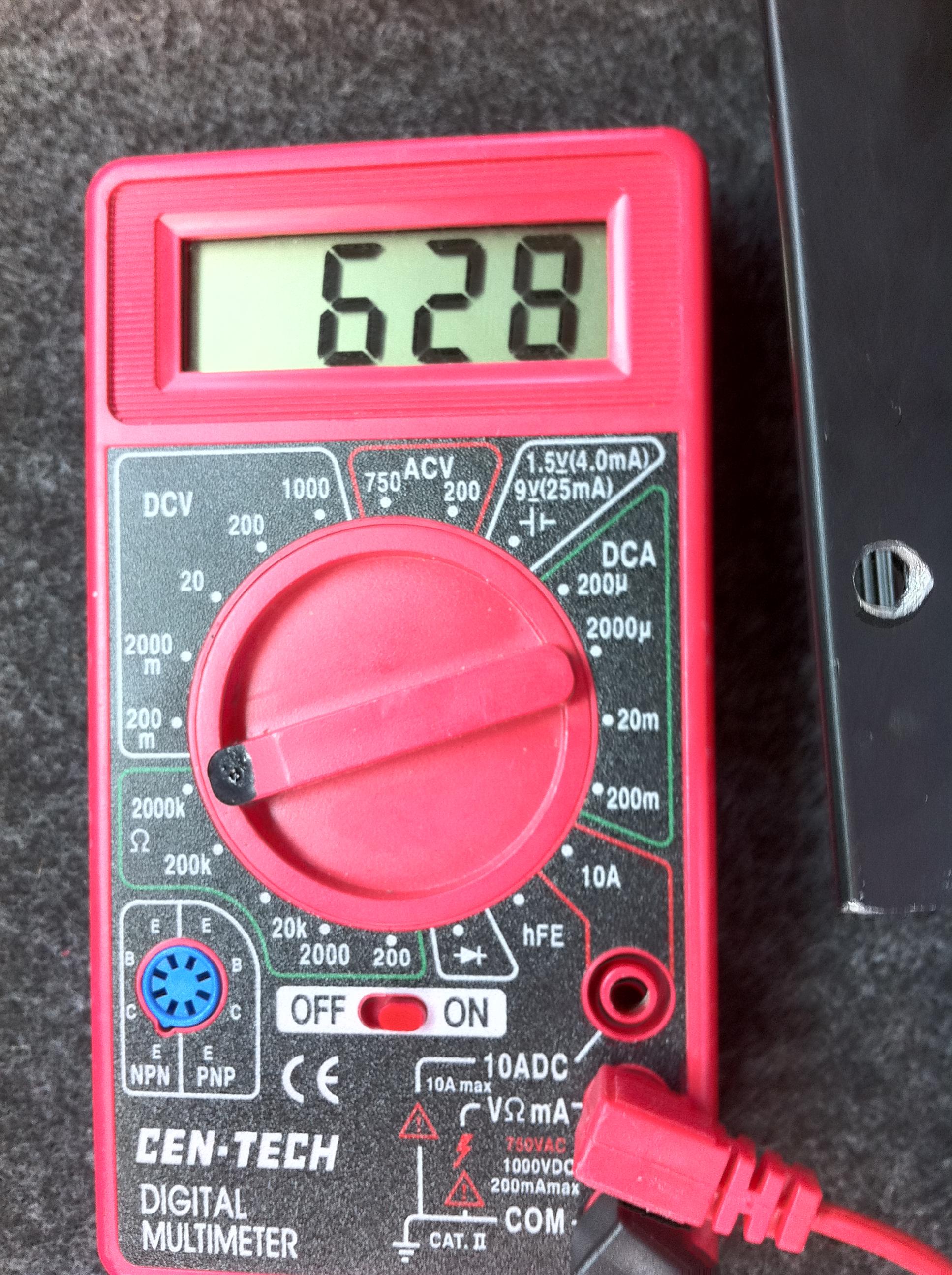

I'll recheck and post pictures of the readings and the meter settings in a couple hrs. Unfortunatly my brother had to take the fluke back to work so I'm back to using the POS meter or the Sencore.

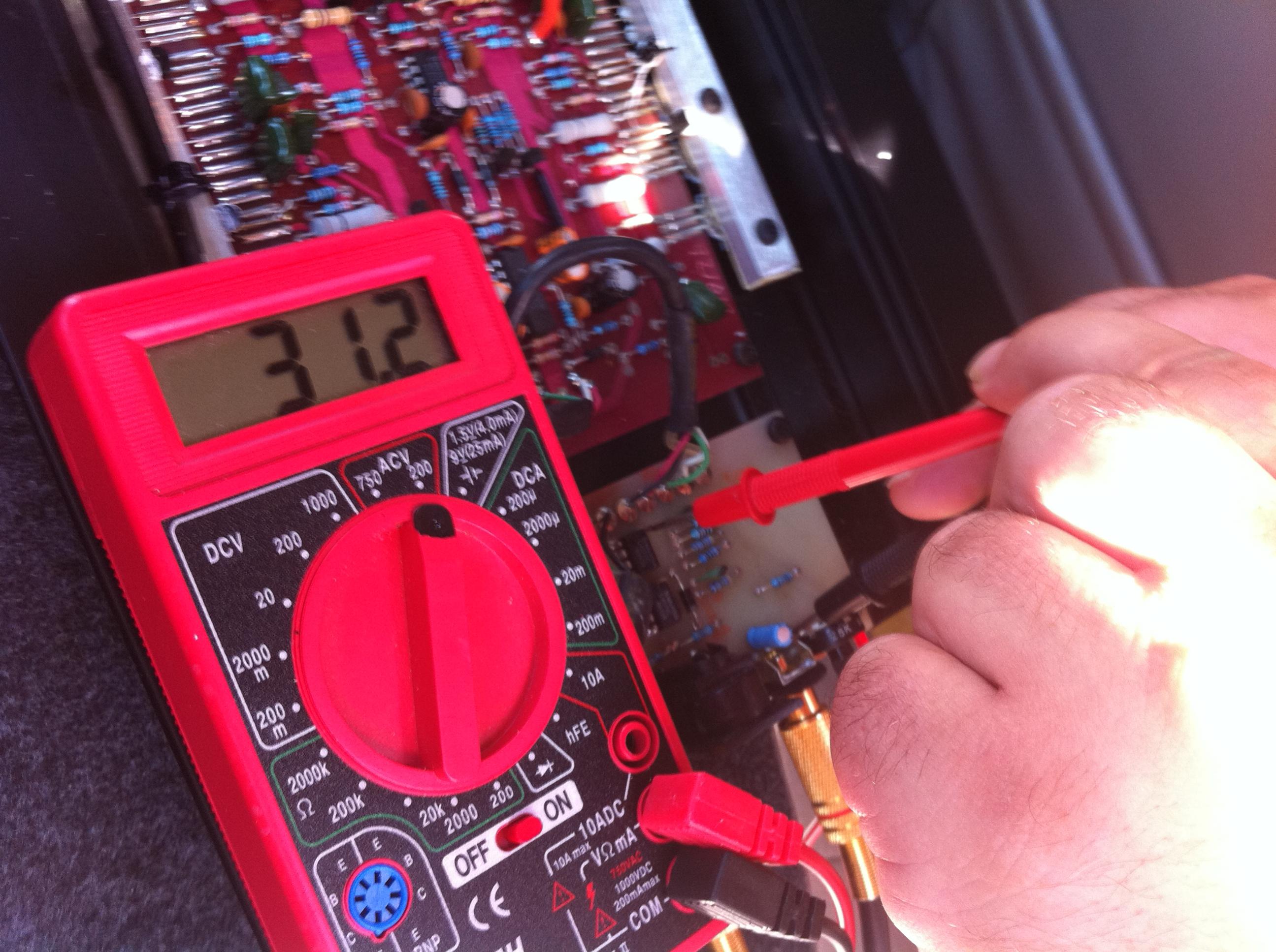

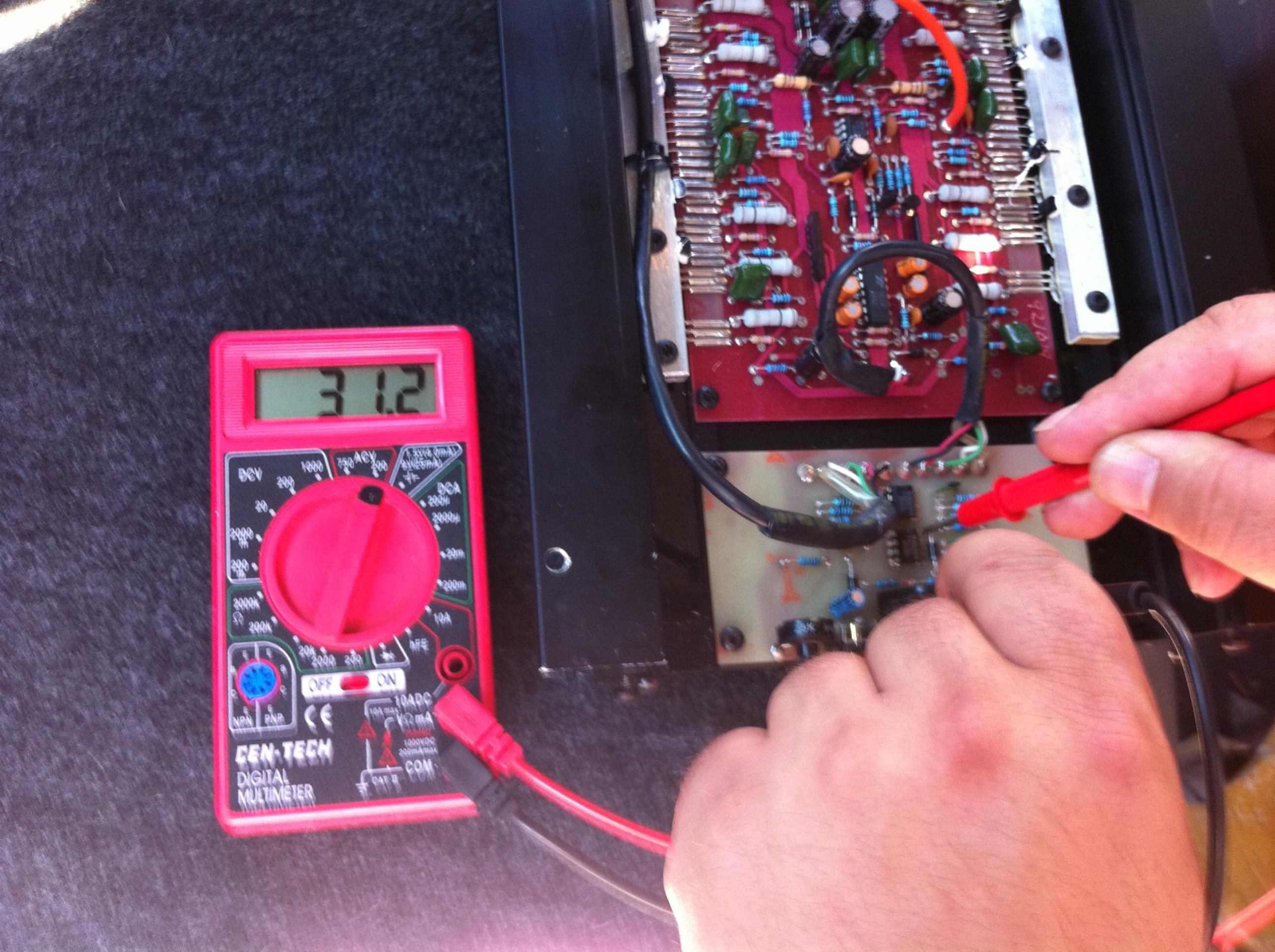

Rechecked and pin4 on both op-amps on the pre-amp board show zero VAC. Pin8 on both op-amps are reading 31.2vac and pictures are a bit fuzzy but should help.
The ohms section seems to be unreliable. I will have access to the fluke later tonight for ohm testing.
Set the meter to the 2000 ohm mode (not the 2000k ohm mode) and recheck. I think it's OK but having on the lower resistance setting will make it easier to understand.
Re-check the AC voltage on pin 4 and 8 with no input signal.
