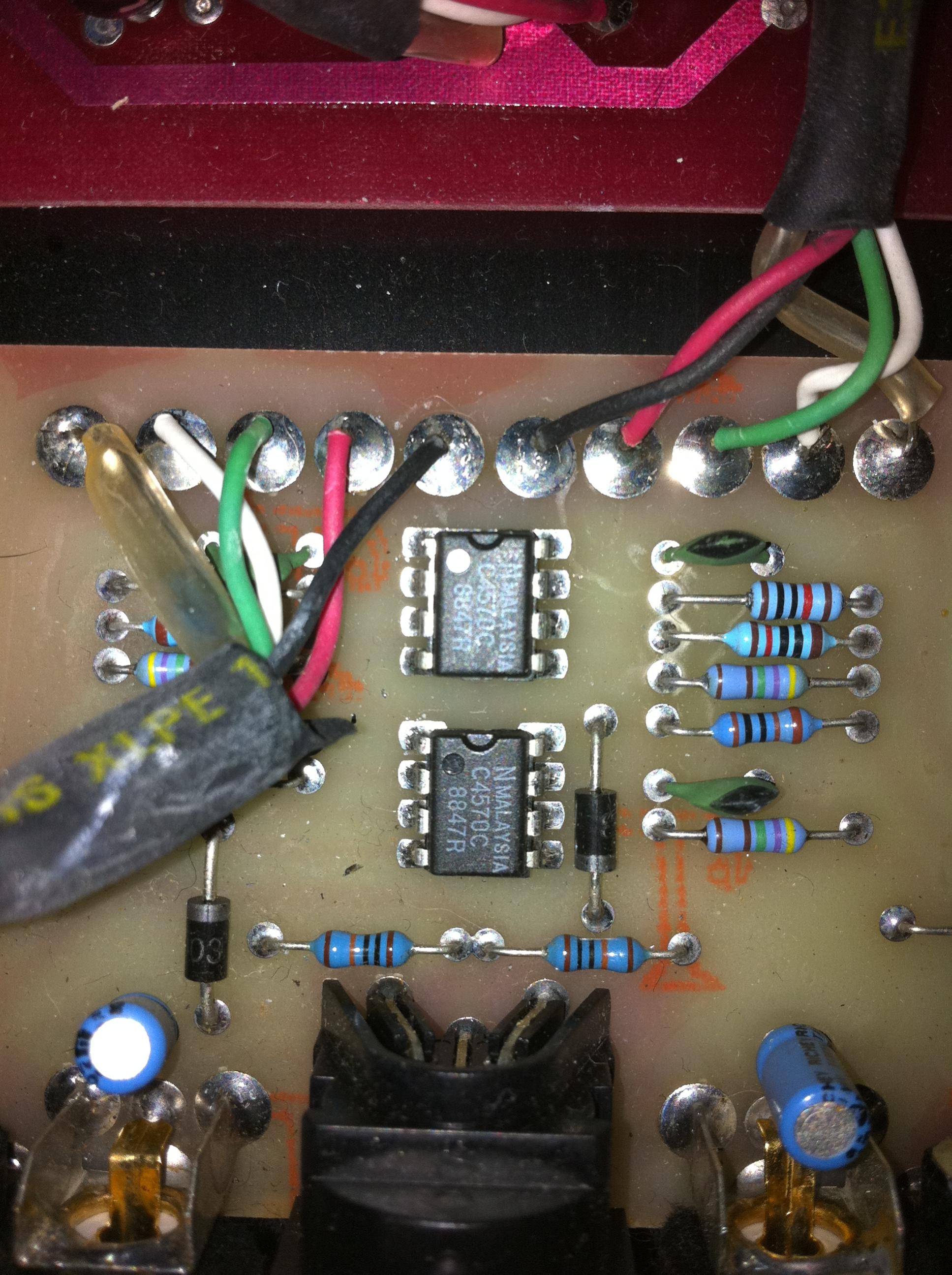

The op-amps on the board are the black 8-pin components.
You need to replace it. I'd recommend using an exact replacement. If you want a temporary replacement, you can probably get a TL082 from Radio Shack.

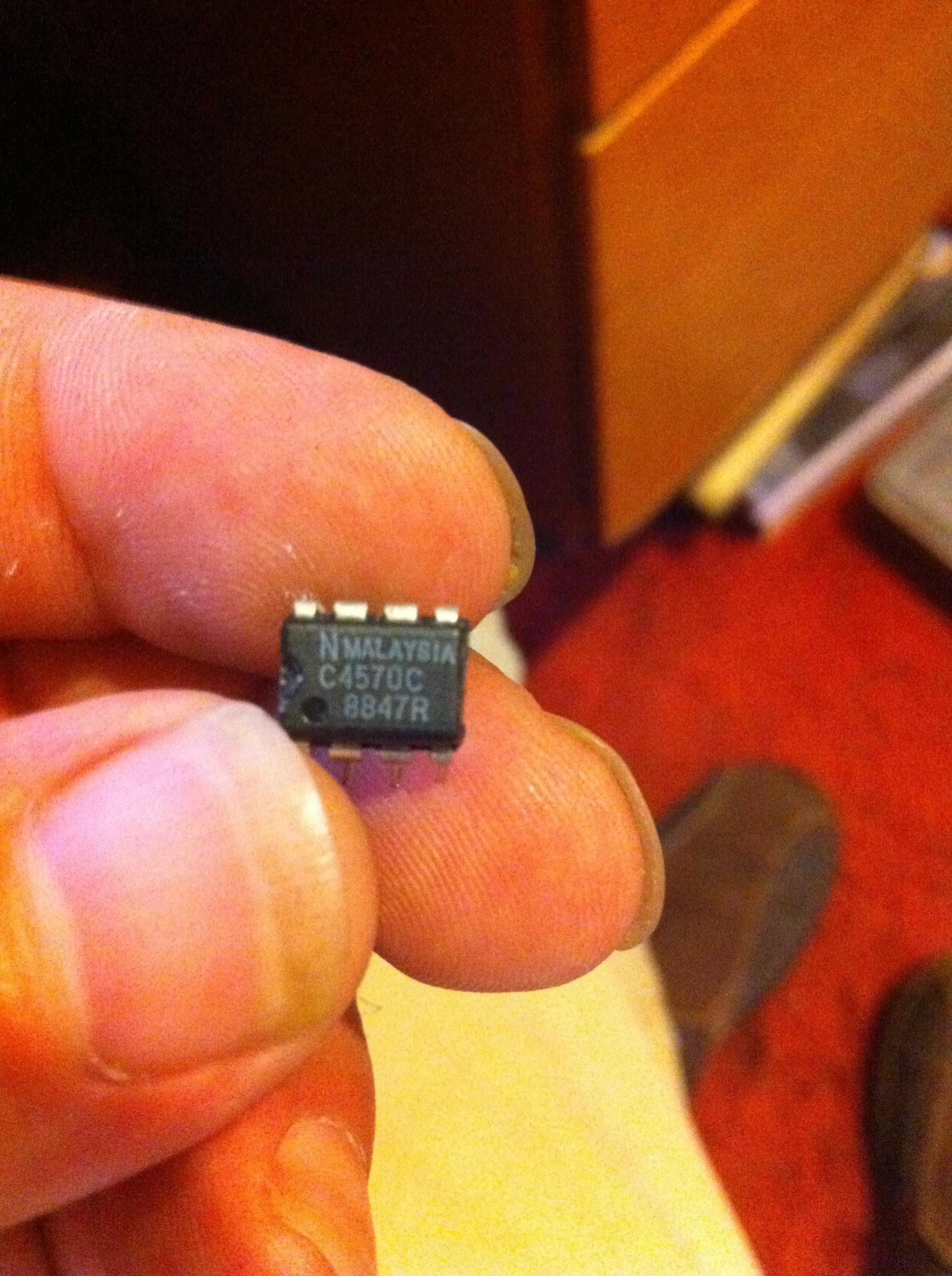

These op-amps have (Malaysia C4570C 8847R) stamped on them. I have found several online but there are a lot of different manufactures. Who should I source them from?_

You can buy 2 of them but, at this point, you only need to replace the one nearest the RCA jacks.

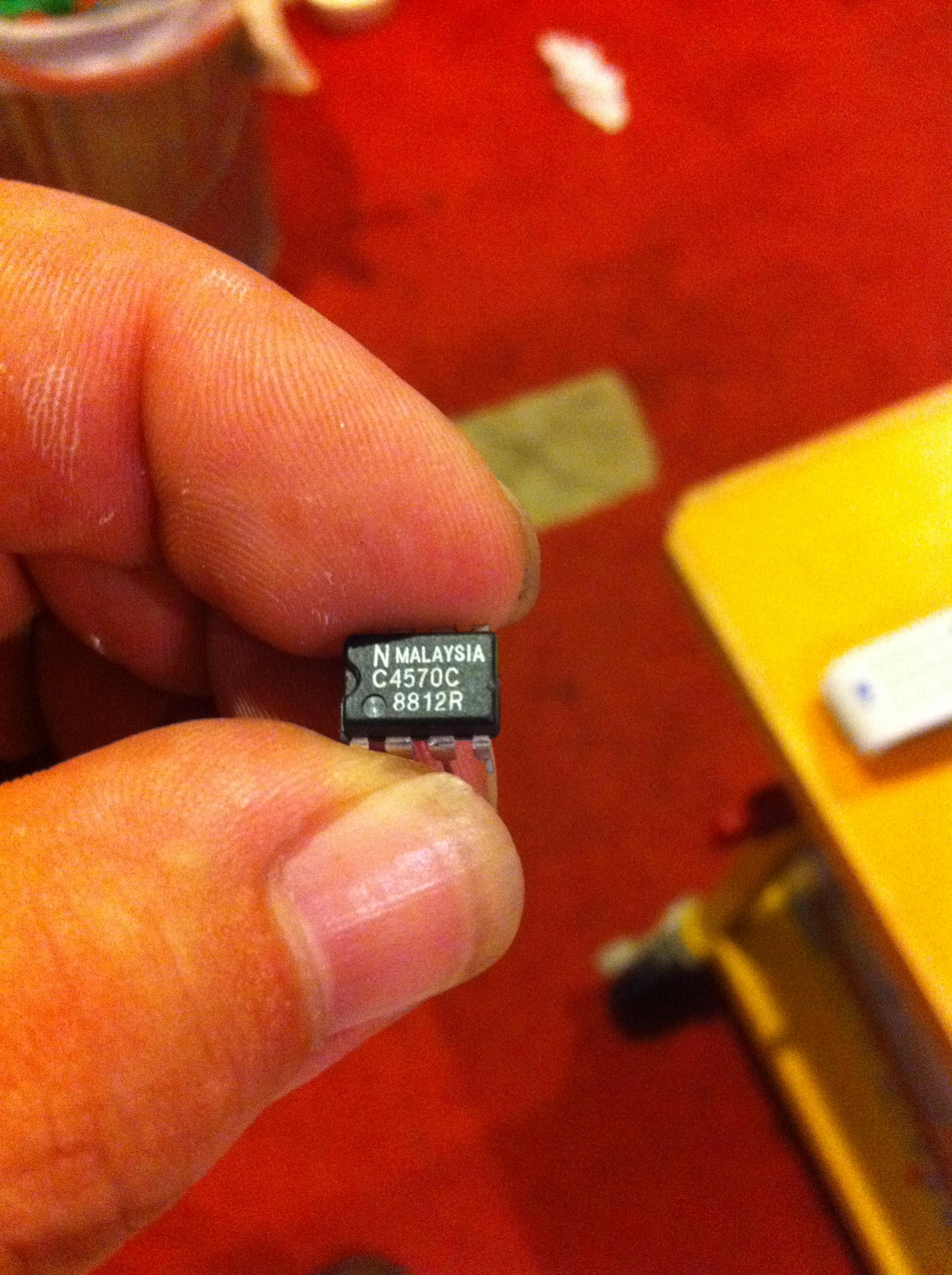

I found one here locally but there is a slight difference. The original is marked Pic#1(NMalaysia C4570C 8847R) The one available is Pic#2(NMalaysia C4579C 8812R) I don't know what the last number indicates. Does anyone know if this one will be ok?
They are the same. One was made in the 47th week of 1988. The other was made in the 12th week of 1988.
Thanks, Installing now. I Will not have my car here today to test with audio signal. I can test with battery and headlight. What should I be looking for on pins 1,2, and 3 with to imputs connected?_ The last test showed zero on all 3 pins leading to the op-amp replacement. I'll post results later today.
You will need a signal source to test it. The 0v DC was OK. The problem was that you had signal on pin 3 but had no output from pin 1.
Ok, I will test this evening with signal. Op-amp is installed and waiting for test vehical. Thanks again
I have sound!!!! I replaced the op-amp closest to the RCA's and with 1v supplied through the RCA's I get 1v on Pin#1 on both op-amps. On Pin#7 I get .3 on both op-amps. When subs are hooked up the left rca sounds great the right channel is about 1/3rd the volume. So there is an improvement (Sound)Thank you,Thank you,Thank you.
