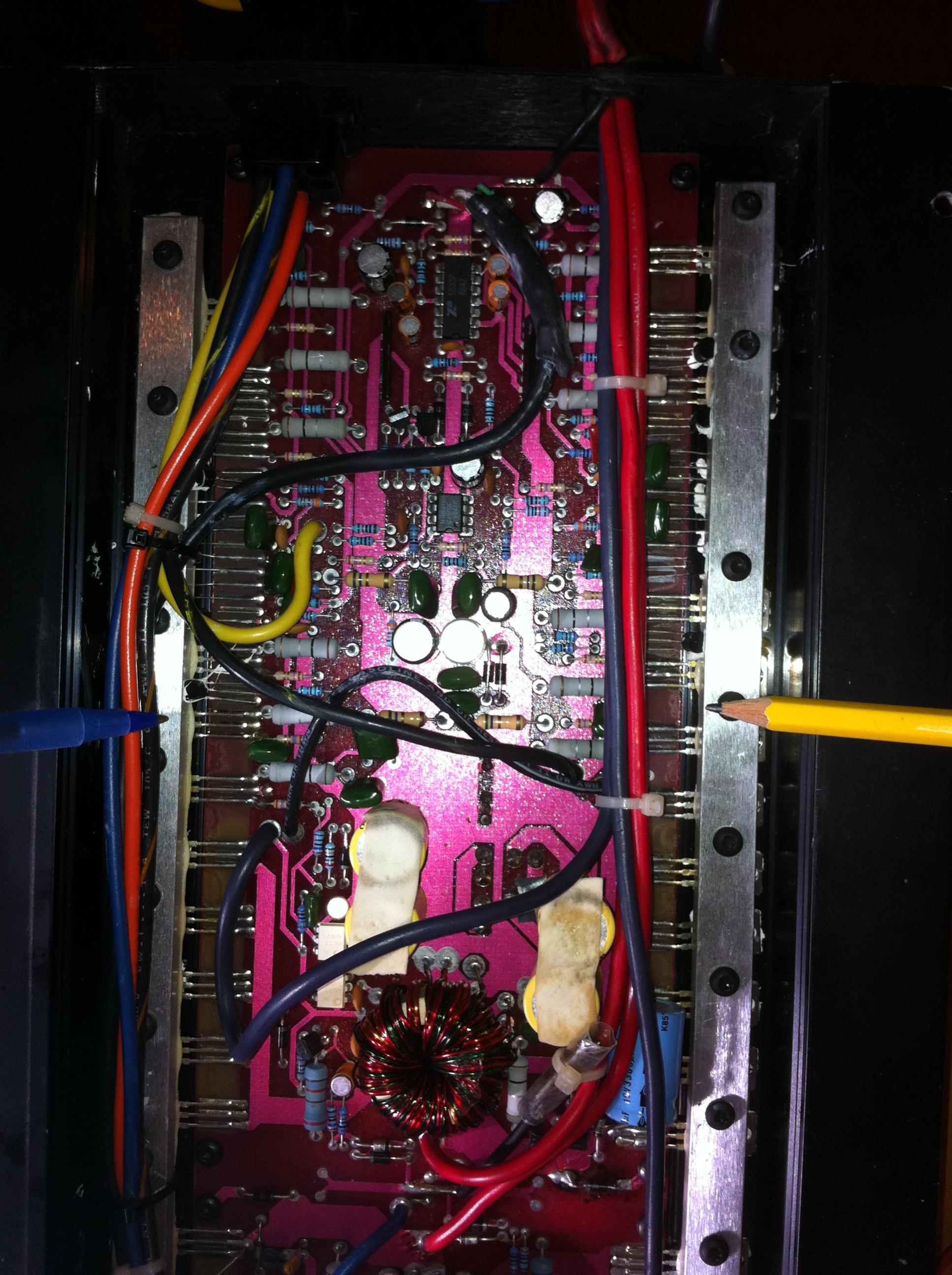

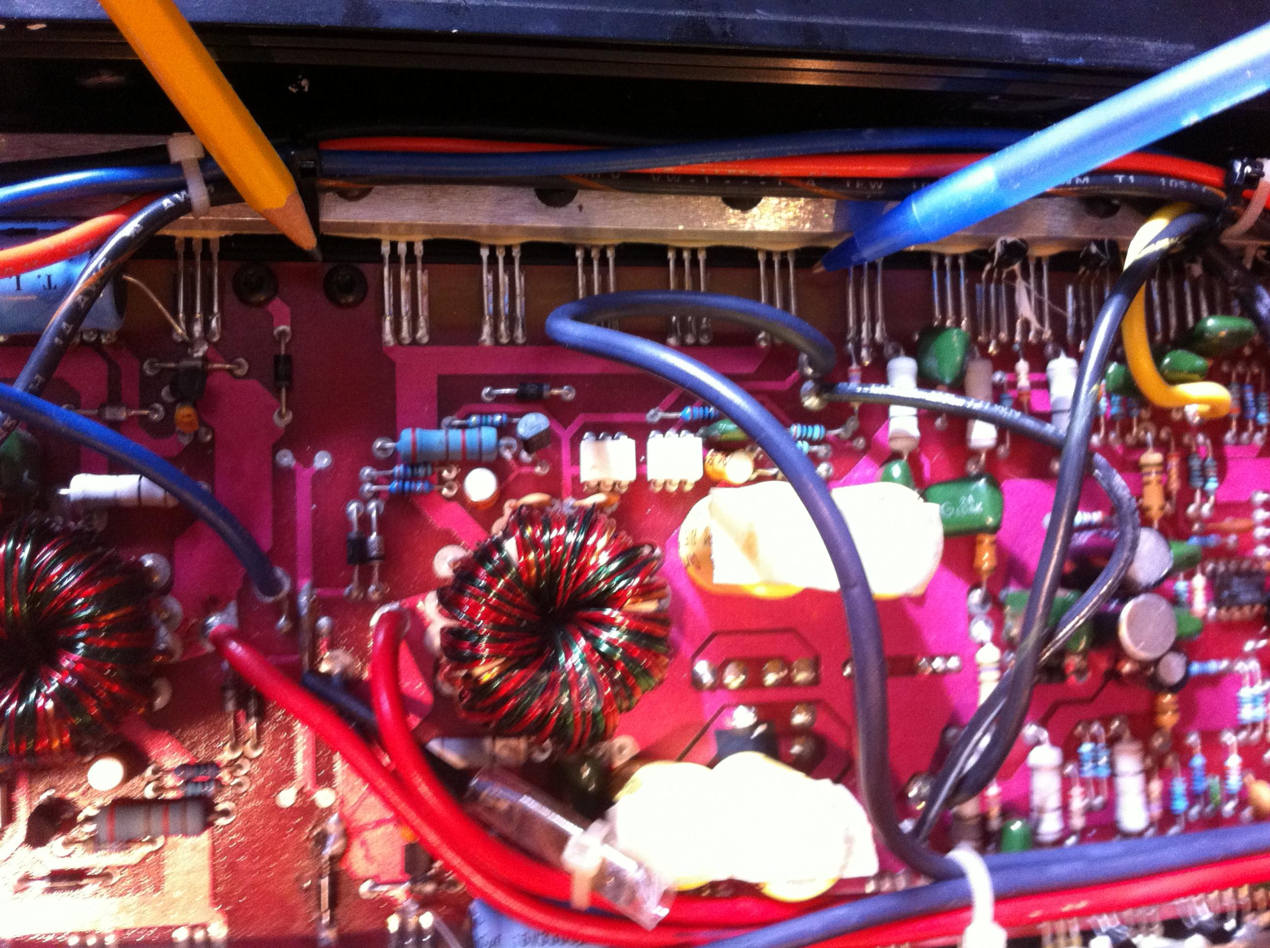

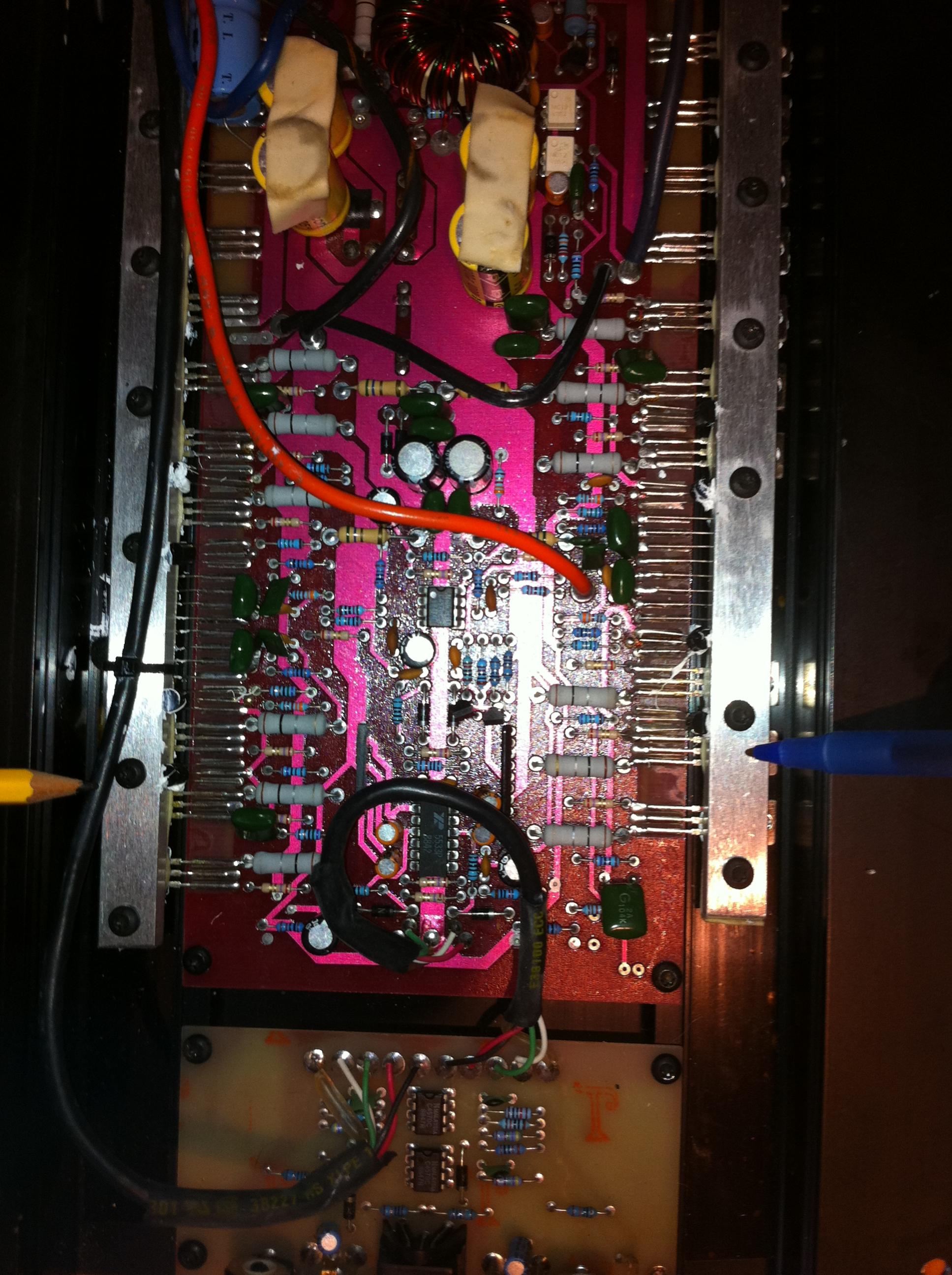

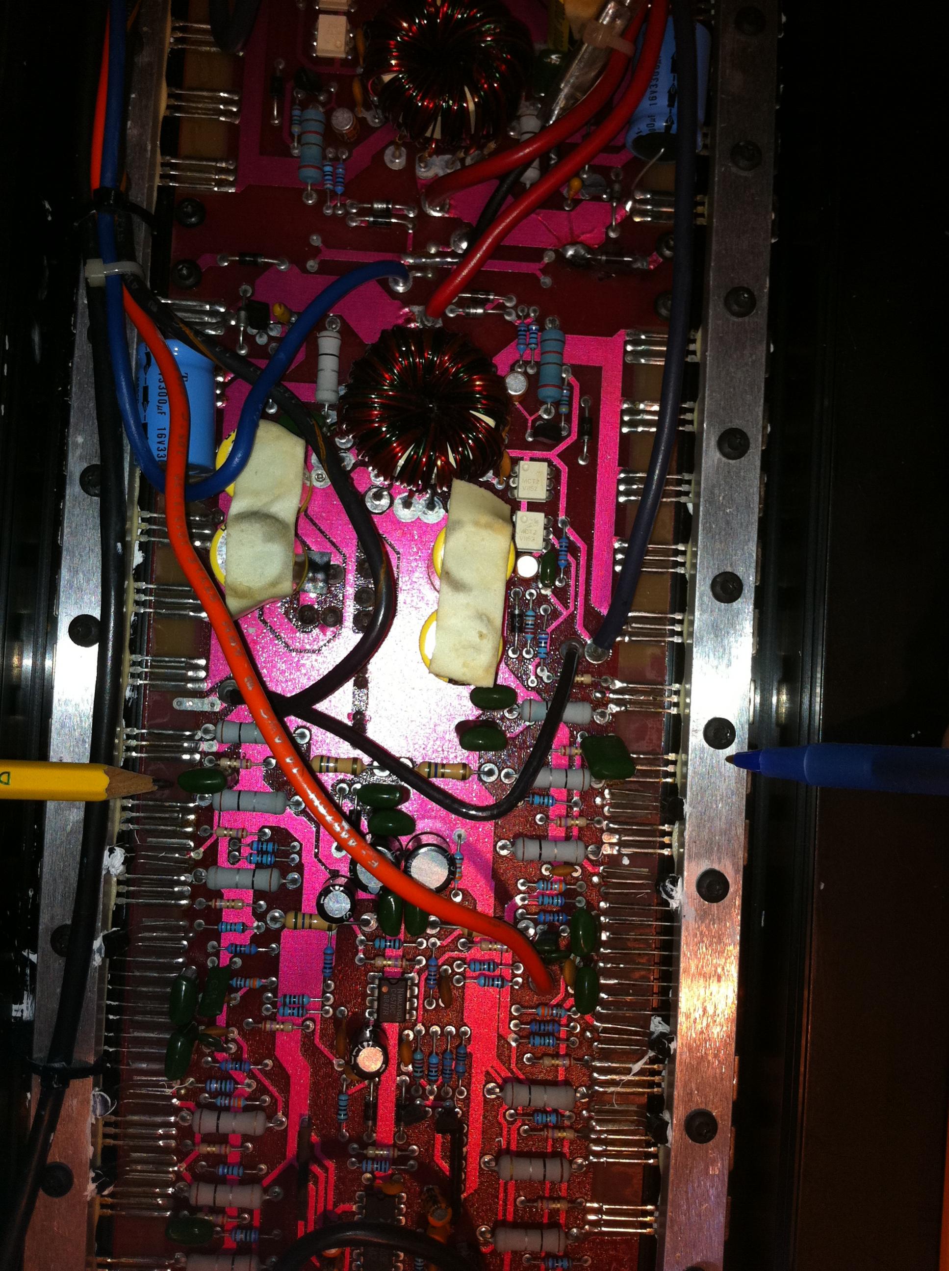

I do have +16.2v and -16.2v on the legs on the RH side of the amp(The end with the rca imputs pict.1&2) and +16.0v and -16.0v on the LH side of the amp(the end with the speaker outputs pict. 3&4).
Pic#1 Pos 16.2
Pic#2 Neg 16.2
Pic#3 Neg 16.0
Pic#4 Pos 16.0

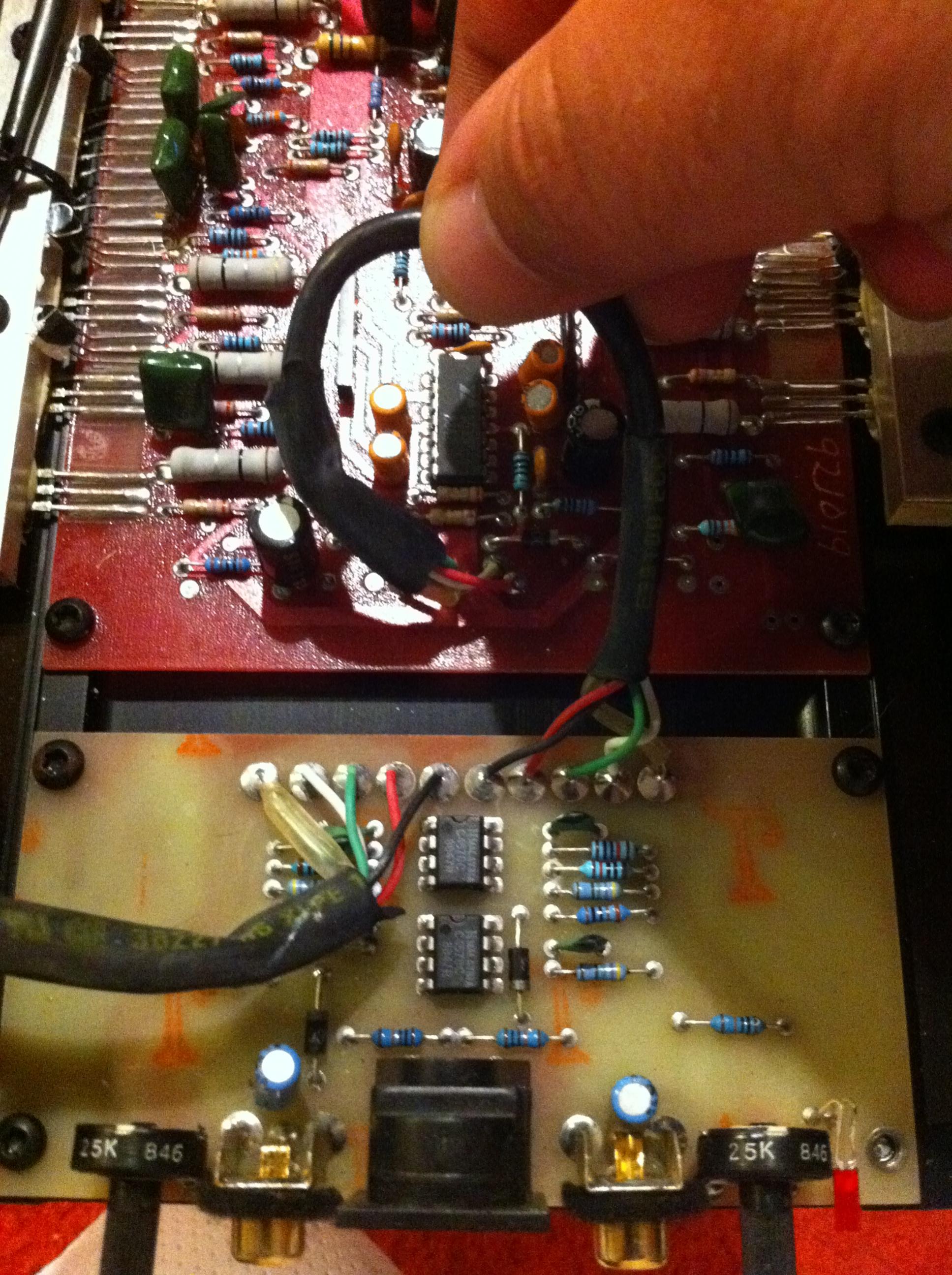

In Pic#5&6 Is the center section that has no readings on leg 3.(this may be normal)

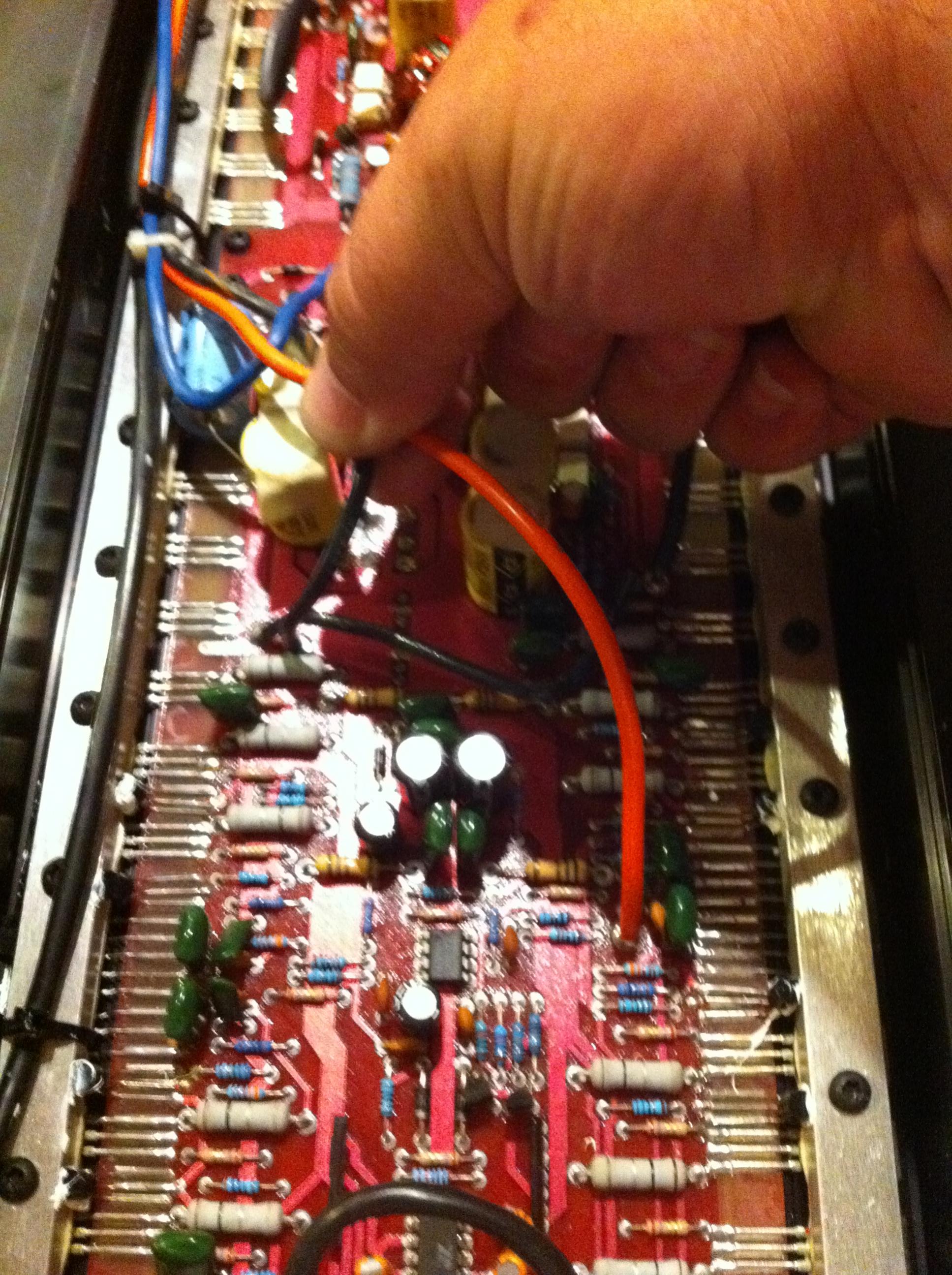

Ok, Just tested using the sm. ground wire as the negative speaker wire and one by one tested each wire.
Yellow wire= no sound
Black with yellow trace= no sound
Orange wire= sounds nice
Black with orange trace= sounded little sloppy. Not as deep or as loud for the set volume as the orange wire
hope this makes sence to you, I'm lost.

This is actually a 4 channel amp that has two channels bridged for each output channel. The tests seem to indicate that you have 3 defective channels.

Download this file, burn it to a CD (or whatever you can use to drive a signal into the amp).
http://www.bcae1.com/temp/100hz300seconds.zip

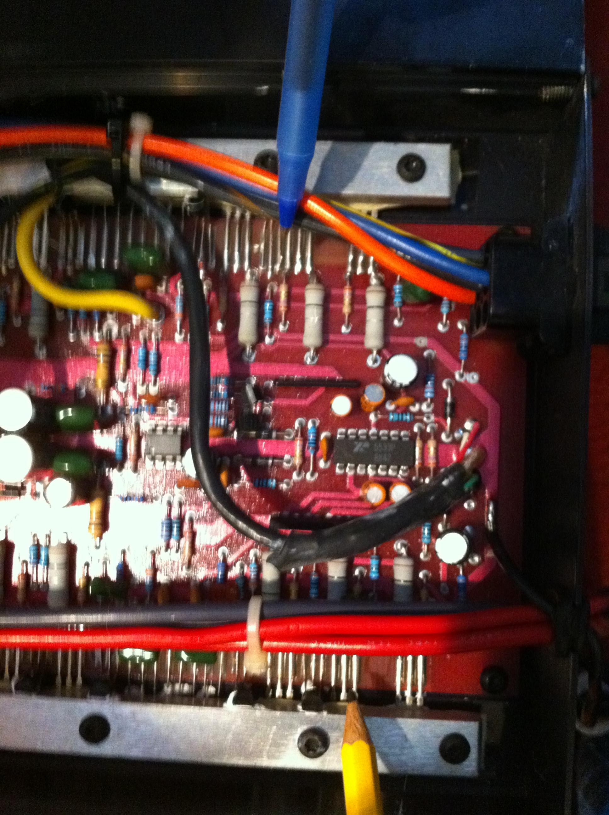

Drive a 1v signal into the amp (measure the AC voltage at the RCA jacks) and then measure the AC voltage on pine 1 and 7 of the op-amps on the preamp board. Post the voltage for those pins on both op-amps.

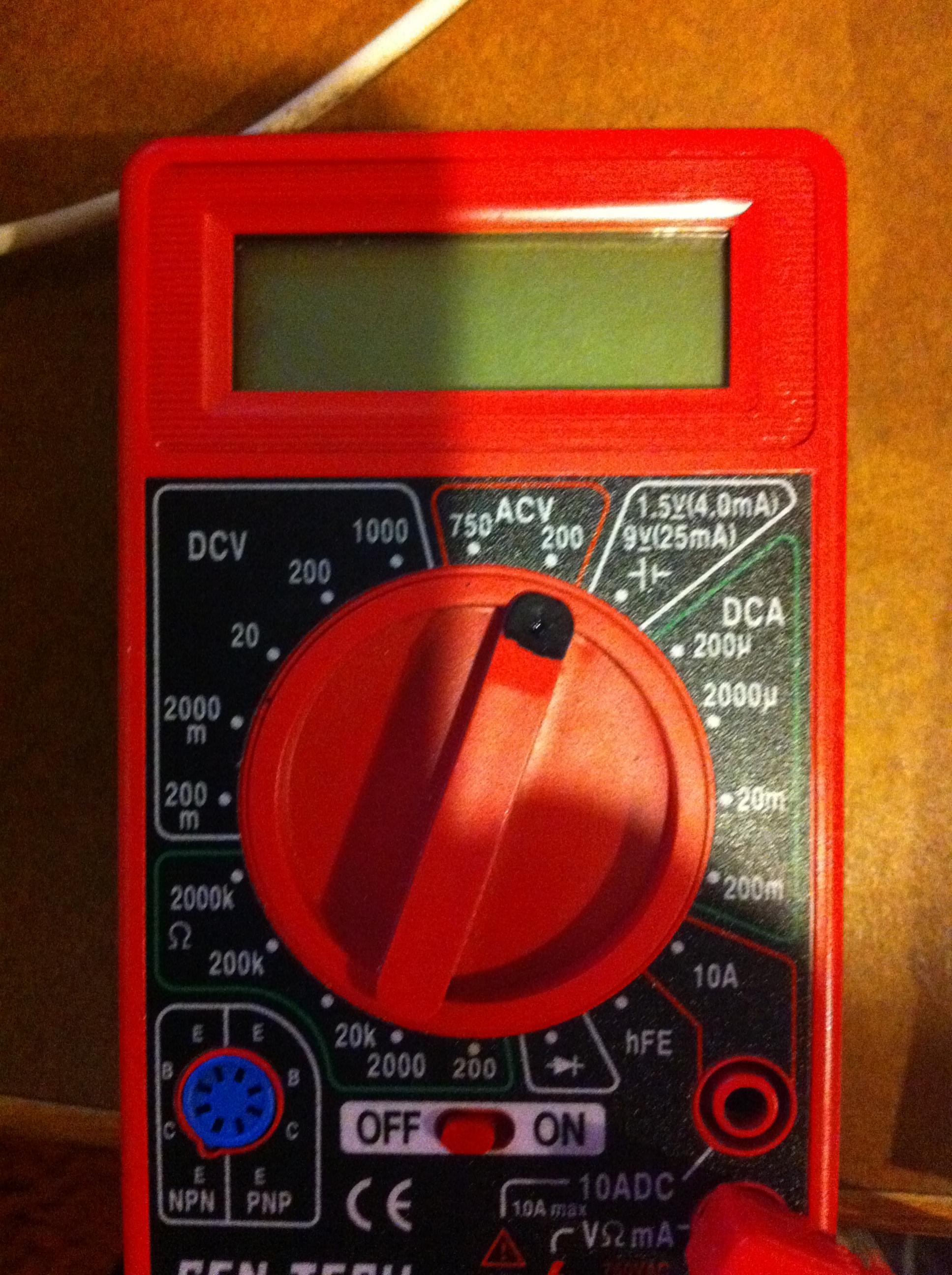

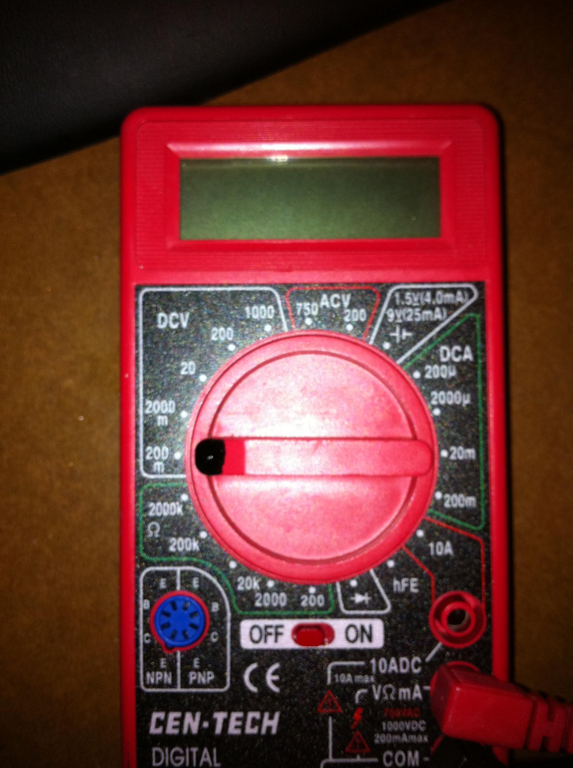

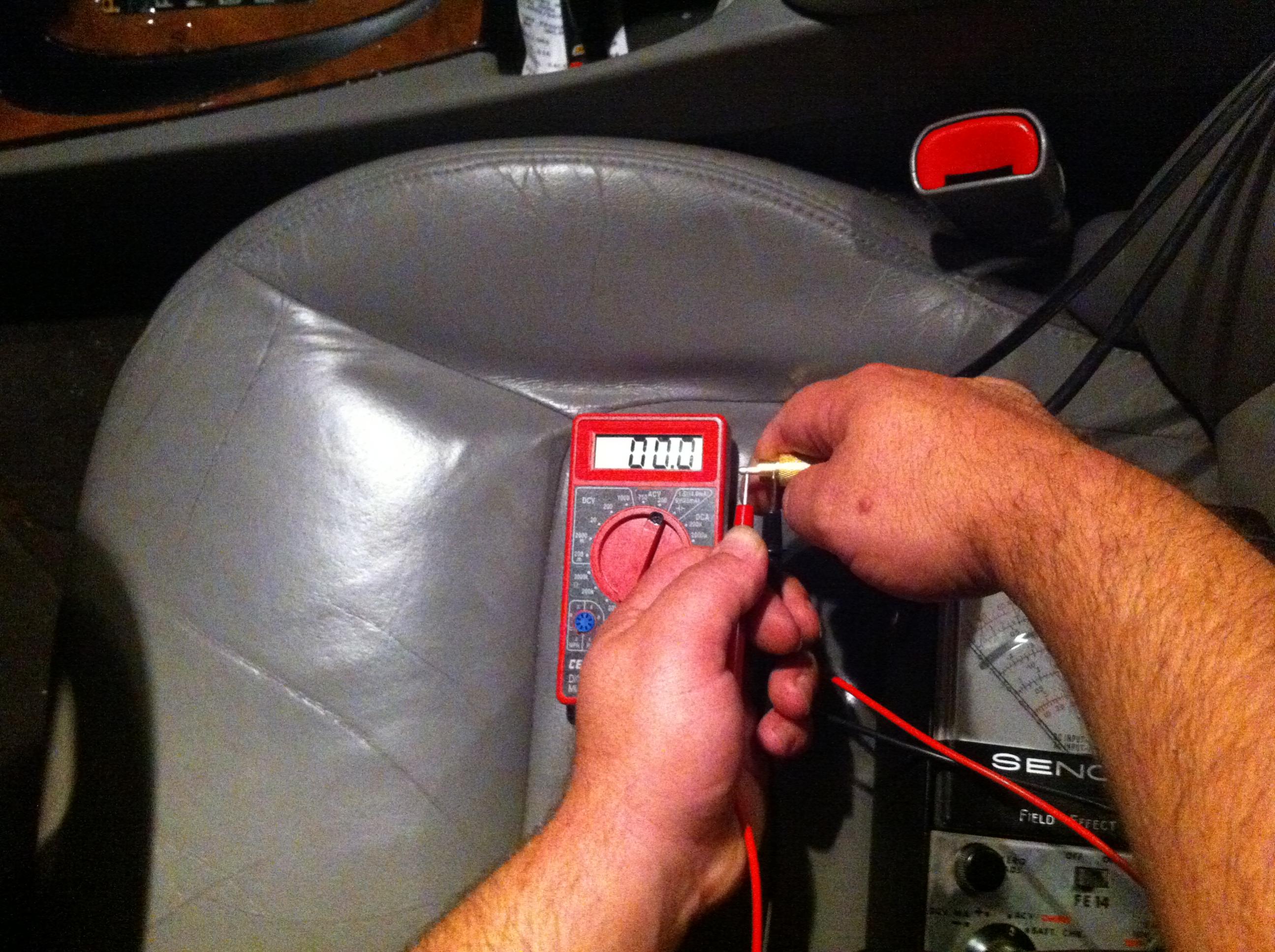

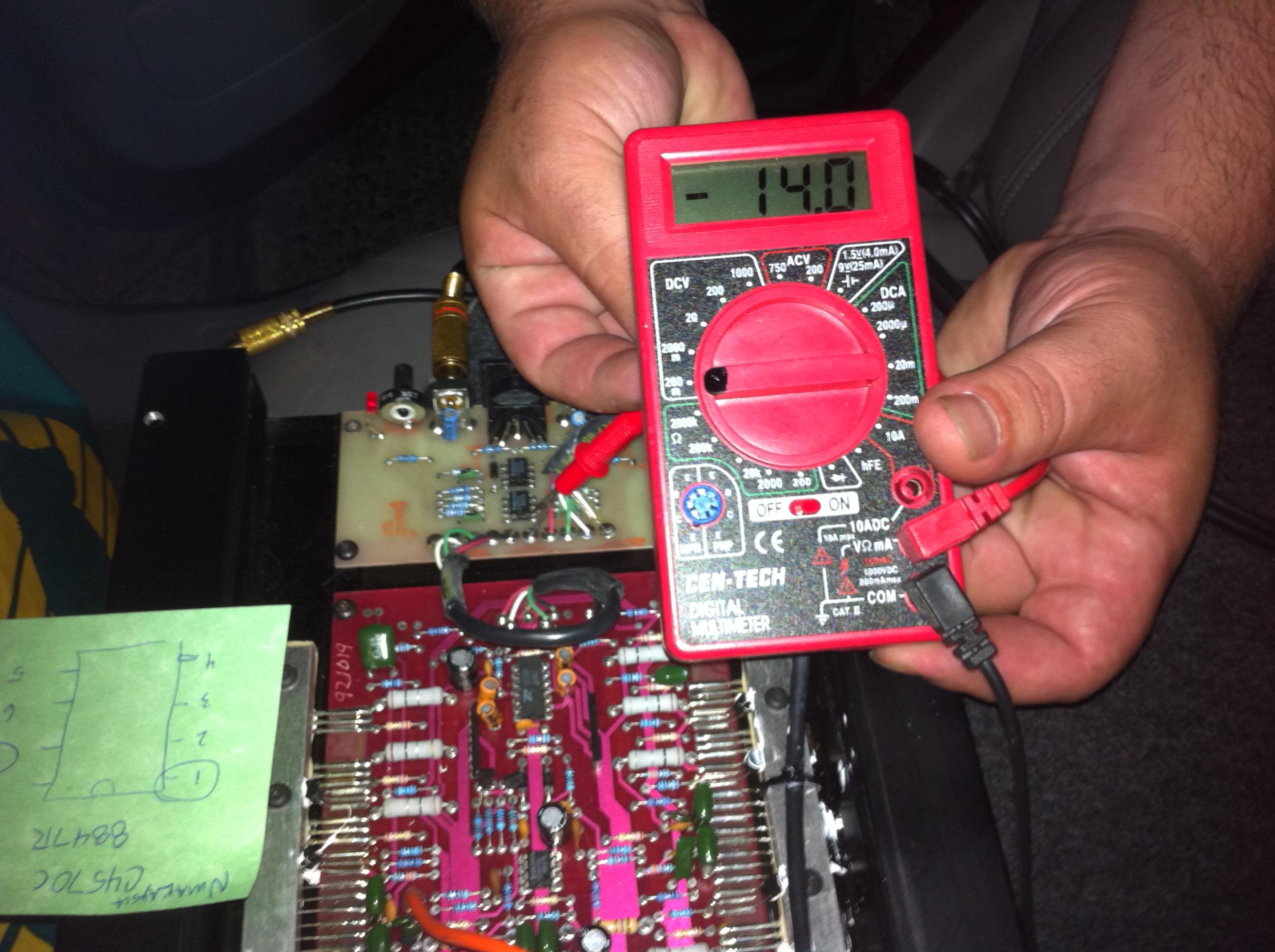

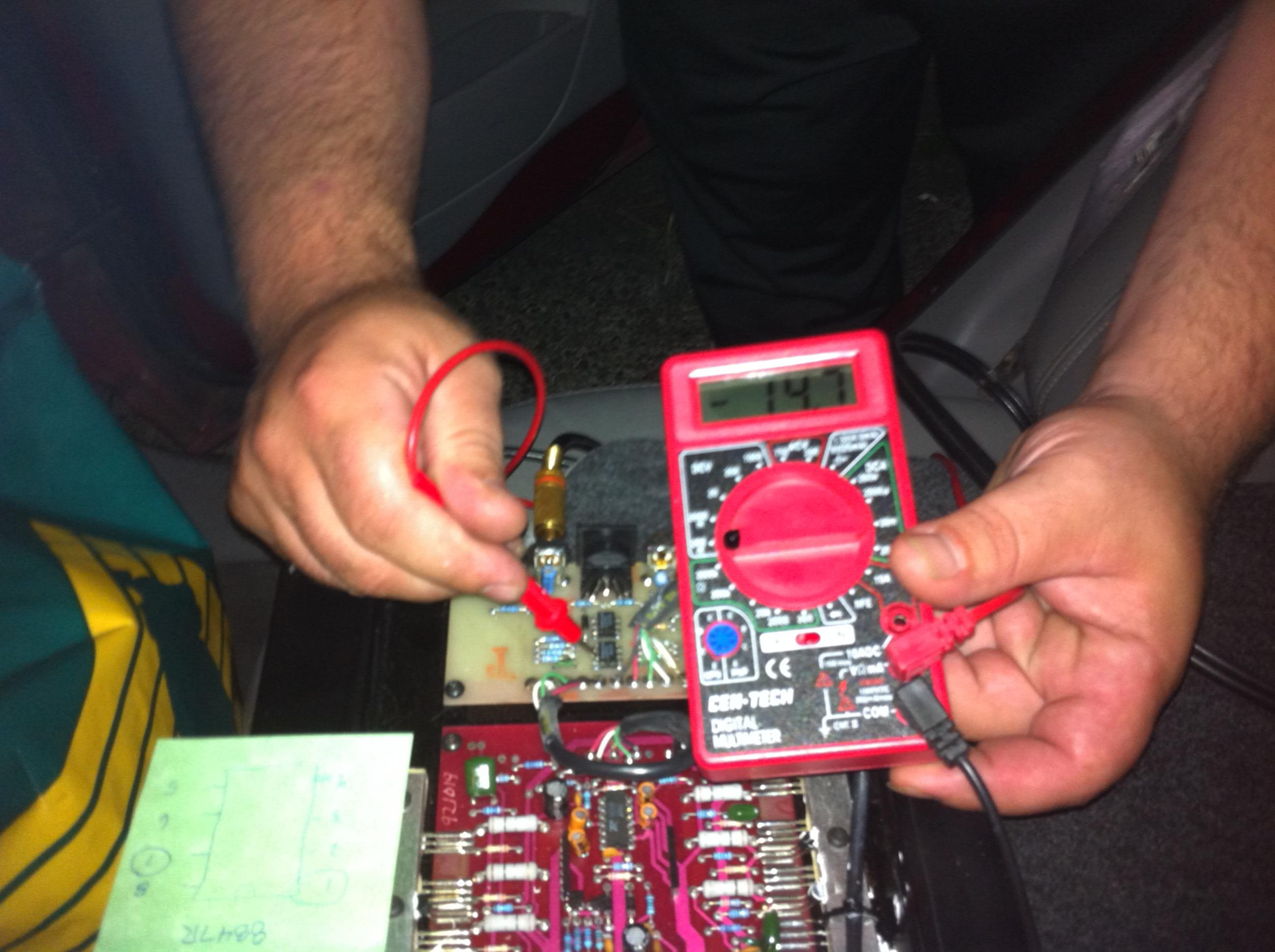

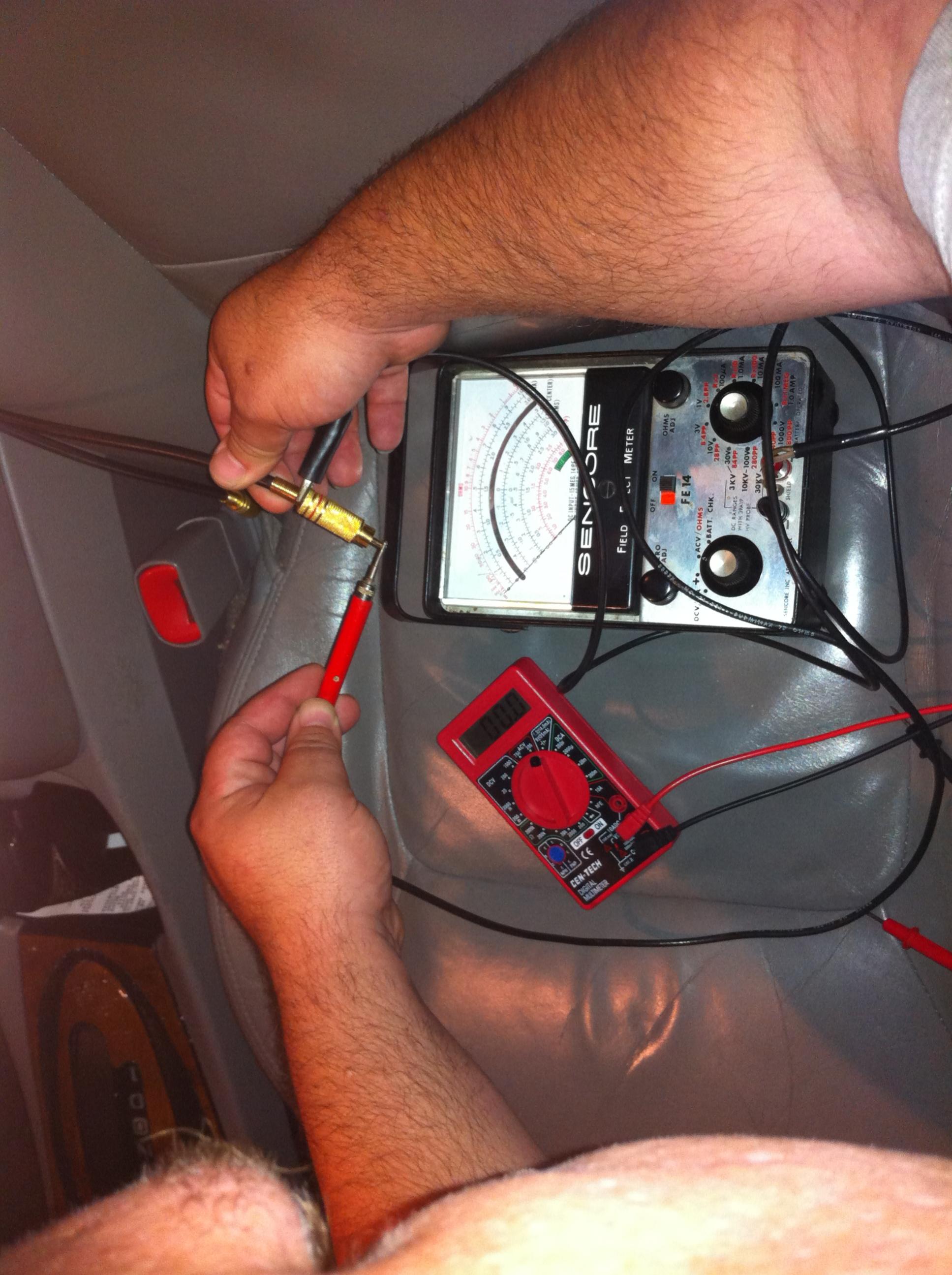

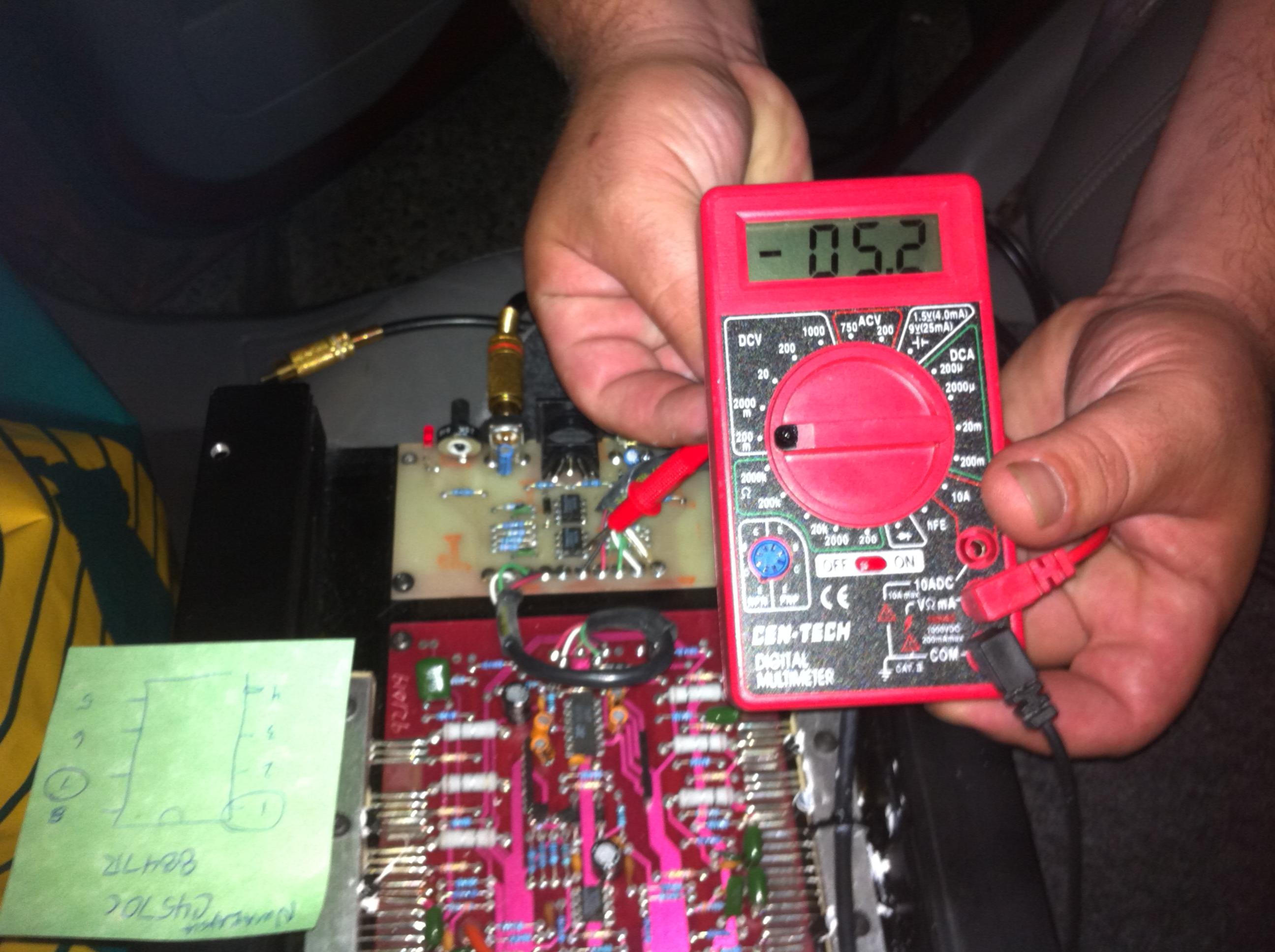

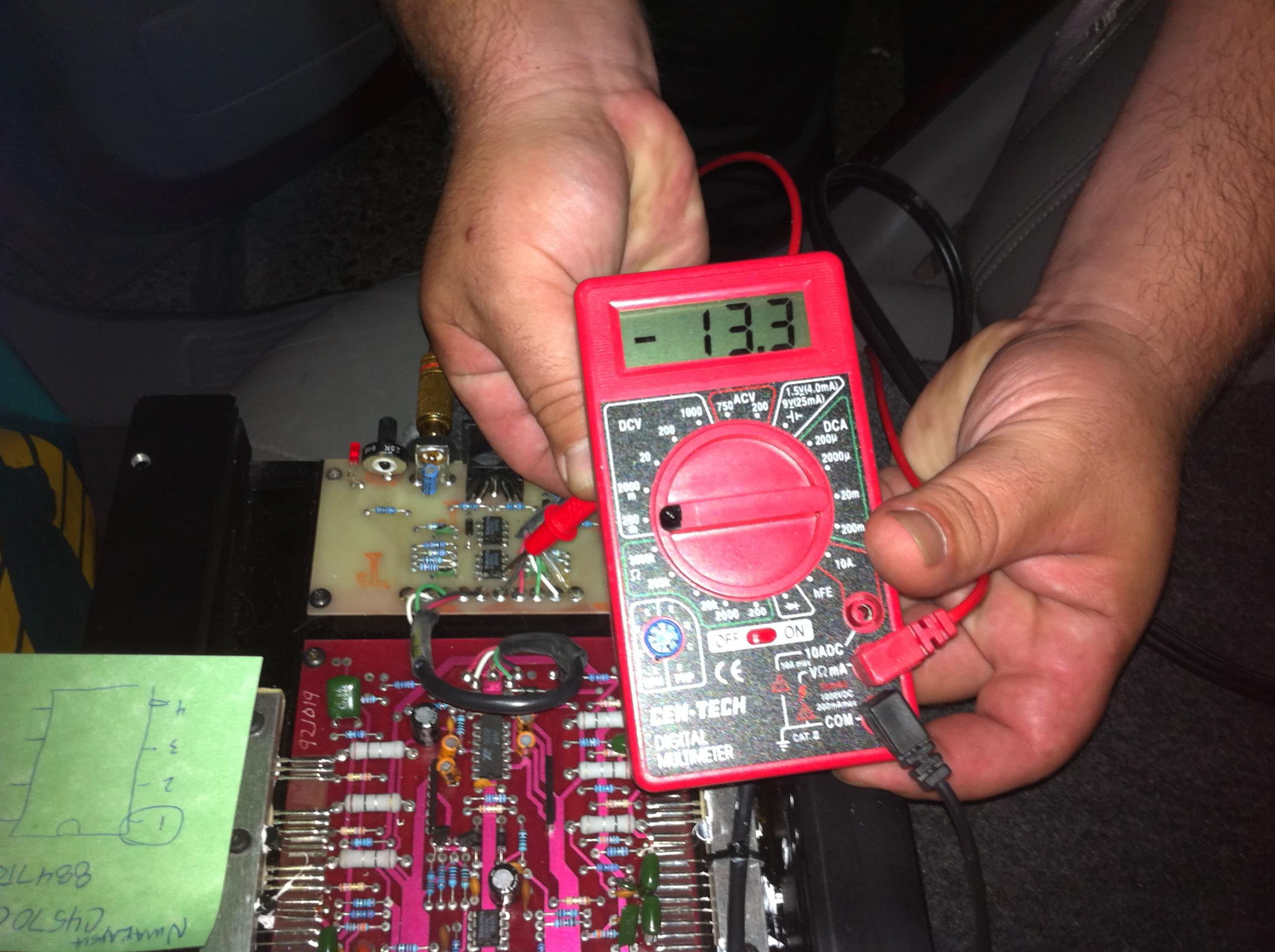

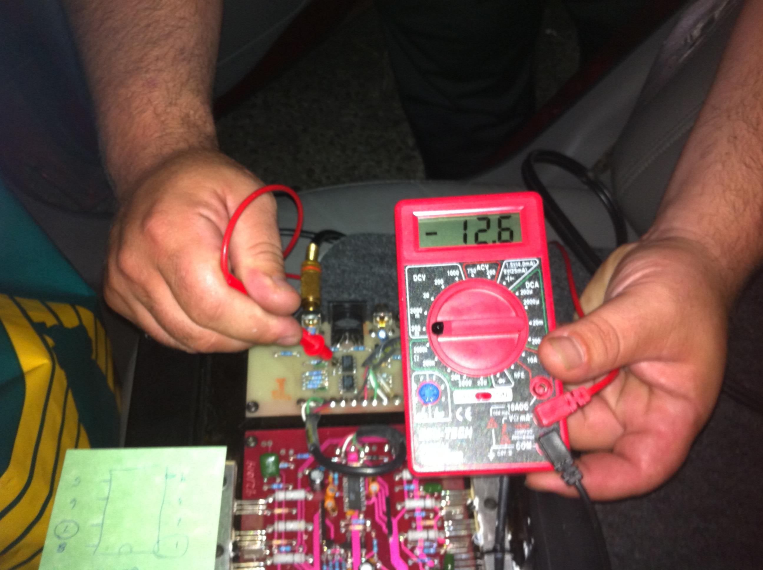

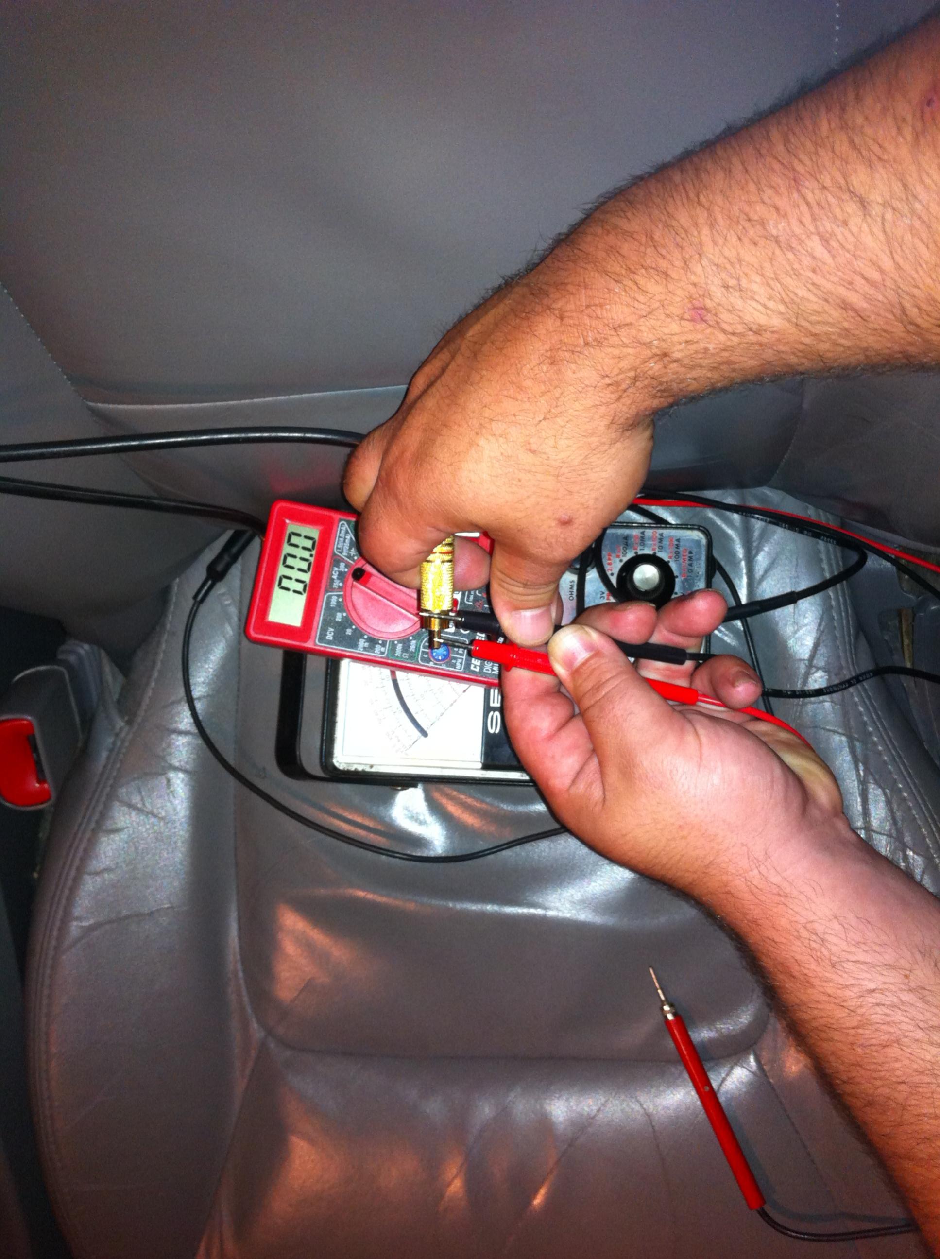

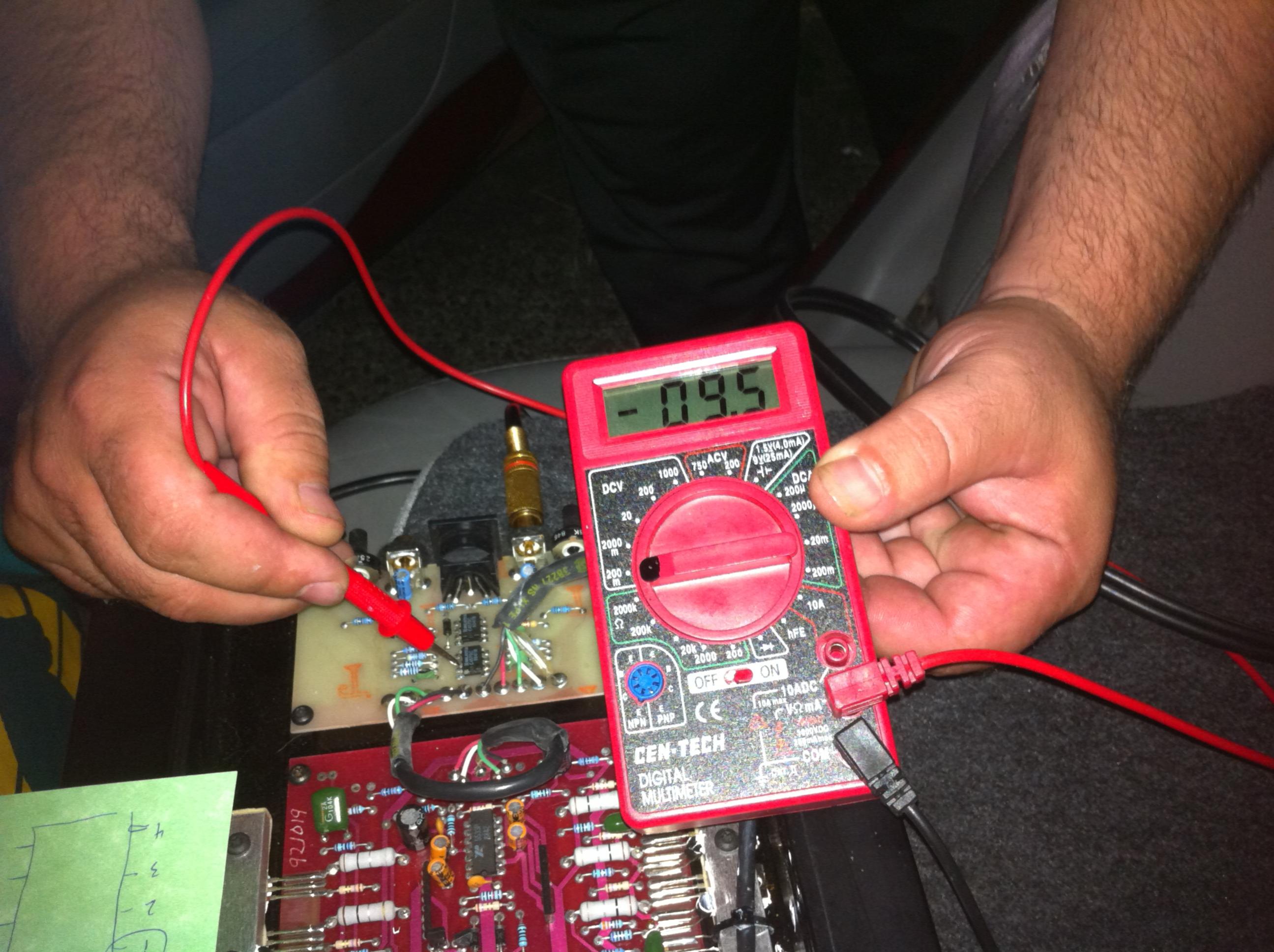

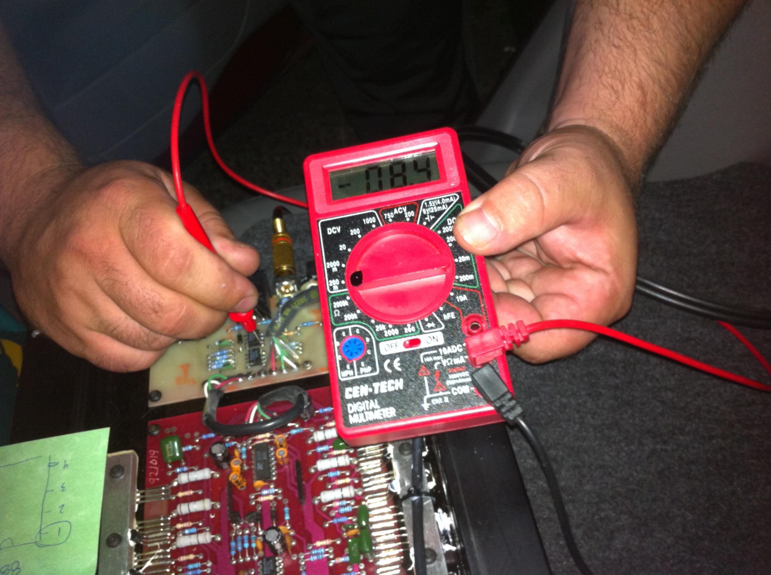

I did run the CD but I have no way of generating a 1v siginal. I tried puting the meter on the RCA's and adjusting the volume to get 1v. My piece of S meter does not read anything coming out of the RCA's yet if you plug them in there is sound! I did run the volume around 1/4 of the way up and checked pins 1 & 7 on both op-amps. The one closest to the end of the amp reads (pin 1=8.7 and pin 7=8.8) on the one farthest from the end of the amp reads (pin 1=11.4 and pin 7=10.6)Please note that the only way to get any reading on the meter I had to set it to (200m see pic) so I'm not sure what that would be in VDC. I do not no if this is of any help since I do not have the proper testing equipment. Also I just realized I used the left and right RCA channels plugged in to the amp which may have a slightly differnt output voltage from left to right due to the line level imputs. Should I try to re-do the test using the same RCA imput on both channels to get a more accurate reading from left to right?
I just checked it again and I still get nothing when testing the RCA's. I even used some old meter I found in the garage(Old). Still if I plug either one into the left RCA imput I get sound.
This time I tested both op-amps with the same RCA cable. Volume set to 1/4th. With the RCA going into either input. The op-amp closest to the end appears to have less power than the one furthest from the end(not by much, but less). Below are several pics of the test but the meter is all over the place so it may not be much use(I never got the same reading twice in a row with the Harbor Freight special). I don't know if I can get my hands on a better meter but I'll see if I can borrow one. Sorry Pics got mixed up, so they may be a bit random. Thanks
