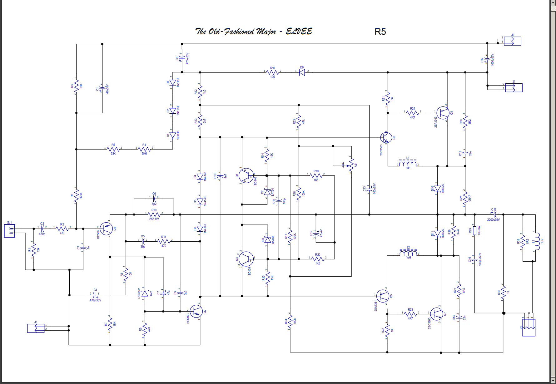

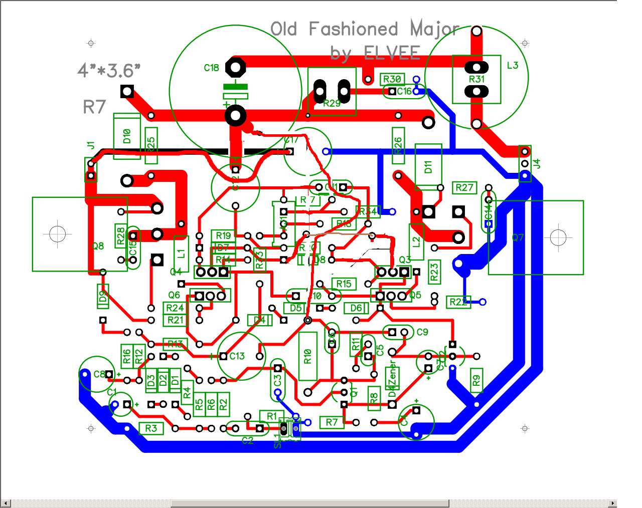

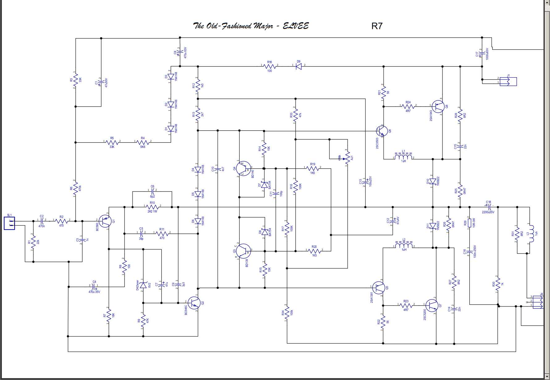

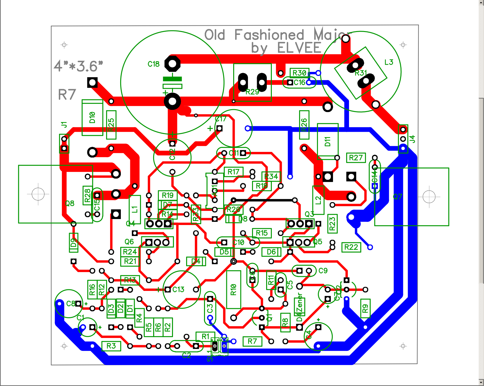

My first attempt at PCB design.
Please check Sch ver 5 also as some minor changes may be there.
Please remove .asc extn to open Dip-trace files.
--gannaji
Dear LV,
--gannaji

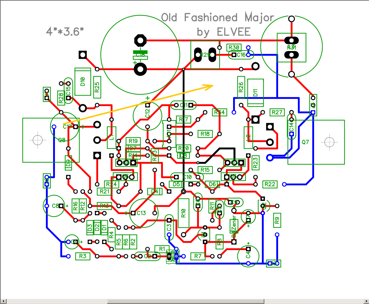

Where to begin...
Let's try anyway:
C17 should connect directly between the emitters of the power transistors, meaning it should be moved towards a more central position.
On its power side should arrive the supply connections and the GND of the speaker output.
On its amplifier side, the GND should connect to the input circuitry (J3) and the negative side of C1.
Its + side is relatively unimportant and can connect to the rest using the easiest path.
As said earlier, all the tracks carrying current (E & C of outputs, output, output GND, C17) should be made as wide as the space allows for.
In addition, the input GND track (with C1 C8 C4) should also be thicker.
R10 should connect directly to the + pad of C18.
By moving and rearranging some components and tracks, it should be relatively easy to arrive at a single-sided design (with maybe the odd strap, be I do not even think it is necessary)

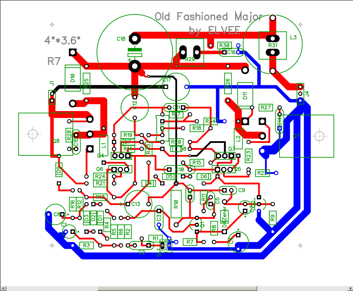

Where to begin...
Let's try anyway:
C17 should connect directly between the emitters of the power transistors, meaning it should be moved towards a more central position.Done
Done
Done
Done
Done. Can be done more by experts.
Done
This the best I could achieve. Hope this should be passable.
--gannaji

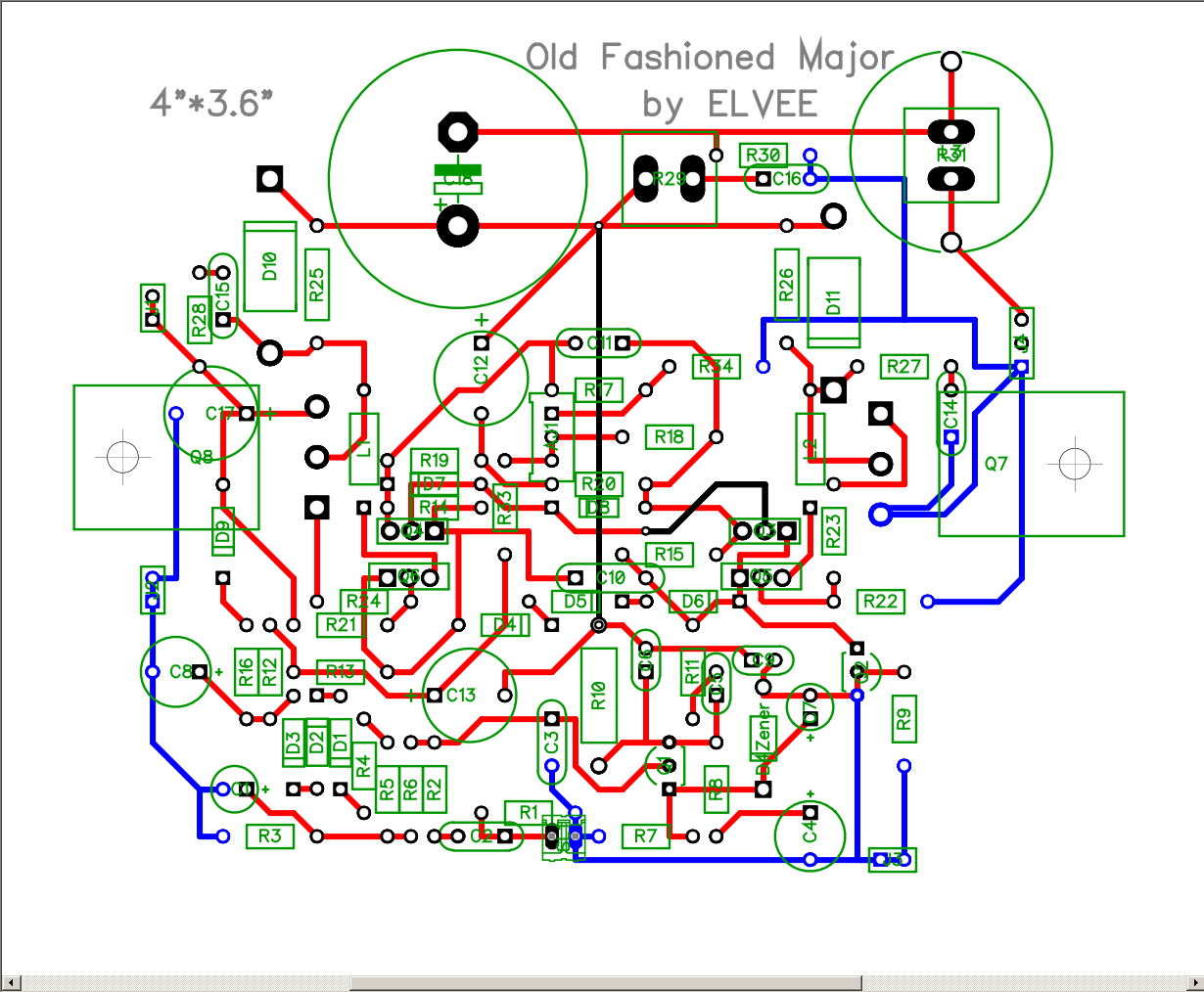

It should be good enough.
The number of tracks on the top could be reduced to one, and this last one could then be implemented as a strap, which I think is more convenient than having to process two sides:

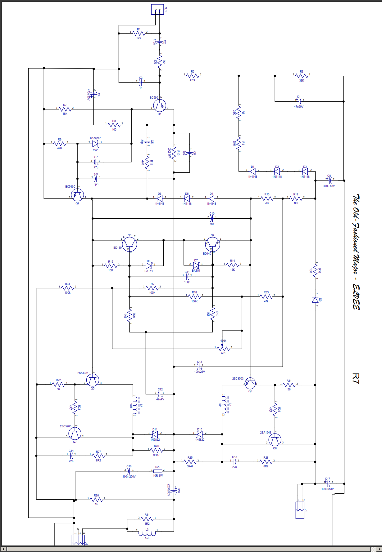

Dear LV,
Did the modifications I can do. My knowledge ends here with the program. All this I did in the last 15 days by trial and error. Now hands up.
--gannaji
