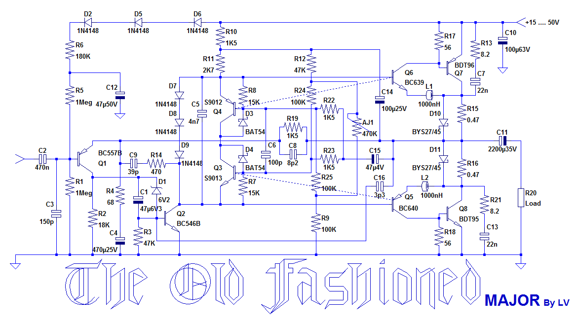

Following a request, here is the big brother of the Old-Fashioned lite:
The Old-Fashioned Major.
attachment.php
It also belongs to the series I proposed to Daniel, but it was rejected at an early stage, probably because of its messy look, both in schematic and in prototype.
It does fit the bill though: single supply, old fashioned techniques with the ease of a chipamp, transistor count <11, and good performance and flexibility.
Since it has to be as easy as possible for inexperienced builders, it also includes a smart bias scheme, making any adjustment unnecessary.

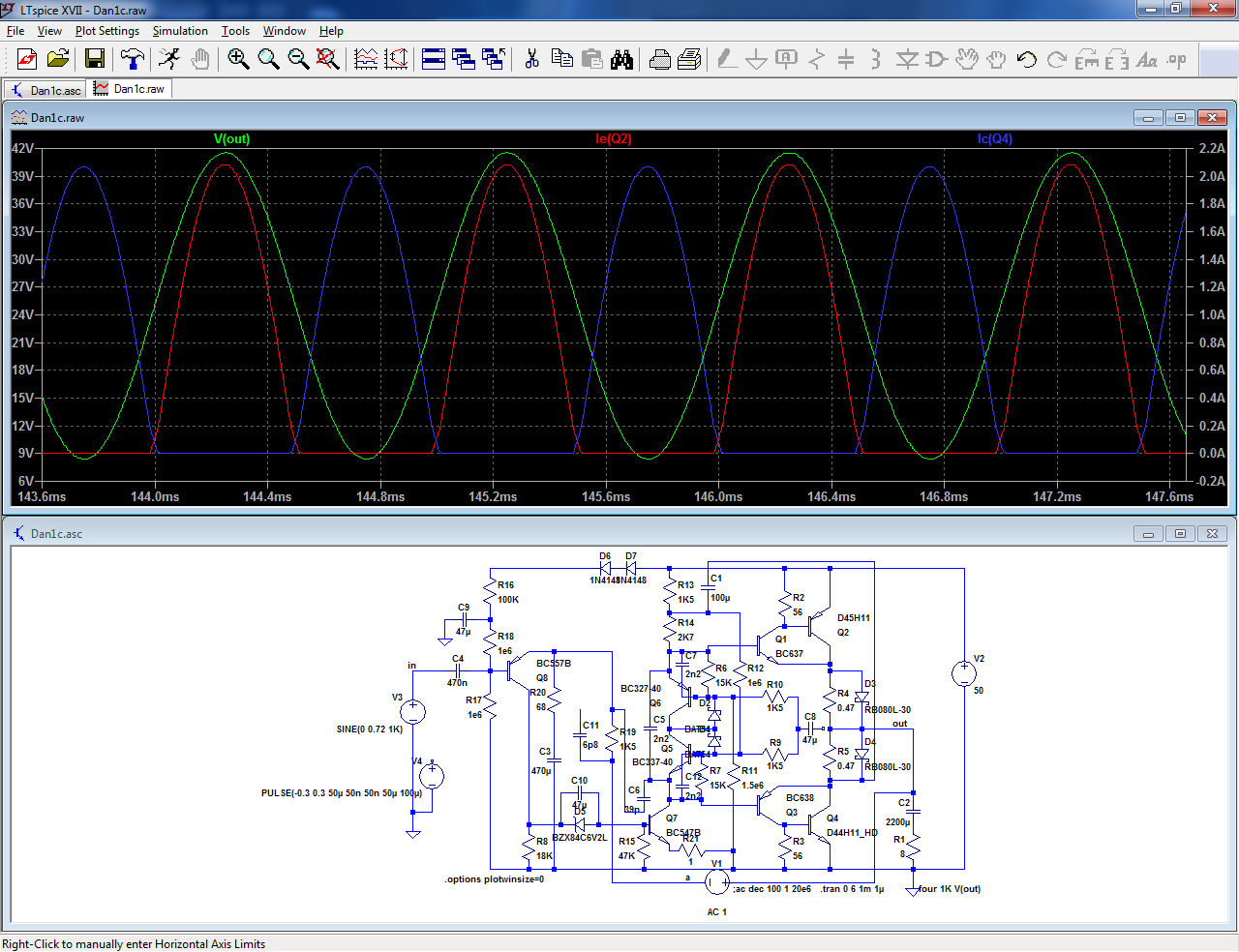

The strategy it uses is based on a completely novel philosophy:
It is neither the usual type of Iq servo, encountered for example in the EZmos, nor the trick used in the lite version, because this trick cannot be upgraded to work satisfactorily with composite OP's: in fact, the static Iq is not servoed, but a peculiar class B engine enforces a dynamic non-switching behavior, meaning the static value is essentially unimportant, and does not affect performances.

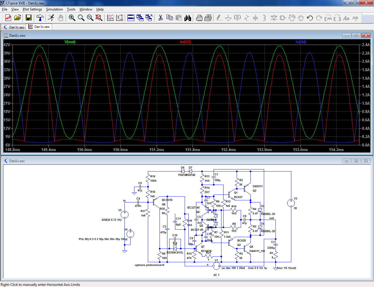

The class B engine is built with just two transistors, Q3 and Q4: without C4, they would just form a bog-standard bias spreader, as this sim illustrates (sorry, the graphic version is not functional, the sim is messy, and C4 becomes C8):
attachment.php
When C4(8) is in service, the class B engine becomes operative, as can be seen here:
attachment.php
Now, all the transistors conduct all the time.
It works rather well: the measured THD @ 35W/8Ω is 0.004%, which is quite respectable for such a simplistic circuit.
It is also quite efficient, and swings to within ~1V of the supply rails.

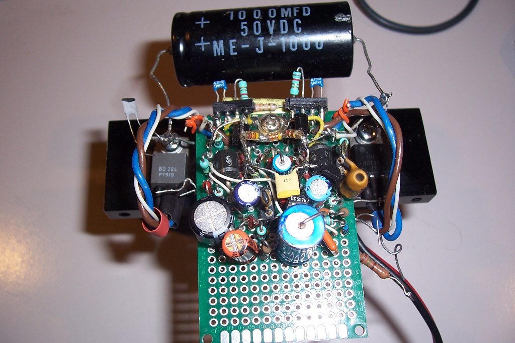

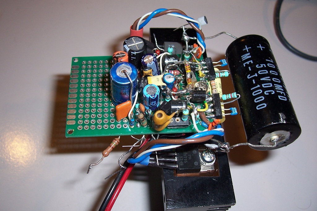

Here are some pics of the prototype(!):
attachment.php
attachment.php
attachment.php
On the prototype, a BDT96 was replaced by a BD204 because i managed to fry it (how surprising!), and I had no spare.
It has experienced a number of shorts from OP to the supply rails without damage, but the sixth time was fatal....

Great that this concept is being updated beyond the .06% HD of the AX6.
I can acually buy BY527 with leads, but all the BAT54 at farnell US mouser US & digikey US still have no legs. 6v2 is maybe a 6.2 v zener?
Being US based I'd use MPSA56 input, MJE15028/29 as q3/q4 q5/q6 and MJL21193/94 as outputs, but that is just because I have them on the shelf. I have BD139/140 as drivers but they are fairchild without the Phillips Ft spec. The On drivers are 30 mhz ft. Any gross mismatches please highlight. Group buy on the schottky diodes North American readers?
I can acually buy BY527 with leads, but all the BAT54 at farnell US still have no legs.
BYS27, not BY527, but any large schottky will do.
I didn't use a BAT54 actually, probably a BAT43, 48, 85 or similar: it does not really matter any >200mA schottky will do.
I know there is a 1Nxyzz type too, but I can't remember the exact type N°.
Can someone help?
Being US based I'd use MPSA56 input, MJE15028/29 as q3/q4 q5/q6 and MJL21193/94 as outputs, but that is just because I have them on the shelf. Any gross mismatches please highlight. Group buy on the schottky diodes North American readers?
MPSA56 is OK, MJE15028 is much too large (it will work though): opt for something more reasonable, in TO92 or TO126 at most (even Fairchild's), or a good old TO5 like 2N2905 and 2N2219
Basically the design is undemanding: you need to respect basic Vceo, Icm, Pdmax and SOA ratings but that's about it
For North-American members, the MP-- series has all the types needed for the signal part: MPSA, MPSL for the low level and general processing, MPSW for the drivers.
The 2N series also has an infinity of suitable types (don't mix Ge with Si types though).
The S9--- series originally from Fairchild will also work, even cheap chinese versions (my prototype uses two of them).
Of course, the 2S series also has plenty of suitable types.
Don't go overboard though and use types with 2GHz Ft: that's asking for trouble and won't bring any benefit
To summarize:
The purpose of the amplifiers designed for Daniel (EZmos, Oldfashioned) is to offer a decent performance level with dubious or even crap components, combined with minimal or zero adjustment.
Don't push it too far though: for example using a 2N3904/6 pair as OP will lead you straight into a wall...
Ha, newark (farnell US) & digikey have BAT48 a 350 ma 400 mv schottky diode with leads, from ST.
BYS27 is not available from farnell US, digikey, mouser, nor does datasheetcatalog.com have a sheet for it. What back voltage min, what working current, what vf @ what current were you expecting? You reacted in horror when I suggested subtituting the ON semi 100 piv 1 A schottky diodes I have for the bat54 in the oldfasioned.
I've tried to buy 2n2019 2n2905 TO5 parts since I found the burned ones in the dynaco ST120 ~1985. The single survivors I have are driving the best sounding amp channel I have (ST120) with the djoffe 7 transistor bias control circuit addition, but NTE49/50 (TO220) and TIP41c/42c are sluggish substitutes (on the AX6 board) that don't have as good high frequency IM distortion. Hence my fascination with Ft, which is unspecified for NTE49/50 and is 3 mhz for TIP41c/42c. BD139/140 is thrown around a lot on here as drivers, but the specless fairchild parts we can buy here may be nothing like the phillips originals.
I got 100 MPSW56 2.5 watt TO92 in the great ON semi phillipines fab closeout, but matching MPSW06 are available only from a surplus house. They are not ON semi parts and though I bought some, I don't trust them. I bought some newark 2n5682 TO39 parts (metal can) 10W 120 v to complement the MSPW56 as drivers, they do have a 30 mhz ft, but the QA is all farnell. Who knows how quiet they are? At least they will take a heat sink.
I trust the MJE15028/29 from farnell to be real & fast, they have a nice heat tab in TO220, but Cob may be high.
The BYS27 can be replaced by any 3A schottky: 1N5820--->22
The input transistor can be any PNP low power, >30V, >100mA, say 2N4403
The VAS can be a 2N5551
2N4401 & 2N4403 for the class B engine
The Fairchild BD's are OK as drivers (the MJE15028, 29 are overkill but they will work too)
The MJL's will obviously work as OP.
A word of caution: of the three projects (EZmos, Old Fashioned lite, and Major), the Major is the less mature.
EZmos has been refined and studied in depth and is completely mature, the OF lite has received a bit less attention, and the Major has been rejected very early, meaning some aspects may still need to be explored and discovered.

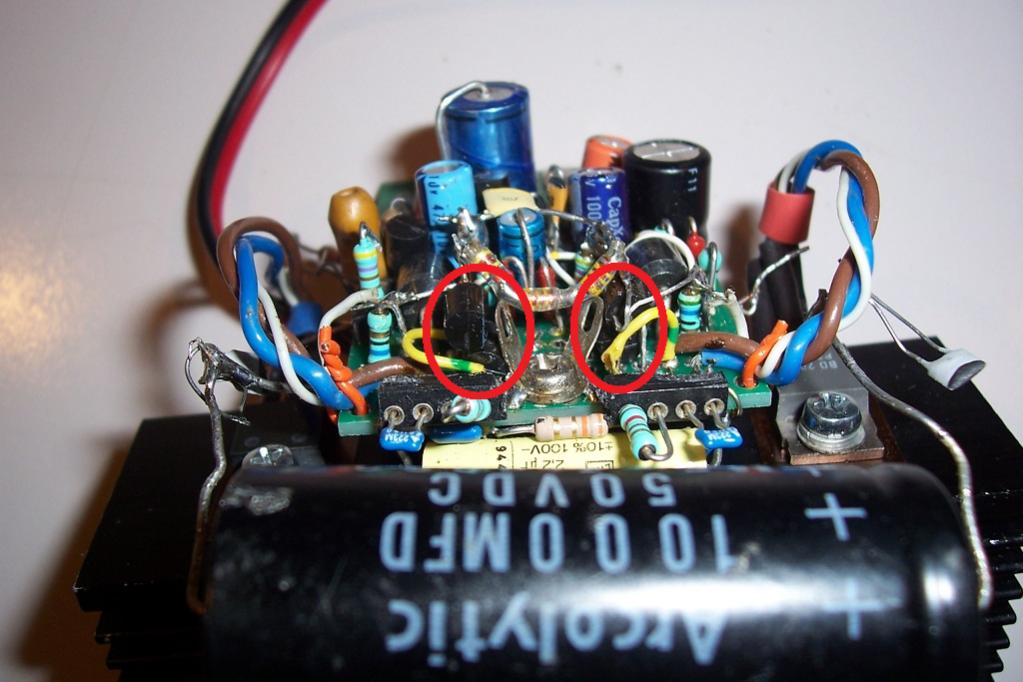

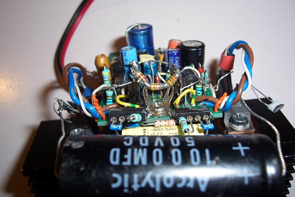

I suppose the dotted lines mean the class B engine transistors are screwed to the heat sink with the output transistors? I was thinking MJE340/350 or BD139/140 in stock for those, they have a heat pad.
The primary thermal connection is between the engine transistors and the drivers (because of the CFP OP): they are in direct contact, as I tried to highlight on this pic (not very visible, the epoxy of both is black).
attachment.php
A secondary thermal connection is made with the OP transistors, via a metal standoff and the two solder tags, also visible on the pic.
It is probably not necessary to exactly observe this construction, but the hierarchy of the couplings is correct, and should be kept in mind when planning the layout/building.
Although the 250 mhz Ft of 2n4401 might be important. I have 150 mhz MPS8099 KSC1845 & KSA992 if the Ft is more important than the heat sense pad.
The Ft in this case is almost irrelevant, thermal contact is very relevant.

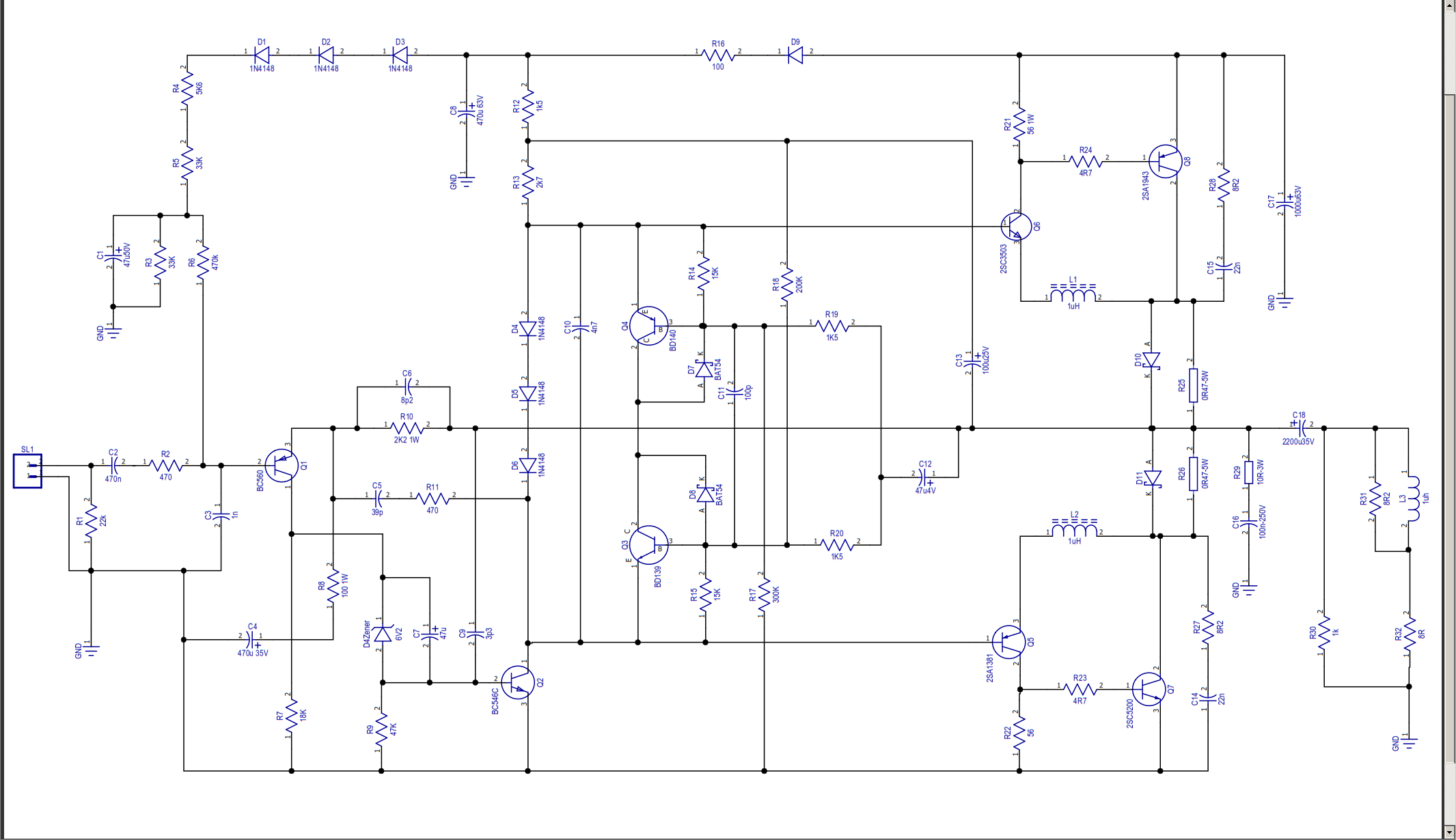

Dear elvee,
I had entered the file in Diptrace and enclosed. I tried to follow the schematic posted by you. There may be some mistakes. Kindly check the scheme enclosed as png. I made a few minor changes. The BJTs shown are the ones I am having. The input scheme is adopted from your "Single supply Circlophone".

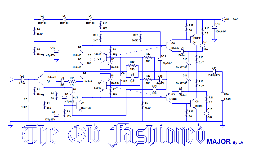

OK, I thought the folder contained other info, like layout.
The OP transistors are quite fast compared to what I used, and you might experience instabilities, requiring some values adaptation, for example R27, 8, C14, 15, L1, 2.
R29 C16 should not be necessary, but you can include them on the PCB and leave them empty.
Many resistors do not need to have a high power rating: R25, 26 can be 0.25W.
R8, 21, 22 too.
R12 should be 0.5W.
Remain aware of this warning:
C5, C6 and C9 might need to be tweaked.
With this in mind, it might also be prudent to include the possibility of quiescent current adjustment: I do not have enough experience with this circuit to guarantee that it won't need one.
Here is how it could be implemented:

Thank you elvee ! I shall do modifications in the Dip file and post. Assuming the numbers you refer are as per your diagram !
A good experiment to do !
