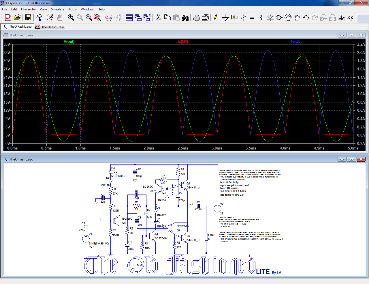

I played with it a bit and realized what the "automatic bias" does is move most of the cross-over switching to the faster transistors, which can be drivers. Doing it that way, I got similar results ~ 0.007%THD. IE drivers (lots of current) and no Schottky diode. Probably good enough for most applications and thermal worry free.
Not my favorite way to do a single supply voltage; I'm sure it has a serious turn on/off thump.
Your D44H11 model has a lot more gain than the standard LTC model, which is important for the single EF stage. With the standard model, you run out of current and get a premature positive clipping.
I would spend the extra $1 for current limiting, but that does increase the parts count.

Yes, I mentioned the switching aspect in the explanation:
To sum up: Q1 will always conduct, even during its "quiescent" time, but the conduction of Q2 will be hard-switched, depending on the need: this is why the circuit is both switching and non-switching.
The switching aspect might seem to be a potential source of artifacts and discontinuities, but this is mitigated by the fact that Q1 remains always in conduction, thus keeping a certain control on the output, and the role of D1 to D3 is to reduce the magnitude of the discontinuity from ~3Vbe to 100 or 200mV.
It would be easy to keep both Q1 and Q2 in conduction all the time: simply add the N counterpart of Q3 to the base of Q2.
In reality, there is not much benefit in doing that: firstly, it consumes one Vbe on the non-bootstrapped side, reducing the output swing and the low-voltage operation ability, and secondly, it is not necessary: with a step of 100 to 200 or 300mV, the output is able to "ride over" the trough thanks to stored charge and similar effects, and the fact that the phenomenon is completely local, just confined between the collectors of Q3 and Q4, not relying on GNFB, thus very fast.
This is confirmed by the THD residue, where no Xover artifact is visible.
When one of the diode is shorted, small artifacts become visible on the waveform, but the global THD figure remains utterly unchanged.
Thus, it is important to minimize the step, and the magnitude of the step depends on the OP's temperature, which is why minimal thermal tracking is necessary.
If the voltage step is small enough, around 200mV, the Xover artifacts disappear completely from the distortion residue, as the oscillogram showed.
Note that only the aspect of the residue is important as a criterion: you can have both 0.007% global THD and nasty spikes, because the energy of the spikes is very small.

Yes, I agree, and this worried me, but I couldn't find a way of eliminating it without additional complications, whilst keeping the other advantages intact: the ~1 to 10 supply range without changing a single component, for example.
If you find a simple way of eliminating it without affecting the other features, I (and the DIY community) would be glad to see it.
Any other mod or improvement you can think of is also welcome

The project was designed according to Daniel's preferences, and he selected the transistors types and also provided their models.
In my build, I used the BD43x series, and they were suitable
...And Daniel preferred it with no FETs....

The transistors you gave as examples have a Vce of 250V: that is ~10times what is required for this type of amplifier.
Inevitably, a high Vce negatively impacts the Hfe, even if they are quite good, something like 100.
You need a low-voltage (<40V) transistor optimized for high-current, high Hfe application, but finding them in a large case, TOP3 or TO247 is going to be difficult.
There are probably Japanese types, with perforated emitter having a low Vce and high Hfe, but most are going to be in a smaller case because a high power is not justified.
The old superbeta 2SC1984 would be ideal, except it is in a TO220 (and I don't know any official complement)

The D44H is available in TO-247. Unfortunately, the D45 is not. Never was, never will be.
Some of those Jap types you refer to are still being made by ON (acquired from Sanyo). Low volt, high hfe, high fT, but no PNP... and TO -220.
If you could get it working with alll NPNs without losing one or two more vbe we would be getting somewhere. That’s your next challenge, I guess.
It would also be possible to use a mix of Si and Ge transistors, as some early complementary amplifiers did, for example a 2N456 as a PNP and a 2N3055 for the N side.
A perfect steampunk project...
And, a question: Is the OldFashioned, actually a Class bG amplifier? I've never seen one before.
No, there is no class G there, only class B.
I propose Bs/i, for switching/idling, as both regimes are present
Not a too difficult one, except it uses up one more transistor:
