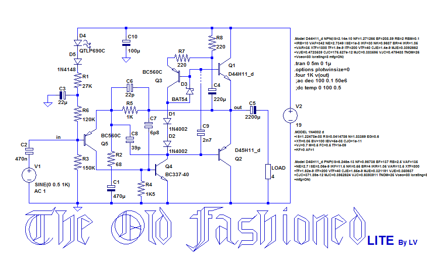

Some time ago, Daniel asked me if I could design "discrete chipamps", ie. amplifiers as simple, tolerant and easy as chipamps, but completely discrete in the seventies style, and with additional constraints: single-supply, no LTP, no unusual parts like lat-FETs and transistor count < 9.
Here is the result for the lite version: ~0 to 25W output.
It is the base circuit: the circuit lends itself to various modifications and improvements (will be described later).
attachment.php
It is built to be highly flexible and tolerant: it was initially designed for supply voltages ranging from 3.3V to 24V without any component change, but it can in fact work from less than 3V to more than 30V if the capacitors have a sufficient voltage rating.
All components are non-critical, and it can work with cheap internet parts (my prototype uses some).
The performances are not exceptional, but they are decent enough for such a small circuit, and normally sufficient for most applications.
Since the thermal compensation/quiescent current is always a delicate issue for DIY amps, it uses an automatic class-B bias engine: no adjustment, and only basic thermal coupling is required (this can even be dispensed with completely, more on that later).
The efficiency is also quite good: with a 19V supply, it manages to deliver 18Vpp into a 4Ω load.
The schematic and sim use the D44/D45 OP pair, because it was a preference of Daniel, but in my build I used a BD435 from ST and a BD438 from Philips. Not the best match, but it works with this amp. The VAS is not a BC337, but a CN made S8050.

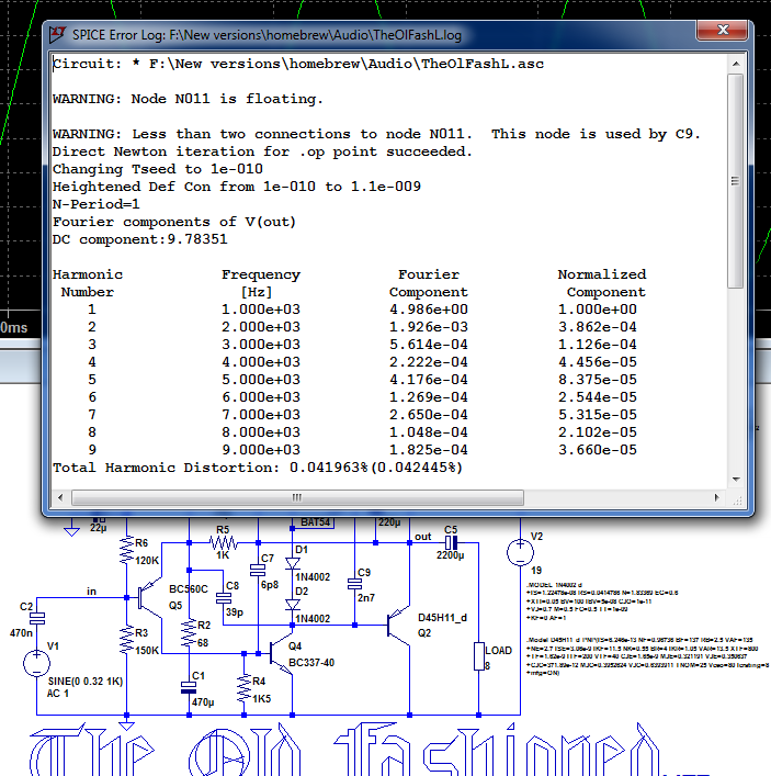

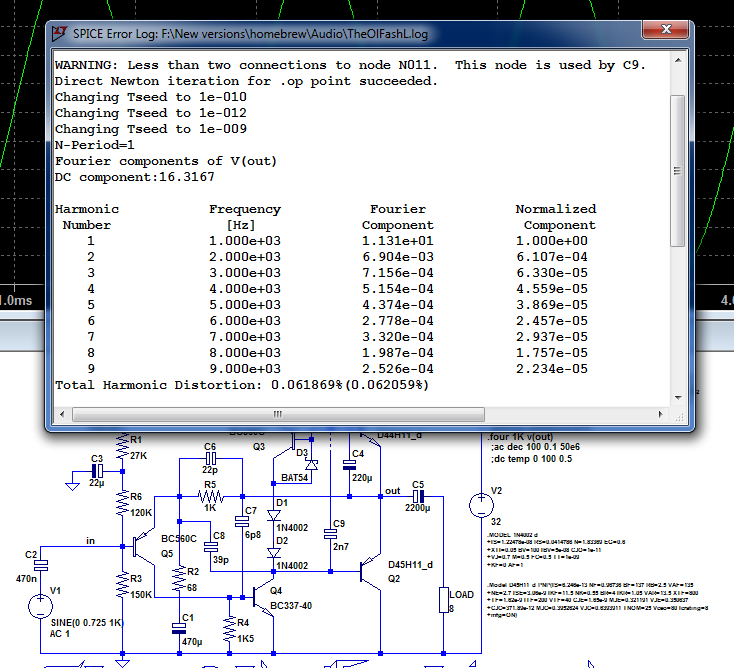

The simmed THD is 0.04%, against 0.05% in reality.
The power bandwidth exceeds 300kHz.

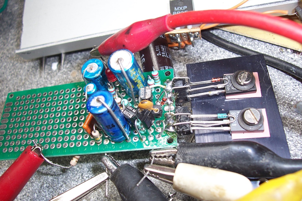

Here is a pic of the prototype:
attachment.php

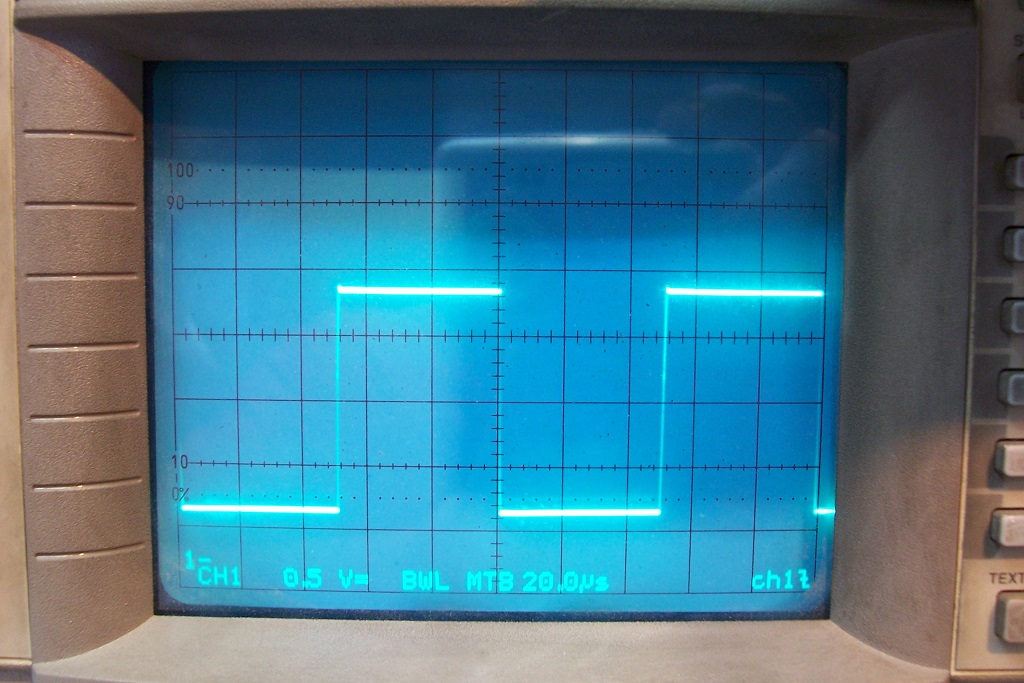

And here is the 10kHz, large-signal squarewave response:
attachment.php

Can you please show predicted distortion profile for 1kHz st say 1w and 8w into 8ohms?
Here it is for 1W
attachment.php
And for 8W
attachment.php
Only exotic part is the BAT54?? What voltage & wattage zener? I've got some original 197? GE D44R2 transistors from the NY production line.
Not exactly exotic: as I was a bit lazy, I took the first small-current schottky available in LTspice.
In fact any small (100~300mA) schottky's like BAT42, BAT48, BAT85 etc will also work, and those are leaded.
There are also 1Nxxxx and 1Sxxx alternatives.
Do not use higher current devices like 1N5818.

From the pic, you can see that I didn't follow very seriously my own advices: the diodes are just in the vicinity of the transistors leads, and Q3 is simply left on the board.
This why the current build uses a 1N4148 + BAT43.
It worked with the 1N4002's, but when I made tests at higher voltages, it triggered a thermal runaway.
In theory, it slightly degrades the performances, but the effect is minimal and the measurements and screenshots were taken in those conditions
To get acquainted with the circuit, for example by building it on a breadboard with improvised external heatsinks and diodes remaining very far on the breadboard, you need to take one of these safety measures:
-Short D1 or D2 or even both
-If the diodes are not too far from the transistors, you can shunt (or replace) one of them by a schottky (that's what you can see in the pic of my prototype).
Without these measures and a haphazard thermal construction, the result will be a quick and irrecoverable thermal runaway.

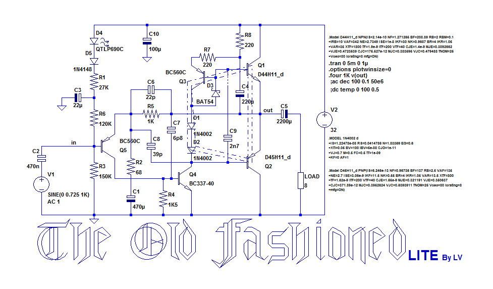

Here is a description of how the circuit works, but first, this is the schematic drawn like it should have been, with the desirable thermal couplings shown explicitly.
Note that D3 is excluded, and that's how it should be.
attachment.php
Under quiescent conditions, the main loop imposes a DC voltage of Vs/2 to the "out" node.
The emitter of Q3 will thus sit at 2Vbe above that, creating a current through R7, R8 and the emitter.
This emitter current will require a base current, imposed by Q3's β.
This will create an emitter current in Q1, but because of the main loop, Q4 will draw a current just sufficient to balance Q3's collector current, plus the base current of Q2 required to maintain the stasis.
A steady quiescent current is thus created, provided Q3 has enough C-E room to maintain it.
Without D1 and D2, this condition is obviously met.
With D1 and D2 adding two Vbe into the equation, the condition is still met, because Q3 can pull the anode of D1 practically one Vbe more positive than the base of Q1.
With the antisaturation diode D3 thrown into the problem, the condition can still be met, because being a schottky, it will spend only ~half an additional Vbe.
If a positive output excursion is required, Q4's collector current will not match the current imposed by R7, R8, causing Q3 Vce to collapse until the antisaturation diode D3 kicks into action, shunting the excess current towards the base of Q1, driving it into conduction.
If a negative excursion is required, Q4's collector current will exceed what R7, R8 can provide, and this excess current will drive Q2 into conduction.
To sum up: Q1 will always conduct, even during its "quiescent" time, but the conduction of Q2 will be hard-switched, depending on the need: this is why the circuit is both switching and non-switching.
The switching aspect might seem to be a potential source of artifacts and discontinuities, but this is mitigated by the fact that Q1 remains always in conduction, thus keeping a certain control on the output, and the role of D1 to D3 is to reduce the magnitude of the discontinuity from ~3Vbe to 100 or 200mV.
It would be easy to keep both Q1 and Q2 in conduction all the time: simply add the N counterpart of Q3 to the base of Q2.
In reality, there is not much benefit in doing that: firstly, it consumes one Vbe on the non-bootstrapped side, reducing the output swing and the low-voltage operation ability, and secondly, it is not necessary: with a step of 100 to 200 or 300mV, the output is able to "ride over" the trough thanks to stored charge and similar effects, and the fact that the phenomenon is completely local, just confined between the collectors of Q3 and Q4, not relying on GNFB, thus very fast.
This is confirmed by the THD residue, where no Xover artifact is visible.
When one of the diode is shorted, small artifacts become visible on the waveform, but the global THD figure remains utterly unchanged.
Thus, it is important to minimize the step, and the magnitude of the step depends on the OP's temperature, which is why minimal thermal tracking is necessary.
Without thermal tracking, things can quickly turn sour because there are no emitter resistors.
Without the various control diodes, the circuit still works, and it does not even require thermal tracking, but the transistor's saturation sticking and the magnitude of the step generate some Xover artifacts, perfectly tolerable for PA or communication channels, but not acceptable for HiFi

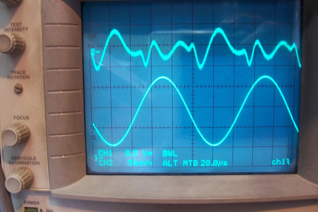

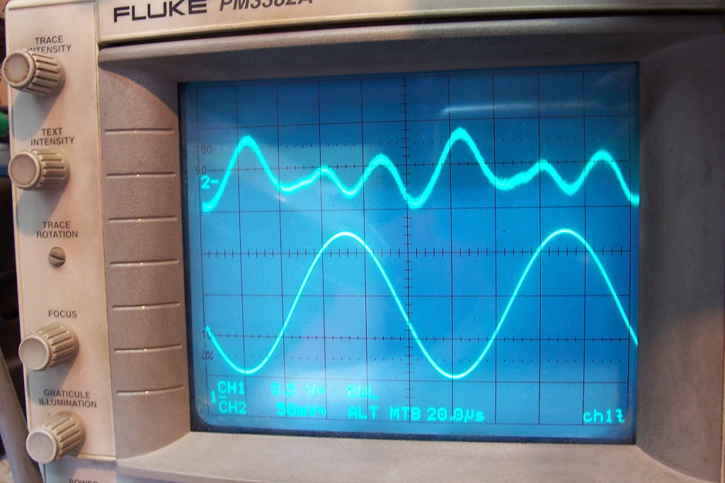

To illustrate what I said earlier about the diodes, here are the THD residues (0.05%) waveforms with the circuit in normal working order, ie. D1 & D2 in circuit, and with one of the diodes shorted.
With D1 & D2:
attachment.php
With D1 shorted:
attachment.php
The first is clearly preferable for normal operation, but for completely safe tests, tweaking and debugging, the quality of the second is ample enough.
The optional capacitor C9 slightly improves the situation for the degraded mode, because it provides a feedforward path from one base to the other, helping the transistors keep the control over the output signal.
For normal operation, its effect is nil.
