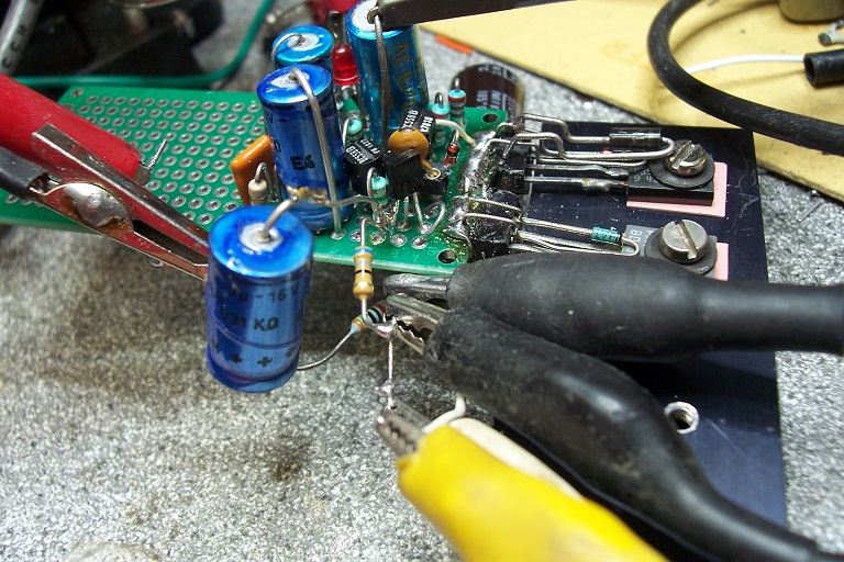

How come nobody noticet that Mr. L.V. really knows his **** in and out? He's using BD435/436 pair in his prototype. A known low-loss family, custom tailored for low-power output devices. A blast from the past, from the "good old times"!
Btw why don't you use something a liiiittle heftier like a BC327 as a Q3?
Would there be any effect on performance or operation by adding emitter resistors?
Not really: remember, contrary to appearances, this is not class AB, and applying classical AB recipes to this circuit will not have the usual results.
Although the circuit will perfectly tolerate resistors, they are unnecessary, and if the "bias engine" does not work properly, destruction will occur anyway.
At most, if the diode string is inadequate, they could slightly reduce the risk of thermal runaway, and other than that, they will be decorative and will deprive you of one of the interesting feature of this topology: the zero I*R losses.

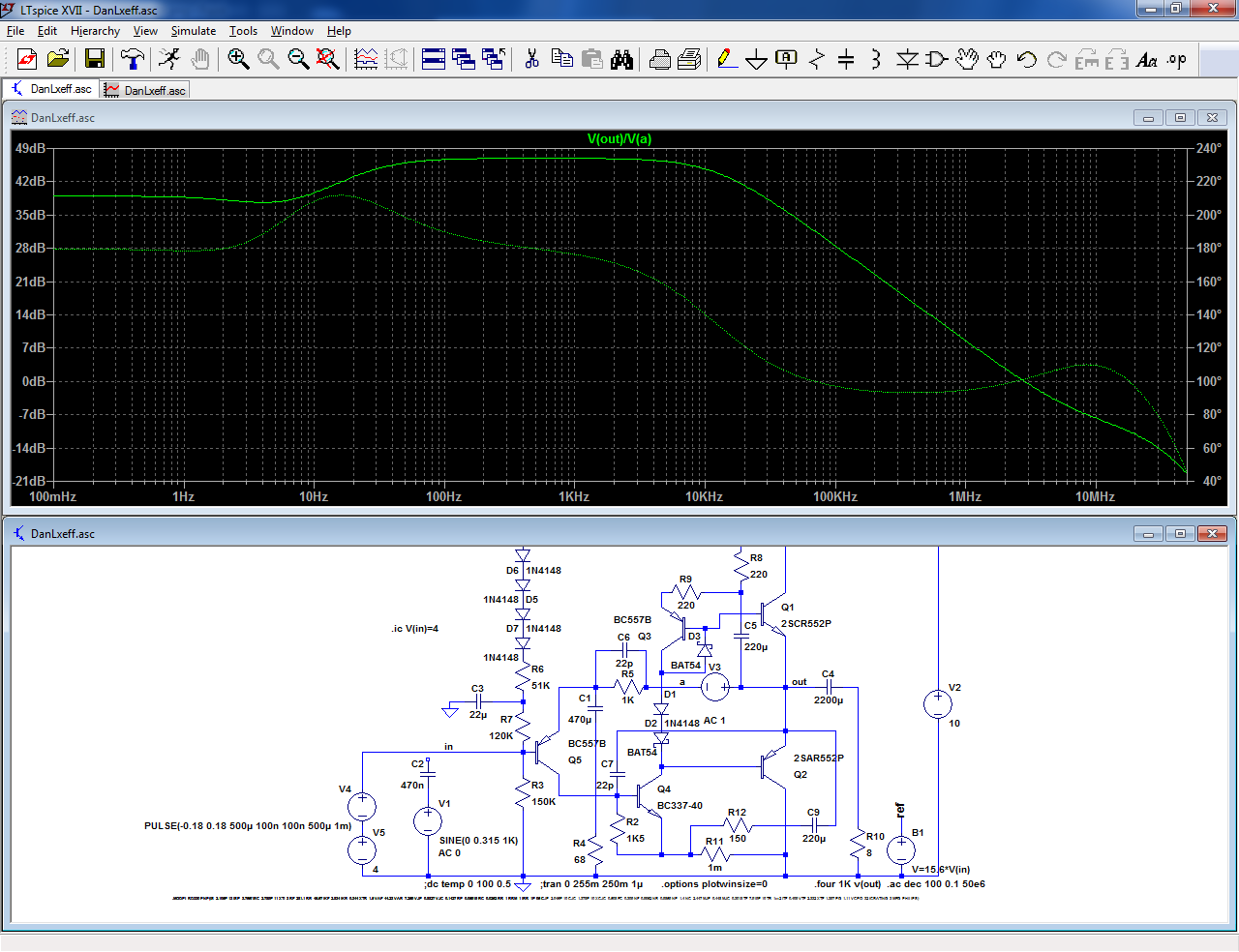

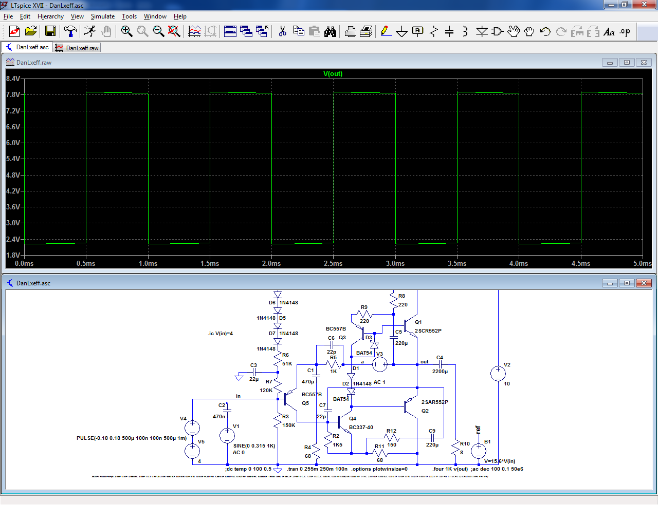

You are right, the phase has a funny look:
attachment.php
Apparently it is caused by the lower bootstrap making C7 mostly ineffective.

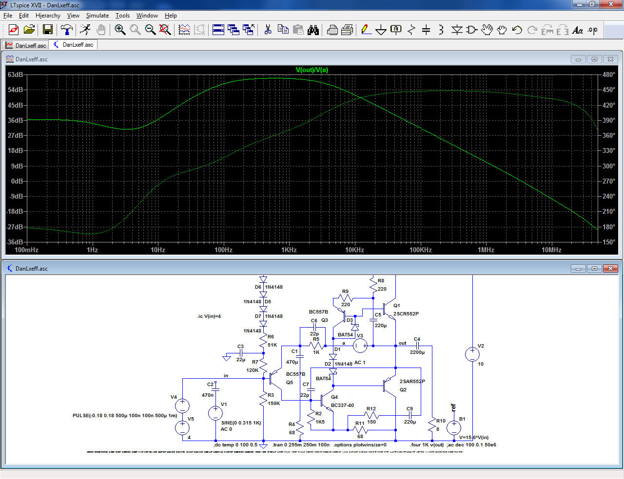

If R11 is defaulted to 1m, most of the strangeness disappears:
attachment.php
As I said, this is an earlier version I didn't optimize and didn't try in reality, and the compensation strategy would need to be adapted and optimized.
That said, the FR does not show any peaking, and the squarewave response with a small timestep looks perfectly clean, with no sign of ringing:
attachment.php
A paradox, that would need to be investigated in the real world, because the sim does not seem very useful in this case

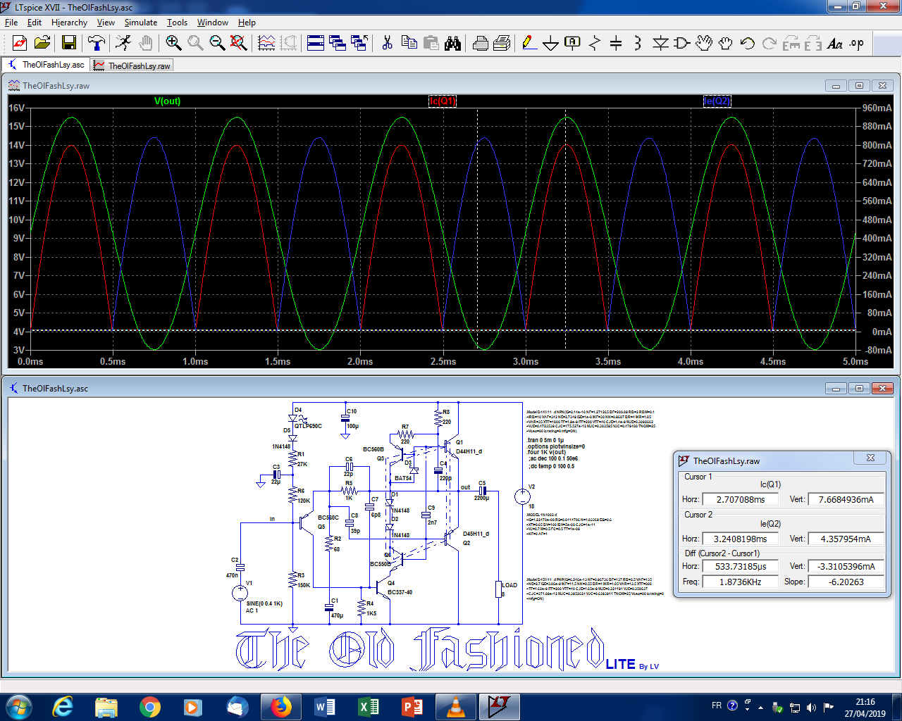

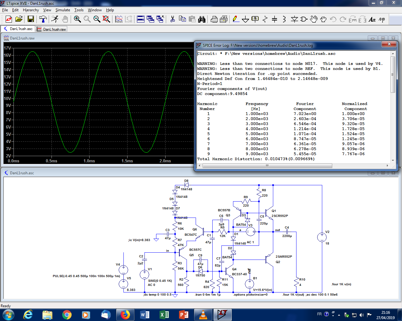

Here are two additional variants that I have studied in sim only and may consequently need to be updated regarding the compensations and some others aspects.
One uses a Rush cascode and zener level-shifter to increase the loop gain, and lower the THD:
attachment.php
The other shows the symmetrical version of the bias I mentioned, and although it has not been tested physically on this exact circuit, I am pretty sure it will work as advertised, and it is in fact a purely cosmetic mod, which is why I grafted it directly onto the "clean" schematic:
attachment.php
Although it is symmetrical and keeps both OP transistors "alive" at all times by imposing a small minimal current (here, ~7mA and 4mA, defined by the Hfe ratio of Q1 to Q3 and Q2 to Q6, as usual), which in principle should be "Good Things", all aspects of the behavior and performance remain mostly unchanged, except that the negative swing is amputated of 1 Vbe, which could matter for low supply voltages.
Diodes D1 and D2 can now be ordinary 1N4148's, because there is a bit more room for maneuver.
Edit:
I forgot to use an antisaturation schottky on Q6
  • TheOlFashLsy.asc
    TheOlFashLsy.asc

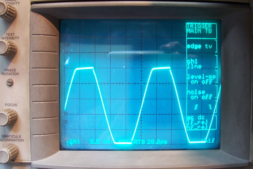

You can sometimes get the weirdest loop gain and phase plots when an amplifier is unstable with open loop due to a local positive feedback. Apply a negative feedback that's stronger than the local positive feedback and everything behaves normally again.
Yeah but what happens if you play loud and clip the amp here and there. For low-voltage amps I think it's better to make it as flat as possible. Otoh, a low-voltage-wattage amp won't do much damage if it burps here and there...
BTW, nice touch-ups on topologies from the younger days, he he.

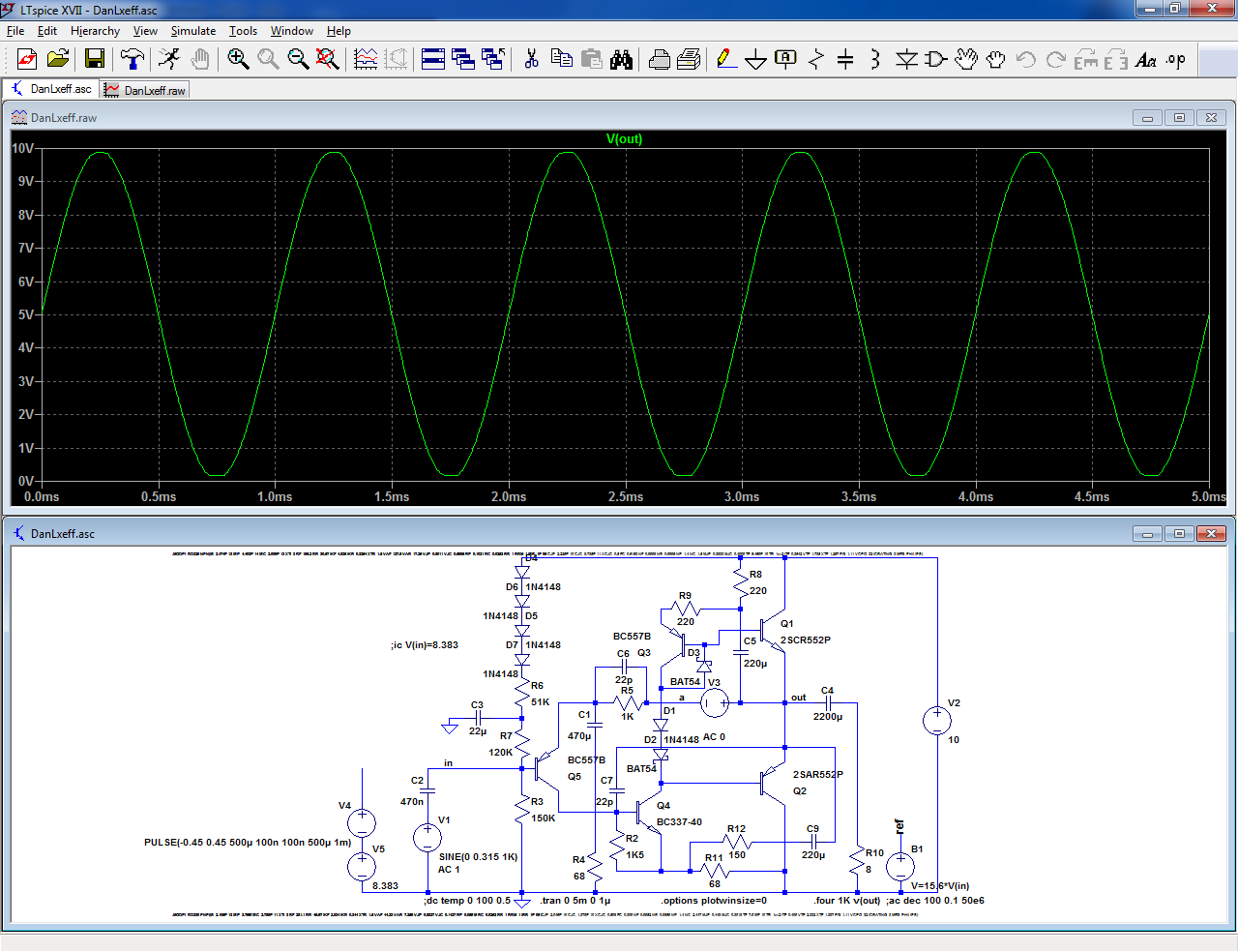

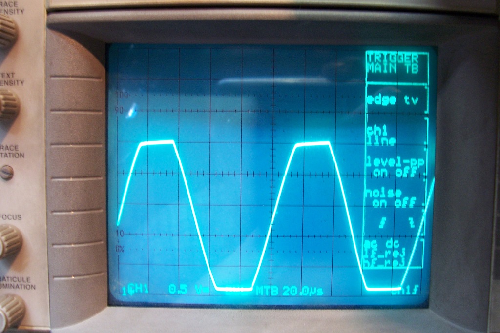

I made the test, the quick-and-dirty way: I just grafted the bootstrap components to the latest version to make it rail-to-rail.
attachment.php
That aspect works as expected, which is no surprise, and I tested the 10kHz, large signal squarewave behavior:
attachment.php
The result is slightly degraded: a small overshoot.
Nothing catastrophic, and it can be remedied by bypassing R11 with a 5 ~10nF cap, and/or increasing the compensations according the division ratio of R11 and R12, so it is usable. I didn't attempt to refine the compensations to the point of perfection, but it should be doable (you could even live with the small overshoot: on actual music, the effect should be infinitesimal).
Without a load, the signal is perfect.

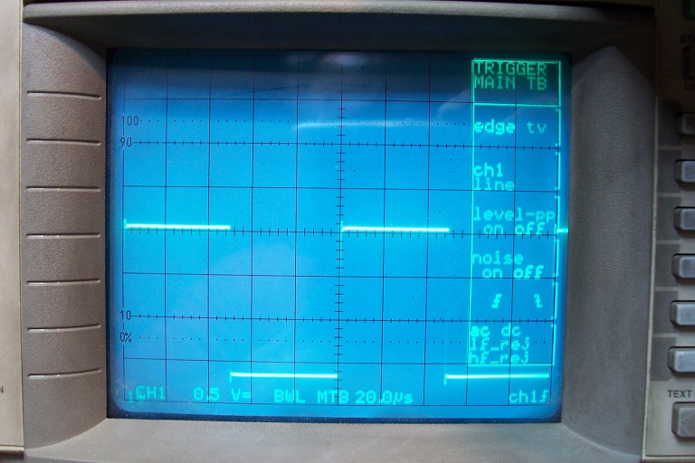

Yes I did, and a small degradation also appears (slight rail-sticking), but again nothing near as catastrophic as the loop analyzis would hint at.
Here is the behavior of the "normal" configuration:
attachment.php
And here it is with the bootstrap and nothing else:
attachment.php
The same remedies that cure the squarewave misbehavior also work on that one
