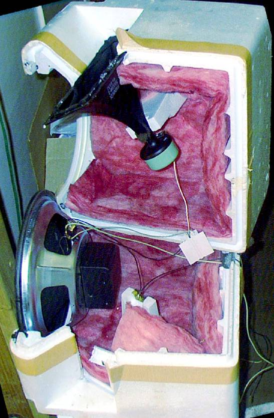

Thought I should post some photos of my old RCA console drivers on the baffles I built. Just as a reminder this is an Alnico CTS 12" and a Foster horn from late 1969- early 1970.
I didn't have much luck with these drivers in OB. The 12" seems to be too low QTS for this use. With lots of bass boost and a 20, yes 20! ohm resistor in series, they started to sound decent. Enough to lead me into more OB experiments.

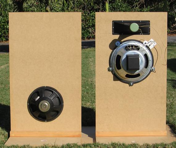

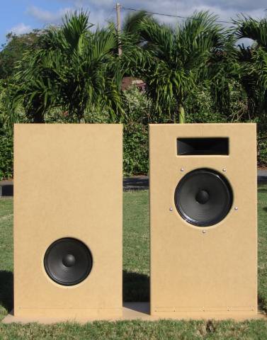

Below is a photo of the stereo pair without wings. The "cat door" is covered in normal use. But please, don't tell the cat he's a "Woofer."

Here's the reason one baffle has a cat door. It first had a 10" small magnet woofer on it. Qts of about 0.65
Lots more bass than the 12" CTS. But I really didn't like the sound of it much. Kinda "wooly" sounding. Just a cheap driver. My wife says I should try the 10 and 12 together. Hmmm..... How to connect a 4 ohm and 10 ohm driver together?

It's going to be easy enough to wire the 10 and 12 in series. No idea what that's going to do to the Q of either dirver, but it won't be hard to try.
We have to be carefull with this stuff, Geoff, or we'll get kicked out of the fullrange club.
I did wire the 10 and the 12 in series. Well, it works, that's about all I can say. Takes some edge off the 12.
Also tried parallel, biamping, resistors, inductors, etc. Just could not get them sounding decent. Definately the wrong drivers for the job. Perhaps with a whole lot of EQ they could be decent - but it may not be worth the bother.
