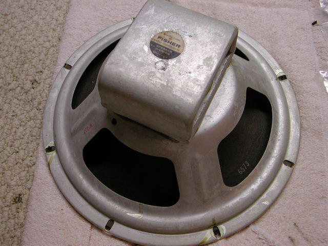

Smokehouse Bob said:This is a Fisher
Some serious magnet on that one... be a nice support driver for one of the modern 3" jobbies or an old small oval, or 4".

Should we show Bob some real magnets. Like 10lb alnicos, or 18lb ceramic.
WooHoo! Those would be some real weights for sure! Man,
What did they come out of? BTW, I am a step or 2 closer to completing the OBs, the smoke has cleared and I have all my appendages!! I have one of these that is just about here and I'm ready for a little single ended action.

Hi Bob, the 10 pounders are on Wharfedale Super 10 RSDDs. Many modern folk think you can't get good bass from a big magnet on a widerange. Mr Briggs knew different, otherwise he would not have had a long voice coil with 3/8" overhang. That's 10mm travel in each direction. I grew up with those, in 5 cub ft cabinets. They were my fathers, now my Daughters, and in my hands, 42 year old and still sound fine. My main system has a pair of 40 y/o, but modified to increase sensitivity, (104dB @ 1m-1w) and bring the resonance up a bit.
The 18 pounders are on my Altec Lansing 411-8As Another big displacer. I think though only 10mm total.
I think GM has some bigger units. about 22 pound on the 515s.
And yes, if alnico won't cut it, there's a mile of copper wire. And spiders with 3 "S" legs. No dust cap. What spider noise?
