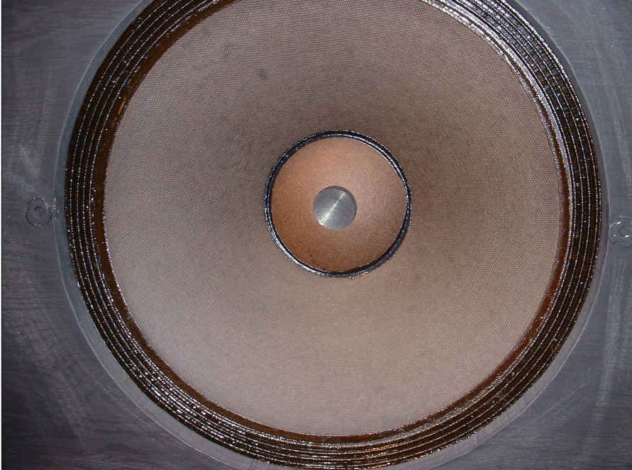

Ditto, I was about half-way through my speaker building 'career' before I acquired any power cutting tools and was ~done before I was given a router kit. Even then, by that time I was getting a neighbor to fly cut the driver cutouts on his big drill press, so have yet to use it for this app. FWIW, here's an example of my freehand jigsaw work from the late '60s, with all the other cutting on these ~20 ft^3 'subs' done with a handsaw in an apartment parking lot, so don't have any sympathy for the folks that whine about not being able to DIY because they don't have the space and/or table saw and/or router and/or jig, ad nauseum............
WRT chamfering, not having a router and in my need to save time where practical, I lined the cutout with felt and added a felt ring around the perimeter to mimic it, and when the driver was mounted from the front, a large/coarse half round 'b-a-s-t-a-r-d' file made short work of a small driver's cutout backside to allow it to 'breathe'/rapidly decay any HF standing waves. Not nearly as pretty as when a router/jig is used, but then I really don't care what the hidden parts look like and in theory my uneven 'hand-job' is technically superior due to its randomness.
As always though, YMMV.

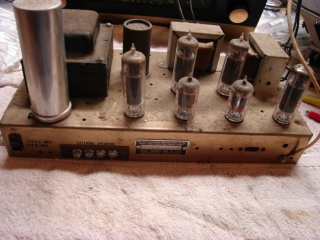

Another console came my way last week, but drivers from it don't appear to be alnico and they don't have the whizzer. They were used with a 6BQ5 PP amp.

Nice cut-out GM. I seem to be happier working with metal than timber or MDF, and also impatient. I'll also conjure up excuses for something that may not be up to the standards of some of the fine furniture makers on these pages.
"and in theory my uneven 'hand-job' is technically superior due to its randomness."
If that theory is correct, the corner cabs my Wharfedales are in, are better than yours. But they were just an experiment, which worked.
There's a pic in the widerange thread. They have a bit of baffle radiation I want to address before cleaning up the hole.

Bob, how come you get all the good old stuff? Don't discount the speakers. They could be pot type, or W (IMHO the best) The 6BQ5 is my favourite hand warmer. A bit more power than the 6V6, and lower distortion. I am considering building a nice big chasis with a bank of 8 in a row with 4 transformers behind them, and 4 12AX7s in front.
If you need any data on the old amps, I still have my 1964 edition of Miniwatt Tech data.

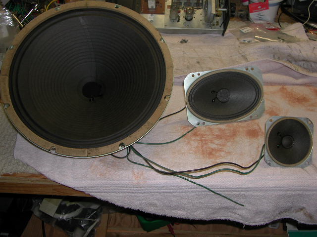

When I win the lottery, Geoff, a large shipping container will arrive at your house loaded to the gills with consoles, I promise!! Here is a pic of the 6BQ5, before fitting out with RCA jacks, power cord, etc. Bet you can smell the dust from here, hehe.
