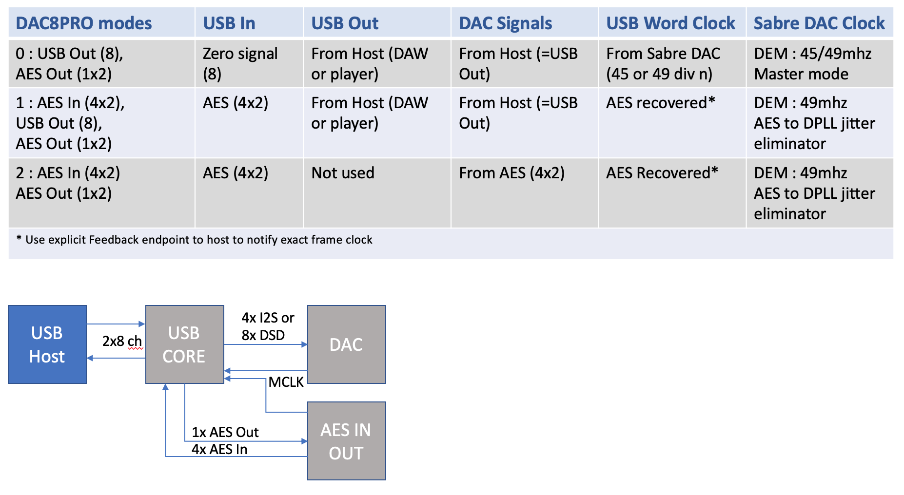

Could it be possible to let us know more about the signal path regarding the "The data flow can also be routed to the DAW USB host for additional processing before looping back to the DAC" (examples era very welcome).
The DAC8 PRO is discovered by the OS as 8 input and 8 output ASIO-capable channels. The incoming AES/EBU data can be processed in real-time or recorded and sent back to the DAC. Software like Audiolense and various DAW packages should be able to do that.
The attached image describes the data flow.
