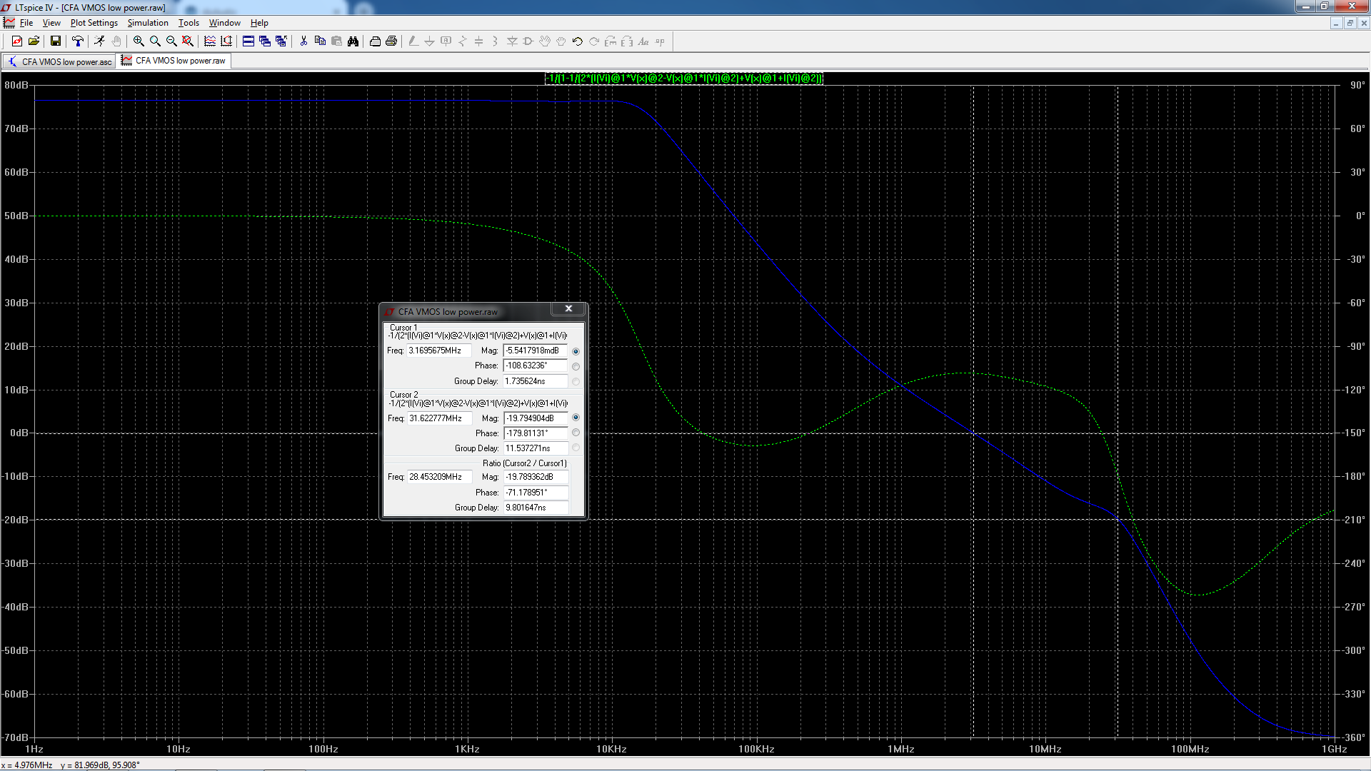

Here is the Tian probe in the C8 capacitor line.
I still don't understand how LTspice determines the phase, looks incorrect.
But I was able to determine the flow thru C8 by a check on the lines in, out and around it.
There is no positive feedback that I can see, so my suspicion was incorrect.
But if it's all one way, and therefore Minimum Phase, why is the phase weird?

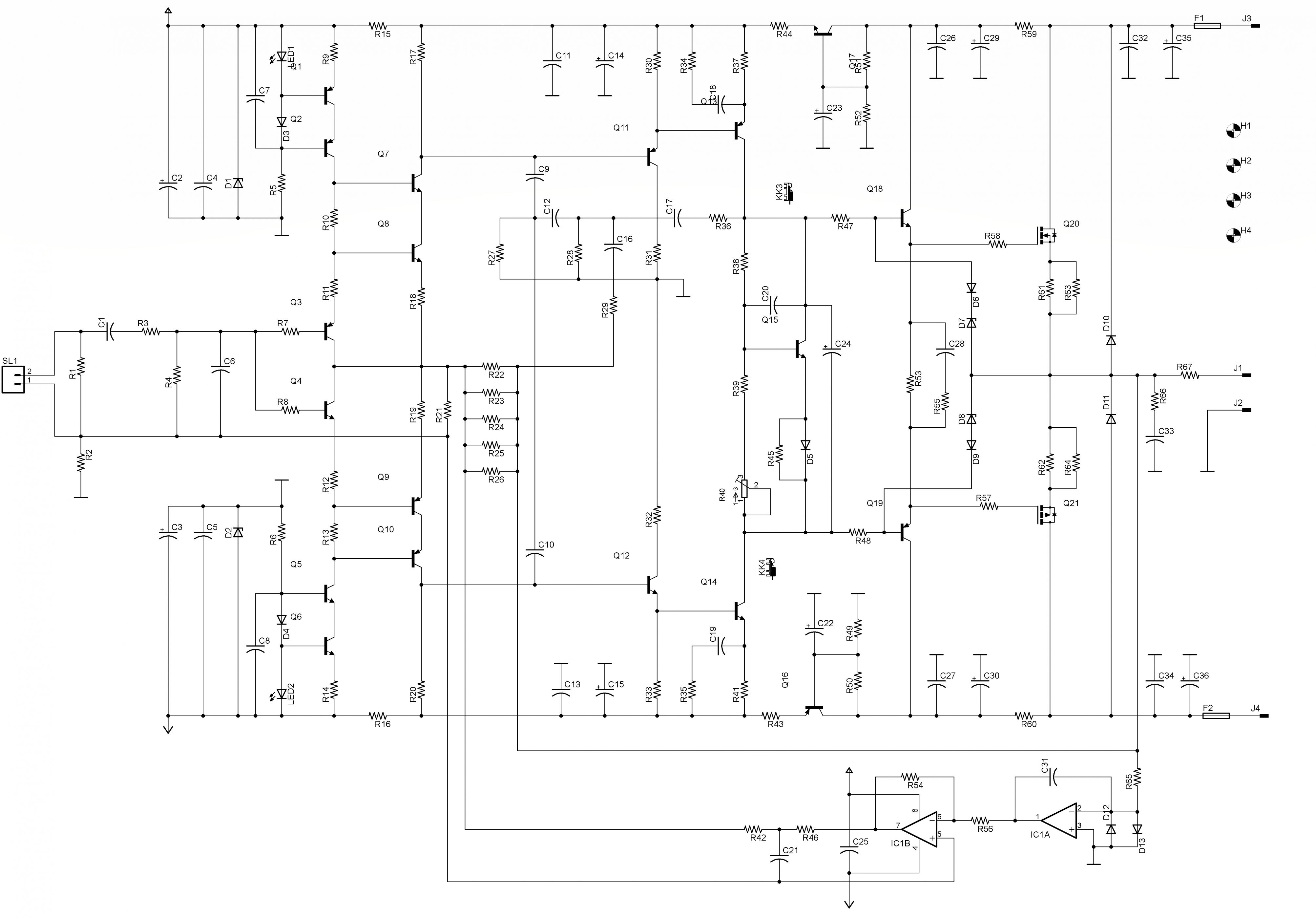

The prototype of my amplifier using this compensation which built by my friend was running stable today. He used un-matching components, DCO was high about 1,8V and then I modified the value of resistor of DC Servo's output. DCO reduced below 1mV. The bias current is over compensated a little bit.
He said the high frequency quality is very good. Monday, I will listening the amplifier.
Bimo, when you said "this compensation" do you mean OITPC? Could you show the schematic?
Yes, but I add a resistor series with Cherry's capacitor.
The schematic is not fix yet. I still modify it (through chat with my friend who made the prototype).
I can see that this amp is very similar to my CFA mosfet. You made this compensation even more complicated, adding not only R29 but R27 and C12 too. Do you have reason for that, could you show the LG plot?
One warning, move output mosfets protection from the drivers bases to the emitters. The protection as it is now is not good enough, I have live experience with it.
The file simulation is at office computer. Sunday, I will find it. But, I have show the Loop Gain in other thread, but I forget what thread 😀
The basic design is same as yours. C9 and C10 are 10nF, just as AC coupling for the compensations, so I can use Silver Mica for C12, C16, and C17. Silver Mica is more expensive than 10nF MKP here.
OK, nice move, but in this case I don't see reason to use R27. It makes additional shunt compensation.
R27 is 100K use to get DC zero voltage of the joining point of C9 and C10. Nothing to do with compensation.
I make this amplifier as cheap as possible and use transistors that my friend already have. Some components was given by other friend. So, this is win-win situation. I want to learn this compensation but have no time to build it, and he want a good amplifier.
