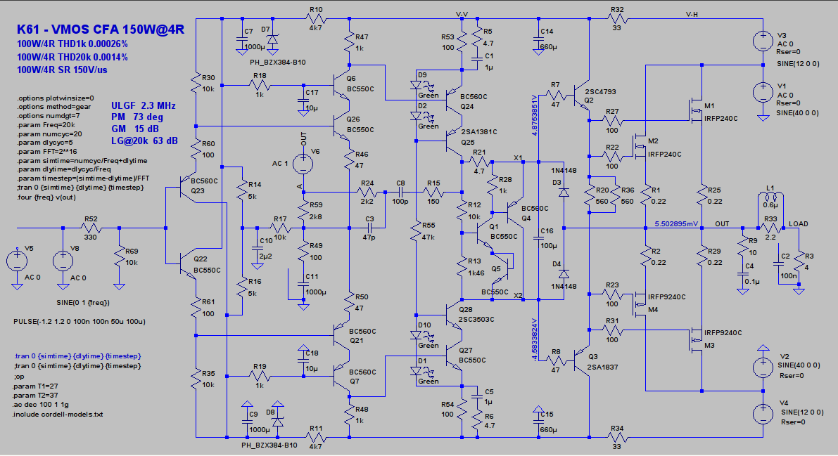

Damir, what about this compensation method ? I'm just before the PCB design is finished. Last chance to change something 🙂 ( I know R30,35 should be replaced by CCS, but improvement is only few ppm)

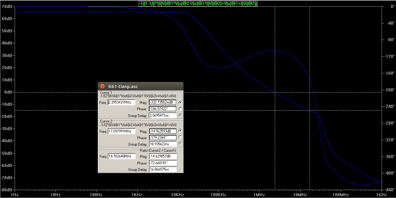

This is similar to TMC, I can't comment just from schematic, and for LG plot better use Tian probe instead, more accurate.
CFA TMIC ? or how to call it ?

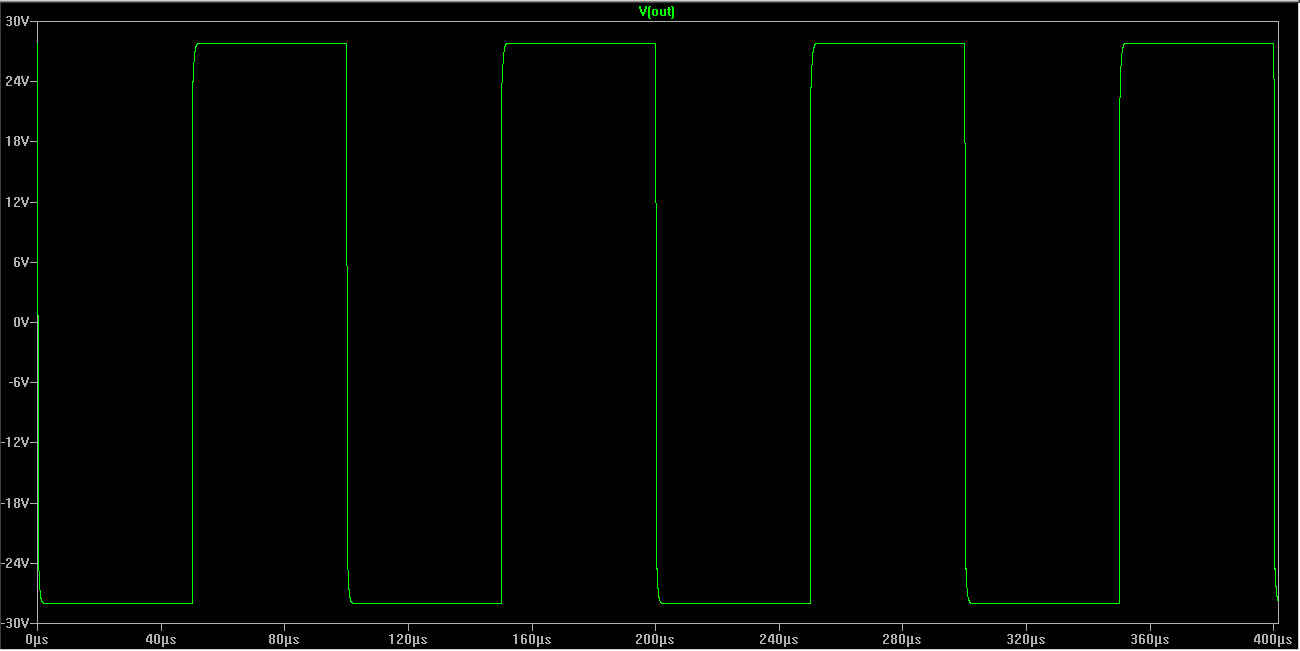

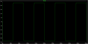

this compensation has better transient response (no sqr wave overshoot), fewer components and the result is very good indeed
tian probe - it is the same
square wave test - input PULSE(-1 1 0 10n 10n 50u 100u), output 56Vpp@4R

All transistors use Cordell models, except Q2,3. Up to +-50V PSU it's safe as it's drawn. D3,4 - flying catch diodes, protect gates from overdrive and also function as natural current limiter. (Cordell book - figure 11.14, page 237/238)

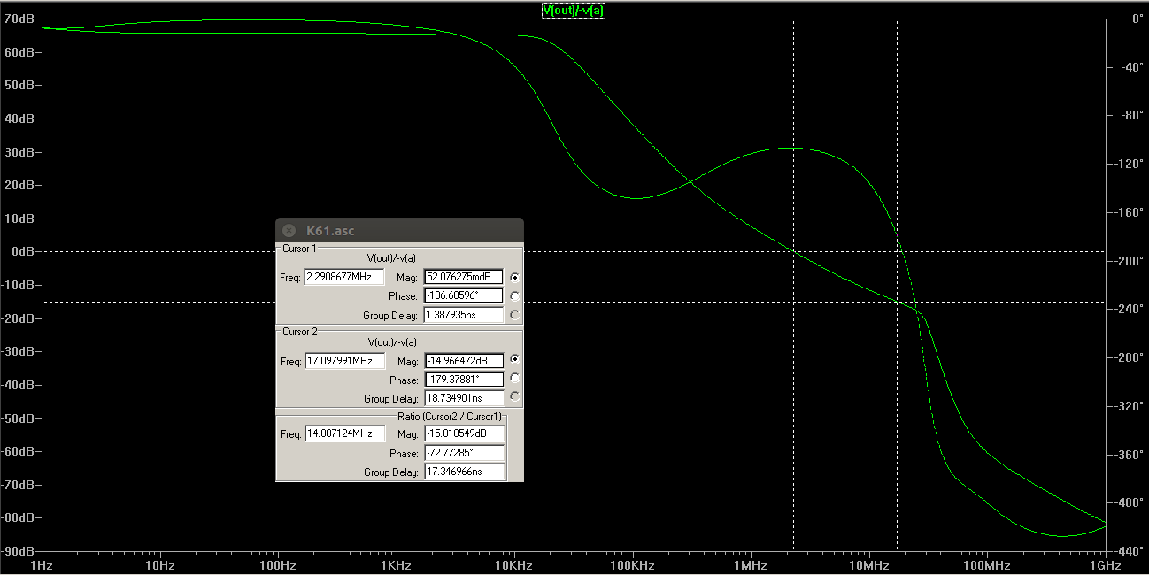

Damir: In post 2 or so you show the phase plot of the amp and it is rippley. Isn't that a problem?
Borys: The 100uF in the ground leg of the feedback loop is too low a value. Yes, Self still shows 220uF in his schematics originally drawn in the 1990s and never updated to his new thinking, but no reason to do it to yourself. Higher vaalues will improve the phase response at low-frequencies and reduce THD even at 1kHz. I use 10mF minimum, but more typically 33mF. (m=milli)

Could you be more specific, what post?
Hi Damir
Actually, all the plots in post-1 and the ones in post-6, but especially the fourth in post-1.
That ripple in the phase response does not look right to me. other plots I've seen for amps with less sophisticated compensation have smoother phase response. So I wonder is this a fact of the compensation, or more about topology?

I wanted to study this more closely since you first posted, and finally made the effort.
I suspect that you have some positive feedback via C8 and C6||C9.
This is not a criticism, I think it may even be beneficial, as below.
Could you put a Tian probe in series with C8 and show the result?
To explain more clearly here is CFA simu[l]ation with enhanced VAS. To remove peak...
I think this peak is not necessarily a problem, theoretically it can be beneficial.
I would be a little careful, of course, hence my interest in the C8 feedback.

If I may answer for Damir because he is perhaps too modest to explain how nice his implementation is.
The phase response complexity is not just a fact but intentional and beneficial.

Hi nauta,
This ripple is a fact of two pole compensation, nothing to do with topology.
Here I use a bit more than simple two pole compensation to enhance it, like splitting output leg and bypassing VAS emitter resistor with suitable capacitor, all that to get better PM and GM wile maintain flat loop gain up to 20 kHz. More detail explanation by Bode.

For HF C7/R22 and C14/R30 (from schematic in post 1 and 6) can be seen as paralleled - shorted via C27/C28. I'm sure you can save some parts here if the pcb is carefully designed.
C8: I have tried this variant (cherry?) and the only GM/PM benefit was during simulation. In real life the amps where more prone to oscillation. See discussion with user kgrlee, Dave Zan and others in thread around post +/- 500.

- OITPC - Output inclusive TPC (not TMC)
