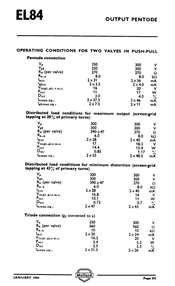

Perhaps interesting. I've asked UL taps to be 25% instead of the ubiquitous 43%.

Hi Lee,
Sure because Dynaco Z565/MagneQuest MQ565 had them. And I thought the 565 sounded better than the other EL84PP transformers I used to have.
Output transformer for EL84 PP
And I read this somewhere on this page Why have I never seen any 6L6GC-based ultralinear amps? | Audiokarma Home Audio Stereo Discussion Forums:
Doesn't mean he is right though. But Hafler and Keroes also determined 25% (But that was probably for max power)
At the end of the day...I don't think it matters THAT much. Would have been nice to perhaps be able to switch between 25 and 43%. At least then I might have an anecdotal opinion on it.

True UltraLinear operation is in fact very specific with regards to the tubes used, optimum screen tap percent, and even the type of bias system used. Unfortunately, many if not most transformer manufacturers today are dumb-stuck on the idea that optimum UL operation is achieved in all tubes with a generalized tap placement at 40% of the winding. Nothing could be further from the truth. Relative to the performance characteristics that true UL operation achieves, use of a less than the optimum tap percent can be quite detrimental to the performance of some tubes, with straight pentode operation producing much better results than a poorly placed UL tap achieves. As stated before, UL operation of the 6L6 family of tubes requires the screen tap being placed at 43% of the winding, with a reflected load impedance of 6600 - 7600Ω depending on the bias scheme used. The 6550 family requires the taps be placed at 40%, with a reflected load in the 4-5KΩ range depending on bias arrangement. EL34s operate best with the taps at 33% using fixed bias, while the EL84 family works best with fixed bias and the taps placed at 25%.

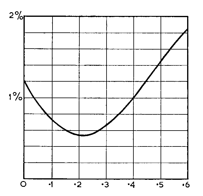

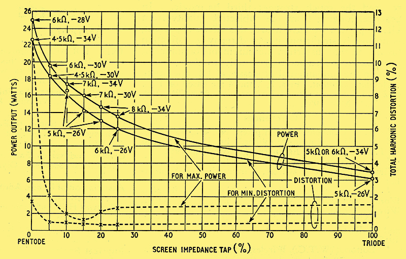

I hope you can find it useful:
for KT66:
THD taken from page 52 of "High Fidelity Sound Reproduction," E Molloy (ed.), Newnes, 1958.
For EL84:
High Quality Audio Amplification

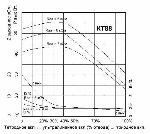

For Kt88:

zintolo, all this data is pretty well-know, but, like Bas said, it gives no info on the harmonics spectrum which is also very important - say, 10% of 2nd and 1% of 3rd harmonics is preferrable for PP amp to the 5% of 2nd and 2% of 3rd harmonics.

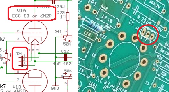

close jumper for ECC83 1-2, for 6N2P 2-3

How do I wire or set for 6n2p valves?
Lee
You ordered the board right Lee? In that case use a jumper. See the pcb schematic for which position is which. 1-2 is for 12ax7. 2 and 3 6n2p
