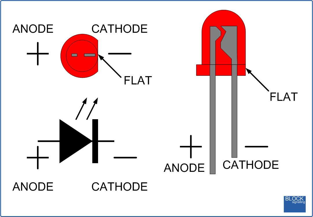

Is the problem identification/polarity of the LED leads? The board mask shows the LED as a circle with a “flat” side, so the flat side is the cathode.
If the physical LED has a flat area (on the plastic housing), the lead adjacent to the flat area is the negative (cathode) lead. Mount it flat side on the board to flat side on the physical LED
If no flat area and your LED has two leads, one longer than the other, the longer lead is the postive (also known as the anode) lead, short one is cathode.
Be sure to check the data sheet of your specific LED.

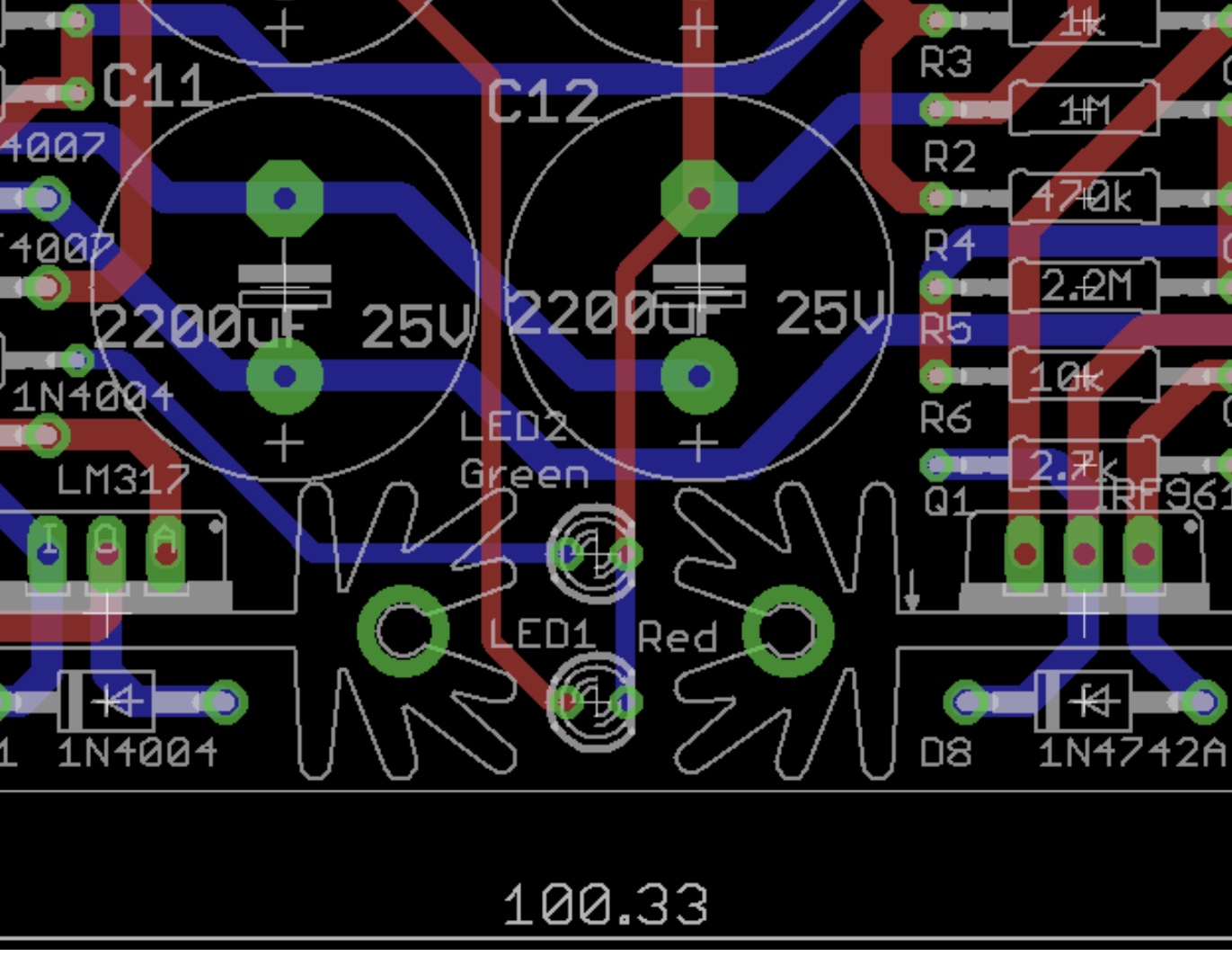

Sachu888,
On this photo of the PSU board it shows the flat sides of the diodes (cathodes) on the right. Does your PCB not have the same mask?
Dear Sachin,
take a look at the PSU schematic here: EL34 Baby Huey Amplifier
From that sachematic you can see that LED1's cathode is directly connected to Q2's collector (clearly shown in your first photo), and that LED2's cathode is directly connected ground (most probably the horizontal track that seems to go to the negative pin of the capacitor close to it).
Double check yourself.
