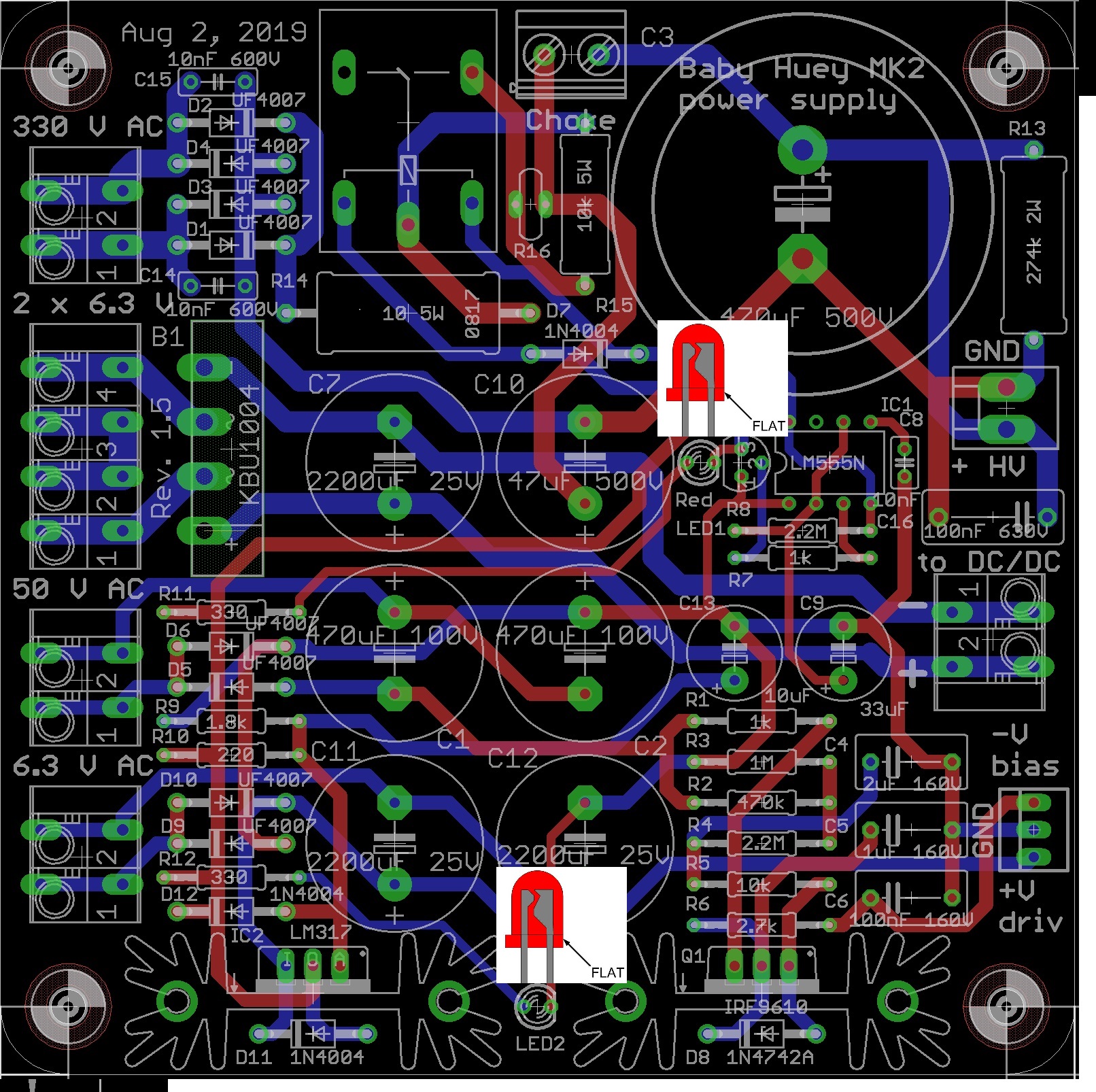

On this photo of the PSU board it shows the flat sides of the diodes (cathodes) on the right. Does your PCB not have the same mask?
Hi Francois
I run across a problems with power supply board. There is an IRF9610 P channel Mosfet. You can see the pic above. The 1N4742A diode's anode should connected to drain, cathode to source?
Where as on PCB : drain is connected to cathode and gate to anode? is this ok? or should I reverse the mosfet orientation or just reverse the diode?

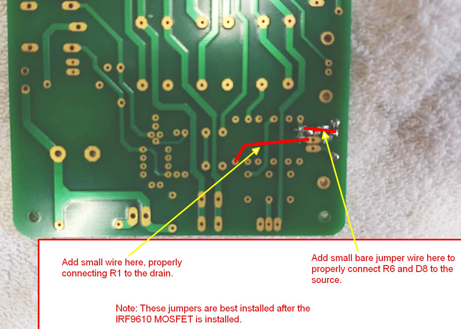

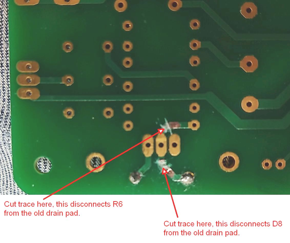

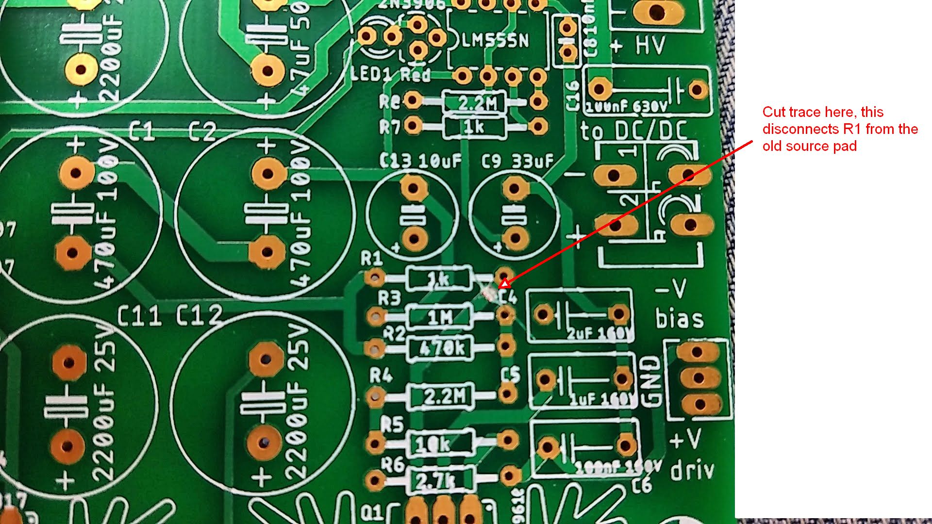

IRF9610 PCB correction, drain and source are swapped !
there is also a mod --->
Thanks for detailed explanation. I will do this now.

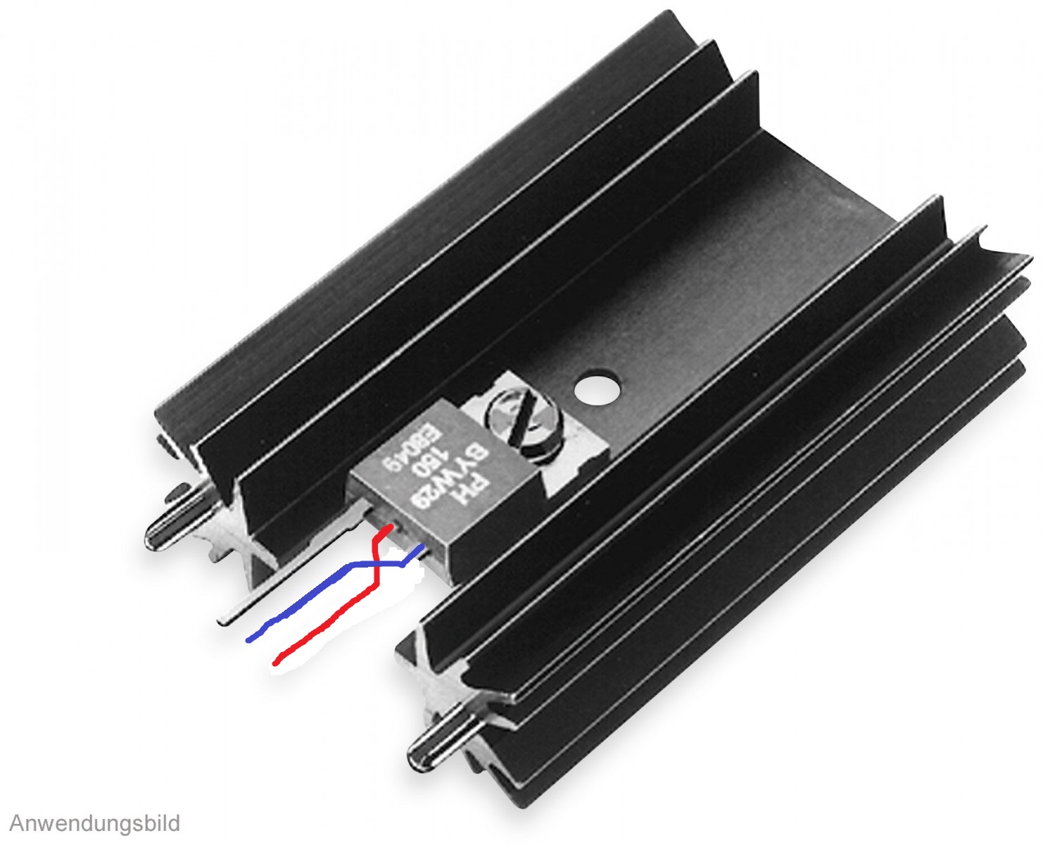

with a little skill you can mount the IRF9610 a little higher on the heat sink and cross the pins by bending it
Thanks!! If I do this then no need to cut any traces and placing jumpers?

yes, no need to cut traces and placing jumpers,
see corrected scheme !!!

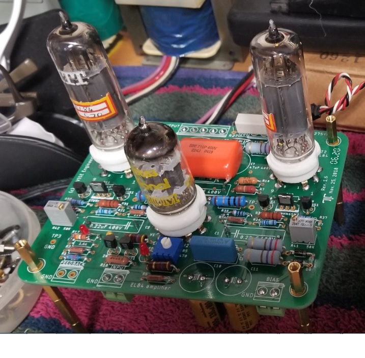

I have completed soldering of all three boards. They are now on the way to UK. I have twisted the legs of IRF9610 mosfet as suggested by Snapper. I didn't solder it on PCB as he may not need it for his EL84 build. Thanks everyone for their valuable support. If any one can correct power supply gerber files. I can get the good quality PCBs done and offer here if anyone interested.
Here are some pics
Regards
Sachin
Here are some pics
Regards
Sachin
hello Sachin
so far so good, but for a housing installation with visible EL84 it would have been better to put the 4 electrolytic capacitors and the terminal blocks on the other side of the board!
regards
regards
