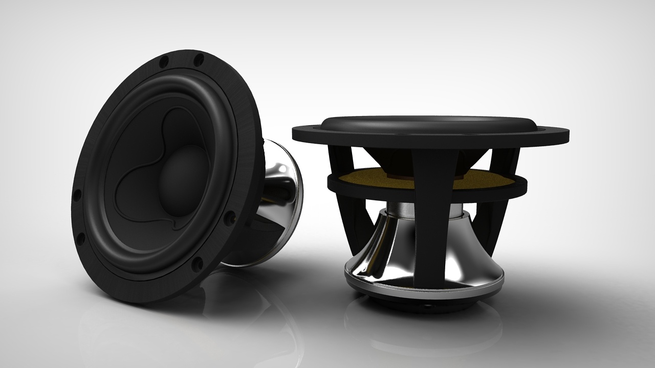

Possible change of midwoofer for the Aurora - illuminator 15wu
Just running it through its paces against the Audiotechnology c-quenze 15H. Look pretty promising so far though. Also the limited space behind the driver when in the cabinet will benefit from the more open basket design of the illuminator.

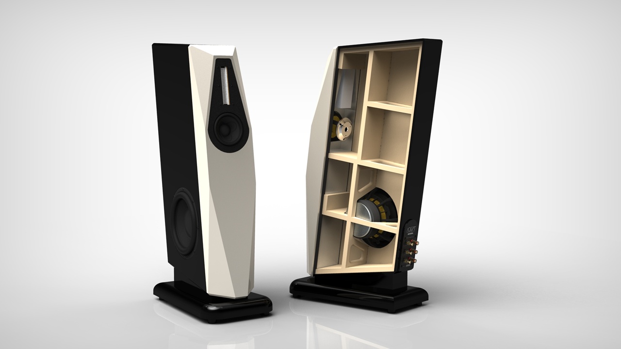

Knocked up a model of the illuminator this evening to give a better idea of how it will fit within the cabinet and baffle(will show the improved 'breathing room' later.
i'm very keen to hear what your quote for the cnc comes back as, because i can make up the model in the same way (though not as amorphous) with maya unlimited and cad, but i always wondered what the cost would be to make it real. for smaller polymer and metal objects you can 3d print them with stereo lithography at rapid prototyping websites all over starting to pop up. pretty reasonable pricing too.
OK maybe the CNC option isn't such a great idea. At least not from that particular shop I was interested in anyway.
Had the quote back today and its uneconomical for small runs of say 5 pairs of speakers. My design is slightly complex and does require a 5 axis machine for most of the parts so a design that can stick within the confines of a 3 axis machine would likely be much more economical I'm told.
Basically it breaks down into a £500 tooling, programming and setup charge per run. And then each pair in that run would be £400 with a minimum order of 5 pairs - if you order more you get it for less. This includes MDF obviously.
So for 5 pairs your looking at £2500. I was thinking more along the lines of half that at the very most. I really hope they get what they're asking but it won't be from me . If you do 3 or 4 runs at that price you could buy yourself a really nice used 5 axis machine!
I'll keep shopping around but I suspect I'll have to do this the old fashioned way.
May be using a 2 axis machine and stack it up like the old Magico Mini will save some cost?
That would be a very good suggestion under normal circumstances but my cabinet shapes are problematic for laminated construction and only get worse the large the cabinets get.
I'll figure something out even if its means just doing all the work myself for the first few pairs. I've only had one quote so I'm hopeful shopping around will drop the price.
Had another quote its better than the first but still £1750. It seems the setup charge is the killer - £450 this time vs £500. This charge isn't so bad if your having a large production run done but for just 5 pairs, its a big deal.
Its also a recurring charge so everytime you want that particular model done and whether its one pair or ten pairs, they're gonna charge that.
You do this a couple of times and you've spent the best part of £4 or £5k on what? 10 pairs of parts for speakers? Silly really when you consider this is MDF and an 8ft x 4ft sheet of 18mm costs around £40 for the decent moisture resistant stuff.
With that in mind, I'm seriously thinking about just getting myself a CNC machine. For up to £5k you can buy some fairly serious looking 3 or 4 axis machines that would suit low volume use.

btw your rendering skills are ******** good

Cheers, excellent tool is CAD.

Say, I think we have been down this "road" before.
I'm assuming the baffle is the complex structure that requires more than a 3 axis machine. Correct?
OK, so perhaps not a poly infused cement for production.. but a hard cast urethane seems about right to me for this application.

If you "void out" a lot of the non-essential areas then it will require a lot less urethane. And in fact you could use another material to dampen those voids to get a better product altogether. (..remember the silicone caulk in the pipe?)
