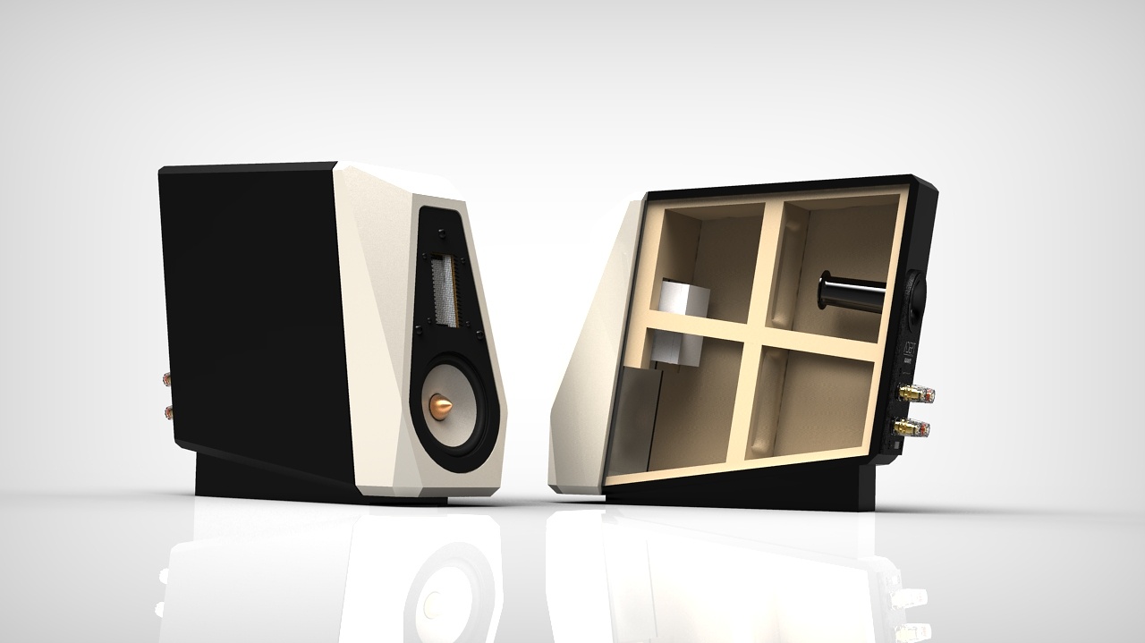

I've found a nice local CNC workshop in nearby Sheffield who do a lot of the cutting for Wilson Benesch. Things are going great and I've just submitted to the workshop what I hope are the final set of amendments needed to take the Aurora design from computer based model to a precision cut jigsaw puzzle! I'll find out next week if that's the case. Either way its coming together and I'm really excited to see the finished pieces.
I've made some significant changes to the internals to accommodate and take full advantage of the increased accuracy that CNC will allow for. I've stuck rebates in the side panels so the bracing now interlocks with these to give a more rigid cabinet. Another upshot of this method is since a large portion of the panels lock together a cabinet can be built up in one session. Just gotta wait for the glue to set really. That's a vast increase in speed over hand trimming all those panels and angles:

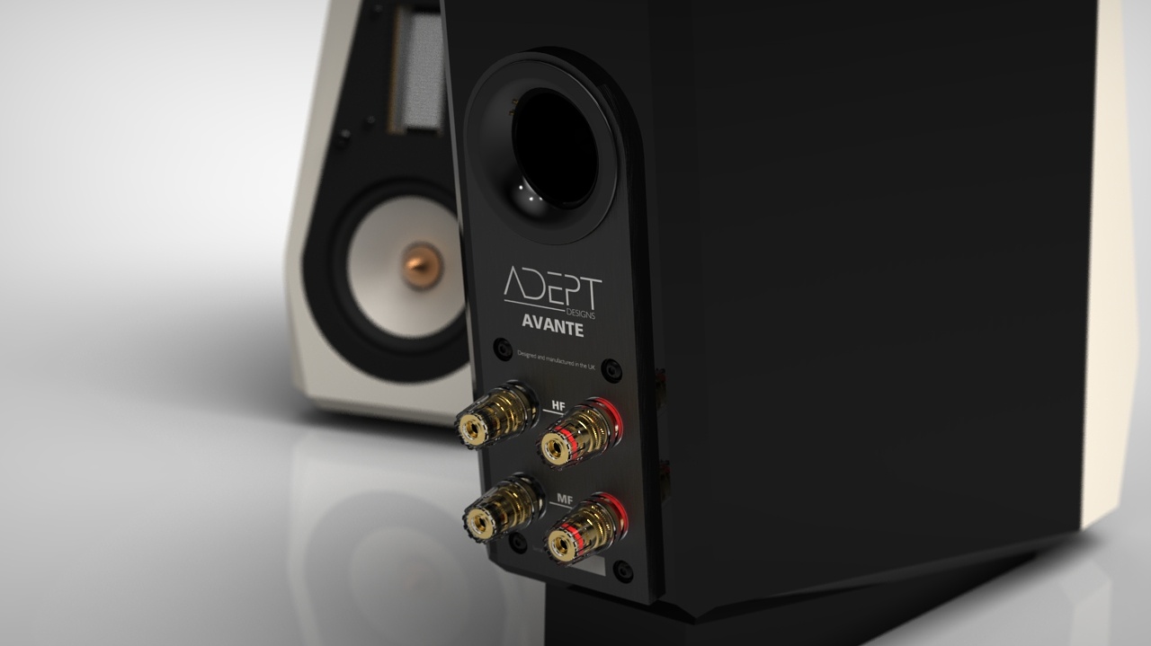

Another cool thing I've nailed is the rear panel used to mount the binding posts. Another company in Sheffield will be laser cutting and etching these. I'll be using black anodised brushed aluminium here and based on the samples of work I've seen from them it'll look a million bucks when done.

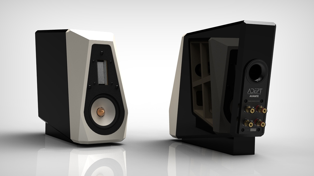

I've pretty much completed design work on the little Avante standmount now.
I've also been busy chatting with Aleks at RAAL and have struck up a deal to supply all the high frequency drivers used in the models I have. So that means bye bye to the excellent Scanspeak 602010 Illuminator and hello to the phenomenal RAAL 70-20XR. I've had to make some adjustments to accommodate this much larger unit but its definitely going to be worth it and since the other models use RAAL then the family sound will remain more consistent as you go up through the range.
I'll also be getting my hands on RAAL's new budget tweeter which probably won't be used in this design but will almost certainly find its way into something in the future.
You put a heck of a lot of detail into those binding post models.
I think it's rather safe to say that he puts a heck of a lot of detail into everything
