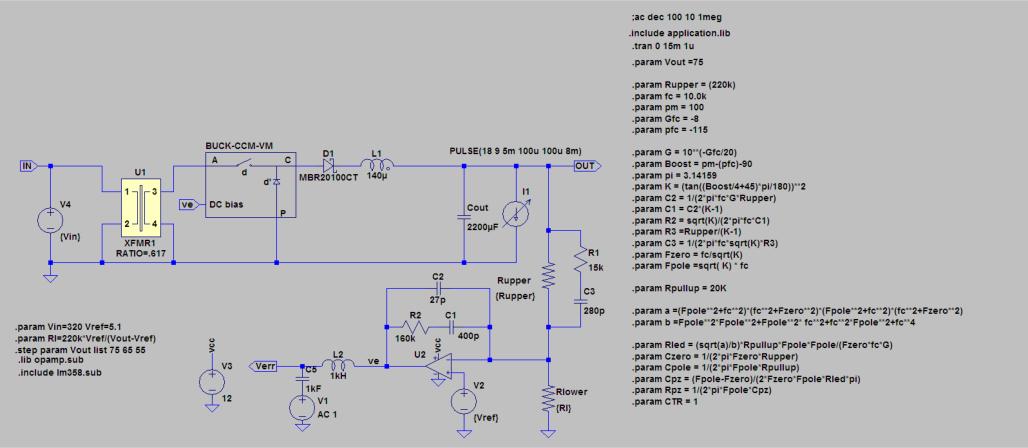

Most components are from K6 parts lists except the output filter(caps and inductor),IGBT, and feedback circuit.
Step response is very good thanks to type III compensation, fsw (75kHz)
I will post LTspice simulation so you can play with it . all you will need to do is download LTspice(its free).
Thank you and also Happy New Year, a bit late but hey, right?

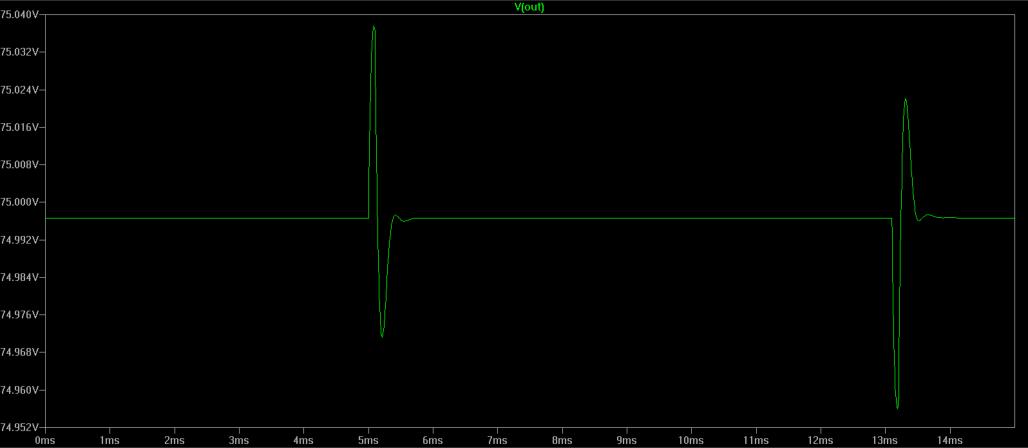

Is that your only scope? If you have any storage one, that step response would be great to post for others to see.
If not, by how much does it fall/rise going on and off load?
FB K6 revist
No this is FullBridge, the IGBTs are 12N60A4D(Fairchild) from ebay 2years ago and since the step response is mainly determined by compensating feedback I am attaching simulation of load stepped about 50% over 8mS, I have not tested real world because I am winding another inductor for 300uH and I am awaiting heat sink.
I don't expect real world response to be much different, LTspice simulator results have been very close in the past since it is for power supply simulation.

In the past I had constructed a halfbridge version of the A&T design and in this thread a few have tried with varying results so I decided to construct the FB version with some of my ideas to see if it would work out of the box if the instructions were followed and it does without problems with a different type feedback, I didn't use the feedback because I wanted the regulation tied to the positive rail and different circuit for the selected voltage outputs. I don't intend to power any amp this is only for testing for max output with the IGBT's.However when finished and performs as expected I will supply info for construction.
Fairchild does not recommend these for new designs, there is a FBU replacement and they are sold on ebay for a good price but I have a few of the 12n's and will use them in feature projects, I am going to revisit LLC , I got turned off because of magnetics and PFC for the amount of power(2kW), Quasi FB seems like a good project.

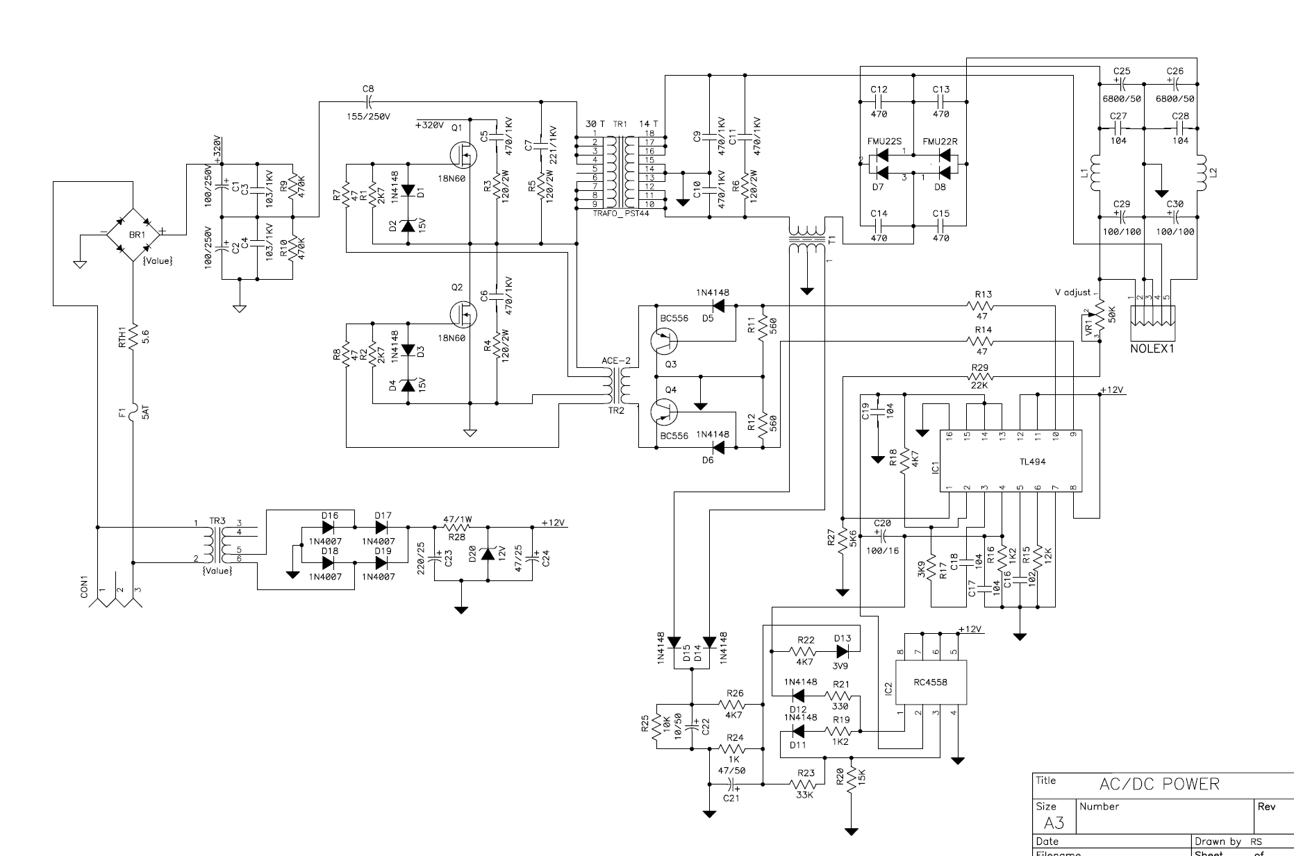

Hi Guys,
I found this schematic while scanning the whole thread. It was shared by member NRS, as I am looking for an smps circuit that has TL494 pwm IC, I got attracted to this one, parts is not too hard to find. Id like to get my hands on it, however there seems to be no details on TR1 and TR2. TR1 is a sensing traffo..? TR2 is a gate buffer.
Member NRS seems to be no longer in contact with DIYAudio (last visit was in 2015) I sent him/her a pm 2 weeks ago but no reply as of this posting.
Anybody out there knows how to construct TR1 & TR2..I could use s some help.
Thanks!
Albert
TR! & TR2
The transformer (TR!) is more than likely a ETD44 core set / bobbin wound in the following manner 15 turns of primary, two secondary windings 7 turns each and finish with 15 turns of primary(use tape between windings, if you use other FSW then you will have to re-calculate turns of TR1.
TR2 is standard gate drive transformer costs about 5 to 6 US dollars each, check this URL:http://www.mouser.com/ds/2/336/-369999.pdf for info , you can wind your own (not hard check you tube for DIY gate drive transformers.
This circuit can be modified using gate driver IC's IR2010 or NCP5182 or others this will eliminate GTD and buffer transistors.
Hi Chas1,
Thanks for the feedback, ..guess I got confused with the traffo numbering, I meant T1 (not TR1) the other traffo connected to the lower half secondary of ETD44 tapped to the opamp 4558.
I plan to manually handwound the gdt, hopefully I could get it right I made one when I built a Detex clone (self oscillating topology).
Albert

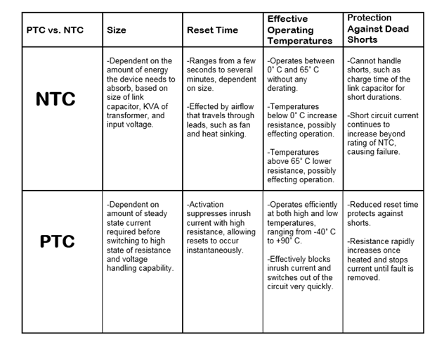

Could I use PTC thermistor in line with the primary high side (+ rail) just after the bridge rectifier? I am thinking of a cheap short circuit protect that could act instantaneous when a fault happens inside the circuit. I am hesistant on using NTC because their resistance starts high during a cold start up. I am aware that the common practice is to install them right at one of the AC mains line entry but I've seen some circuit that had it connected after the bridge rectifier. Is this effective enough?
