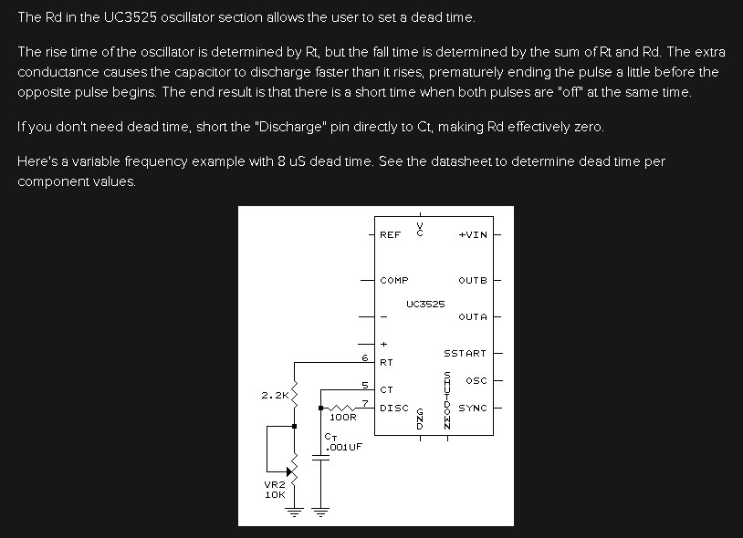

thanks dtp for your reply , i am using discharge 33ohms at pin no7 and ct rt pin 5 and 6 I've used 1nf and 10k caps and resistor .
what should i change ? should i add or reduce the deadtime ? and how should i do that sir?
You did not use the deadtime setup of the driver ic?.
Here you can see how to setup SG ic for dead times and a schematic, the SG can drive a transfomer directly by the way. the totem poles are maybe a good idea for the big nC of irf460.

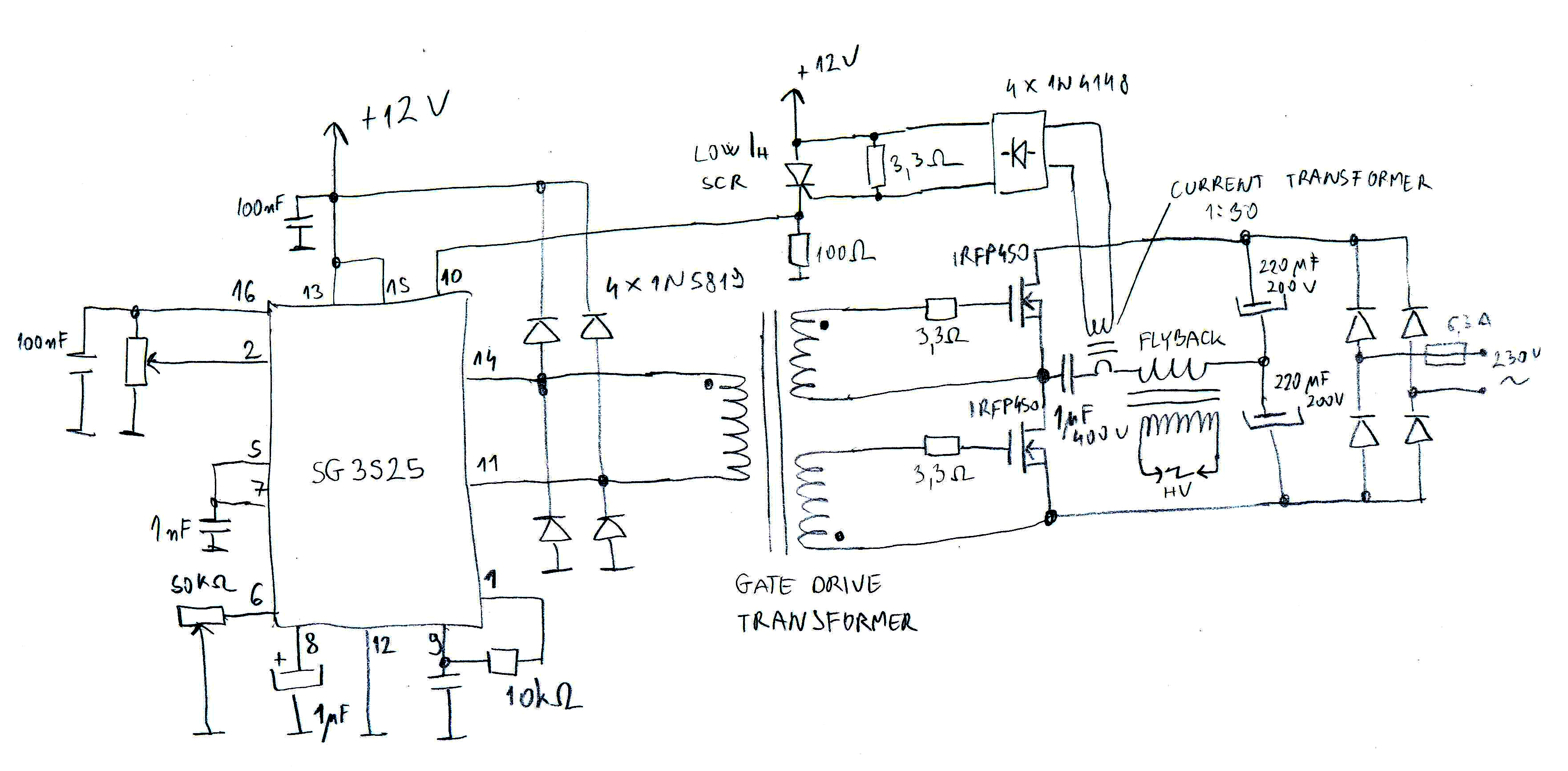

hello all , i have an issue the smps ...
Your high power output rectifiers are loading the same phase...
or to put it another way:
your output high power looks to be designed for a flyback circuit.
while your input side is push pull.
Yes, No ?
More than this gate-transformers are problematic in case of varying duty-cycles. And yes, this looks like some pwm controlled hard switching half bridge converter. Without secondary inductors prone to burn on first overload. Reminds me of these wretched converters that often fail in car audio amps.

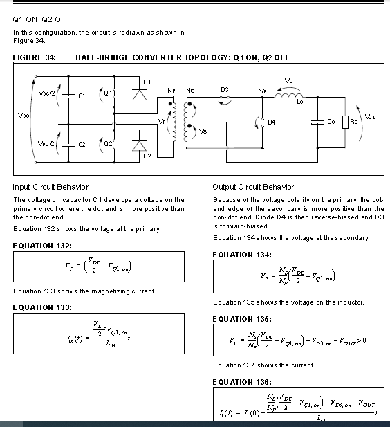

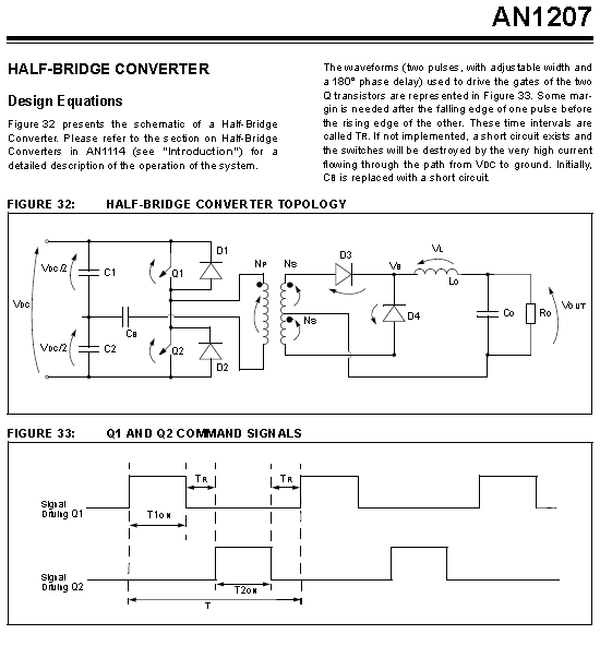

thanks bucks and dug for the reply. kindy dug please provide a simple schematic for an effecient output diode rectification . because i am using halfbridge smps.
A halfbridge is still a push-pull to the transformer.
Take one of your 8T power windings and switch the two wires.
Then loading will be on both phases.
There are other ways but if you have built it already then that way is an easy try.

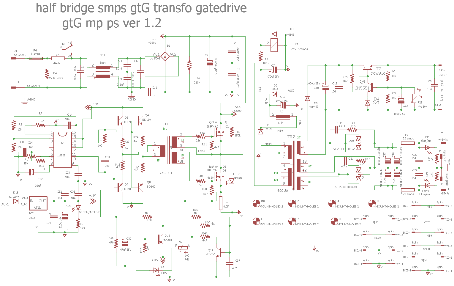

😎hi all more half bridge boards version for higher power handling .they have more banks in capacitor boards are hp 20cm x 15cm and mp 20cm x 10cm
ideas and suggestions are highly welcomed .have fun and post your builds😉
