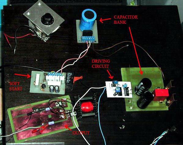

Finally working

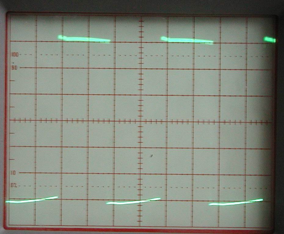

Yes it is complited and working on 230AC 😀. First test was with variable resistor.Because of heat generated on it , it was driven for only few seconds.Heat dissapated for that time was 145W
Wave forms are nice squers as they should be.
Re: Finally working
post schematics😀
luka said:Yes it is complited and working on 230AC 😀. First test was with variable resistor.Because of heat generated on it , it was driven for only few seconds.Heat dissapated for that time was 145W.
post schematics😀

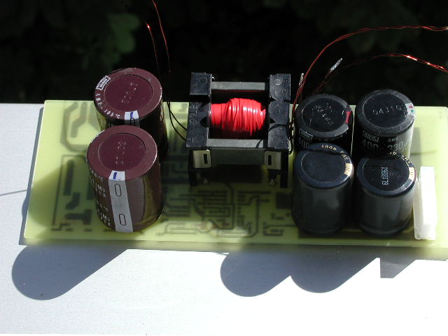

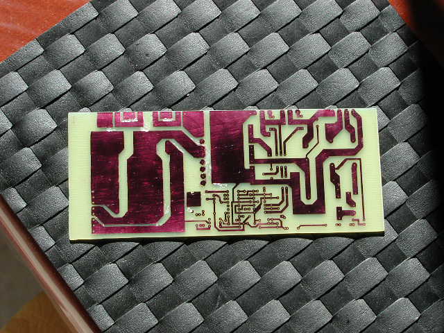

O and Whortless, can't wait to see your PCB.It will help me make my PCB smaller then it is now,and everything on one board only.I would like to see the one, where you use IR😀.
Lp, Luka
Lp, Luka
